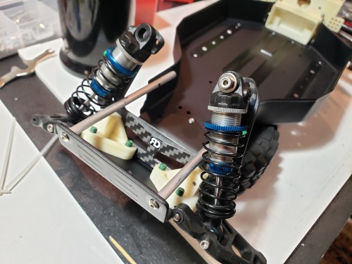

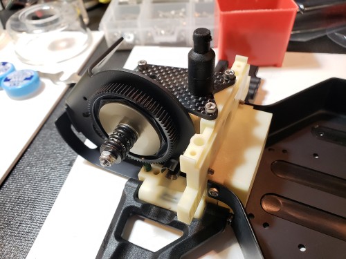

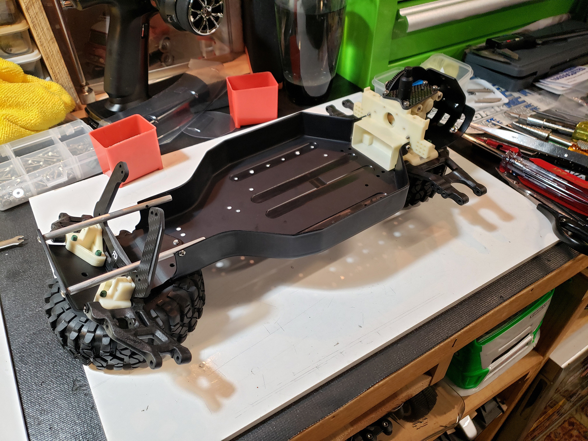

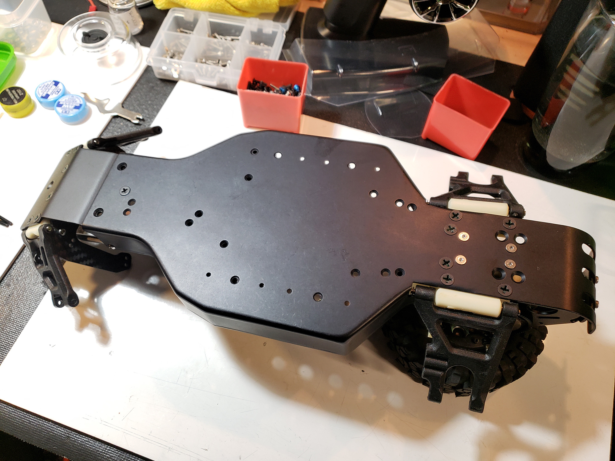

I am new to this forum, yet wanted to share my most recent RC10 build.
I plan to race this buggy in a vintage 2wd class (if it doesn't qualify because of some of the mod's I'll just use it for fun/practice). I have a few nice RC10's that I don't run, yet wanted something that I could use and not worry about scratching or parts breaking. My car will be using modern re-release parts as well as vintage parts and some stuff from modern RC10 vehicles.
Not much at the moment, but here is my progress thus far: I am using Andy's A-arms all around and upgraded a vintage stealth transmission to a World's transmission.
The chassis is one of the black re-release ones, I found it online for $49 a while ago. The rest of the suspension mounting parts, bulkhead, motor plate and nose plate are all vintage parts. I polished the nose tubes, can't decide if I want to paint them black or leave them as is. For now I am leaving.
more pict's to come as I complete the build...

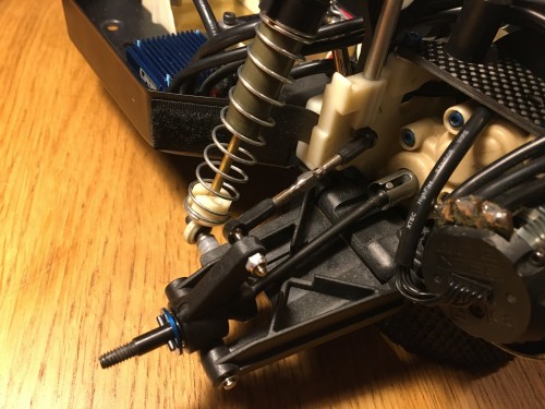

Hi, project looking good.
I can share my experience from racing my worlds rere. There are a few things You need to do:
Use 6565 transmission case and 6570 idler (the rere one is unusable, the gear mesh is wrong).
The 8-32 x 1/2" rere screw break on jumps the philips head goes in too deep and they are weak. use originals or get some proper aviation screws like the originals bare in mind they have 100 deg countersink not the standard 82deg.
The CVA have an issue also the shafts are too short, AE screwed it up! to run them you need to reduce droop ( car will jump badly with reduced droop ). Best solution is to use B44.2 center rear shaft part # 9911. These are hard to find but are the right length. other options are B2 Universal joints. these are the right length and fit.
Some people remove the blue spacer and put it on the other side or simply shim to recover the distance on the inside.
I can see you have a Rusty design front tower, I assume its for 0.89"(23mm) shock bodies. Your problem is that this tower is for Associated arms. the Andy's arms where designed for 0.56" shock bodies and only have the inside shock position. The geometry will be wrong. Use Associated wide arms just not the rere ones. All replacement arms sold until recently where original. The reason: the rere arms are weeker and more brittle, they have a wider area for the B5 shock ball cup. If you break one the replacement will bind since it has more material in this area, it will need to be filled down. (not fun at a race). Use B6 shock ball cups part # 91721(short).
I also recommend using modern ball cups at least on the steering arm end.
Its also a good idea to put a nut on the rear of the rear arm mounts, also the rear motor guard bend mod is a good Idea.

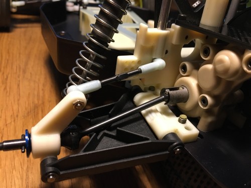

“The CVA have an issue also the shafts are too short, AE screwed up!” Agreed!
I haven’t been able to find any of the Associated 9911 or the Associated B2 universal joints for a reasonable price. They may be more available in EU?
Another possibility might be using Yokomo 60.5mm Rear Universal Bone YOKZ2-010RB and Yokomo C-Clip Universal Joint Pin Set YOKBM-010TPC.
That setup uses B4 rear hubs. Search Yokomo CVA in forums.
https://www.rc10talk.com/viewtopic.php?f=35&t=34582&p=385999&hilit=Yokomo+CVA#p385999
“The Andy's arms where designed for 0.56" shock bodies and only have the inside shock position. The geometry will be wrong” Agreed
Finding older front arms is fairly difficult as well, so to try and keep the Andy’s arms…
I think the implied geometry problem is the fact that the shocks will not be perpendicular to the arms under full compression. This might be mitigated by using the inner upper mounting holes on the shock tower.
If it is a spring rate/ oil weight problem instead of 91635 3.75 green springs, maybe 91638 4.1lb white springs and thicker oil?
I hope some one weighs in on this because I may be wrong, it is just hard to find some of these parts.

The CVA problem
The CVA issue has a free fix. Which is quite ugly.
The cheap fix is x8 3/16” shims.
Much more elegant.
More expensive: that’s with B44.2 center rear axle part 9911.
NOTE: the car in all pictures is shown in the long wheel base configuration (axles swept back).
The CVA Issue is less severe in short wheel base configuration.
I believe LWB handles better on high grip. (Astro/Carpet)
SWB handles better low grip (Dirt)
YMMV
YMMV

My transmission, I am using all of the Re-re parts for the internal gears, including the idle gear. ...but i'll look up the #'s you provided to better understand what your referring to about the mesh being incorrect.

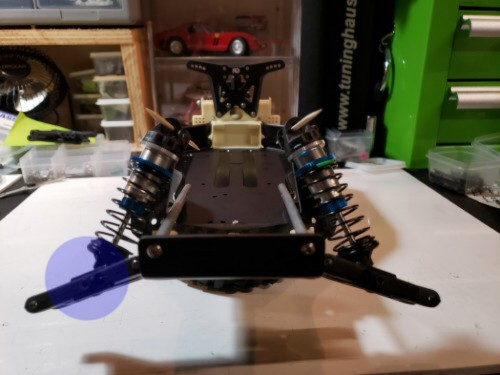

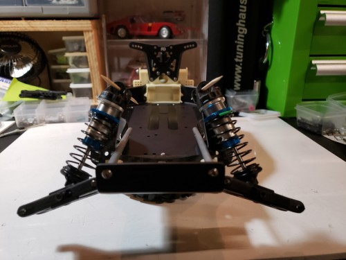

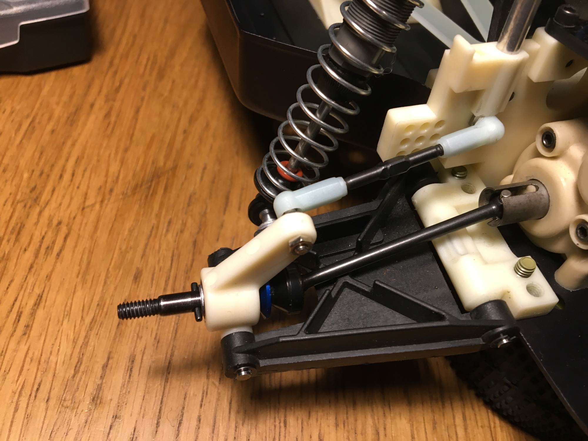

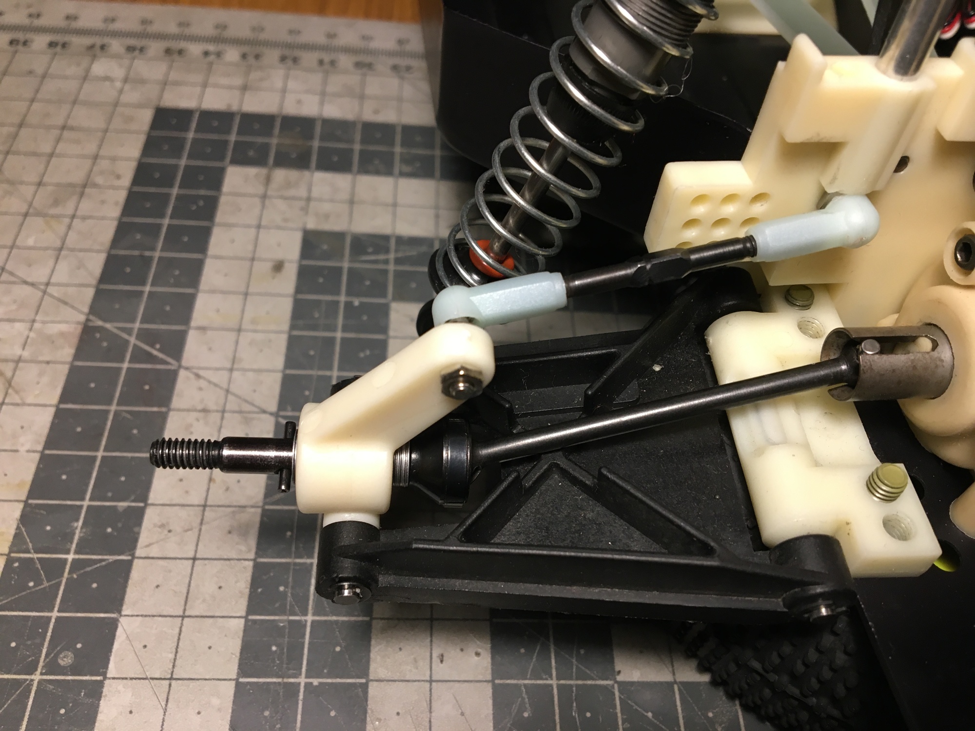

I swapped my Andy's A-arms for a set of RC10 arms, ...I am not sure if these are re-release, the packaging looks really old and I've had them in my RC closet for years...
the geometry in the front looks better, ...i have the shocks held in place w/ toothpicks for now, i'll mount them up later. Once they are mounted they'll move in a bit more on the upper shock tower (the toothpicks are allowing each shock to kind of swing out from the inner hole).

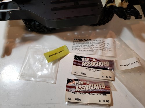

oh wow, -I feel guilty opening the packaging! ...but I guess what is the point if you just sell them or never use them.
I have a few other things in a box, i'll have to go through it Saturday when I am off.
My goal for the weekend is to get the shocks front/rear mounted up.
Looks like there are several options to run modern rims, I am exploring some of those now, including the suggestions you and others have made here.
