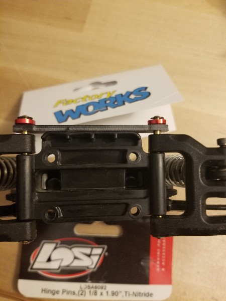

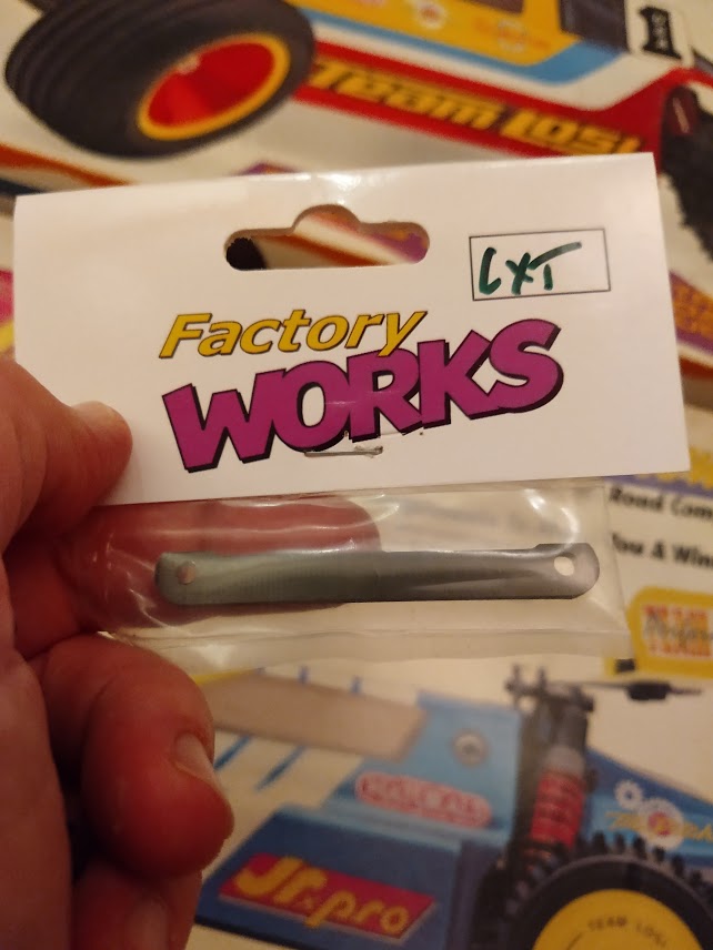

Who knew back when I had a pile of these and was giving them away they would be come so hard to come by. I would pay a machinist for a nice aluminum one. In the meantime when you find one run the factory works front brace.
You need to get longer pins, LOSA602 and LOSA5017 are options and probably others if someone has a bunch of 1/8 pins laying around from somethign with close to right length.[attachment

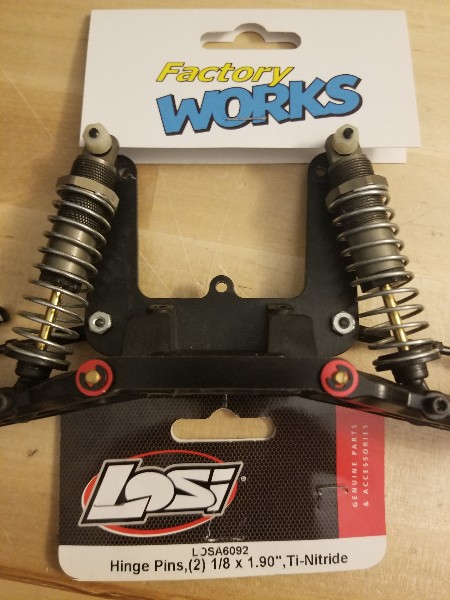

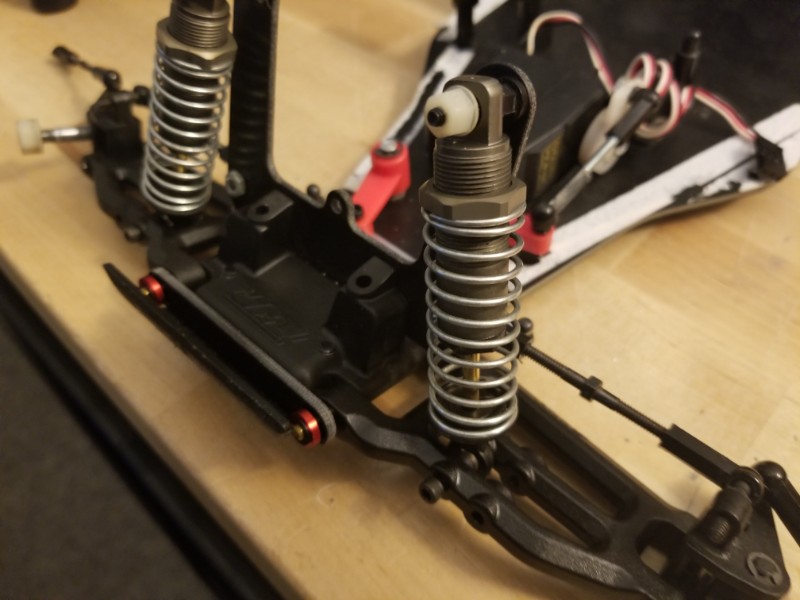

thanks again - I've located some 6092's in asia and paid thru the nose for them on ebay yesterday nite, with a bit of luck by the end of the year they should be hereRCveteran wrote: ↑Wed Apr 22, 2020 10:33 am Who knew back when I had a pile of these and was giving them away they would be come so hard to come by. I would pay a machinist for a nice aluminum one. In the meantime when you find one run the factory works front brace.
You need to get longer pins, LOSA602 and LOSA5017 are options and probably others if someone has a bunch of 1/8 pins laying around from somethign with close to right length.[attachment20200421_150317.jpgFW Brac2.jpgFWbrac3.jpg
Then I recalled that i had something in my stash... which I should have installed a while ago instead of breaking expensive bulkheads
anyway - thanks for the pointers folks. the LXT will soon run again!

I don't have any RC10 or traxxas suspension pins handy. Would be nice to know if any of those 1/8 pins or other cars may have had right length pins we could use as well. There is probably some other one out there that may be easier to source. It just needs to be close enough as you use spacers anyways. In the case of mine that is one M3 conical washer slipped on each side.

I cannot think of a long enough pin from an RC10 or a TRX, at least buggies. thansk for the insight anywayRCveteran wrote: ↑Thu Apr 23, 2020 8:23 am I don't have any RC10 or traxxas suspension pins handy. Would be nice to know if any of those 1/8 pins or other cars may have had right length pins we could use as well. There is probably some other one out there that may be easier to source. It just needs to be close enough as you use spacers anyways. In the case of mine that is one M3 conical washer slipped on each side.

Also check your shock shaft stash. Can run a nut on one end and clip on the other. People will think it’s custom

JEff - yes, the second reference quoted by rcveteran above is indeed a shock shaft!
