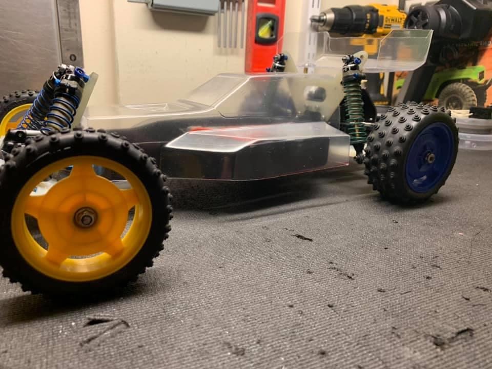

Hacked and Mocked the body I got from eBay, not my favorite thing in the world, but it’ll make a good runner/basher body😁

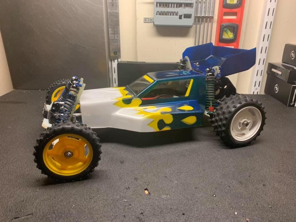

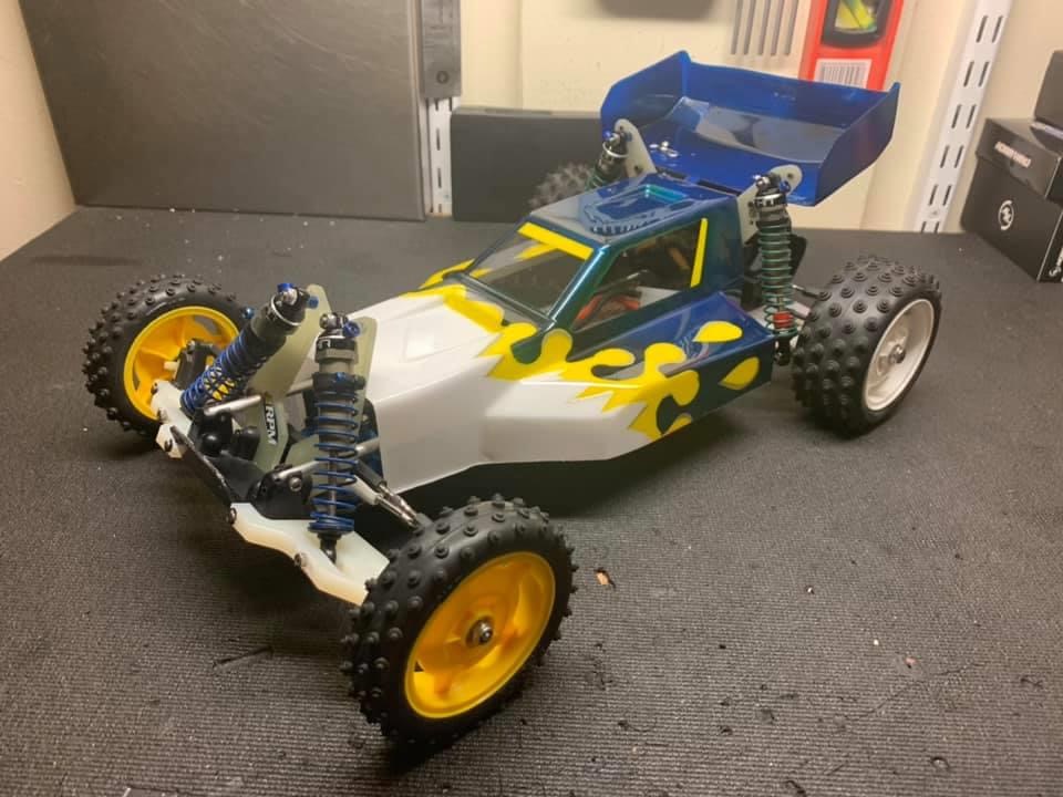

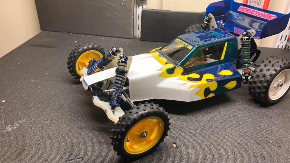

Here it is, all painted up😁
I wish the yellow paint matched up better with the wheels, but that’s Ok👍

I think your under-body electronics should run very cool. :wink:
Anyway, the car is unique and I think it looks great!! :D
Good luck at VONATS.

Tell me about it😂😂😂
I’ll be on the lookout for a Viper body, it’s a lot tighter against the chassis....this will do for now😁

Looking good. What are the tires on the front?

Biz73 wrote: Mon Jun 08, 2020 12:18 pm Looking good. What are the tires on the front?
Traxxas Rad2 2.15” tires

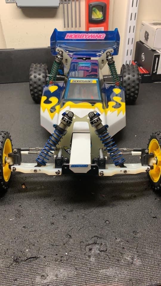

Gave it a bit of a nose job, it was feeling self conscious, so it got a bit of plastic surgery😂

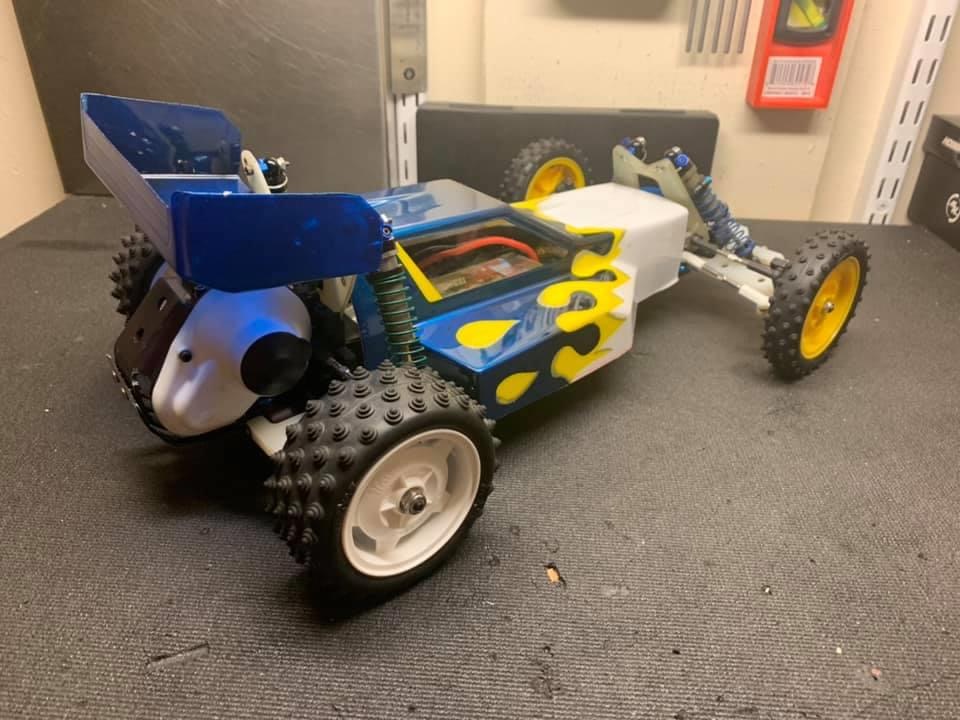

Added Electronics:
Hobbywing 13.5t Brushless Juststock Combo

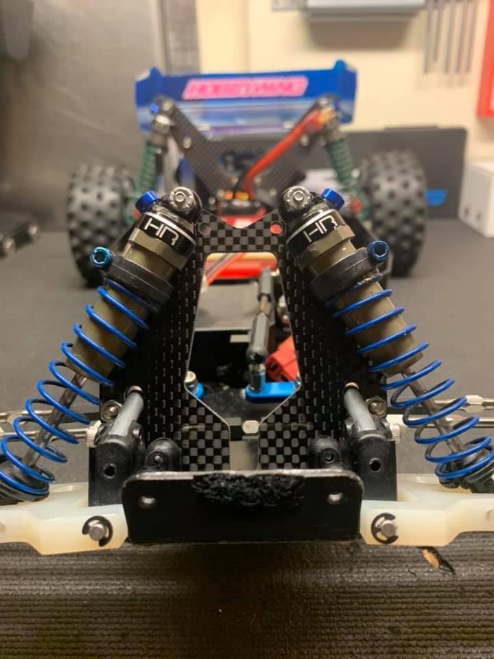

New Carbon Shock Towers
Re-arranged the electronics 😁
