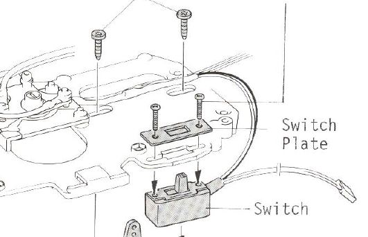

The Tamiya TBLE-02S esc has a large on/off switch that wouldn't stick with the small piece of double sided tape that will fit on the chassis. I am going to have to figure out how to mount it.

The original's top plate had provisions for mounting the switch but this wasn't carried forward to the new car.
I really haven't found an easy way to remove the body/cage - it's a pain. Fortunately, it isn't required for battery replacement.

Tamiya cars are made for the big switch, other brands are made for the smaller style switch. I've had to rig up mounts for both types of switches depending on car/esc combo. I'll have to see if I can get creative and make it work on this one. If I can get together some money I will try to get a different brand of esc. It will work out one way or another.

My power switch is smaller, but I mounted it here:
With your switch being larger, you could attach it using 2 pieces of servo tape...1 on the bottom of the switch & 1 on the side up against the wing mount.
I agree the body is tough to remove, but as stated above it really isn't necessary to take it off much. That is one advantage of the factory battery placement...I usually charge the battery with it mounted in the car.

Nice! I have to pull the top deck to re-do some of the wire placement so I will look into mounting the switch there. Thanks.

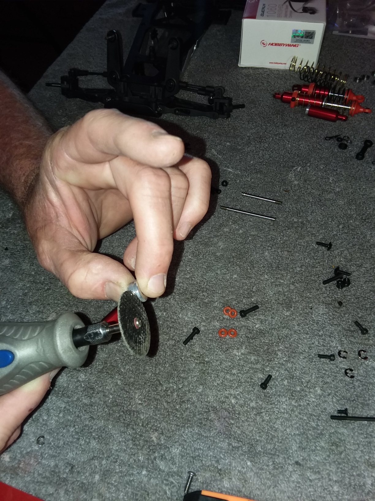

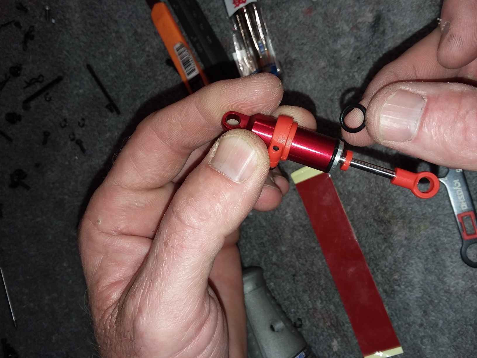

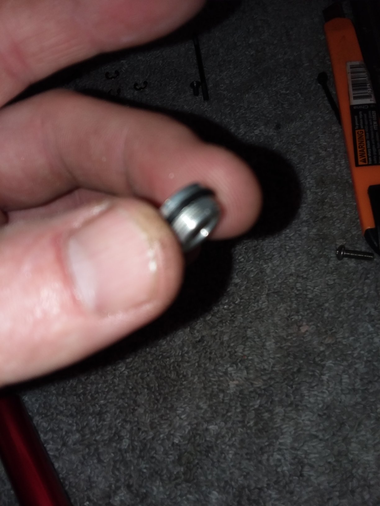

Here is what i did to red shocks, works awsome, no leaks, no air, simple to bleed too. Use a dremel and file round around the threaded aluminum piece where tye teflon seal used to go. Put an oring in the new groove created, finger tighten and enjoy! These are now one of my favorite shocks, i used to hate them.

I really dislike those plastic gaskets so replacing them with a simple o-ring is a great tip! :wink:
Makes me wonder why Kyosho didn't do it this way.

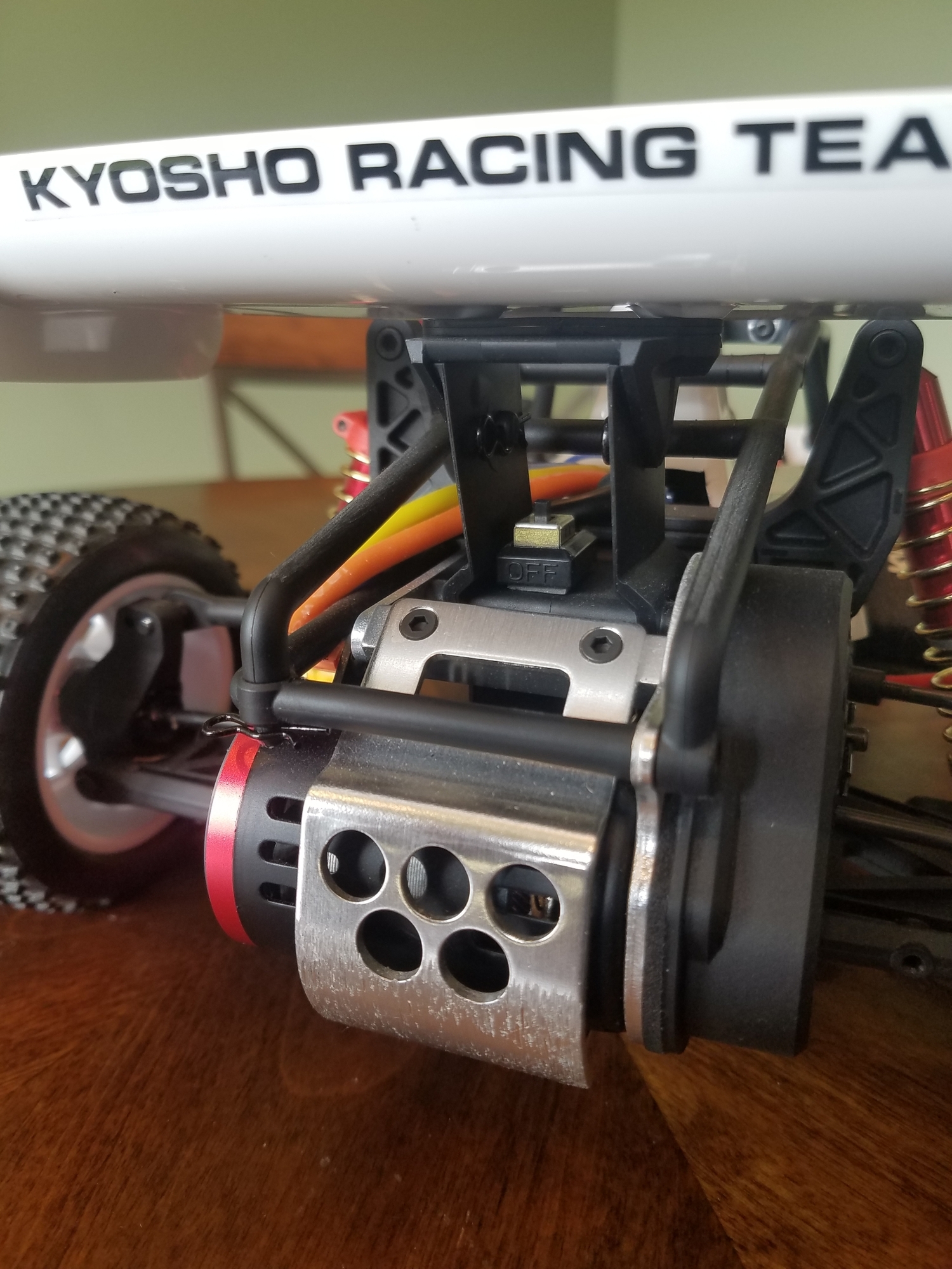

Here is my opinion of this re released car after building it. It was my 1st car i raced in 1987 and i am not a fan if this one. The tires are terribly small, nothing like original. Rear shocks work awsome with my mod but do not fit look of original at all, way too tall. HATE shock towers. Rear motor gaurd doesnt look authentic, needs to be way darker. I am going to replace everything listed above with original stuff. Kyosho needs to do more like tamiya with rere kits and stay closer to original.
