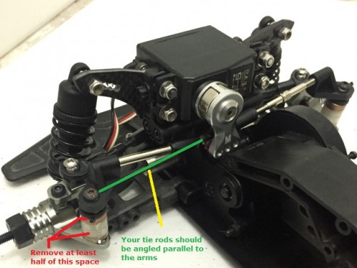

Germano, although I don't have a Mantis, principles for reducing bump-steer would be the same for most cars. Looking at your pictures, it seems like the bump-steer could be improved:
There appears to be a lot of spacers where the outer tie rod ends bolt to the steering hubs. It looks like much of this extra space could be removed, and the tie rods would more closely match the angle of the front arms, even if you kept that rather large servo horn. I'd change that horn to a much shorter one though, as that would help to raise the inner tie rod ends and that would help reduce the bump-steer too.

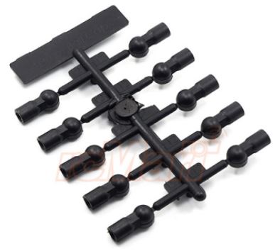

I see the outer tie rod ends thread into a weird angled plastic piece and I'm wondering if it wouldn't be simpler to just install ball-studs in the steering knuckles and pop ball-ends directly onto the studs? Like these items, 4.8mm low profile ball studs and 4.8mm ball cups. I believe your tie rods are 3mm threads, and ball cups like these would screw right on, and do away with the weird angled ends. (Unless of course those are required to avoid some kind of obstruction, but I can't see that from the pictures...)
EDIT: I do see on the right side that, with the oversized servo horn you've chosen, the right tie rod might contact the blue gear gearbox cover...but with a shorter horn, you might still be able to raise the insides of the rods and also lower the outsides by removing some of those spacers, and get quite a bit closer to a parallel angle matching the arms.

It is complicate to lower the steering links. Left side doesn't have obstruction. Right side is necessary to take care with the link not hit the gear case.
Those aluminum knuckles have different design. With the stock steering knuckles, it isn't necessary the spacers.

I'm not sure how much clearance you have between the body and the top of the steering servo, but could you also mount it a bit higher, i.e. raising the servo higher by drilling a few new mounting holes? Raising it a bit there might give you just the bit of angle you need to make the tie rod angle more parallel to the arms.
Another option, if the right side has more obstruction issues due to the gearbox...is flip the servo over so the shorter end relative to the servo gear is to the right instead of the left. Then just reverse the servo direction with the transmitter.
Servo horn would hit the spur cover 😖
But you made me remember an option I was considering when I was starting this project: flip the servo to front. This way I wouldn't have clearance issues.
