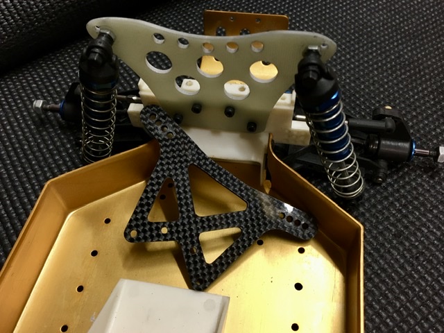

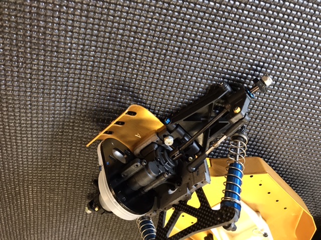

So a little update on this, I’ve been busy racing my bikes and working on the house all summer but back to some Rc now!

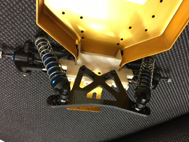

Willspeed is busy with his full time job so hasn’t had chance to draw up my ideas for the RC10 but watch this space as it’s on the to do list, this car I’m mocking up will be the show car once the parts are made

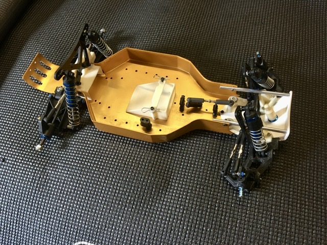

Sorted a few parts out and bought some B4 shocks/carbon towers/steering bell cranks and fitted these up this weekend
The bag is a B4 box which I’ll build up and use the Nix printed conversion parts as a stealth box costs a fortune these days!
It’ll give me the option on a gear diff too!

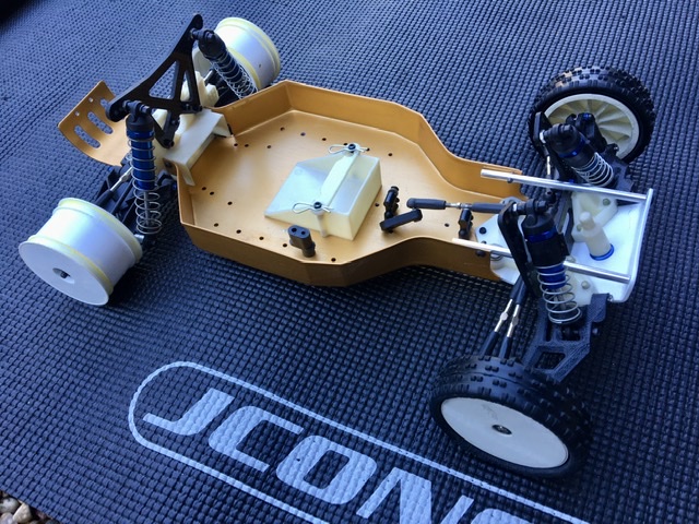

Post by Headling »

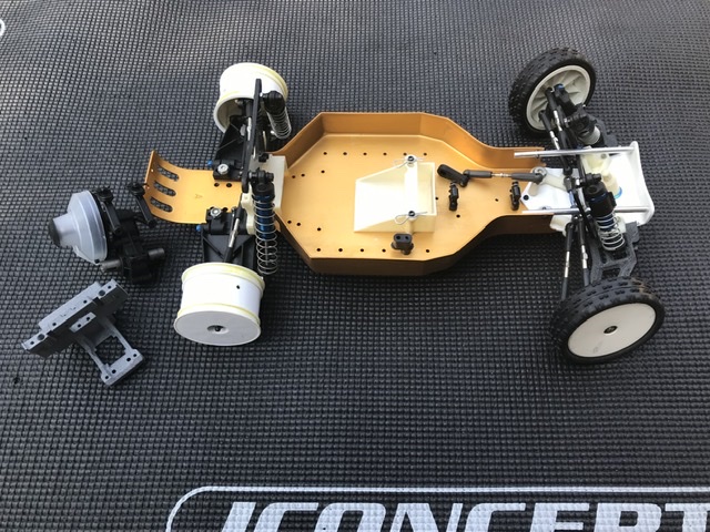

We should get a US/UK trade going on vintage parts!

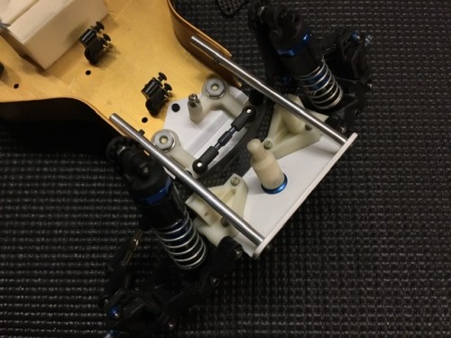

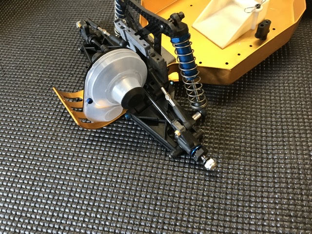

Here is the car, fitted a longer front tower as the B4 shocks are longer than the stock team shocks
Next job is to build the B4 box up and order a Nix B4 gearbox adaptor then get it stripped back down for powder coating
If in doubt go flat out!

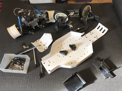

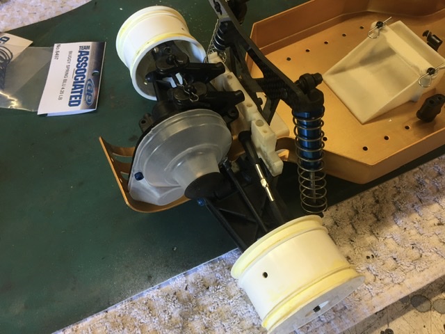

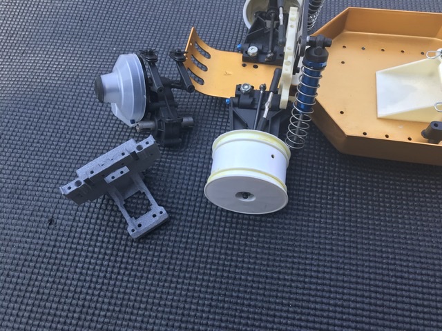

Found some 12mm hex’s in the box and mounted up some Kyosho wheels I had in my box and bolted up some B4 wheels
Nearly got all the bits for the B4 box and need to order the Shapeways adaptor from Nix

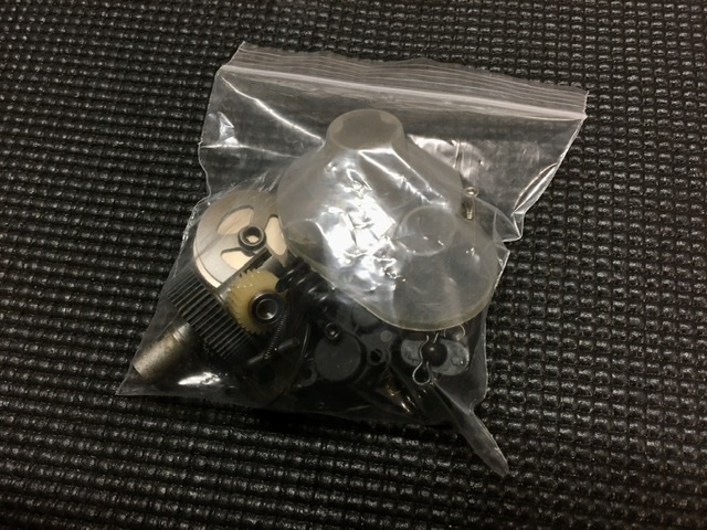

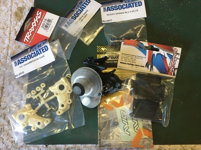

A few of the missing gearbox parts arrived and the B4 box is all together ready to go in when the Nix bulkhead arrives

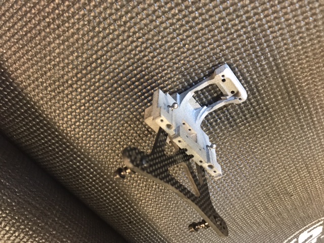

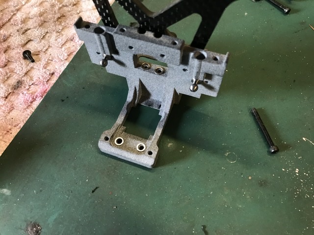

Shapeways delivery came today! Just got to decide to put a ball diff gearbox in it or a gear diff
I’m thinking gear diff as it’s going to be winter soon and I’ll be able to get some running indoors on eos carpet

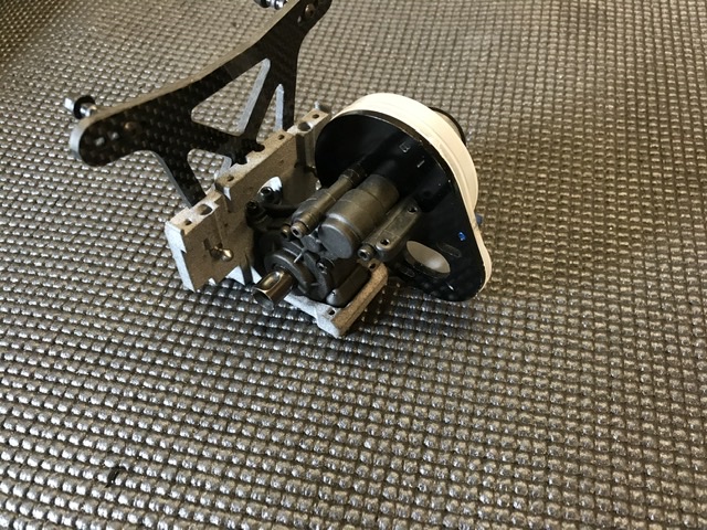

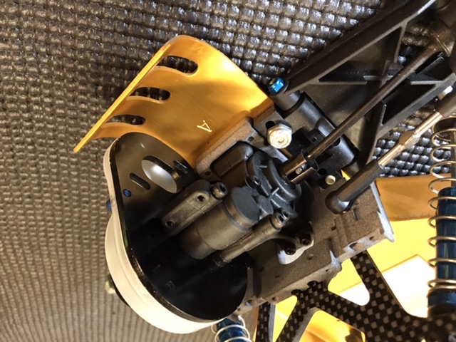

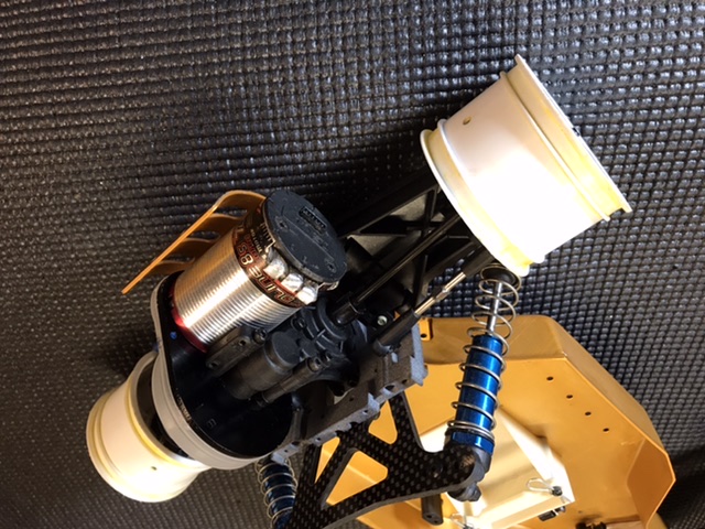

Post by Headling »

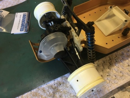

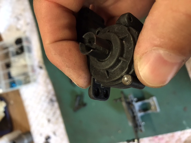

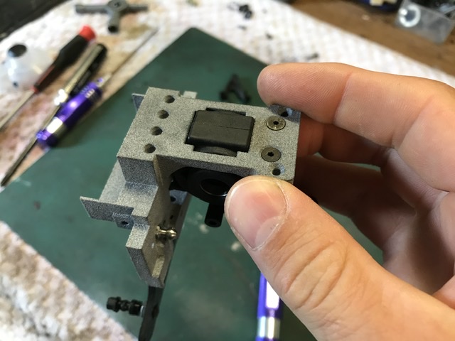

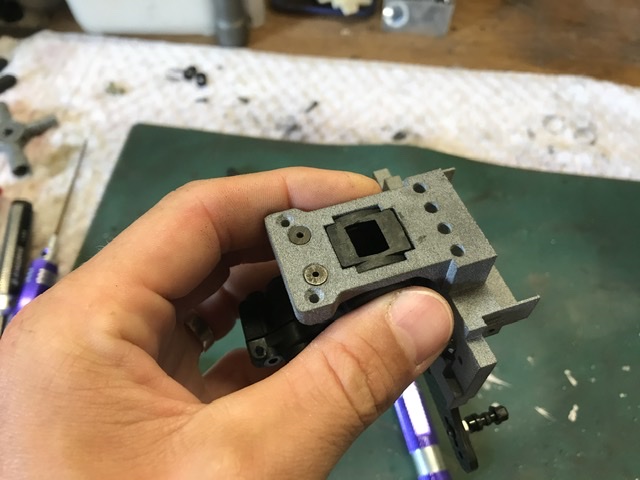

So got the B4 gear diff box in!
Had to make a few tweaks to get it in, first up you have to dremel off the lower part of the gearbox as per the pics as this sits lower than the nix conversion part, an easy 5 min job
Second job is the gearbox bolt needs grinding down to fit in the nix bulkhead, if you run the std bolt it fowls the bulkhead and the gearbox wont sit in nicely
As the gear diff sits lower than the bulkhead by 0.5mm you need to raise this up away from the chassis (you could dremel the chassis a little if you wished) but I raised the tranny up on som 0.5mm shims and this sorted it
The rest all just bolts up as per normal, its a very nicely designed bulkhead by Niki
So now its together and all the issues sorted on the car I will strip it back down and send it off to be blasted and powder coated in my trademark White

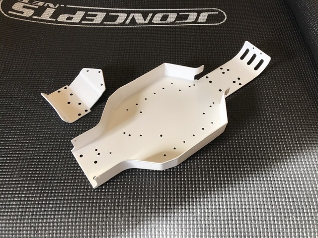

Post by Headling »
The chassis is back from powder coaters, time to build it up! 8)
