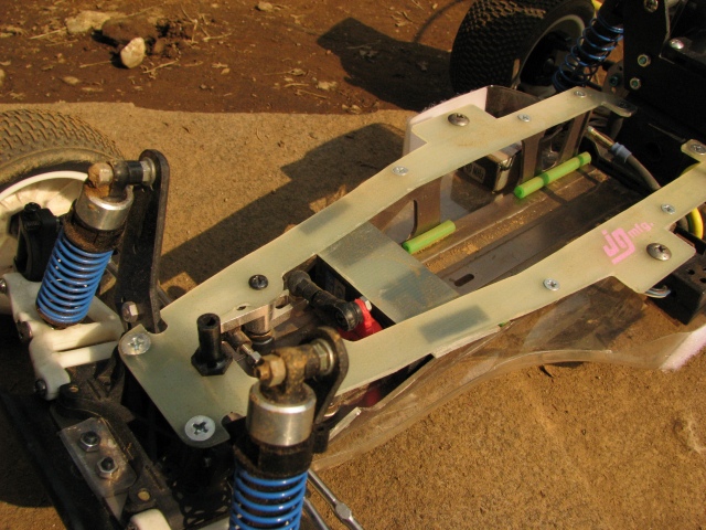

did you mean this one? i thought of that, but then i'd have to change the steering and i'm not sure what parts from what cars i can use that will fit.

B3 uses a setup like that. Same servo saver setup as the T2/GT etc steering. So you can either use the T2 steering bellcranks with the B3 servo arm or use the whole B3 setup. B3 bellcranks are just missing the extra holes you never use anyway.

how would you have mounted the servo if you wanted to use all of the battery slots and what would you have used to hold the batterys down?
for the bell cranks i would have used an old set of aluminum inline sassy chassy bellcranks. my next choice would have been a custom works or r.d. enterprises steering rack or good old b3/t3 bellcranks. as far as holding down the battery i would have used a custom works velcro strap. but thats just the dirt oval in me talking.

It looks like there's holes to mount the holder he has now.
He can use that holder and just cut the bottom part out: so the cells sit low in the slots.
