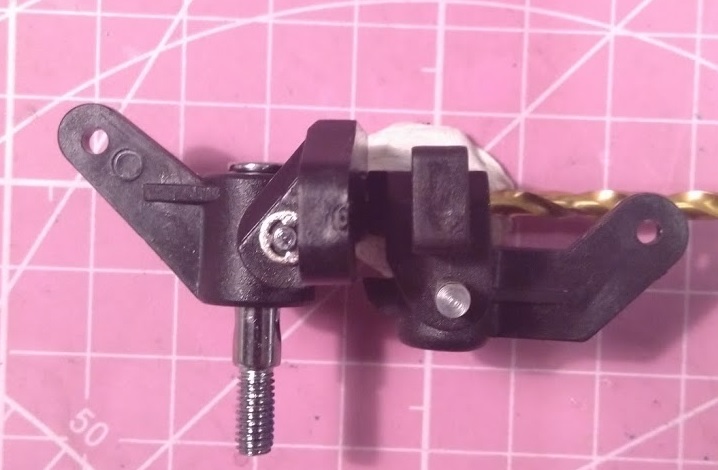

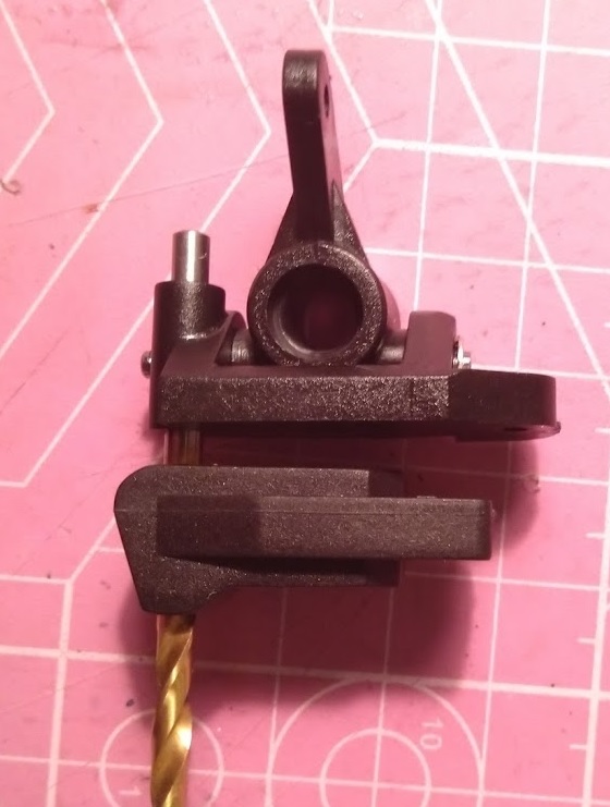

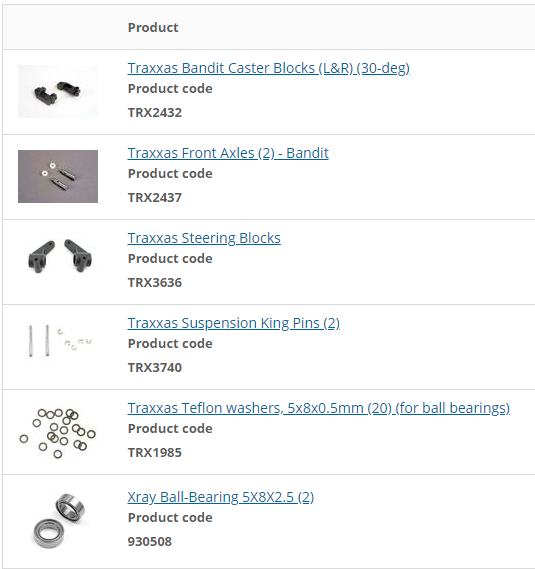

I have also RPM nitro Rustler front arms and shorter inline axles (could be #6220, can't recall now).jwscab wrote: ↑Tue Feb 04, 2020 9:43 am apologies if this is where you got the info and you know all about it already:
check this listing over, it appears its the same build list you have there.
this is from Niki's rpm style build, he does mention the wheel nuts fall outside of 250mm width
https://www.rc10talk.com/viewtopic.php?f=35&t=40129&p=451764&hilit=rpm73282#p451764
It's a hair over 250mm, so not excatly "legal", but doesn't affect club racing.
I am currently doing a hex conversion and took a route to utilize traxxas bandit parts as those seem to narrow the front end few mm and that is even configurable with different hex adapters. (not sure if I need those teflon washer in this build).
C-blocks are a bit taller so it will affect camber gain, unless I move inner ball stud higher. Needs drilling front shock tower.

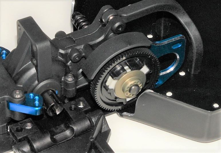

Have you tried fitment with both the rear arm in place as well as the spur on the right side?
I initially thought it would clear when I used a B6.1 laydown in my B1, B4, B6 build. Unfortunately I had clearance issues.
I wound up using the LWB and a 72t spur. Could probably go up a couple teeth on the spur and still clear on mine.
I don't know if you saw my attempt to build a mid motor RC10.
My build shows some of my problems and solutions. https://www.rc10talk.com/viewtopic.php?f=35&t=44231

I have not, I'll probably have some issues since the Bandit arms are a bit beefier around the hinge pin holes than the stock AE arms, I did move the arm mounting holes back a bit though on the chassis plate, so maybe I'll get lucky.radioactivity wrote: ↑Sat Feb 15, 2020 11:25 am Have you tried fitment with both the rear arm in place as well as the spur on the right side?
