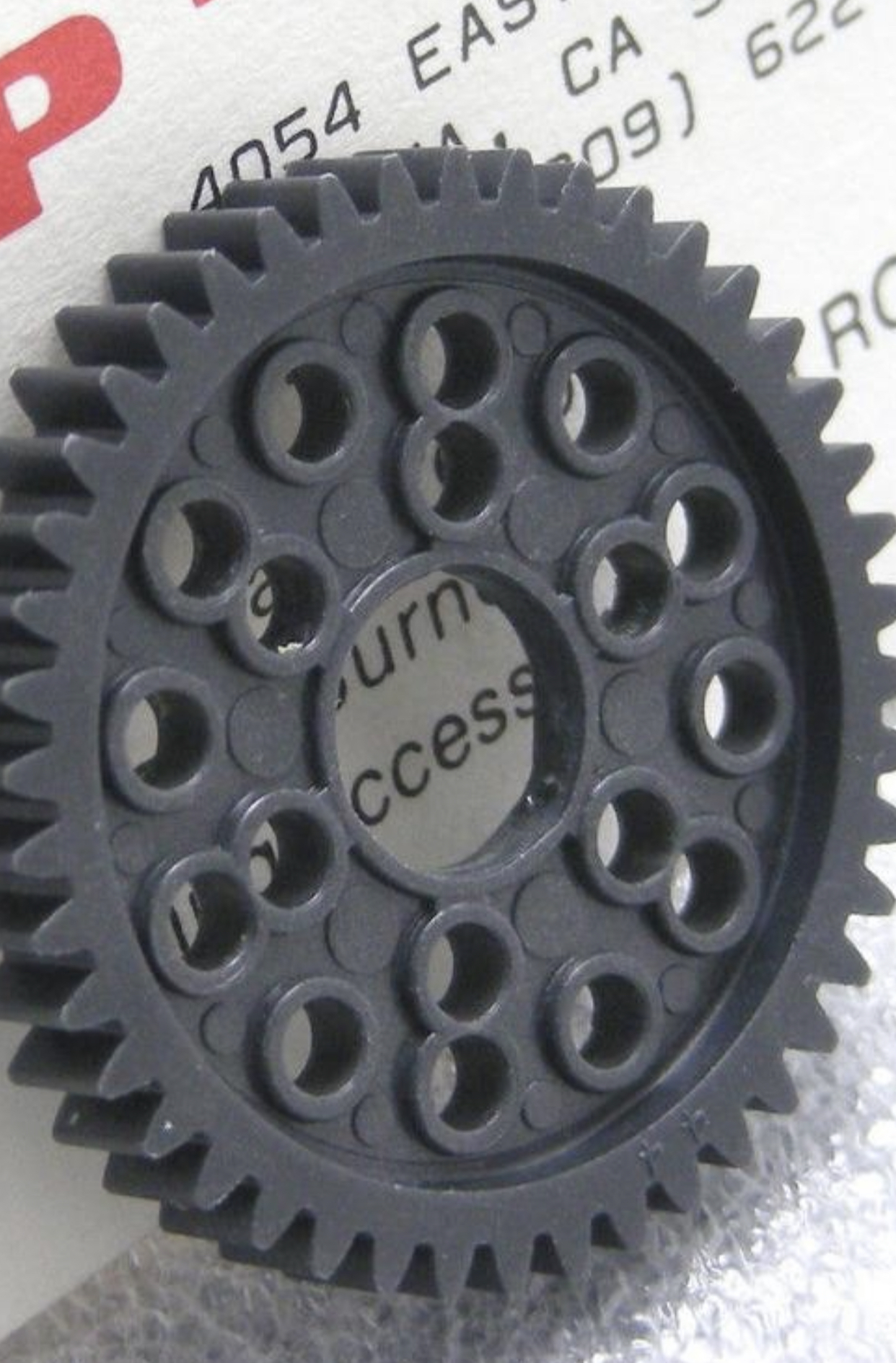

The thorp 5200 diff uses a 5202 diff gear which is a 44t 32p gear. You might be able to Frankenstein (ok Frankenstein’s monster but that is another debate lol) something together since that is a relatively easy to find size gear.

What size of idler gear would one use in combination with a Thorp 5200 differential? I ask because by my count the stock differential uses a 47t gear with unknown (to me) pitch.

Oh that is strange.... it should have been the same tooth count. You wouldn’t change the idler
