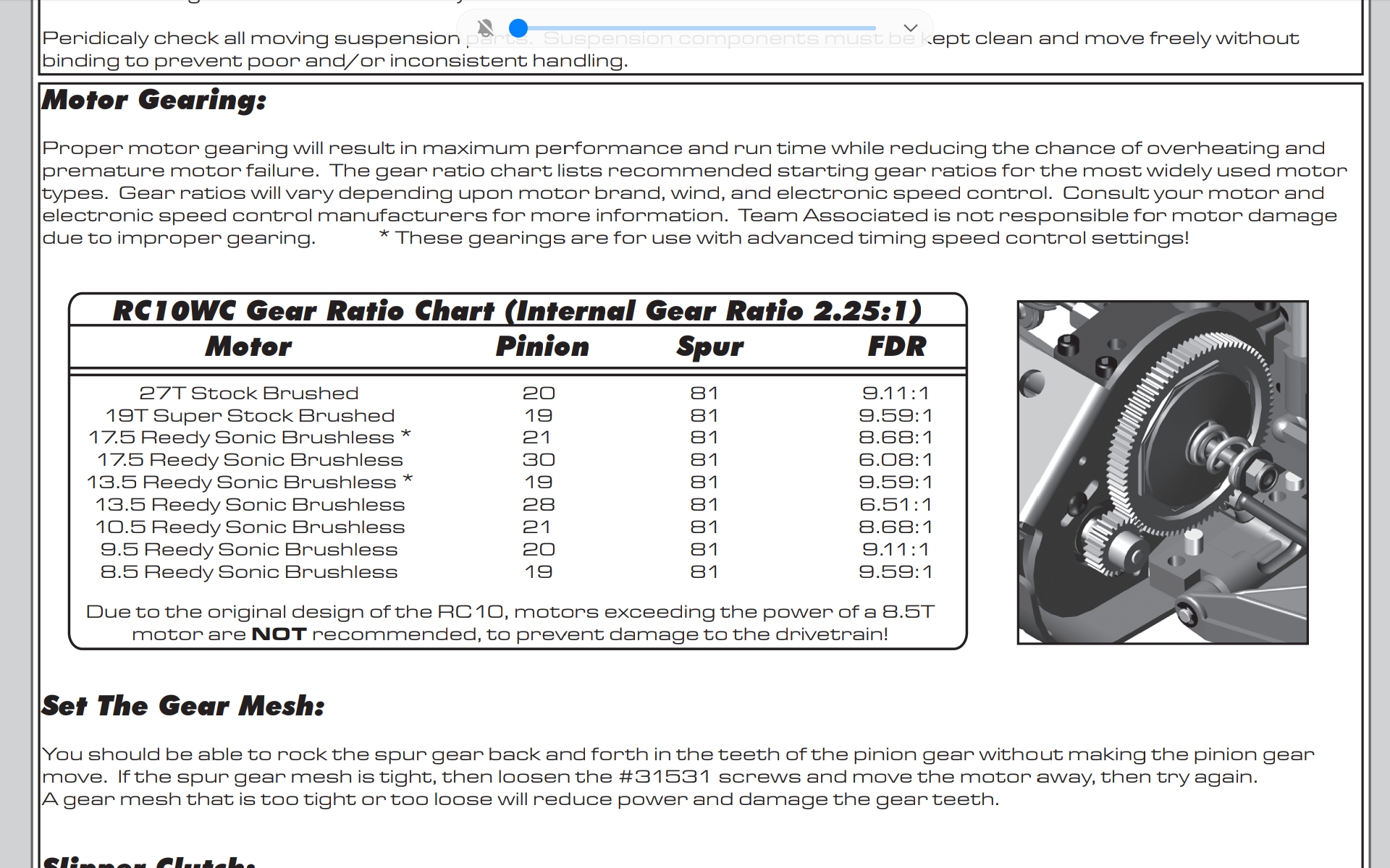

Here are the baseline recommendations from the manual.
Other than a little less top speed, gearing down a little has no disadvantages. The motor will run cooler and likely last longer. Run times will be longer.

Thanks but I did see that.
Wasn't sure how my 21T compared to those specific Reedy motors on the chart. Figured I would start with a 19 pinion because my motor seems to be the closest to that listed 19T Reedy Super Stock.
I'm just curious of the real world results of going up/down a pinion gear size based on my setup above. Like what scenarios would I want to go up or down a gear size? (examples...poor acceleration or top speed, issues with traction on acceleration, etc...)
