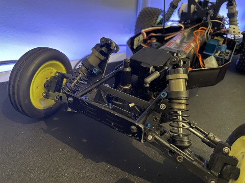

Hi all, I recently got my original RC10 ten worlds back up and running, but am struggling with the front suspension.
Original shocks and black springs, new oil and I stripped them down and rebuilt them.
All looks good, but I get next to no rebound at all.
So I wanted to try some harder springs, but can’t find any originals for the life of me!
Can anyone recommend any aftermarket springs that will fit? Ive found loads of big boars, but not sure what will fit and be firmer in the UK.

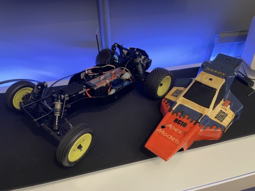

A couple of pics attached as well... just excuse the shocking paint job that’s now turned brown... I was about 13 when I painted it and have a new body ready to go 🤣Image

So it turns out somehow I had completely the wrong shafts in the front shocks, they were about a cm too long. No idea where they came from or how they got in there... but not surprisingly, now Ive put some new, correct sized shafts in, it’s all working perfectly !
