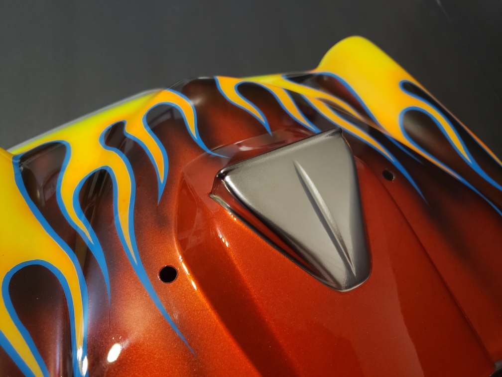

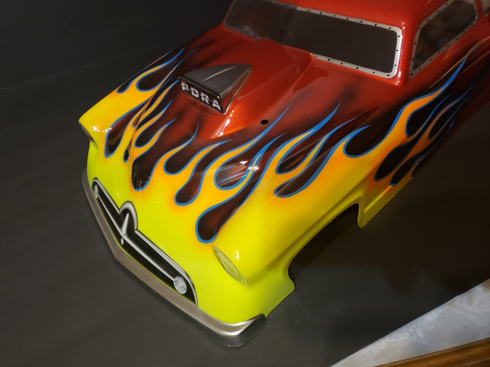

Re: Need paint advice...
The spaz stix chrome is by far the best for a "true chrome" result. Spaz stix paints have the best pigments on the market, but beware, unless it's a shelf queen, the chrome paint will chip and flake right off with any kind of impact. A close second for chrome is Tamiya ps-48 semi-gloss silver anodized aluminum. It's hard to see in these pics, but it is much more reflective and "chrome like" than silver paint. It has to be sprayed with many coats, fully dry and then back with black. It is more like polished aluminum than chrome, but is very durable and you'll never have to worry about it chipping or flaking off.
