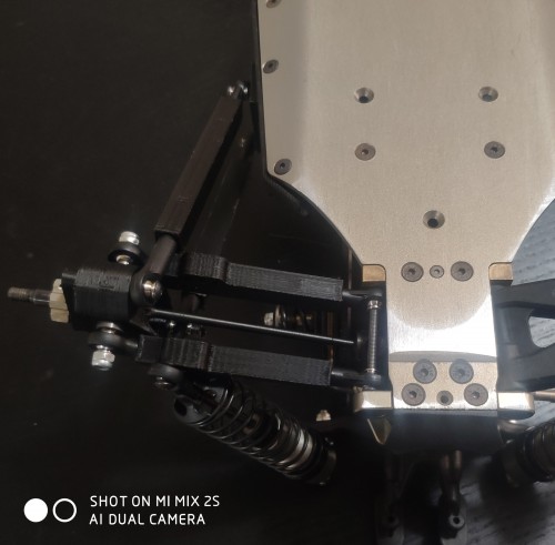

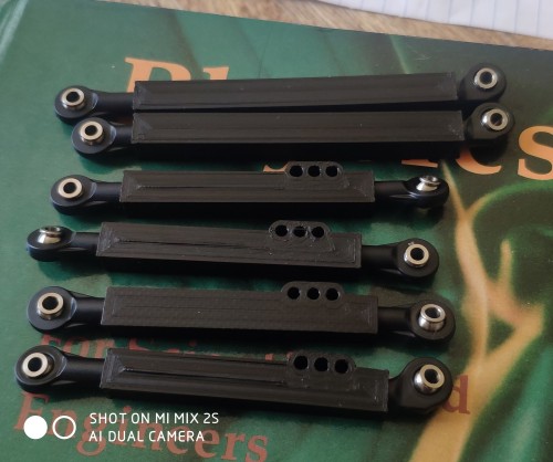

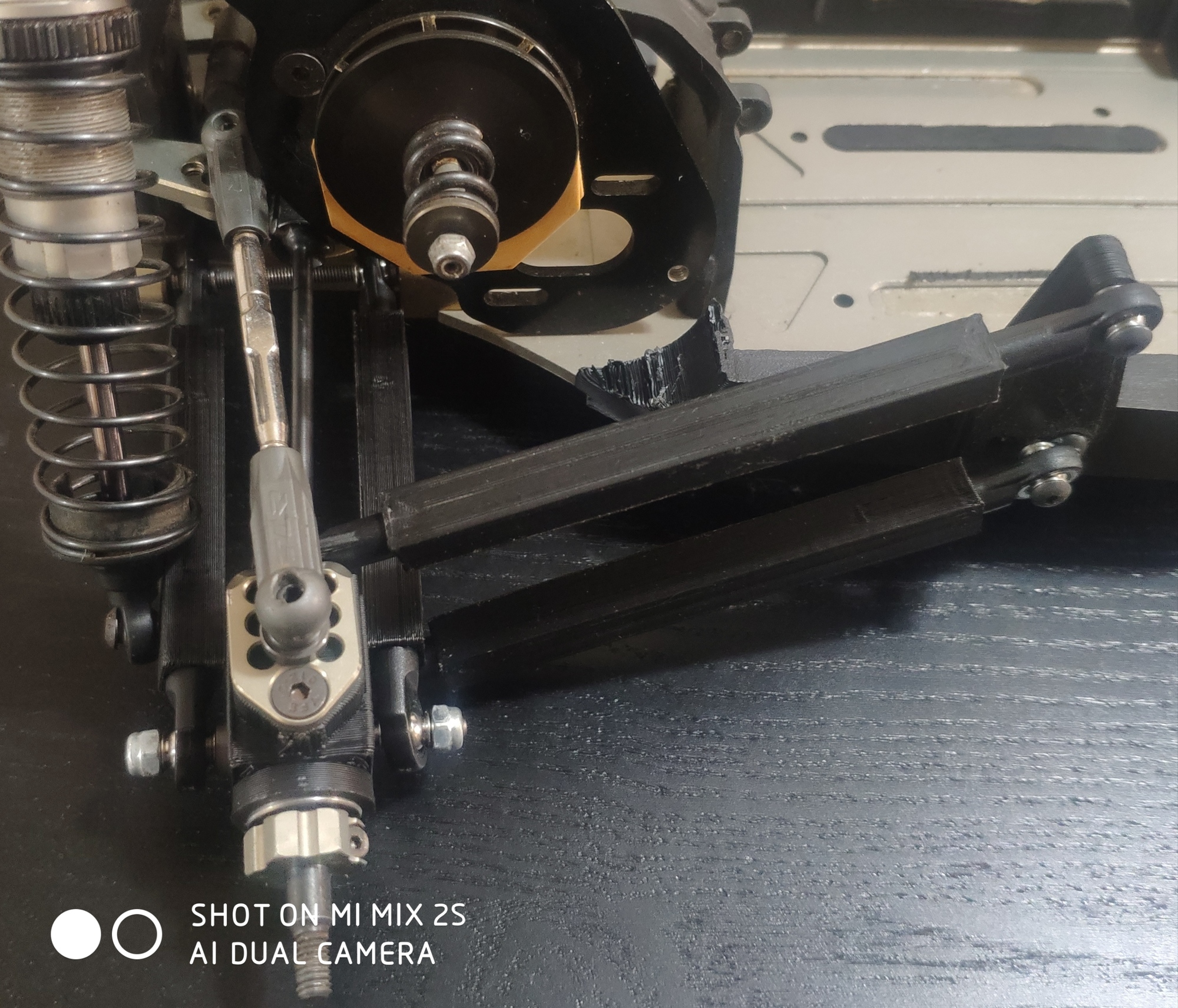

So I've got most of the parts printed just waiting on some parts to come in so I can test fit everything.
Here are some of the links. I am putting a piece of all thread through the 3d printed pieces this will hopefully allow me to print them in user friendly pla while also making them strong.
This is the new side plate I made to accomodate the link mount.

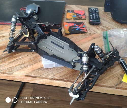

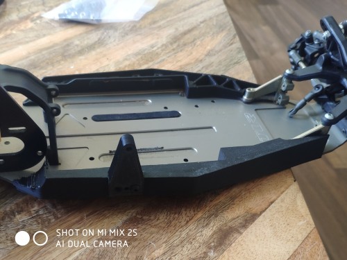

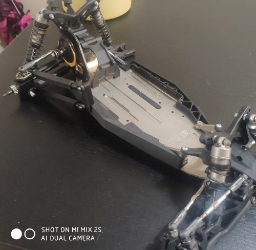

Finally got the last few things I needed to do the initial assembly of the suspension, so here it is!
Still a few adjustments to the prints that need to be made but I am close to having a roller.

Post by coxbros1 »
That is very professional looking! Nice freakin job homz!

Post by aconsola »
That's impressive, great job.

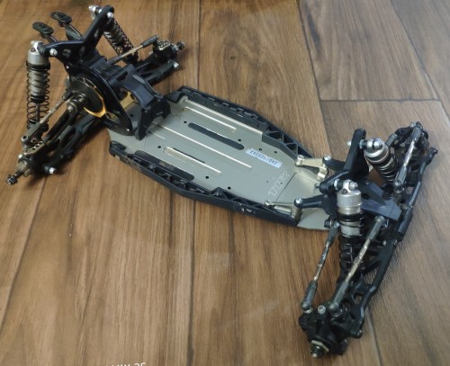

Re: Losi jrx22
Post by Dr1rrrr »
All I need is wheels and I'll have a roller! You might notice something kinda weird in the front more on that later 8) . I also need your guys suggestions on a body. So all the bodies intended for this car a cab forward, the original losi 22 had a rear cab body but I don't think it will fit this car,
so if any of you guys know a body that might work on this that's rear cab that I would love to know!

Post by Lavigna »
Really cool idea and excellent execution. I am very curious to hear how it drives.
I would think a JRX PRO body may fit with a bit of cutting. They are longer than the JRX2, but wider than the SE, which you will probably need for the trailing arms.

Re: Losi jrx22
Post by Dr1rrrr »
Thank you for the suggestion! I think I know someone with a jrx pro so I can see how that would work.
