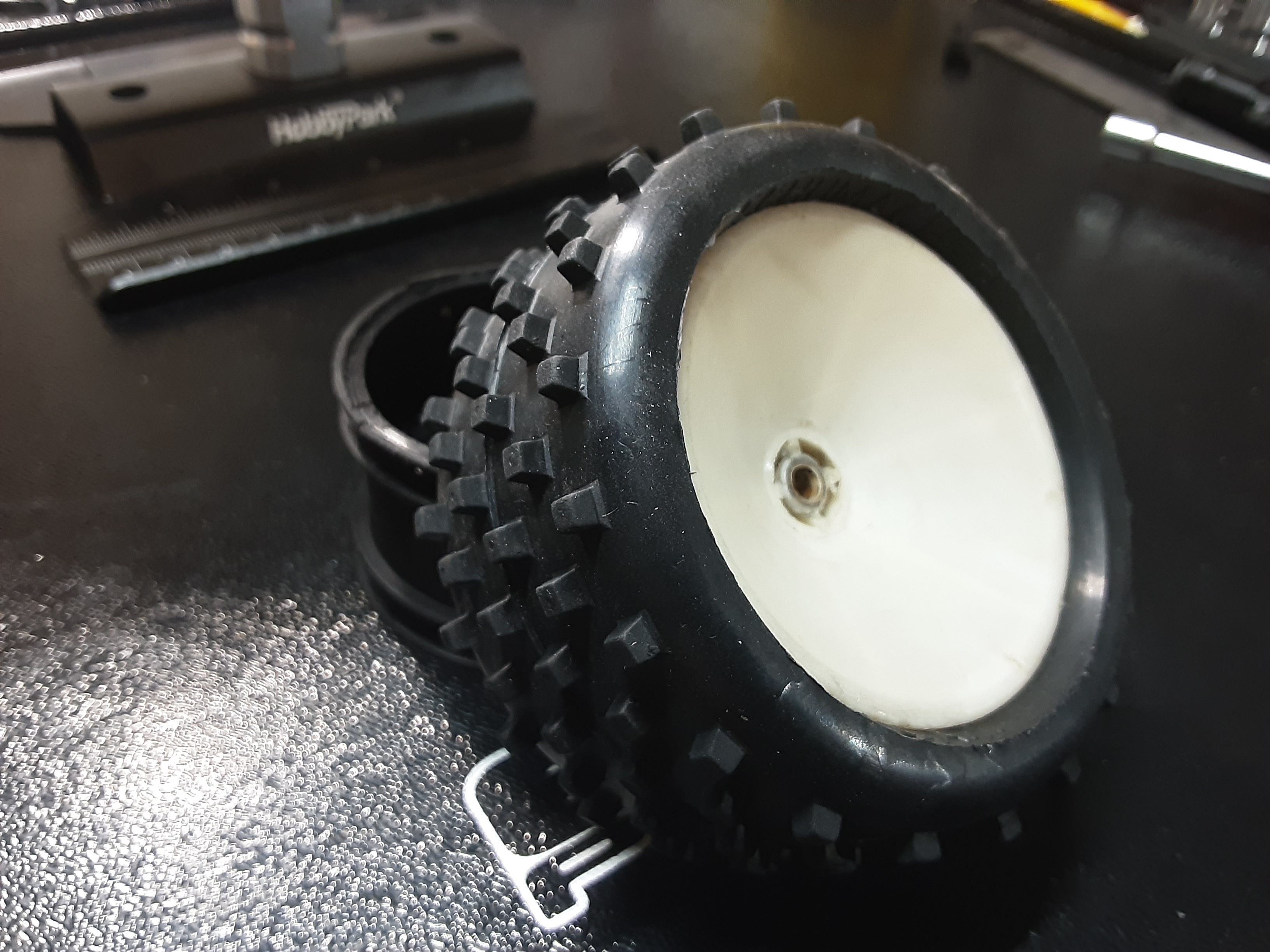

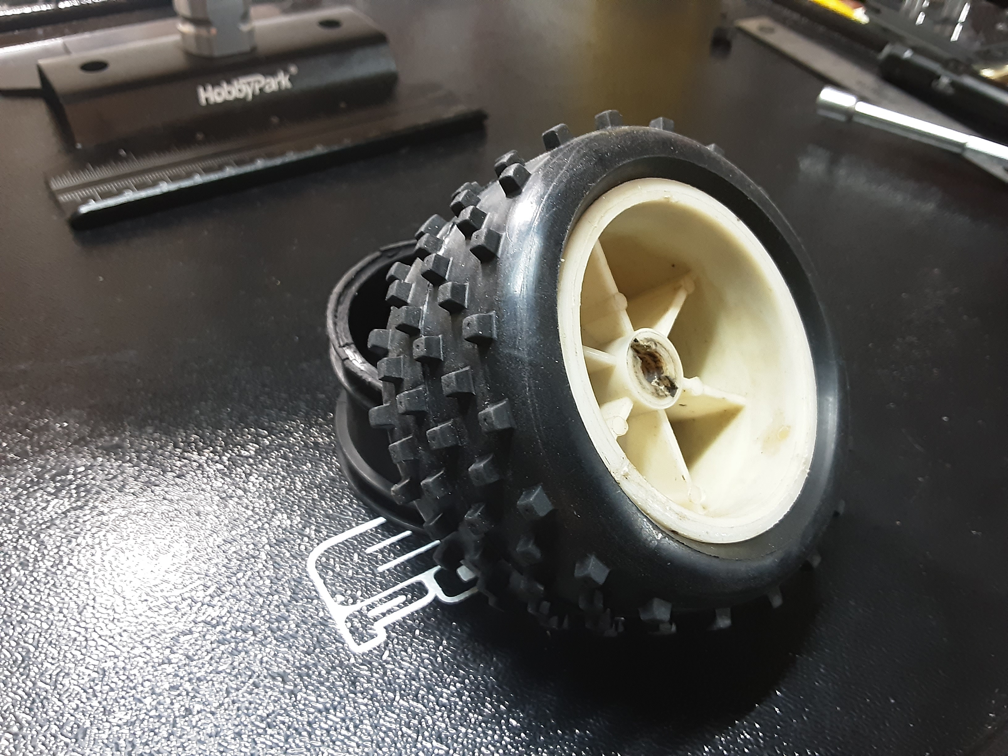

A Schumacher 6786 will fit the rears if you trim about 1mm from the inner mounting bead. I turned the tires inside-out and trimmed them with body scissors. They have a wide profile, so shock clearance can be tight at full compression if you use the outer hole.
A Traxxas 1771 fits the front perfect.
The tire and wheel pics are with a TQ wheel. The car has both tires, except on vintage Pro-Line wheels.

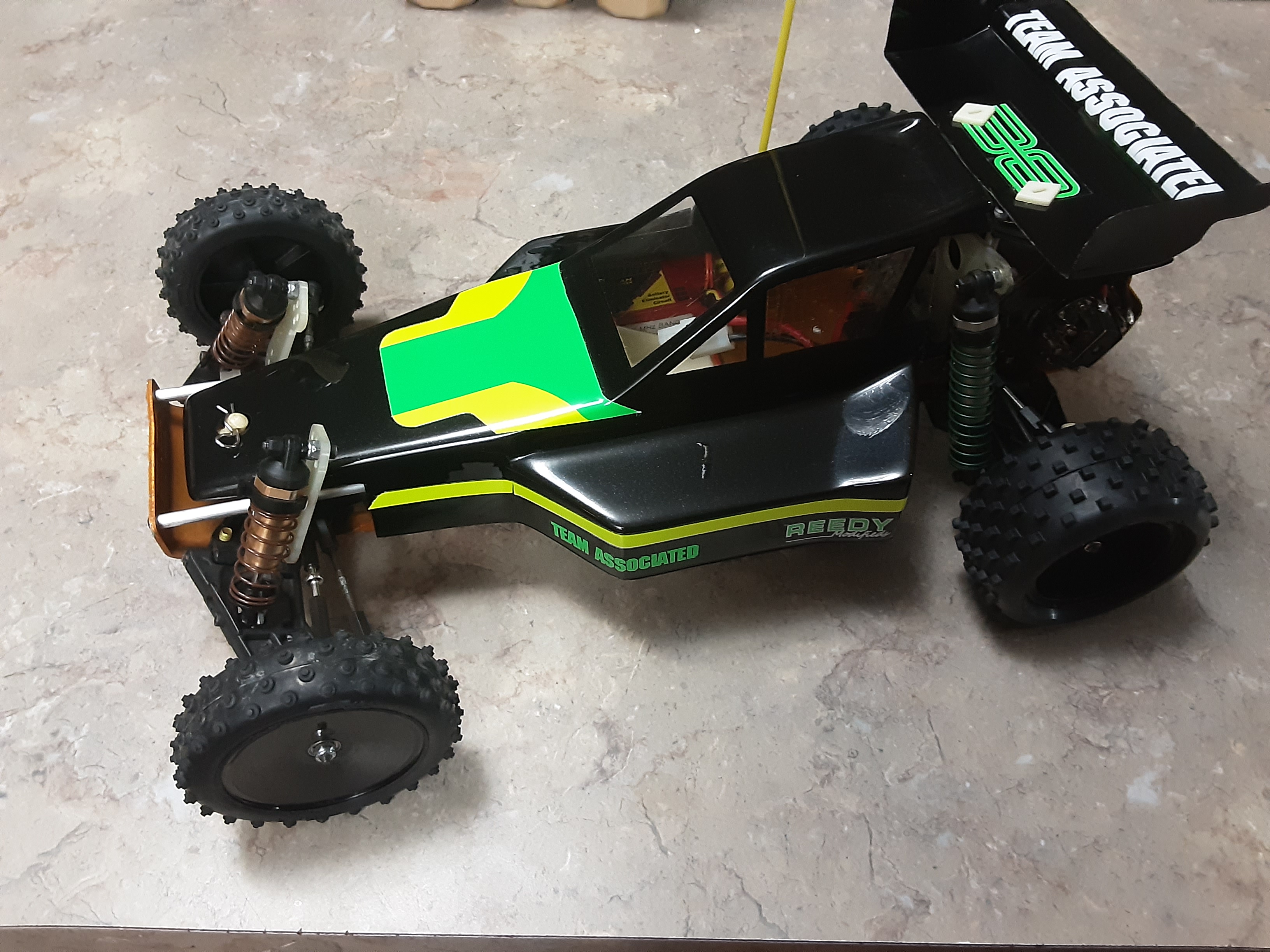

Juicedcoupe what shocks are those?
Posts: 3457
Has thanked: 265 times
Been thanked: 2039 times
Re: TQ Tires
Njpartsguy wrote: Tue Jun 08, 2021 8:11 pm Juicedcoupe what shocks are those?
Mismatched.
Fronts are gold 0.71 AE. That set just happens to be lighter colored than my other ones.
Rears are hard anodized (silver) 1.39 AE, from a T4, SC10, or some other newer truck.
Instead of the common white plastics, these have the newer black ones.
