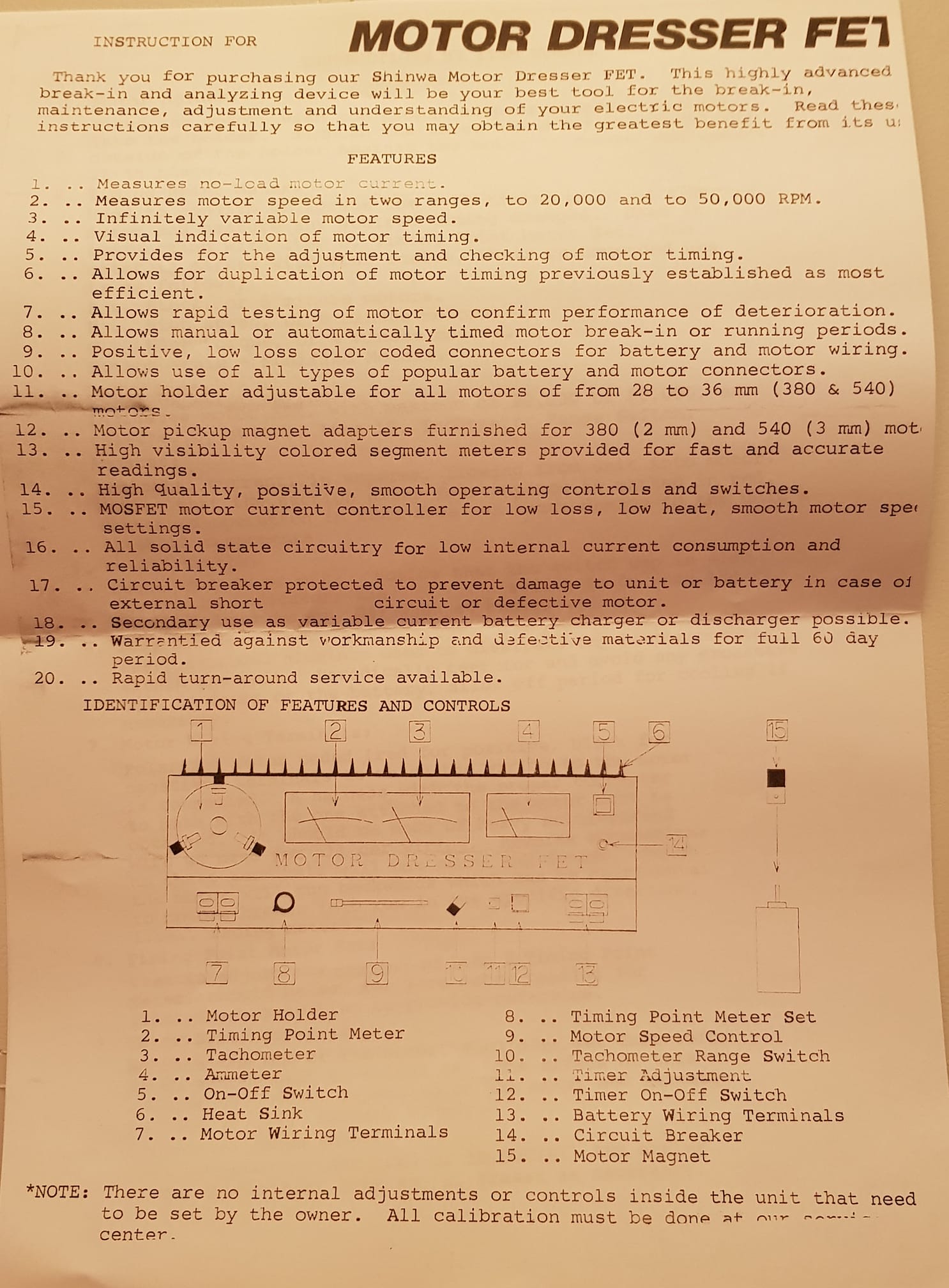

This is for the later silver/grey version.
