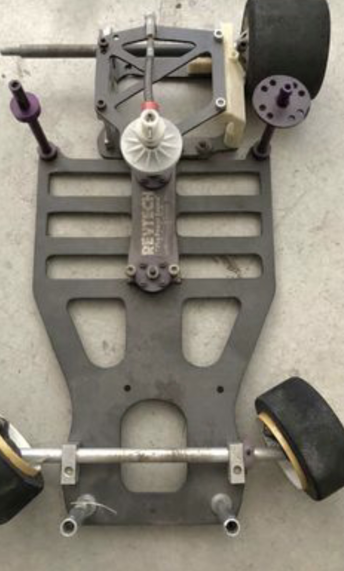

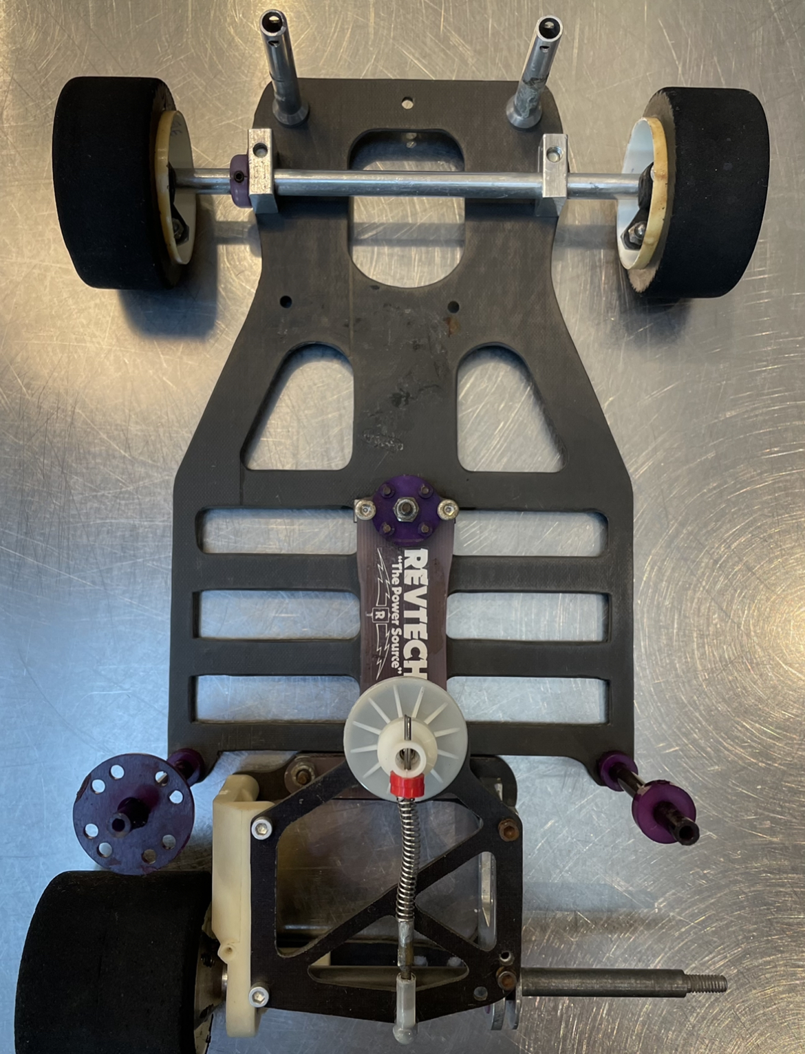

Hello, new member here. I just picked up an RC12l on my local clasifieds for $20. I’ve wanted one since I was a kid! It was missing the slipper/diff/hub assembly. I found some NOS parts and have more coming in the mail. I’ll slowly piece it together.
I was curious if anyone knew anything about this front end assembly?

That certainly does look like an RC12L rear pod, but the front suspension is not 12L nor does the chassis have 12L suspension mounting holes. Pan cars are somewhat new to me so I can't help beyond that but I'm sure the wizards here will chime in.

Doing some Googling tells me the front end and chassis is most likely from TRC, but they had their own rear pod design(s) so not sure if the chassis is from a 3rd party like Composite Craft to meld the TRC front end to a 12L rear or if it was a different car altogether. Someone here will certainly know.

Based on the Delta body mounts and that they used the same type of beam, I’d see if Delta sold a chassis conversion for the 12L

Thanks! That looks like the one! It’s definitely a 2 bolt 12l rear axle assembly. It’s missing thrust washers. I’ve ordered a handful of parts. I’ll post as I get it out together. Not sure my plans for it at the moment other than getting it to a complete roller state.
