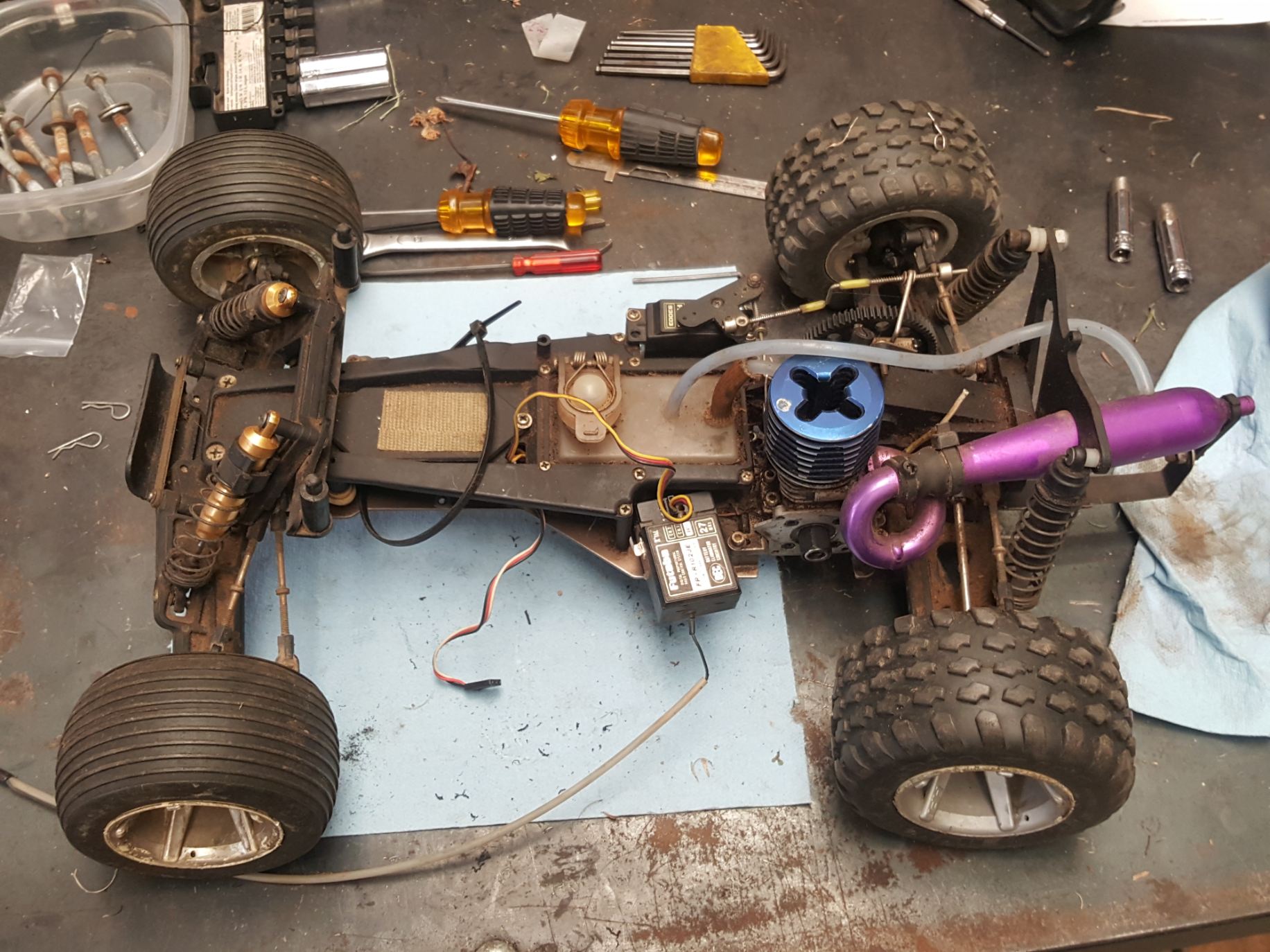

Apparently I have a Traxxas TRX .12 or .15. From a question I asked earlier it seems a Rustler is pretty close to this. Unless they are actally the same. What I want to do it to put on rear swing arms that don't toe the rear wheels as much as the stock arms. Some toe in is good for stability but the toe in on my car compared to new nitro engined trucks or cars are nearly as much.
Before I just buy a set, I was wondering if anyone here has any experience with the TRX .12 and trying different rear swing arms that might have less toe in. I have tried swapping them from left to right but it gives just a bit of toe out and not really comfortable with that. I would be happy with neutral, "0" toe in. I can measure it if it would help to compare it with other rear toe in. All of my electric cars are almost neutral with that measurement.

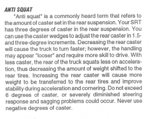

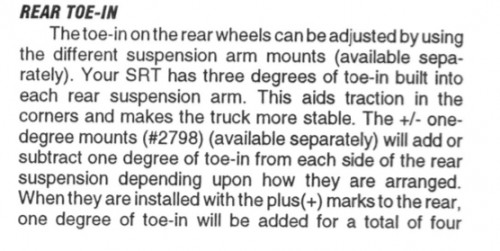

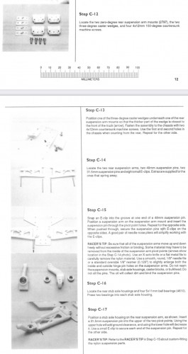

The rustler is a close relative of the SRT (electric) and uses pretty much the same rear suspension. Here are some clippings from the manual that may help.

Thanks! That is really some great info. I have the wedge pieces and the mount for the swing arm on mine has a "A" and a 1 below it. It looks like those are still available so will look into that. This is why I joined. Just good info and no saying " this has been written about a million times...", its still relevant to guys like me who are just trying to get their old stuff back up and running.

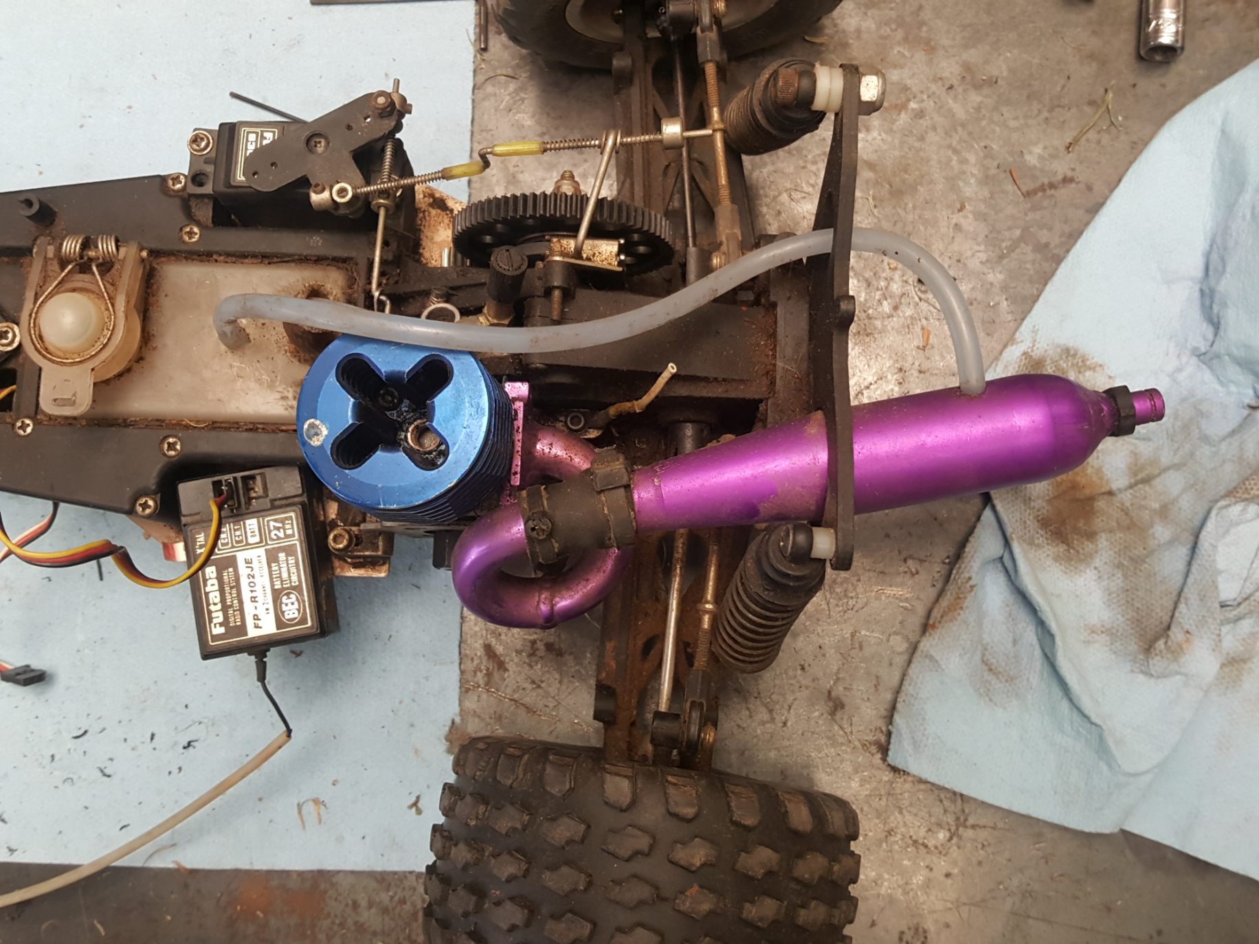

I did as suggested and got the toe almost to 0 degrees. I really don't need it neutral but thats how it came out by switching the rear swing arms. I did order some degree blocks and the 1.5 hub carrier to get the toe closer to my SRT electric truck. I am also refreshing the engine, fuel line, glow plugs, front carb seal and an air cleaner. Will post some pics someday for the the hell of it. Will be a backyard or vacant parking lot runner for now.
