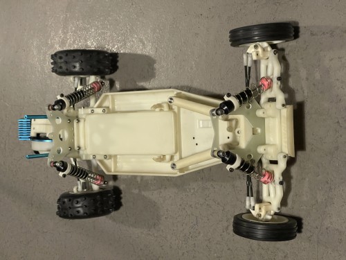

Hi all,
This is one of my current projects, coming along nicely I think but not yet finished.

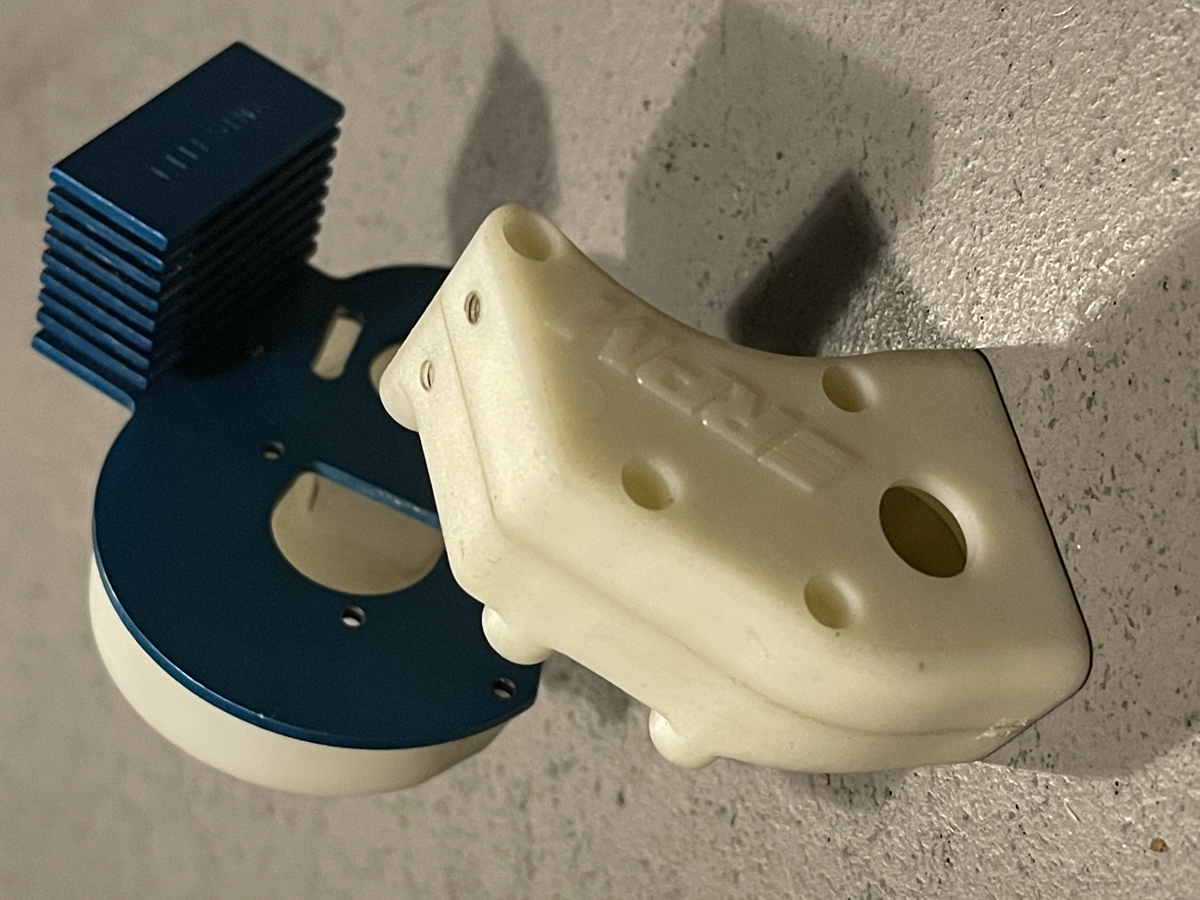

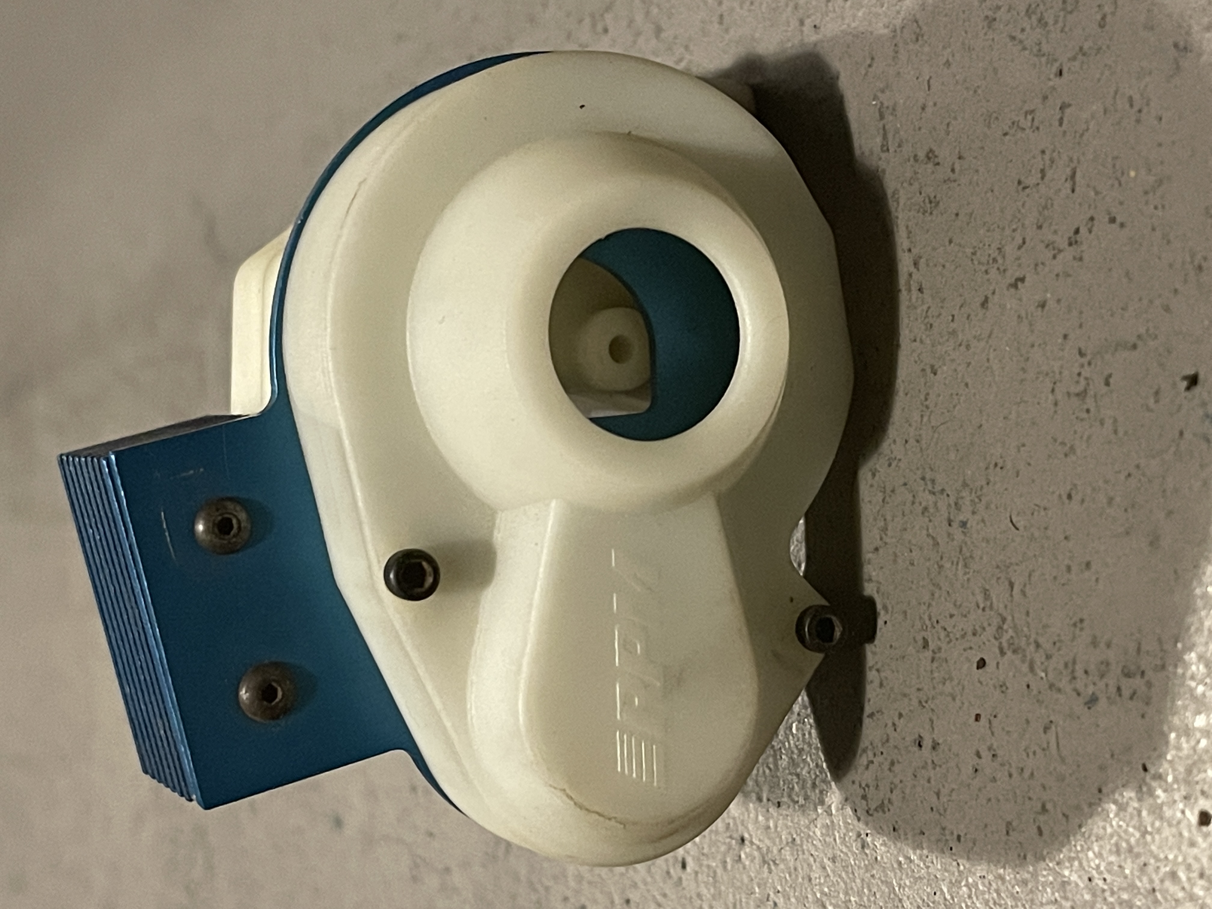

I would like to use an RPM transmission case, but that will require some work on the housing to make it fit.
You just have to love the look of the translucent RPM parts..!!!
Cheers,
HtG

looks great! Love the RPM molded chassis

Anybody know of a contemporary body that fits this chassis?
MarkyDents
Posts: 1187
Location: Staten Island, N.Y.
Has thanked: 1809 times
Been thanked: 643 times
Re: RPM molded chassis build
Post by MarkyDents »
From what I remember reading that others have posted,
It was designed to use a Team Losi JRX Pro SE body.

Jason (Scr8p) modified an RPM case to fit the narrow chassis. If I recall, he got dangerously close to breaking through the case in a few spots. I don't think his pictures were lost or anything so you should be able to dig them up.

I didn't notice it before, but I really like the look with the MRP tires. Good choice!

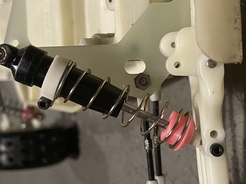

Lovely MIP shock bodies. :)
With the RPM rear shock tower the Losi Jrx Pro SE body is ideal. With a standard RC10 tower you can run other bodies even though they are a tad wider. I like the look of chopping the rear of the body off after the tower. For the front you really need to cut quite a bit to get it to fit under the front tower.
The translucent white RPM tranny is geared at 2.65:1 and was meant to be used in a truck. I get why people put them on buggies, but the Stealth is the ideal and period correct option. I like hopped up Stealth's that have Thorp 64P gears, Mip outdrives, Hydra-Drive, etc.
