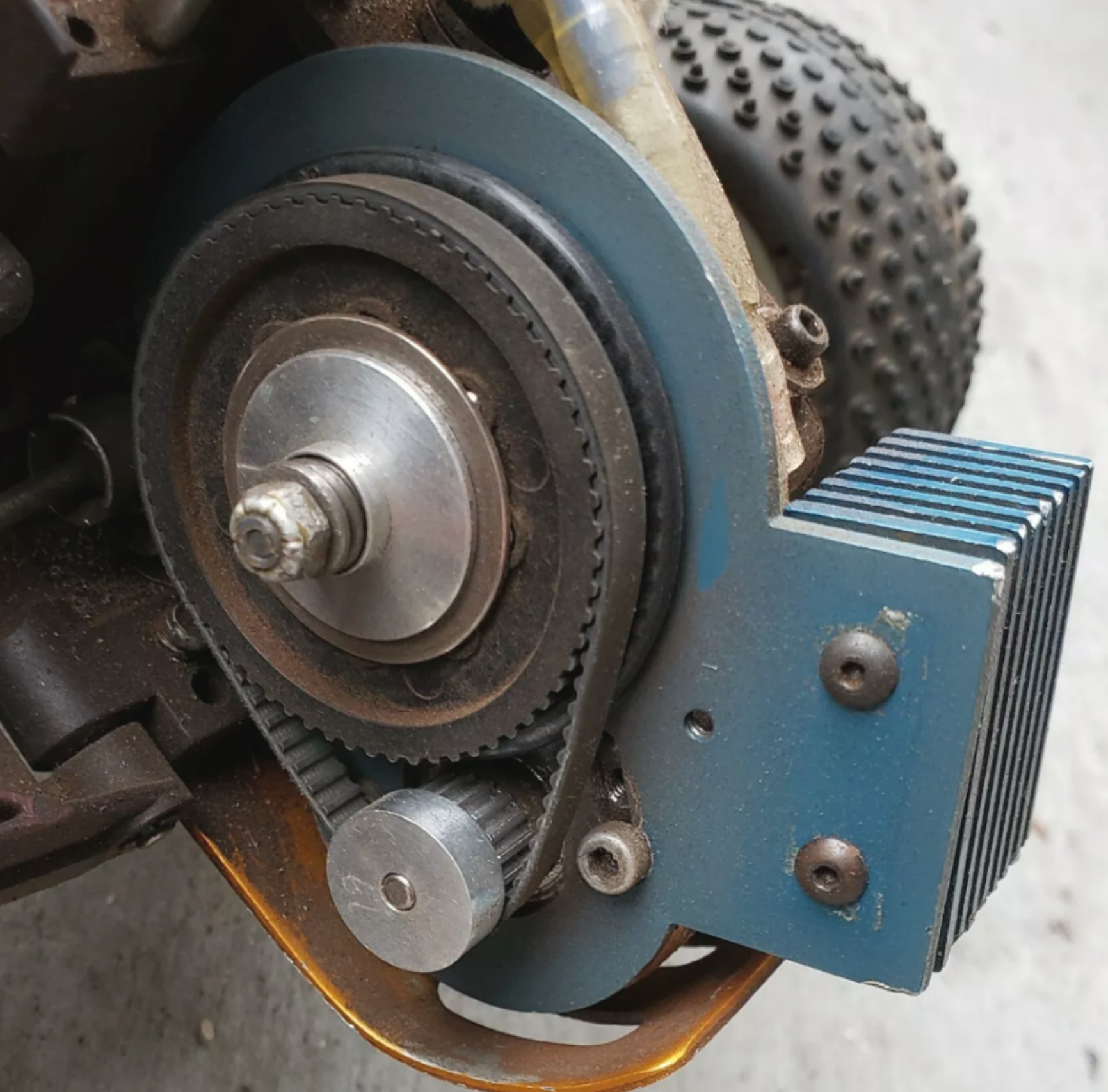

This is probably a question that doesn't need asking, but there aren't any sources of hyperdrive belts and spur/pinion pulleys anymore are there?
- Posts: 12348
- Has thanked: 1131 times
- Been thanked: 3926 times
Re: Hyperdrive conversation parts

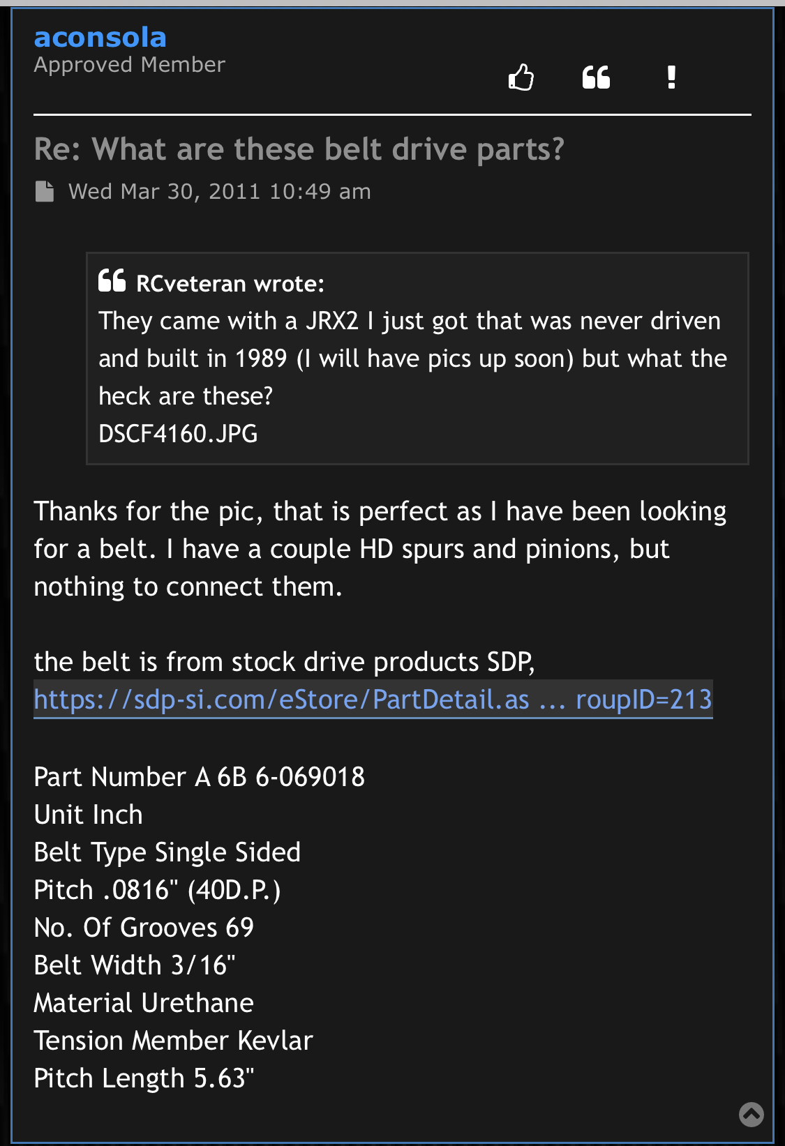

The belts carry a SDP part number and SDP-SI is still around. However the belts were cut to a narrower width than I seen listed back when I looked at this- and it was a couple years back- but I suspect in quantity they could get them in the proper widths.
Link in this is dead anyway but part number might get you in the ballpark

Much appreciated. Do you think there's any hope of finding any pinion or spur pulleys, other than just watching eBay for pop-ups?
- Incredible_Serious
- Posts: 3691
- Has thanked: 1743 times
- Been thanked: 1147 times
I'd go eBay, and keep your eyes open.... they do pop up every now and then. I was able to grab a set a decade or so ago, in a lot of other junk.... split it up and sold off the Hyperdrive parts, and somebody got to do good things with them.Frankentruck wrote: ↑Fri Nov 05, 2021 10:11 pm Much appreciated. Do you think there's any hope of finding any pinion or spur pulleys, other than just watching eBay for pop-ups?
Patience, I guess....
