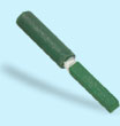

This is about the only picture I could find of one. Not much available that I can see, I liked that you could use it to clean the brush face and also polish the inside of the brush hood as well.
Muchmore look like they might have some square sticks though.
