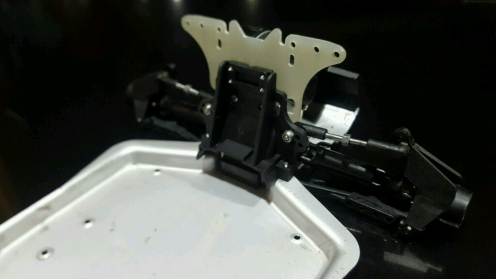

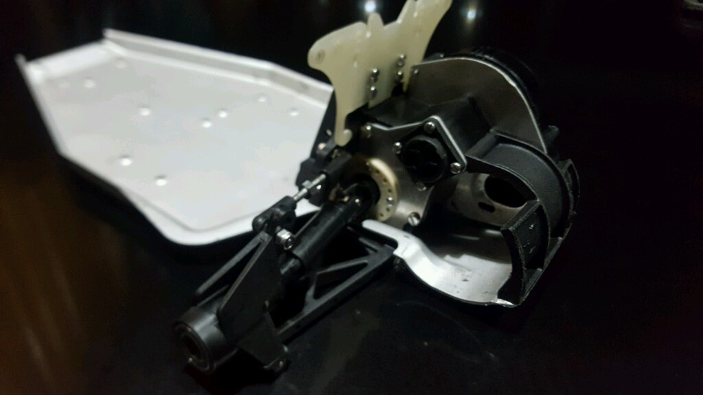

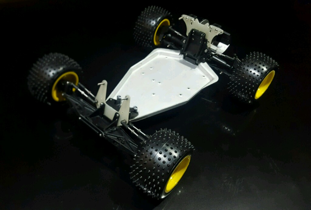

Now that I have enough balls to tackle this I thought I'd start putting it together.
It has gone together quite well so far and has been fun, the sotted screws really add to the experience
The diff feels great considering it is a strange design, and the diff adjustment is a PITA though so hopefully it doesn't need an adjustment
The chassis squared up nicely and the motor guard fits the beltbox as it should.
On to the front half

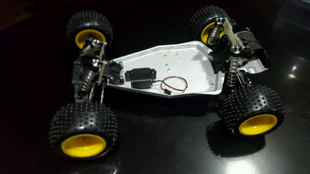

Getting closer, put the front end together and the wheels to see how well the body fit.
I just need to find some 10wt oil so I can put the shocks together and make a new front body mount. I also need some more screws

I finally got some 10wt oil and it was well........ useless
it could have worked in the rear but would never have worked in the front.
And after a long and extensive shock screwing around session I've finally got it in the ball park, not perfect yet but I'll wait and make the final adjustments when there is full weight in the car. I also need to install some 3-4mm limiters in the front shocks. I ended up changing shock shafts 3 times, tried 4 different wt oils and about 3+ different vari-shock piston settings with each wt oil.
I'm tipping the final set up to be
Front
30wt oil
1 hole
4mm limiter
Stock spring
Rear
25wt oil
3 hole
No limiter
Stock spring
I tried 35 wt in the front with 2 holes but it felt too springy when I initially set it up, however I will try it once more to compare to 30wt and 1 hole before making my final decision.

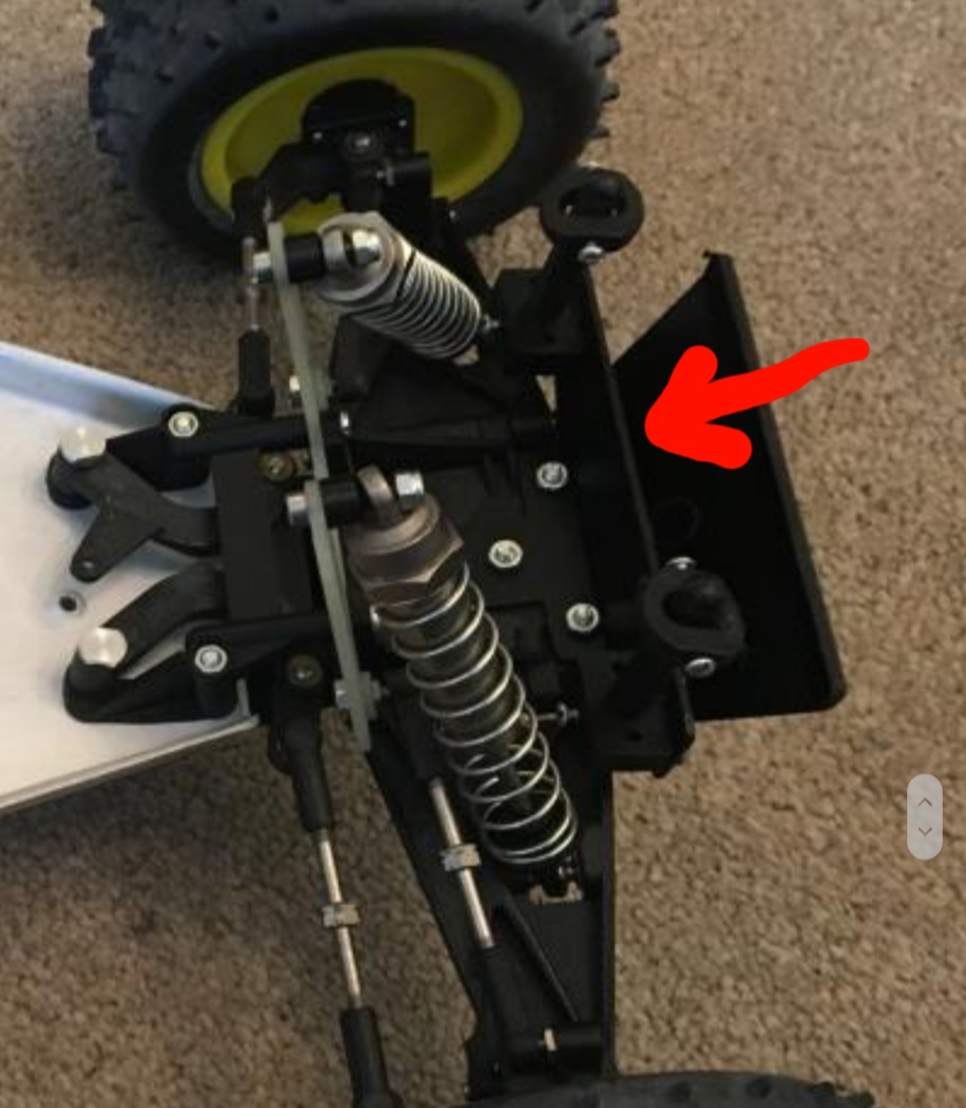

I still don't have a shorty lipo so I haven't been able to make the battery plate. Also, I was never happy with any of the Schumacher body mounting options so I looked into ways I could improve it. The stock dump truck bumper pushes the body too far forward for my liking, looks too bulky and is quite flexible. Mounting the body post behind the front wheel arches tends to allow the body to crack at the wheel arches and the single pin on the fiberglass storm tower..... well.... who thought that was a good idea?
