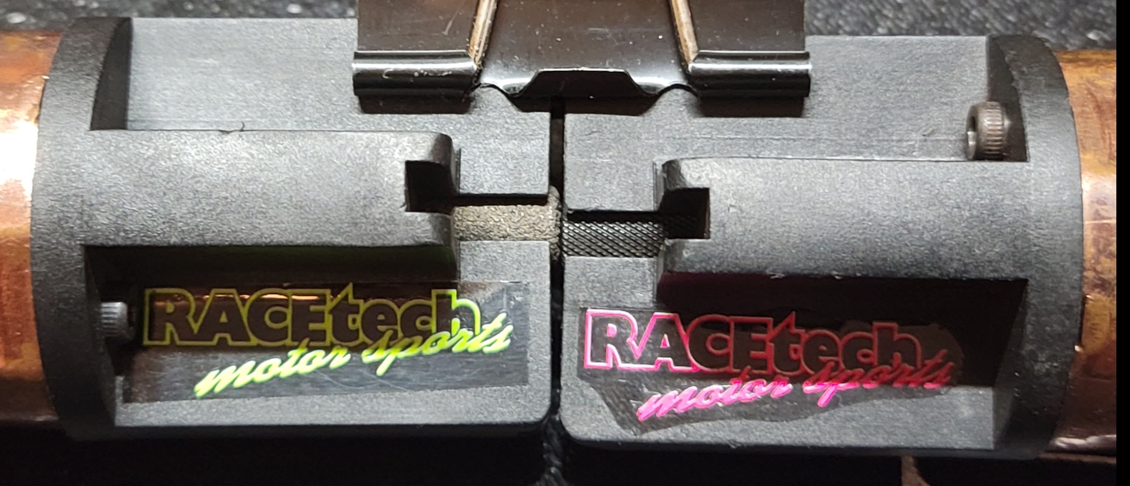

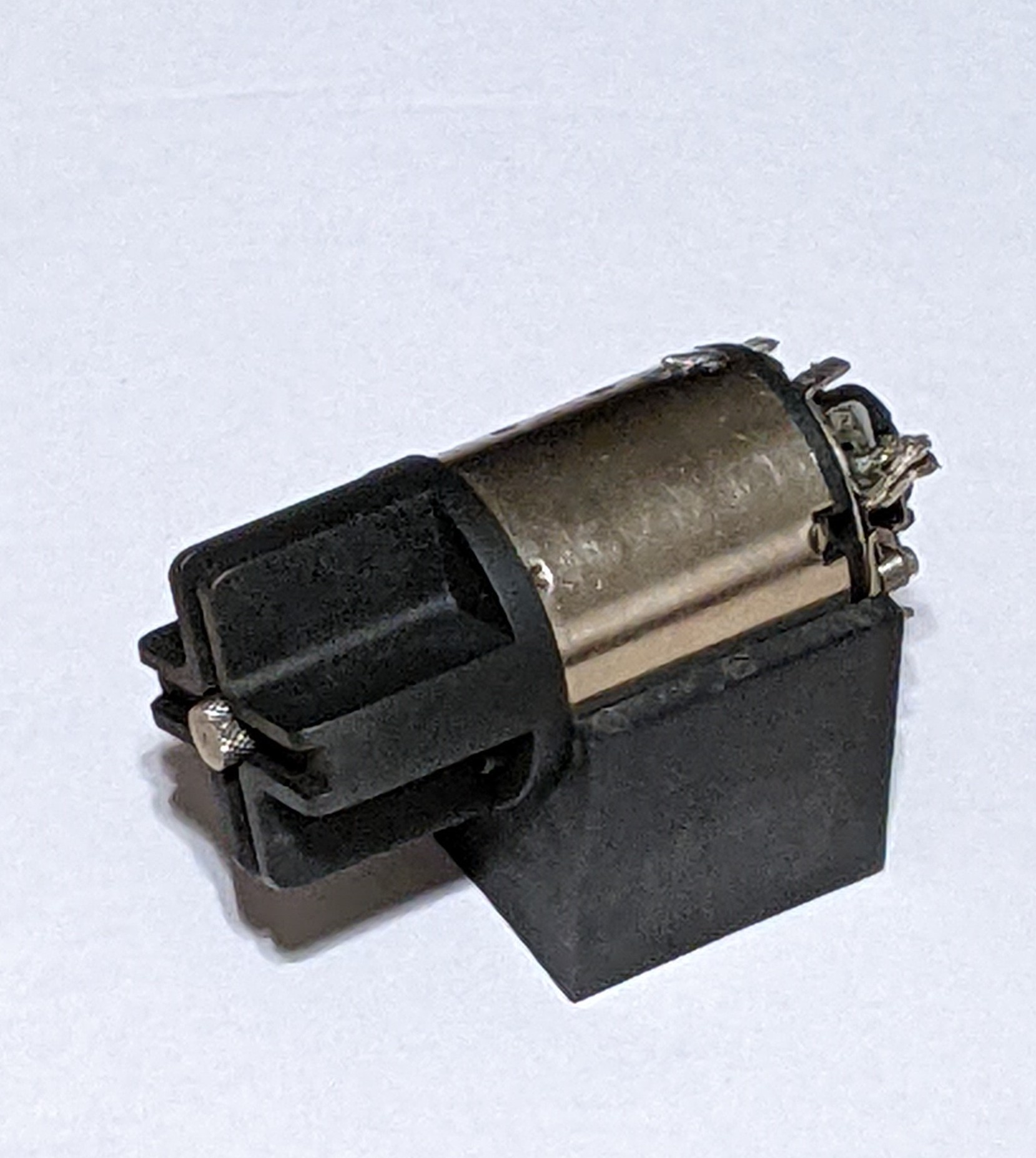

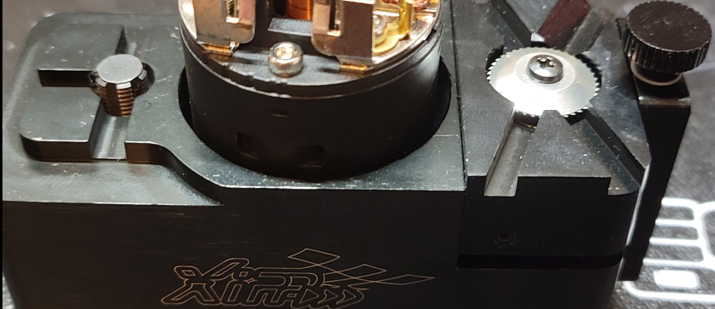

Here are mine. You can see that I have different cutters in them.
I use the coarse stone for touch-ups and the fine cutter when putting used brushes on a fresh cut comm.
This is the Integy cutter. It does serrations and all kinds of cross cuts.

Re: Cutting brushes
Those top styles are brush serrations, they just "restore" brushes by making them round and removing the burnt tips.
That integy cutter is a good piece of gear, looks almost identical to the Trinity unit. They are great for everything, cutting cooling slots, making timed brushes to increase motor timing. Only thing all of those lack is a drill jig to drill a cavity in the brush.
The trick if anyone remembers, was to use Prolong as brush drops, and stuffing the hole with cotton and a few drops of prolong.
Also, from memory Buds used to sell quite an assortment of cut brushes.
