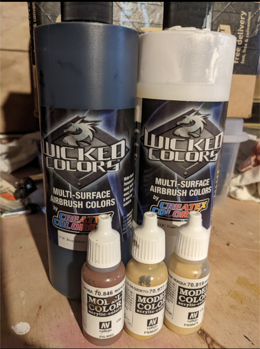

Last time there they had this Vallejo Model Color paint. I recognize the name from hobby shops with Warhammer and other mini stuff. I painted a lexan Sand Viper body with it and it went on well and looks good. Down side was the bottles are tiny 17 ml and like $4.
I grabbed the big 16oz bottles of Createx online for like like $15 and they are also pretty nice.
I use clear Windex instead of thinner. I'm not sure why but I remember reading about it when I got my setup and it got positive reviews.

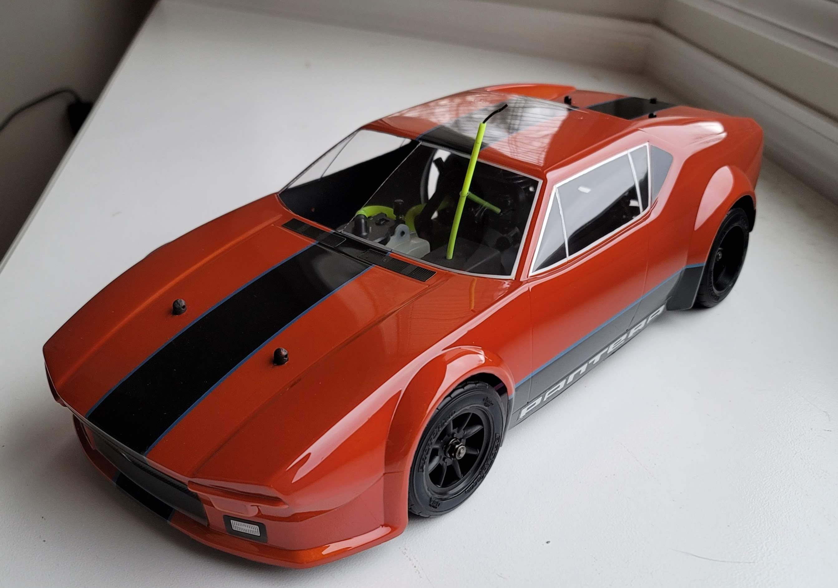

I use Vallejo airbrush paint, or Createx, both work really well.
Apply in thin layers to get good adhesion.
Then finish it off w a spray can paint Like the Tamiya PS series.
This really helps to protect the body.
This one was done with Vallejo Candy Orange, then a Tamiya PS silver
