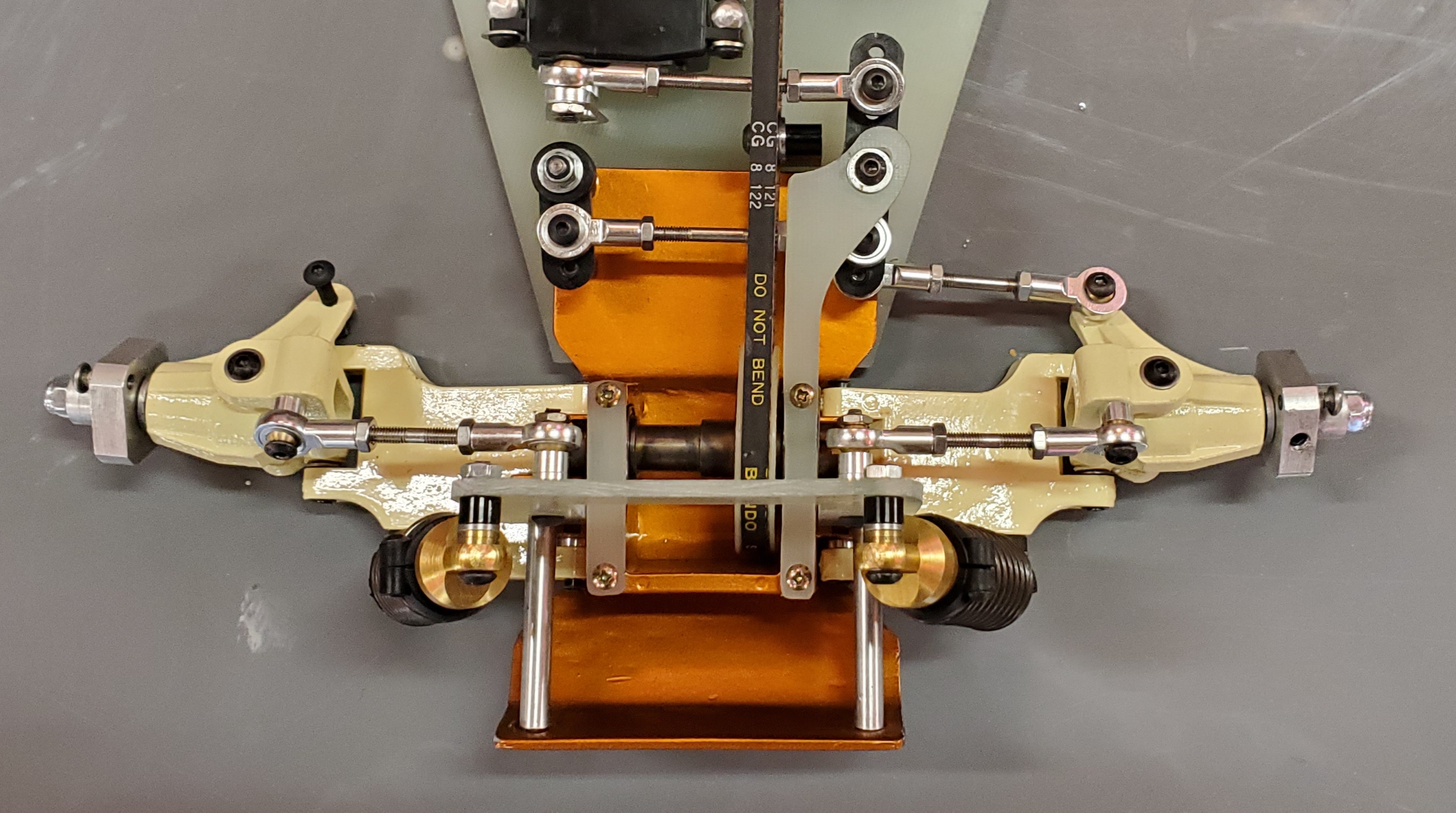

Getting the front end together for the last time, hopefully....had to order more dogbones, those things have to be perfect...so frustrating, 4th set I have ordered....waiting on more rod ends too....the body is off to California😁

Changed some things up, wasn't happy with the steering setup, went with Tamiya DF-02 C-Hubs and steering arms which gave much more area for the dogbones to ride and allowed full steering both ways. Kyosho Scorpion rear axles ride up front with with the 12mm hex adapter....got a super trick set if wheels comin. Kyosho Big Brute non drilled Thorp axles are outback now, had do custom fit them to the A & L rear arms which was scary, but a custom set of flanged 5 x 10 bearings are now going in there....I needed the wide rear axle to get the rear of the car to a proper width with the front, still waiting on some custom clamping hexes for the rear....anyway, it's still progressing but always 1 step forward and 3 back, but I dig working on it, gonna sux when it's finished🥺
Posts: 12346
Has thanked: 1131 times
Been thanked: 3925 times
Re: Mid 4:10
Looking good! Those steering components are awesome.
Just a fyi/future reference we do sell trailing arms that use the 10mm flanged bearings… from the Ultima and Mid trailing arm kits.

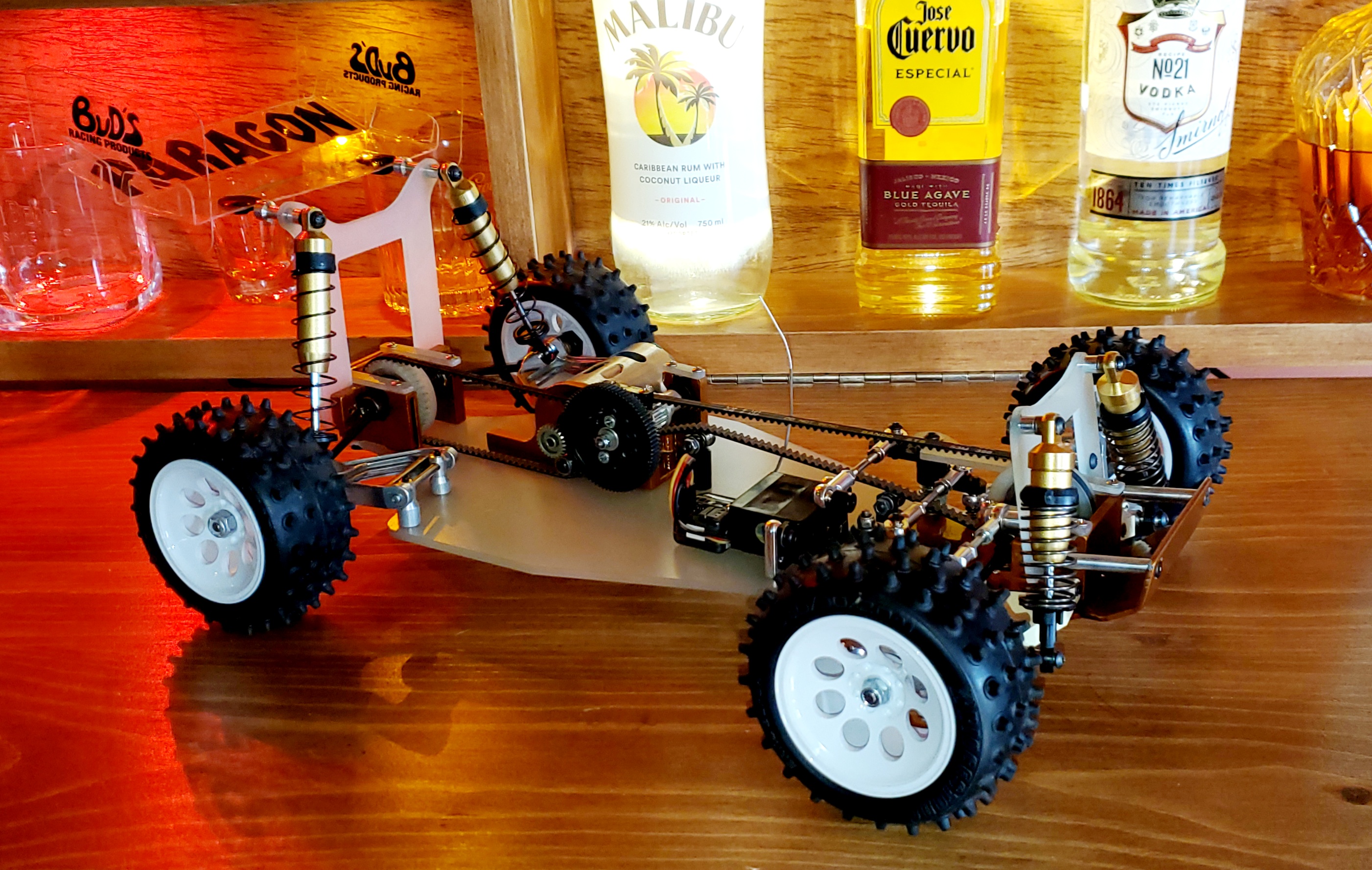

Got to drive this today, it drives amazing nice!...did have some issues with either the Checkpoint motor or the vintage Tekin esc, haven't trouble shot the situation yet but dropped a bag motor in and 1060 esc to finish the driving test, these are just spare roller wheels/tires, not what's going on it, but the suspension, steering and length, width of the car all worked out well....I did have to steal some front axles from my Tamiya Supershot to get the front end narrower to match the rear

Re: Mid 4:10
It looks killer! Glad it's a runner.

Frankentruck wrote: Wed Mar 16, 2022 7:00 pm It looks killer! Glad it's a runner.
Thanks homz!....yes, I want to drive it often... light running tho...I don't want to scratch it....but mechanically I want to run it hard, not sure the Checkpoint with its tiny brushes will hold up to alot of running, kind of bummed about that..
