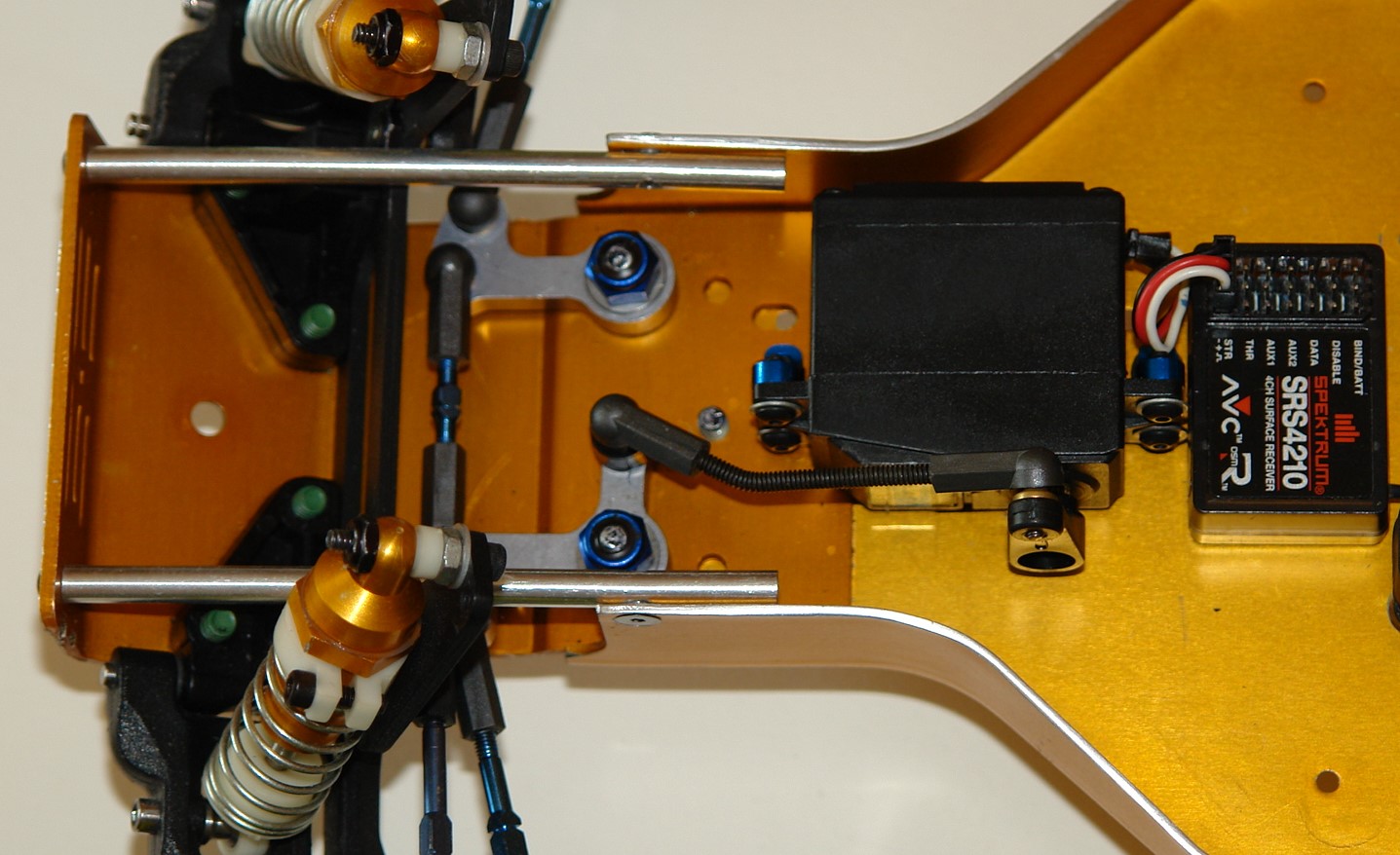

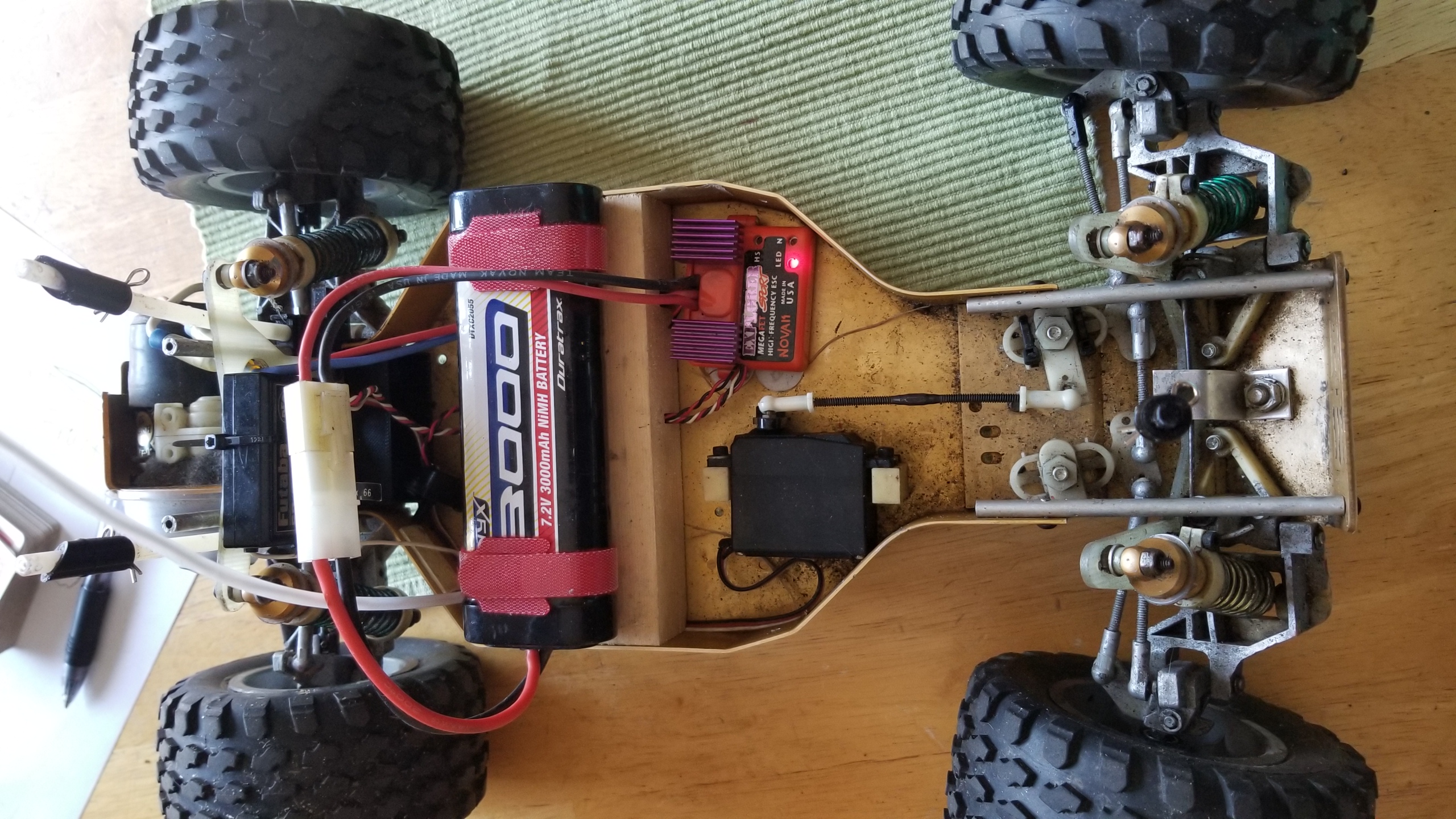

Back in my much younger days I picked up a gold chassis rc10 that the previous owner had converted to a truck. The truggy has the steering system in the non stock location allowing the steering linkage to be perpendicular to the steering arm.
This means that over the 20+ years I have owned it, the battery has been misplaced. I used to jam it sideways into the frame but that caused wire damage. Right now it has a wood riser and velcro which works poorly at best.
I have a 3d printer and the ability to put it back but before I do, doesn't having the steering servo offset like that affect your turning radius and/or responsiveness?

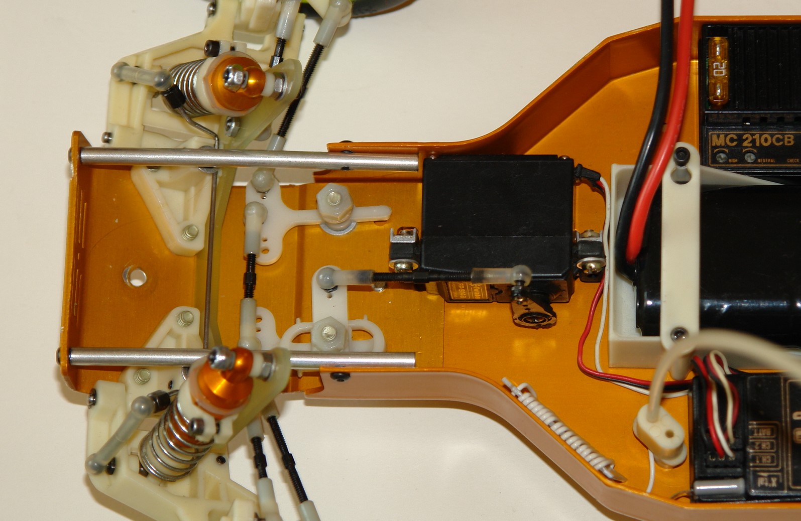

While not very familiar with the particulars...if it's just a question of trading a 90° for a 90° arrangement. I think the servo capabilities would be the only limiting/enhancing factor.

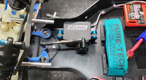

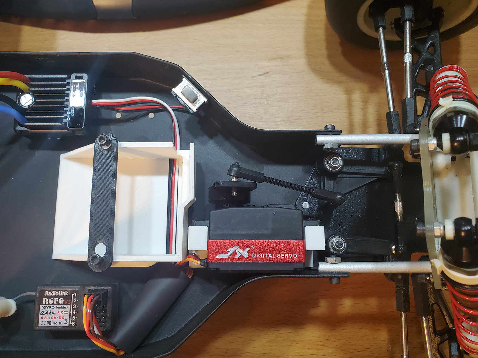

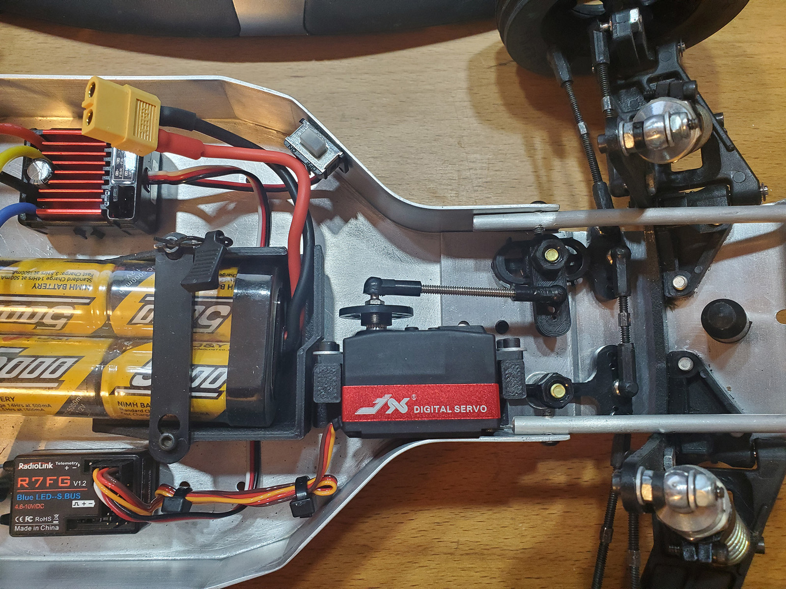

I have this little setup in a couple of mine. The servo is also about 90oz-in, metal gear, ball bearings, and $19. If you want to go serious bashing, you probably want something a little more powerful, especially if you are keeping it a truck. If you are interested, I can send you the .stl files and you can print yourself. The servo mount and battery tray are both printed.

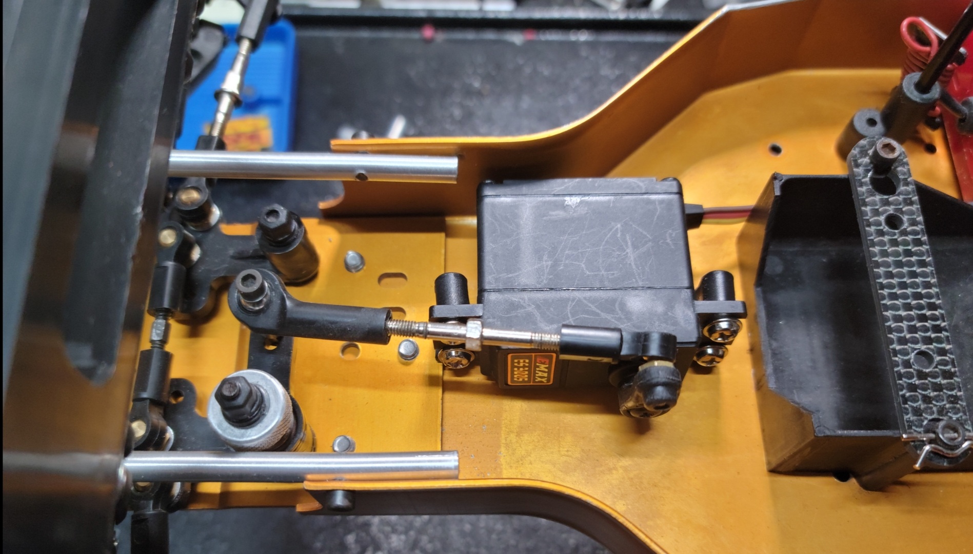

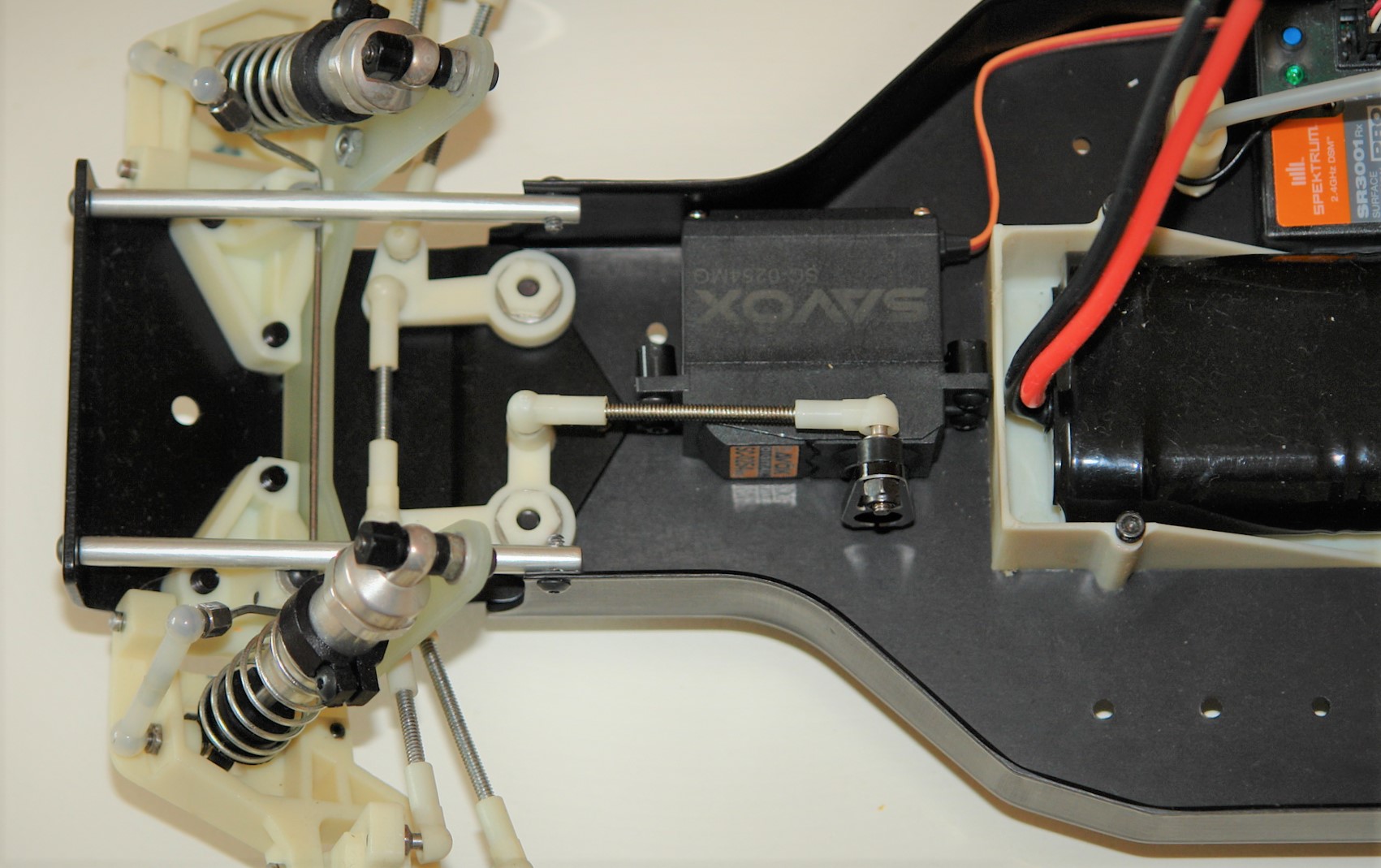

This is my truck conversion. It uses a metal gear, standard size servo. That is the GT/DS servo saver.
The nose plate is setup in the long wheelbase format, which requires longer nose tubes.
In long wheelbase format, a standard servo can be mounted in the original holes without spacers. The front servo post will require a little clearance. I wouldn't modify original RC10 posts but don't mind grinding a set of $3 Traxxas mounts.

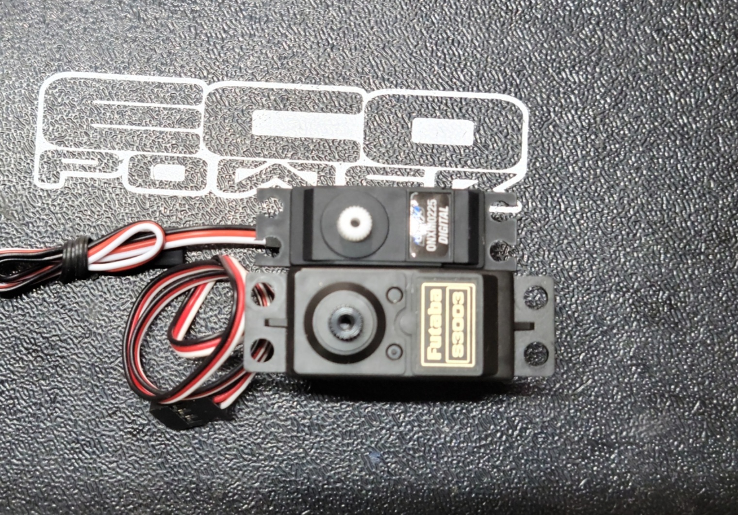

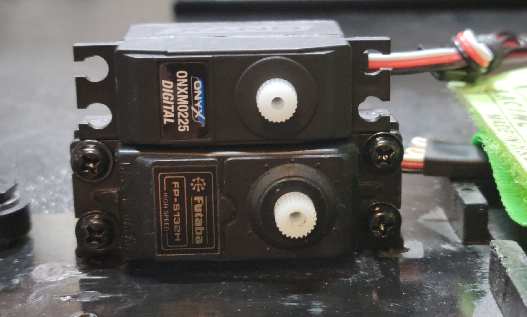

Someone mentioned the Onyx S25, mini servo. It does fit the original holes for a mini servo without modification. However, it looks a little frail for use in a 1/10 truck.
Those plastic gears can't be very big. It is even thinner than a older Futaba S132, mini servo.
And downright tiny compared to a standard servo.
