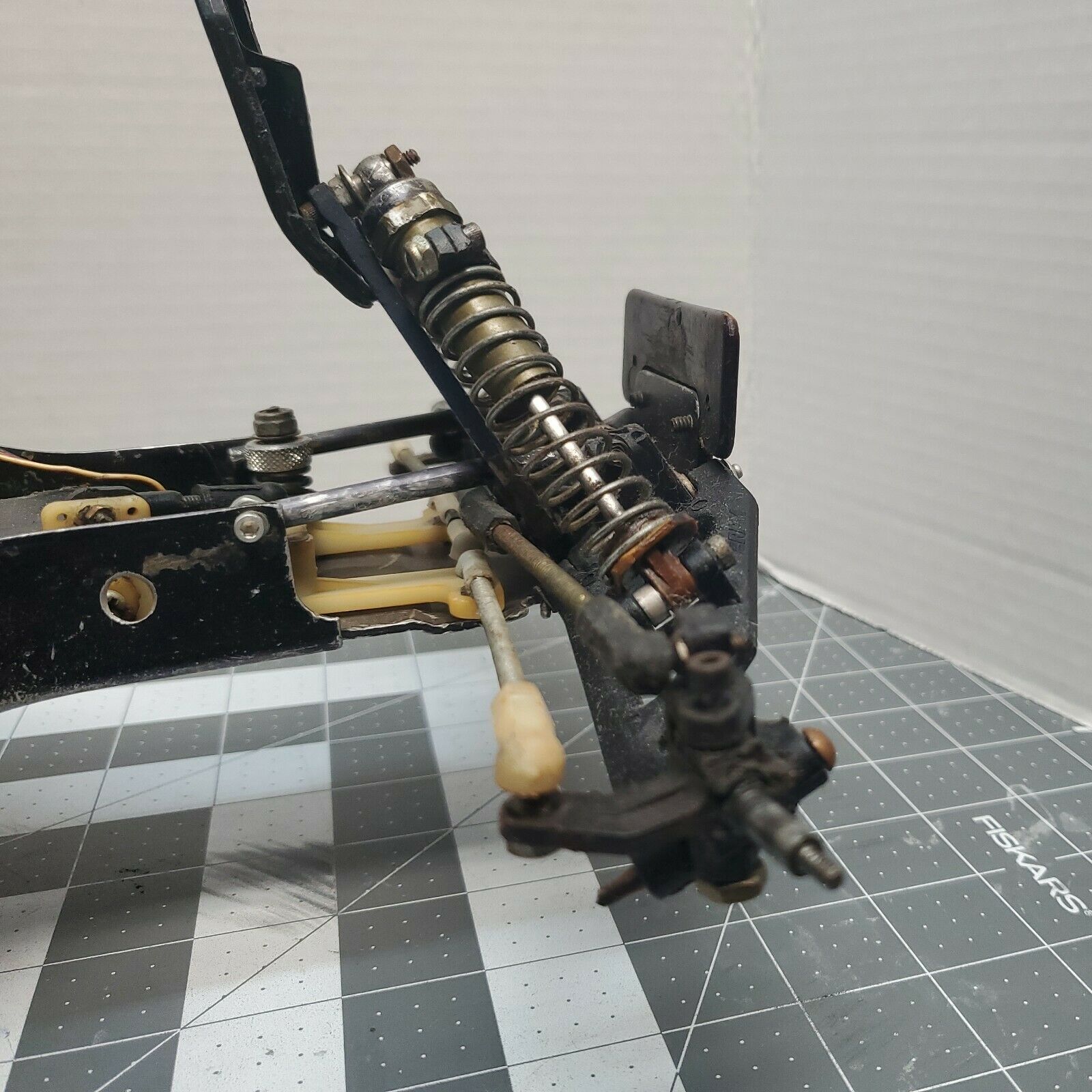

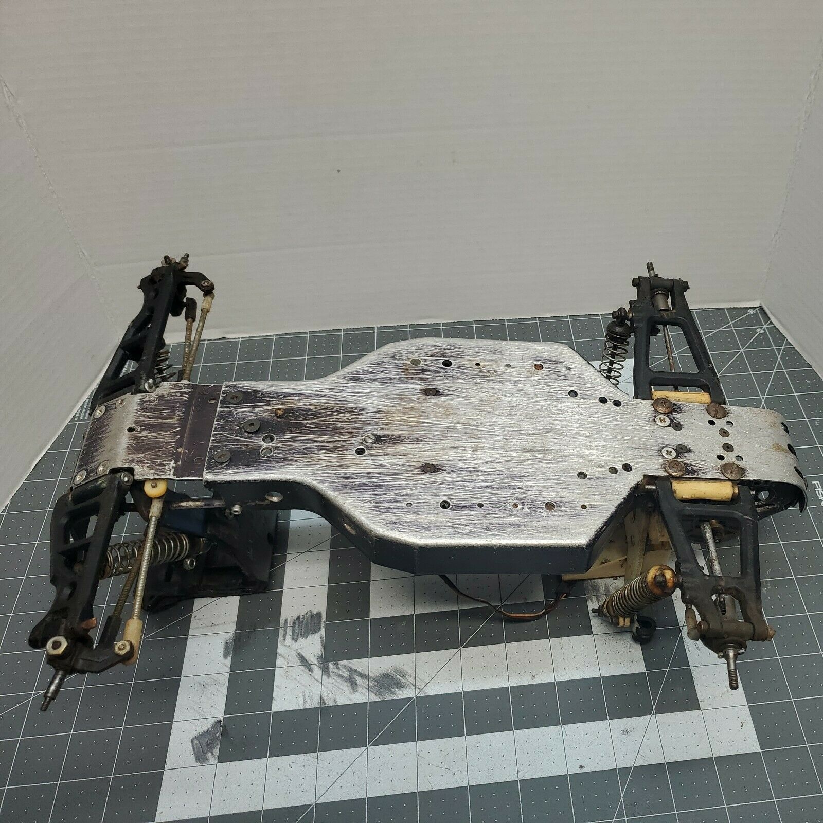

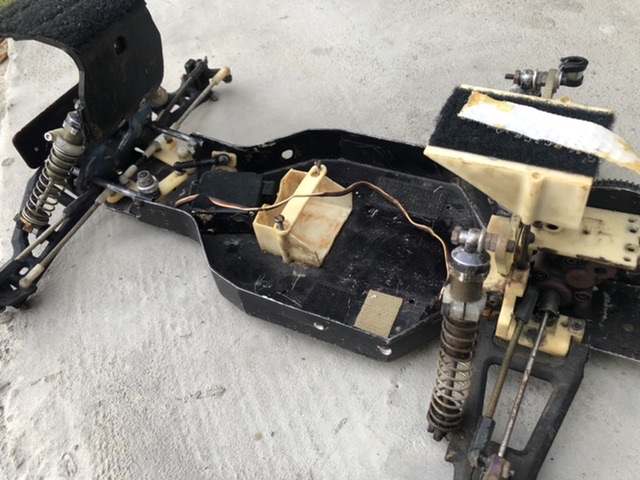

I saw this RC10t on ebay for a price that seems about right to turn it into parts.
Some of the parts were dyed black and that dye is fading and some were painted black. I am hoping to strip the dye from the white parts and use acetone to remove the paint.
I wonder how much will be usable off this truck.

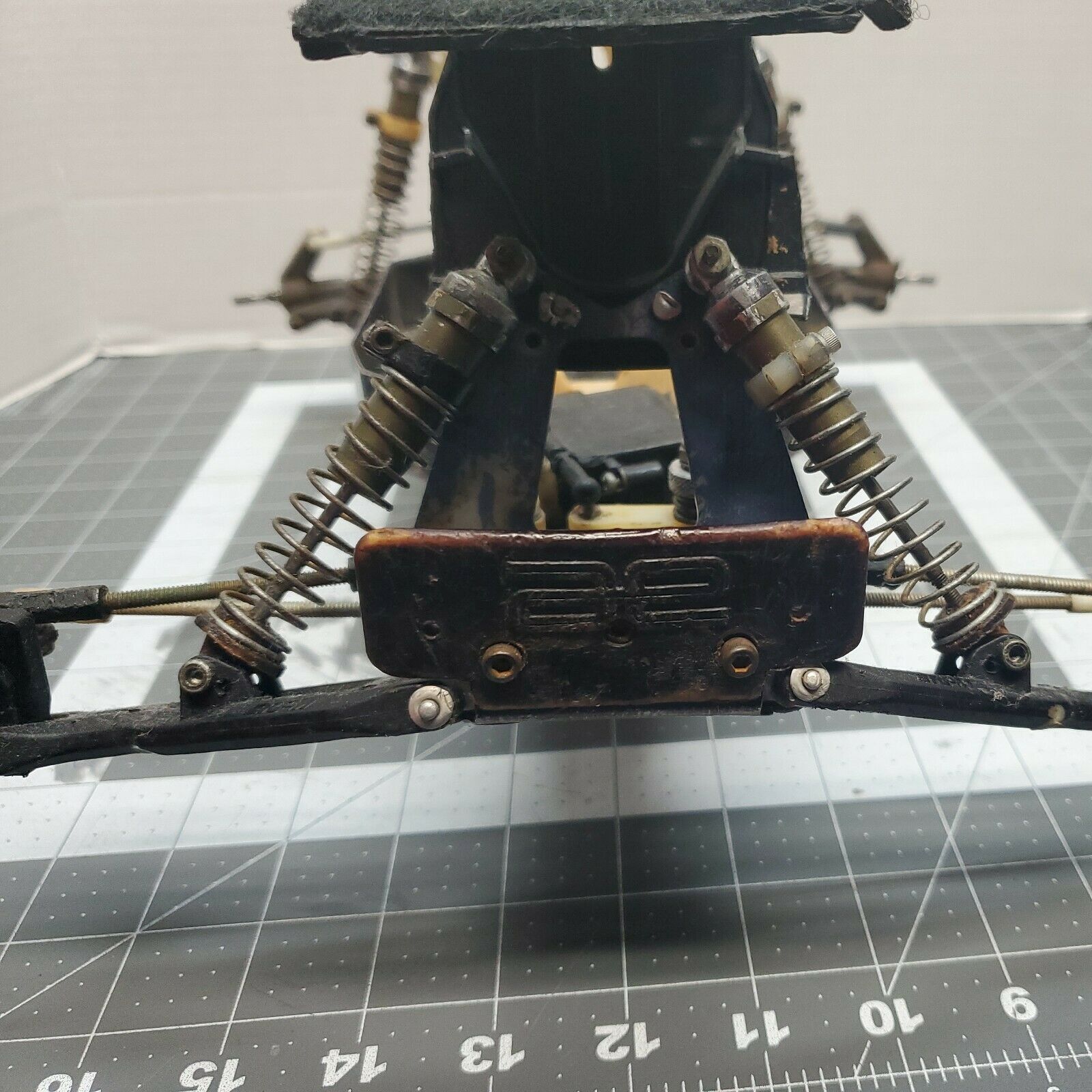

A lot of interesting choices were made on this truck. There are no pins, the arms were installed upside down. The chassis is rough.
This truck looks like it was a white arm rc10t that was 'upgraded'Some of the parts were dyed black and that dye is fading and some were painted black. I am hoping to strip the dye from the white parts and use acetone to remove the paint.

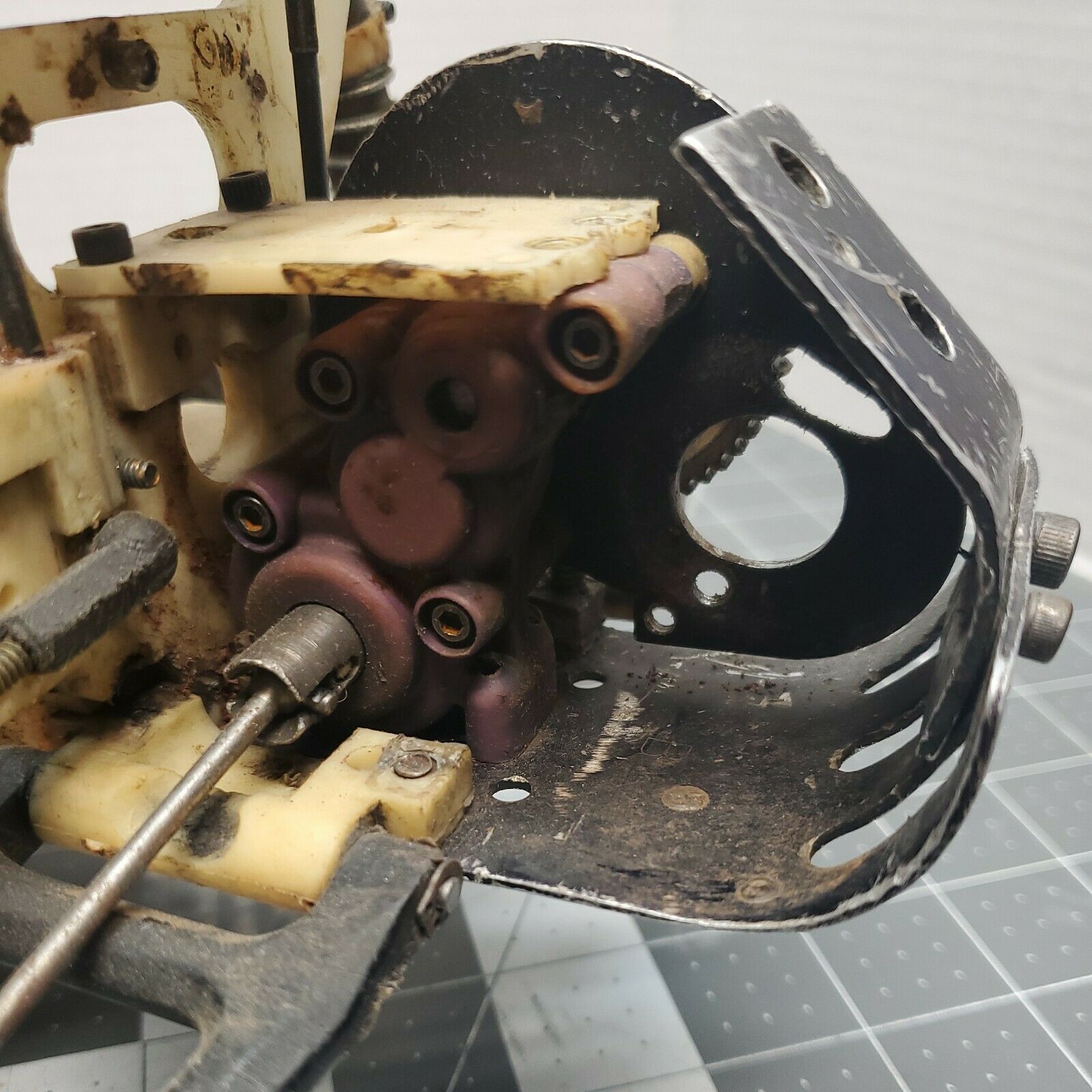

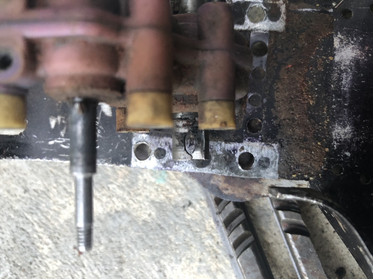

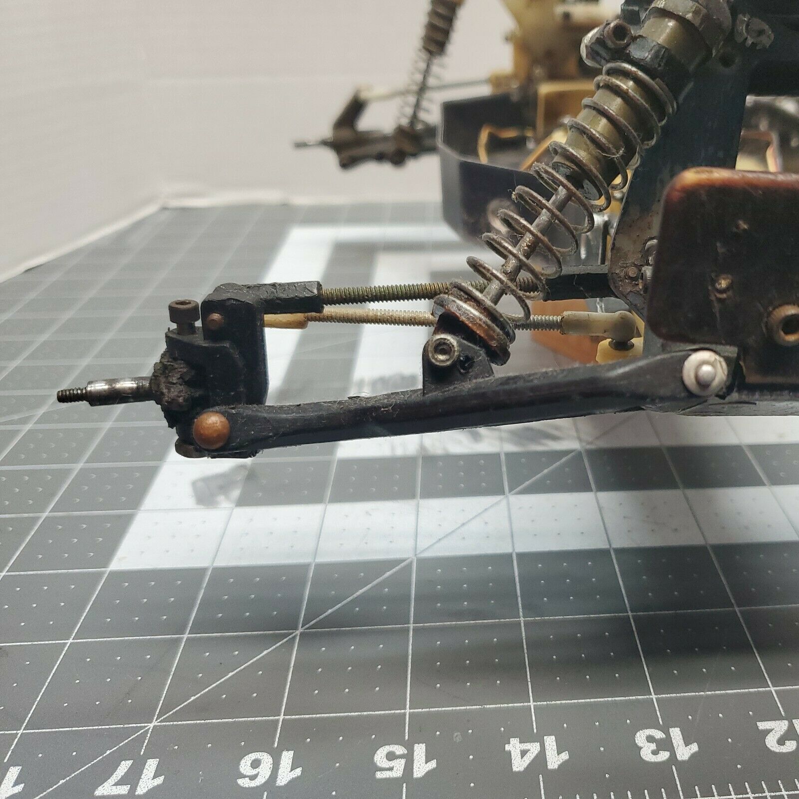

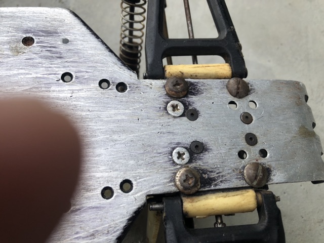

Of in person I can see that the pins were replaced with rivets
In person it is in so much worse shape

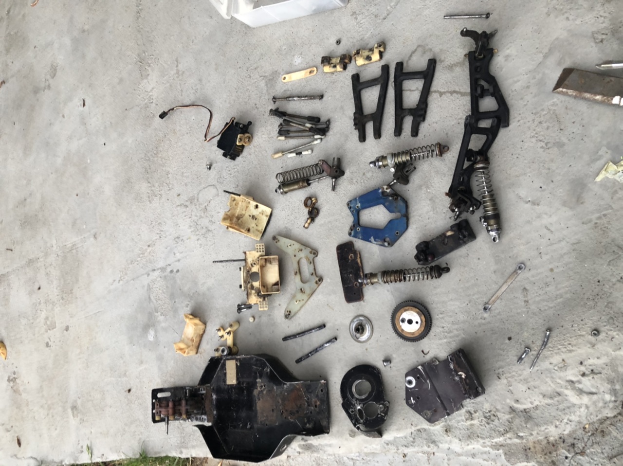

So the outdrives are in much worse condition than I could have imagined
All dissembled

There are a few parts that could use a little buffing.

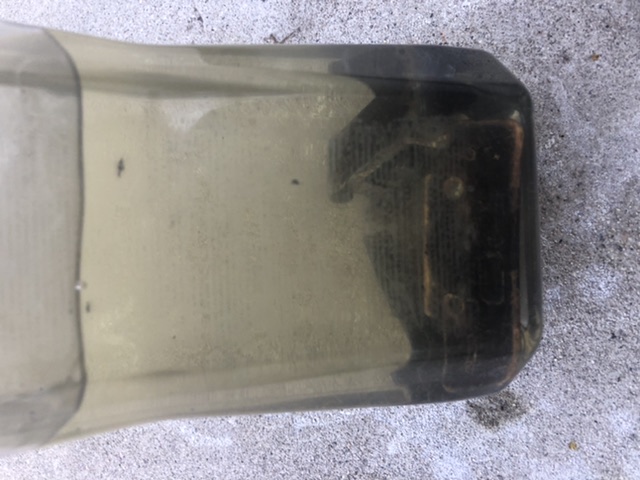

Re: RC10T parts wreck

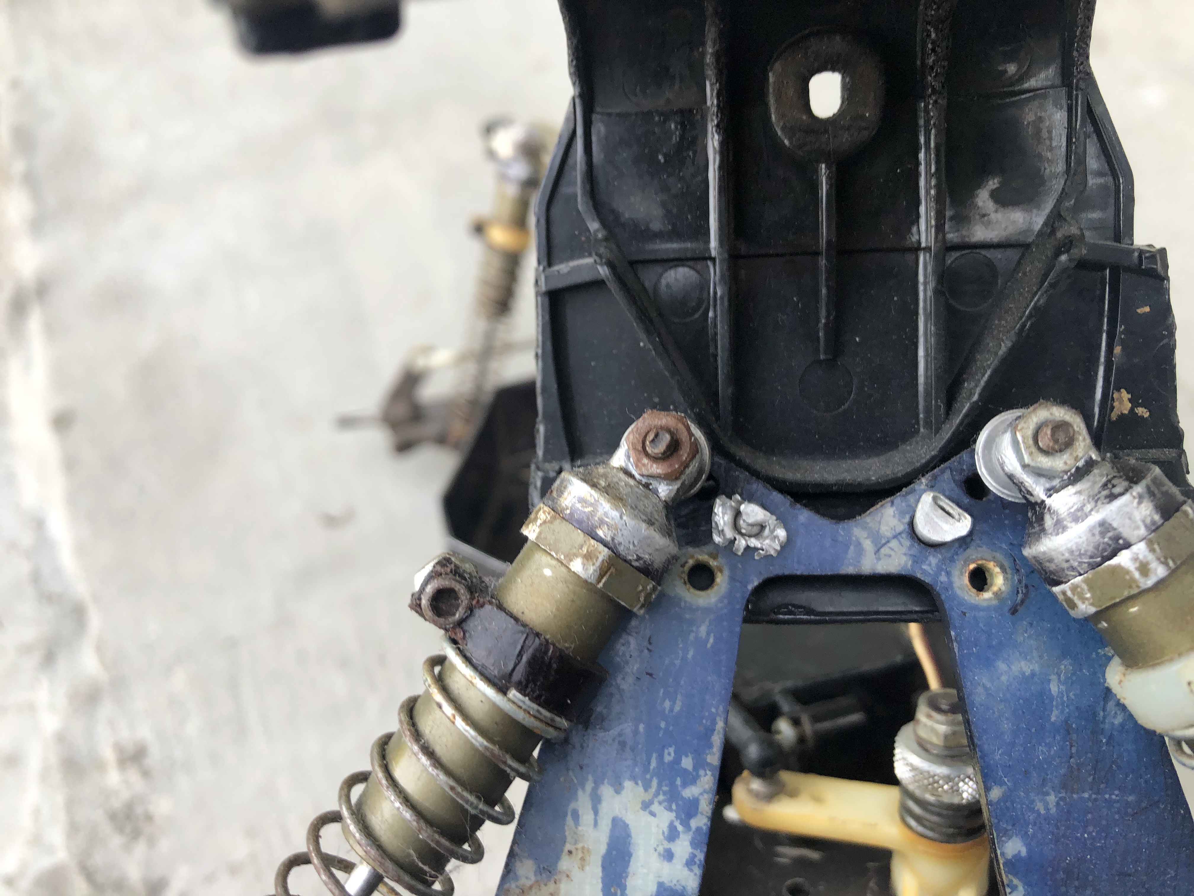

Yep. I dropped the front shock tower in some acetone before the light completely faded and it came back white. I took a bunch of the nylon and started washing it up. The color is coming off the nylon with just a bit of scrubbing. I think there is a shot for some of the parts to come out of this ok.Frankentruck wrote: ↑Thu May 05, 2022 10:36 pm There are a few parts that could use a little buffing.
This trucks like a sport truck that was equipped with teflon shocks. There was a mix of bushing and bearings in the gear box and it had 1/4" axles.
I am quite amazed at the use of rivets. There was a single pin in the truck all the rest were rivets.
Do you know if the black RPM arms were dyed black or a different material? These arms are showing white in wear areas.

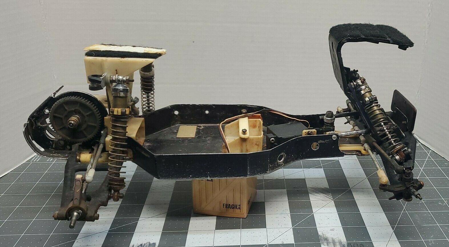

Things are starting to come together.
The chassis is is much better shape that it first appeared. After some deanodizing it appears nearly all the scratches were light. The tub was also really well cast with nearly no lip.
The front shock tower cleaned up quite nice.
I soaking some of the parts in rit color remover.
Some parts are much lighter in color than before.
