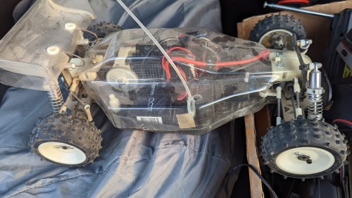

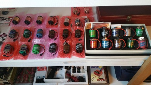

I just had a buddy give me a throw away box full of RC gear someone was dropping off at an electronics recycling drive.
In it among other stuff was a still clear yoko Super Dog fighter yz10 with a REVTECH motor... BROWN w/ gold on clear decal.
Any info? Or are they all just "modified"?
Thank you all in advance! 🙌

Since it's a modified though, it's easy enough to pop the armature out and see what the windings look like and they probably marked it somehow to indicate the turns. A quick view at the comm tabs will tell if it's a single double etc. If you see single fat wire you know it's relatively low turns.

Pretty sure it's a 19turn triple wind. However, if you have a silver dot with the same can/color motor label, it's a 19 turn double. I've got both, but in all honesty....you never really know what you have until you open the can. It was sooo easy to switch armatures in cans on brushed motors back in the day. Nice motor....good score....I Love me some RevTech!
