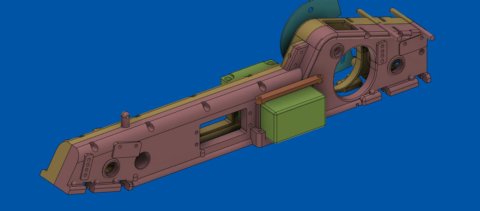

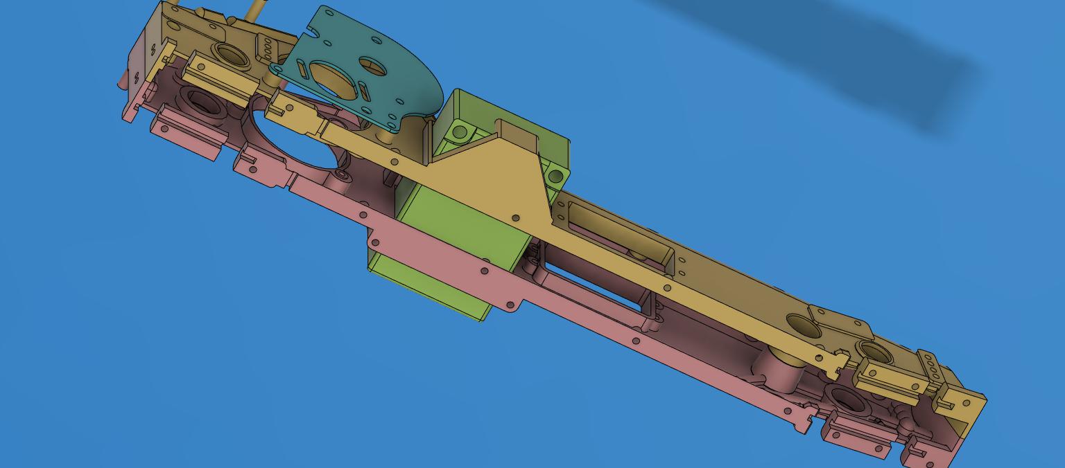

Re: Dadio's 3D Printing Stuff

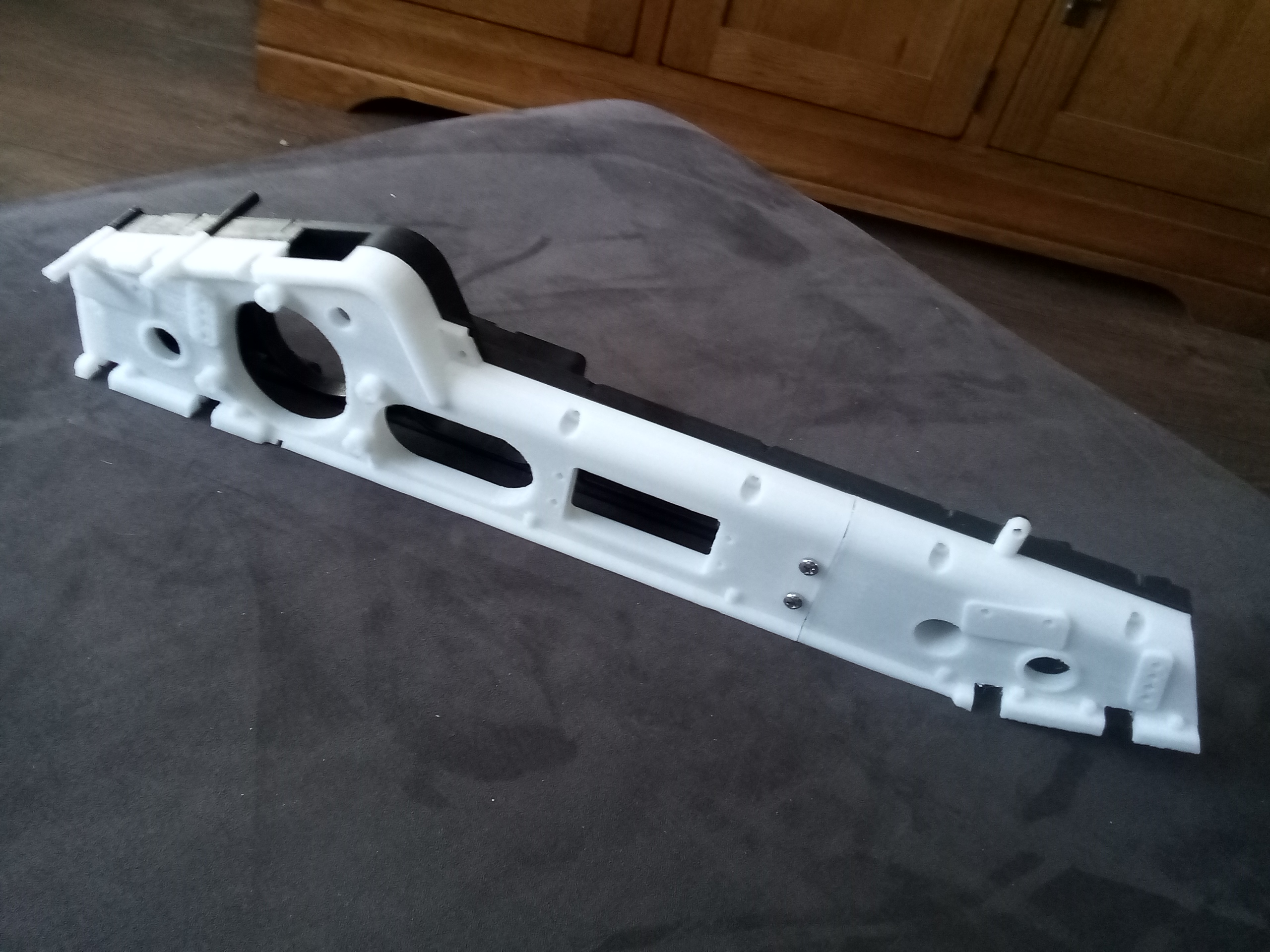

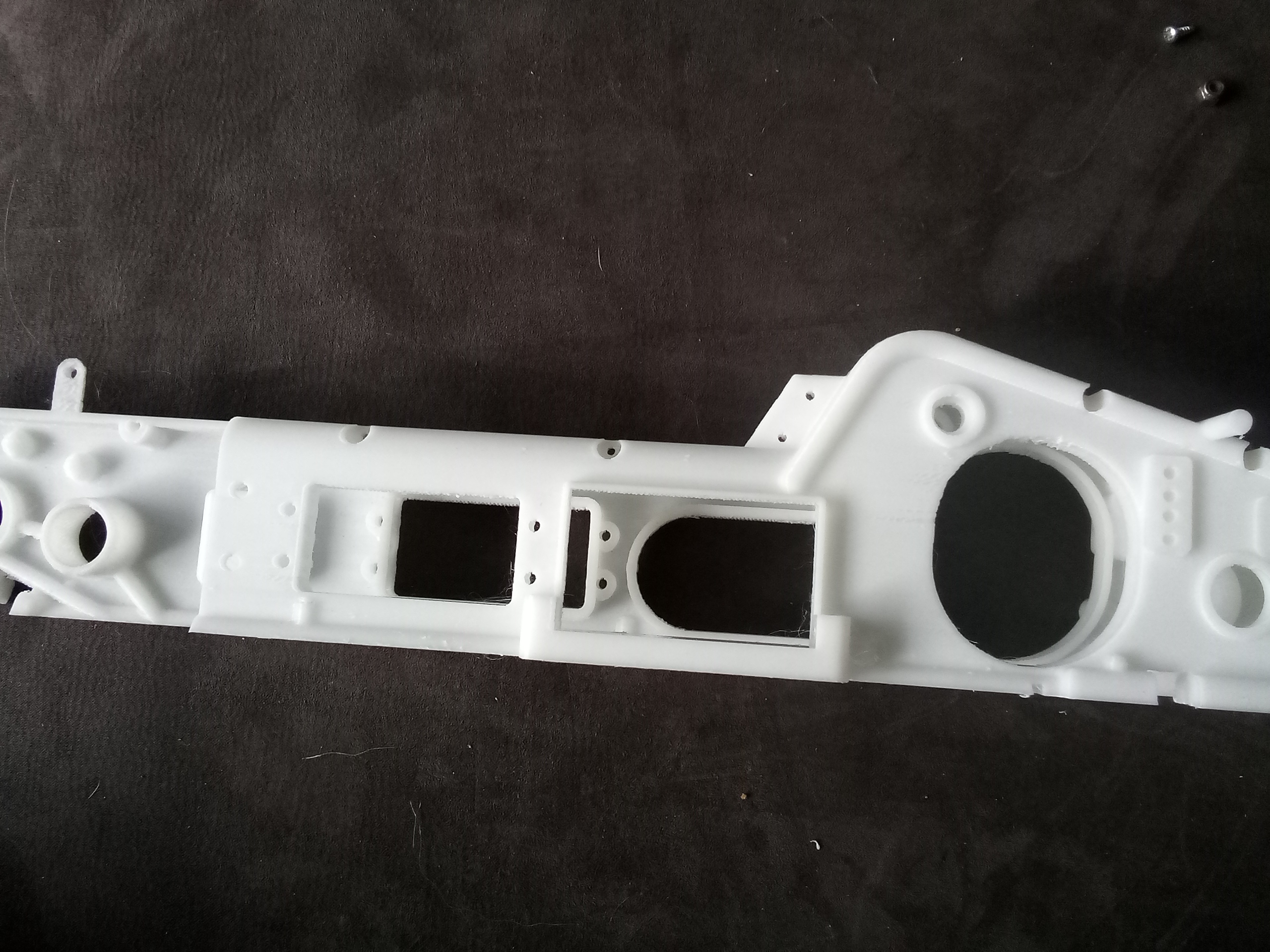

Finished the PB Mini Mustang chassis , had to be very patient at the end as Fusion 360 was close to crashing after every action and it had to think for 5 min before I could continue , that also meant I was saving after every action and it needed to think for another 5 min , just tedious
Anyway I have it in two flavours , a split version with a joint that fits on most print beds for home printing or a full length version .

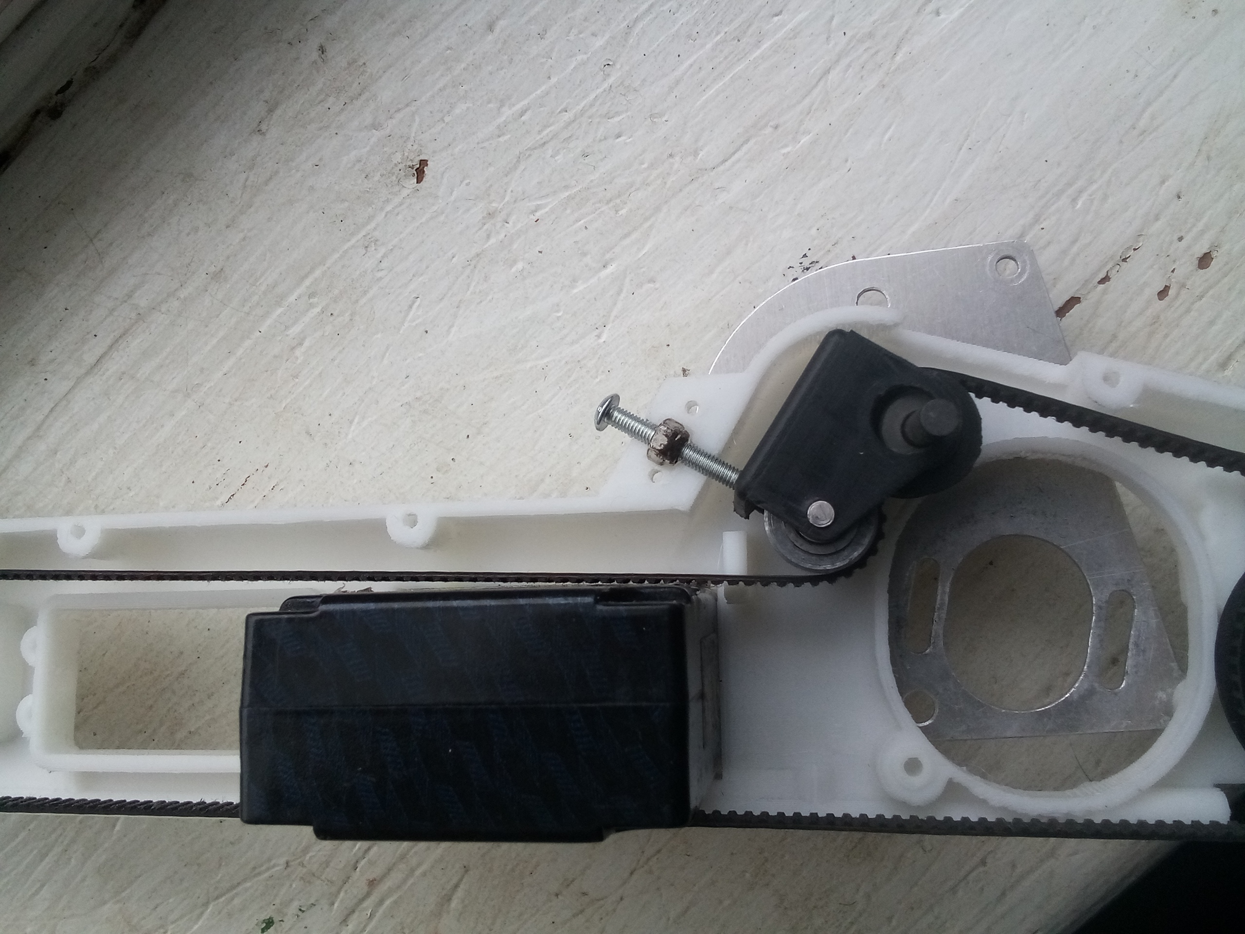

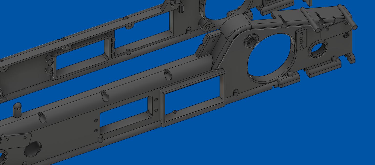

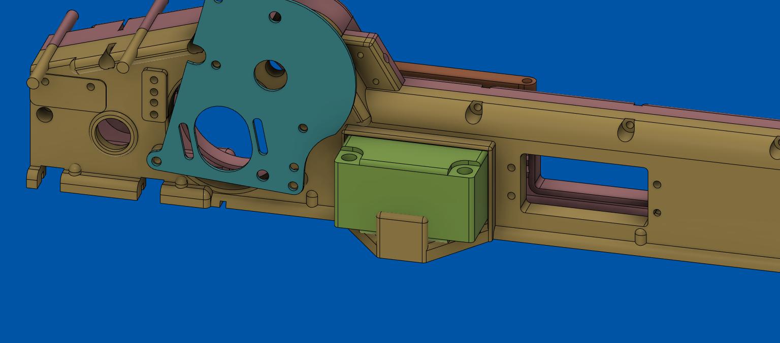

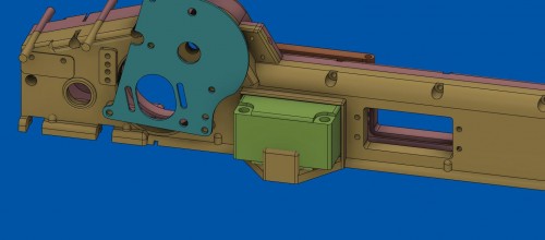

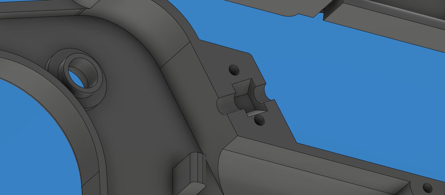

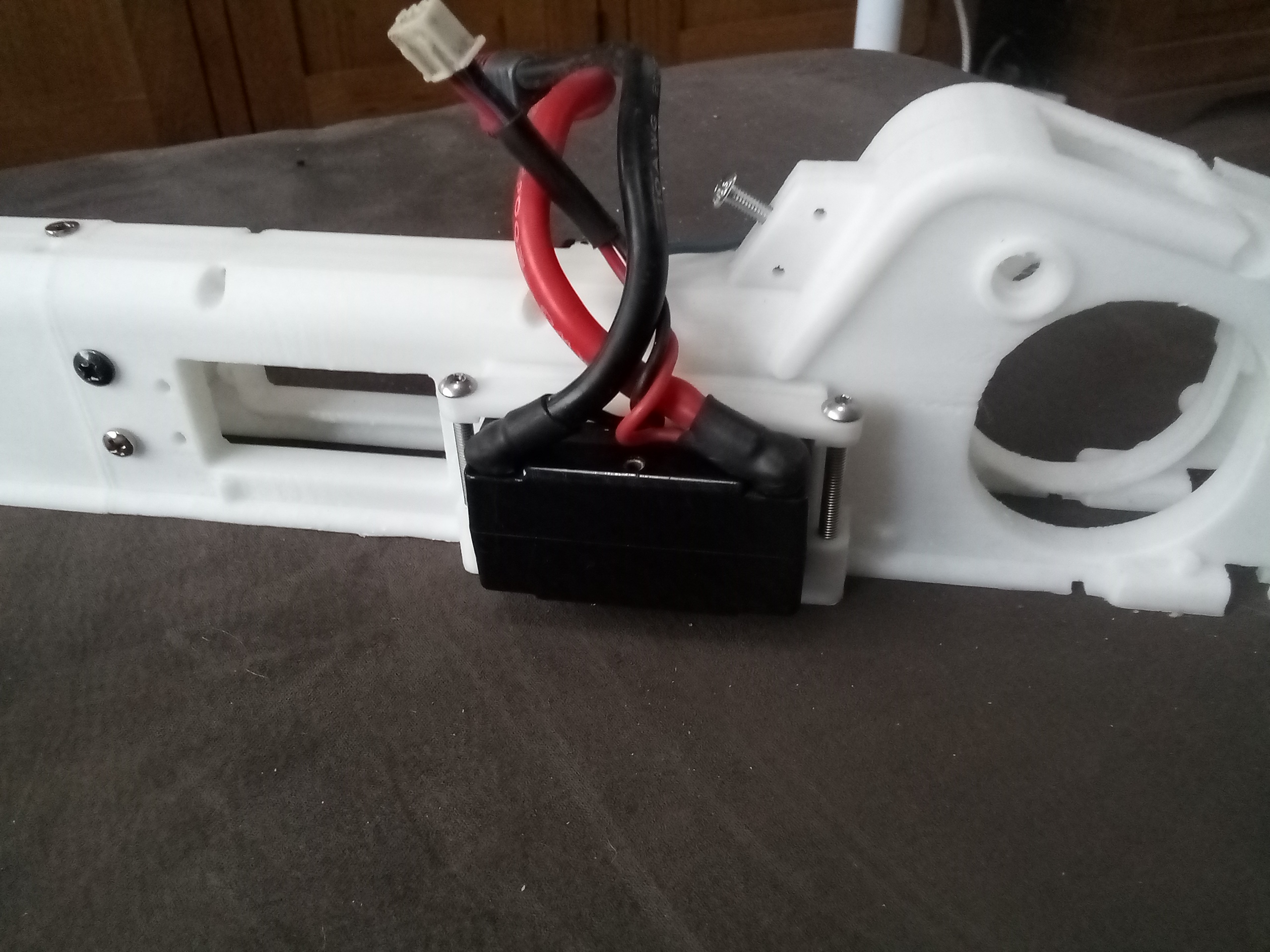

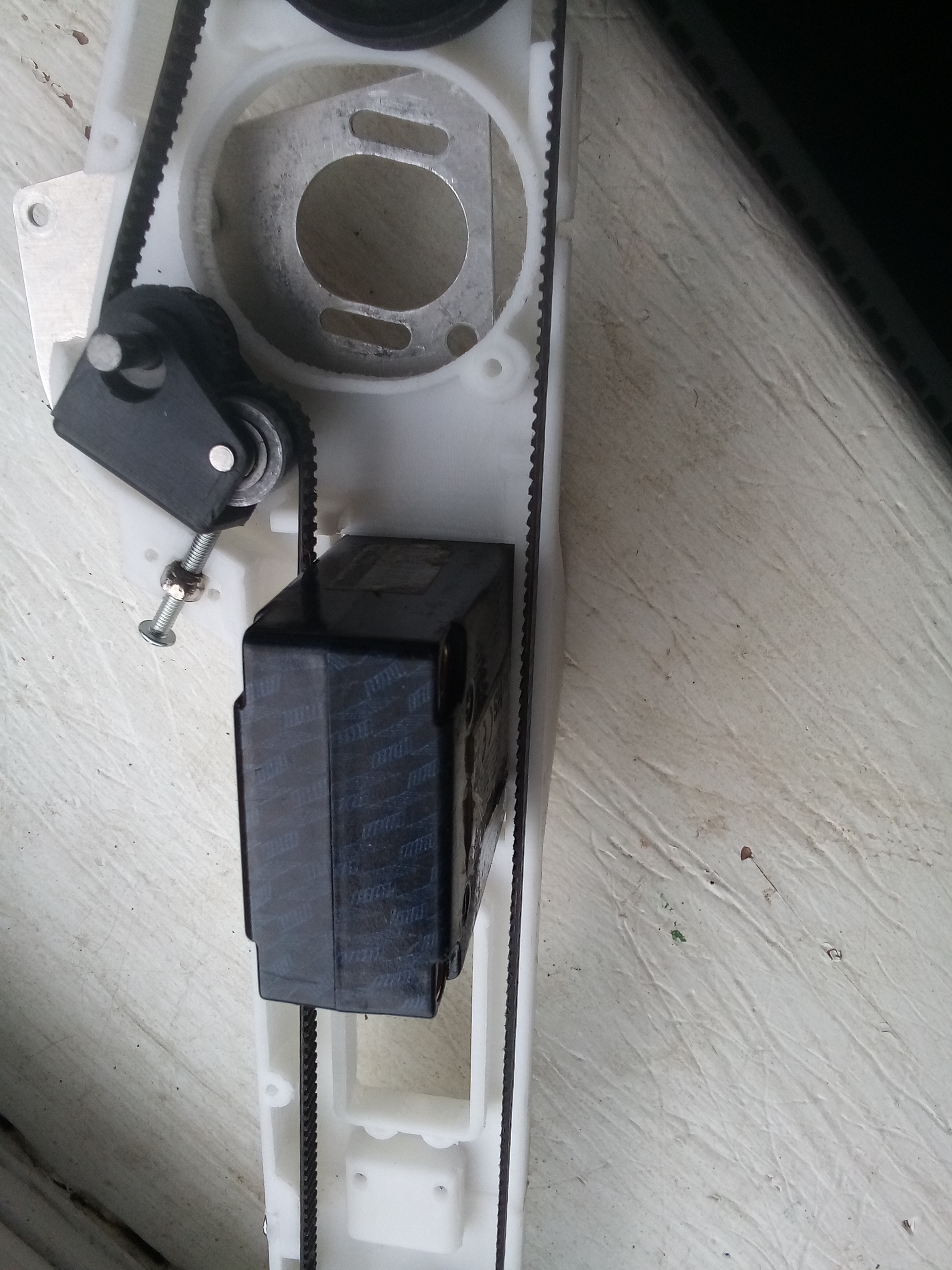

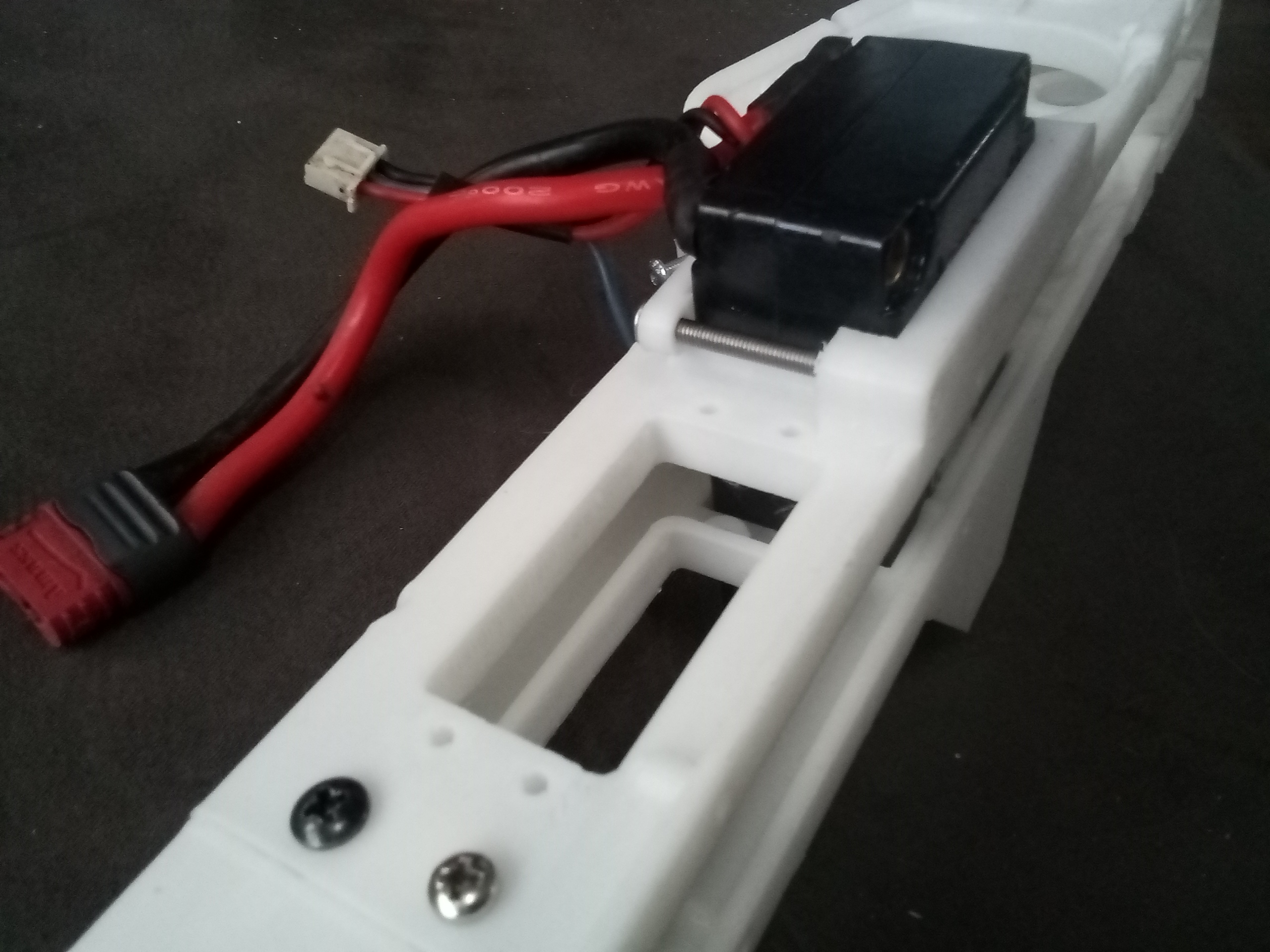

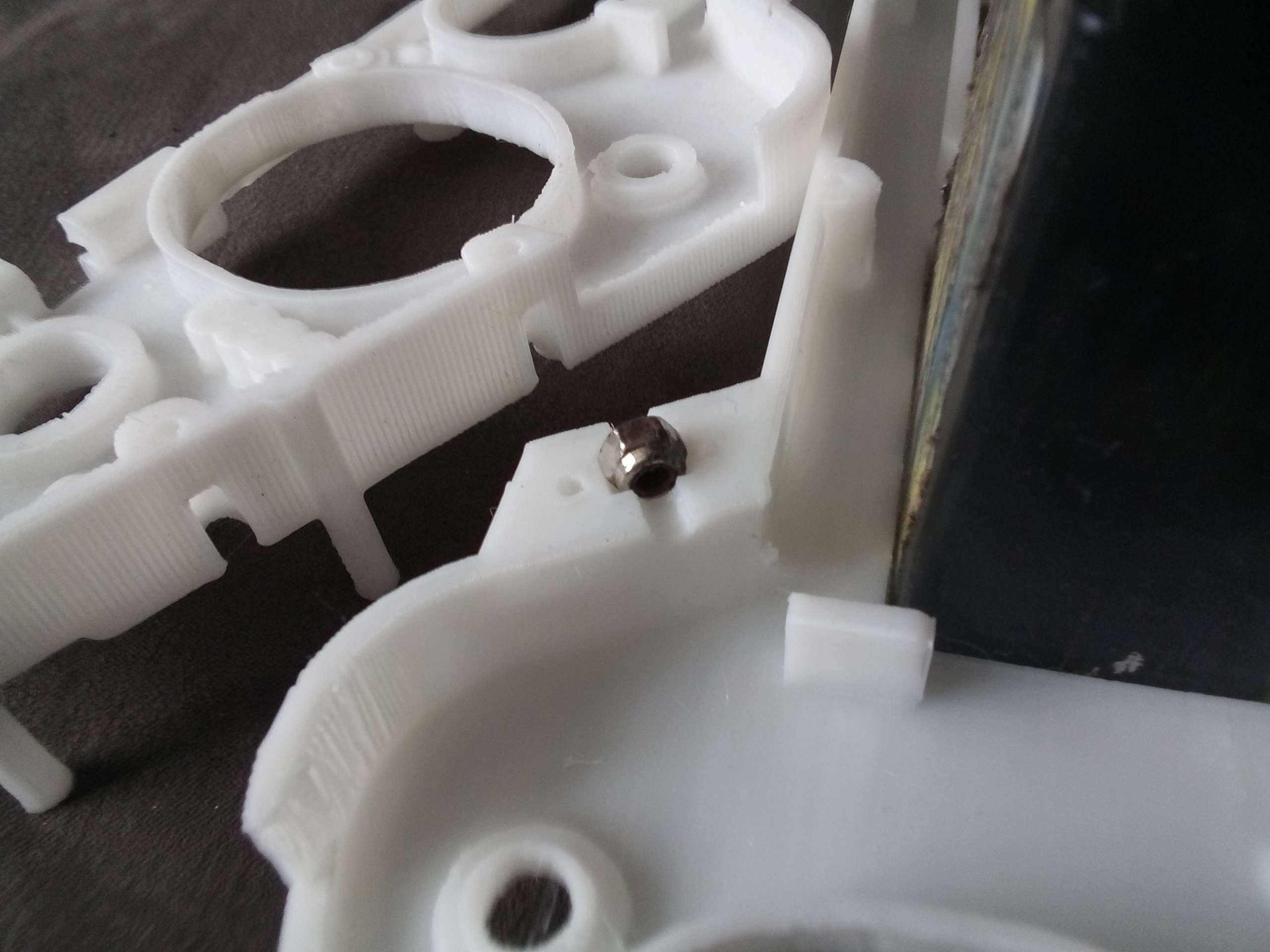

Started modding the Mini Mustang chassis , I was asked to make it fit a shorty lipo and add a nylock nut for the belt tensioner screw. The battery was more involved as i had to move the servo 10mm forward to fit it all in . I beefed up the tensioner screw area and added another screw hole for holding things together there.
Think the shorty lipo chassis is ready .

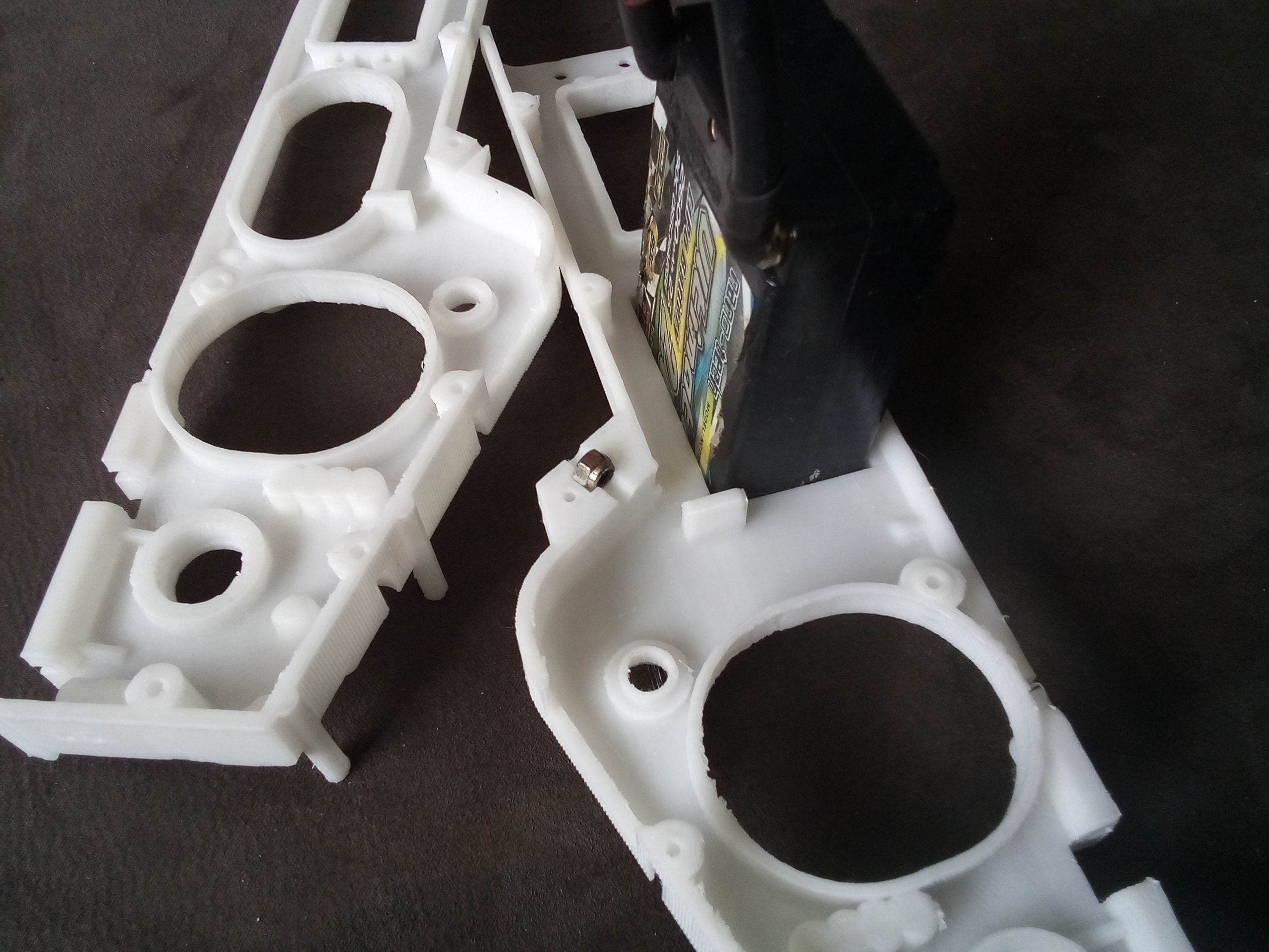

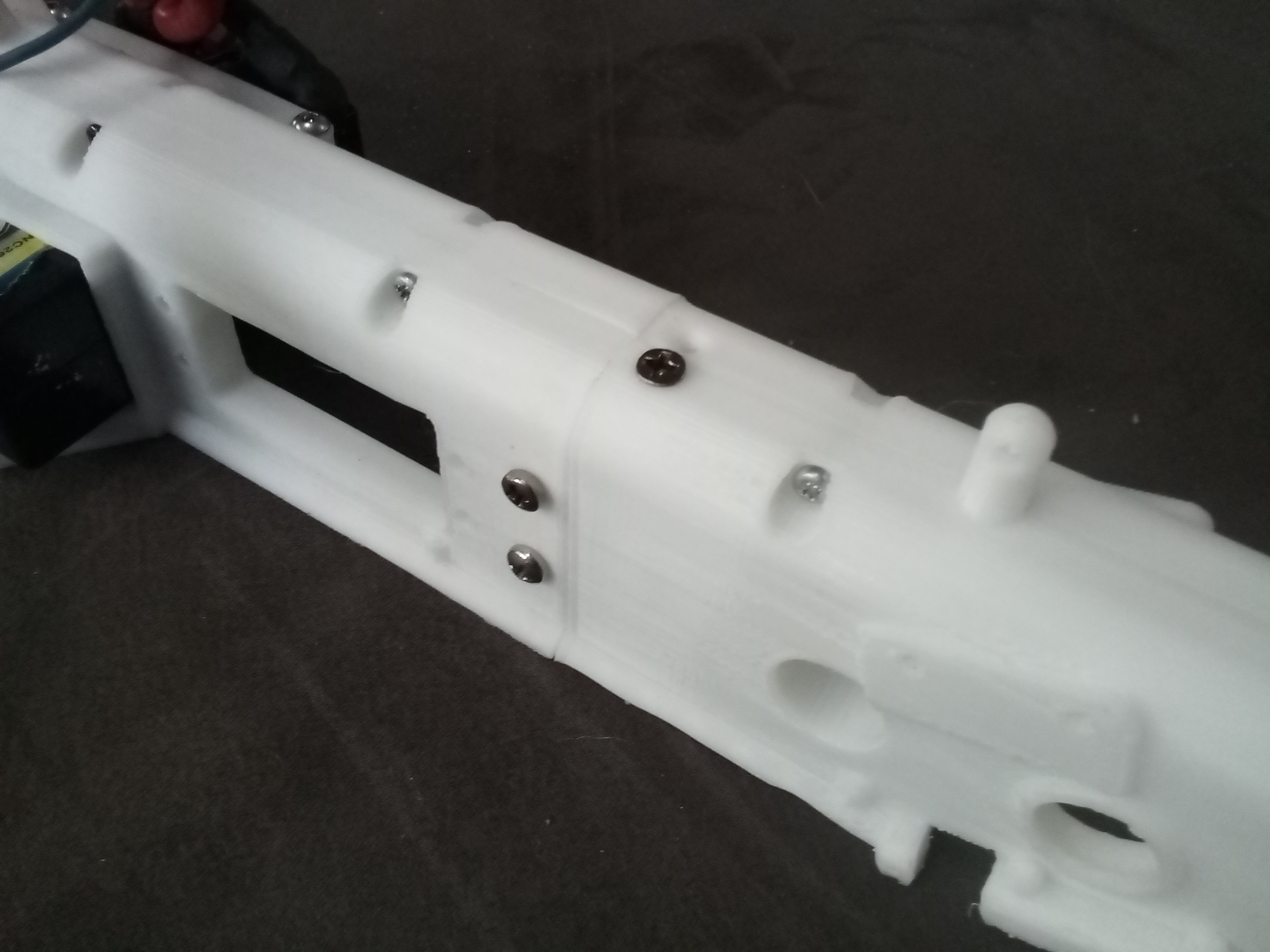

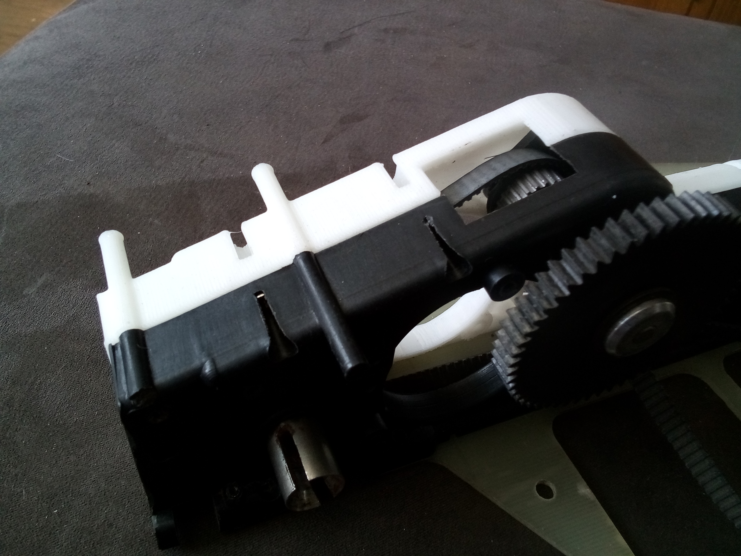

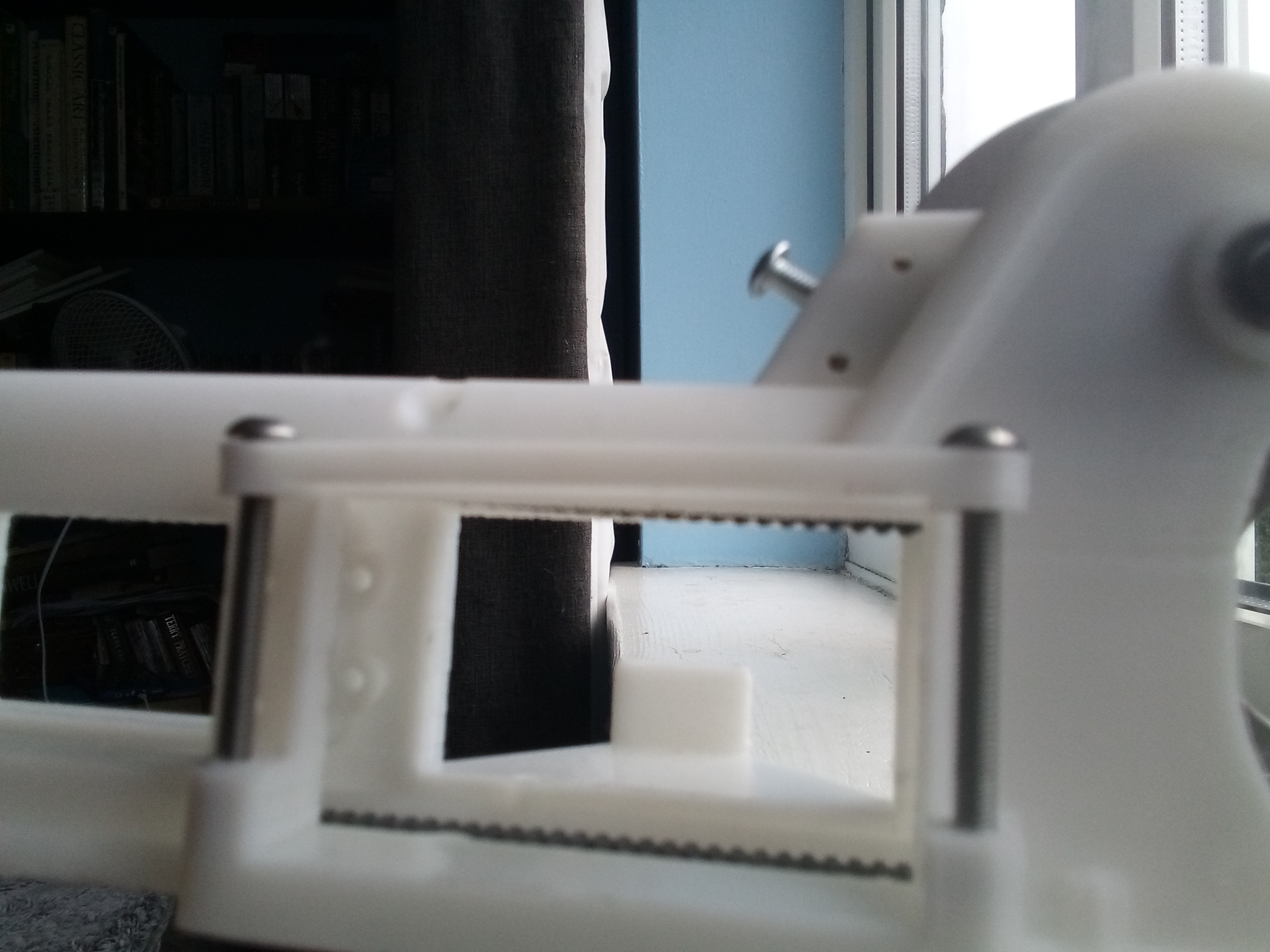

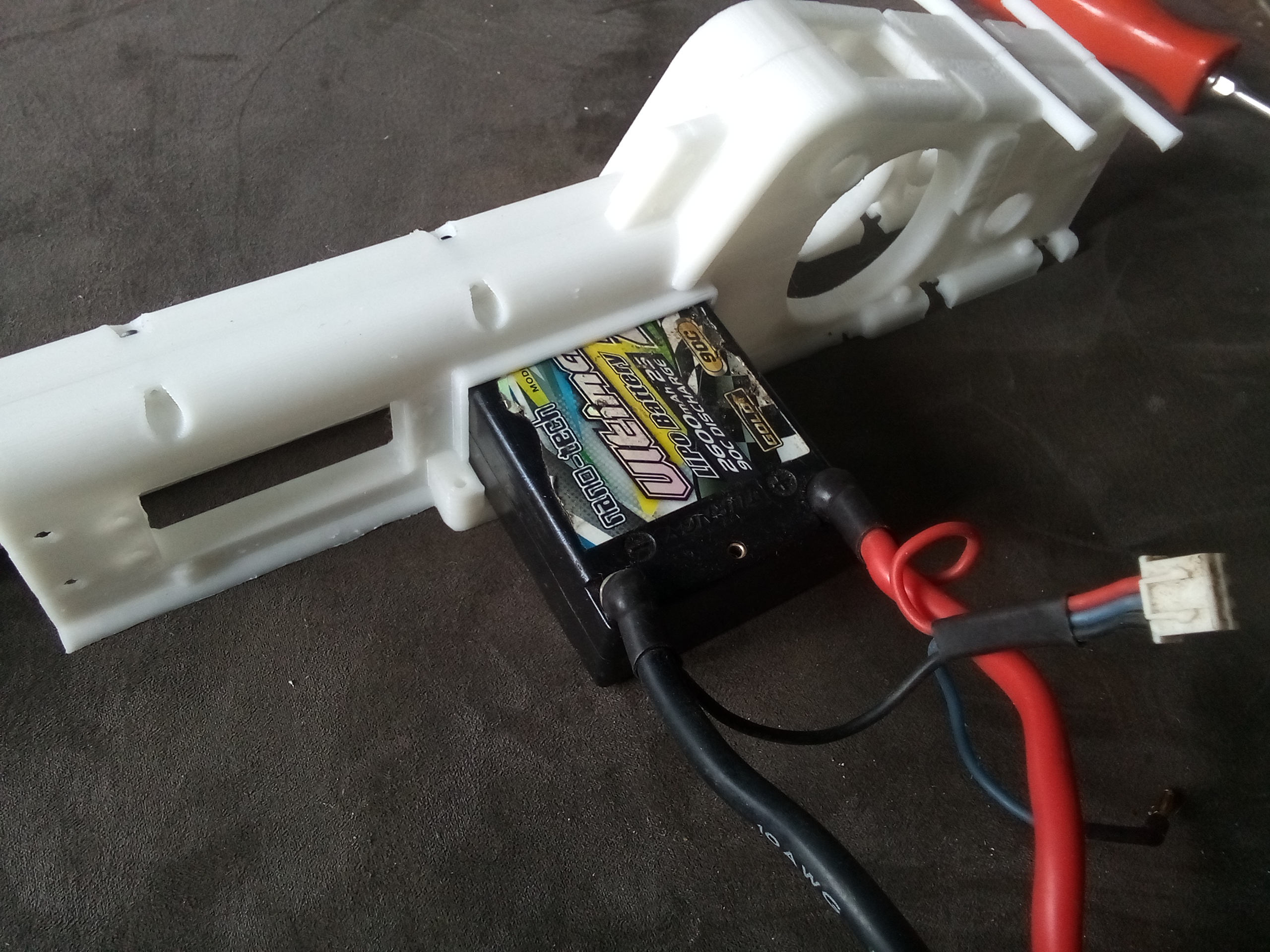

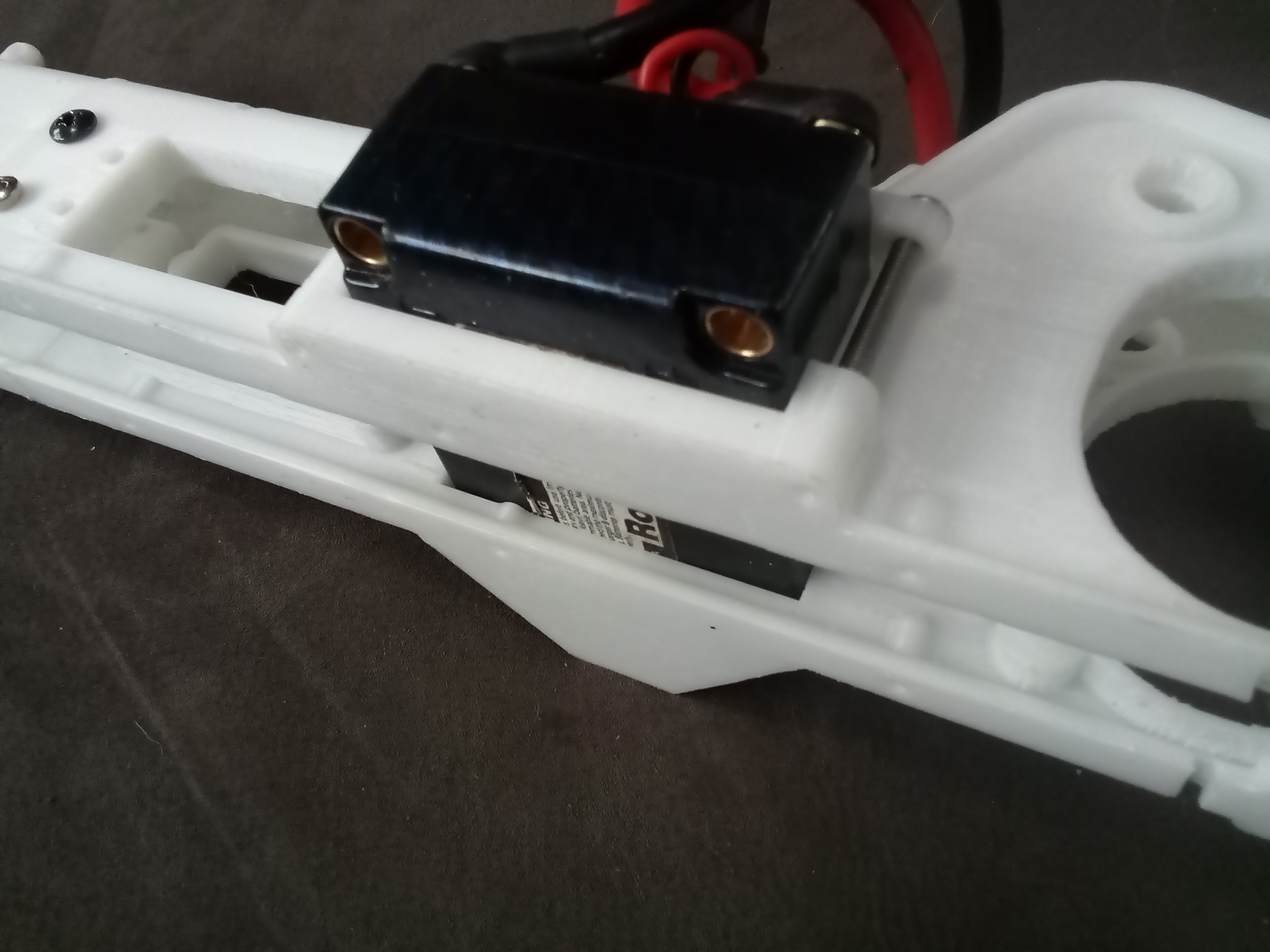

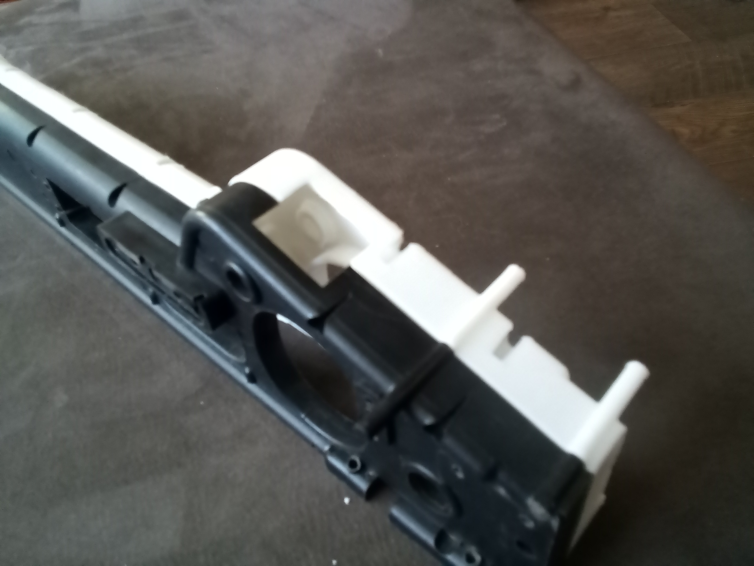

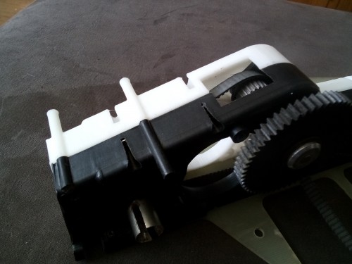

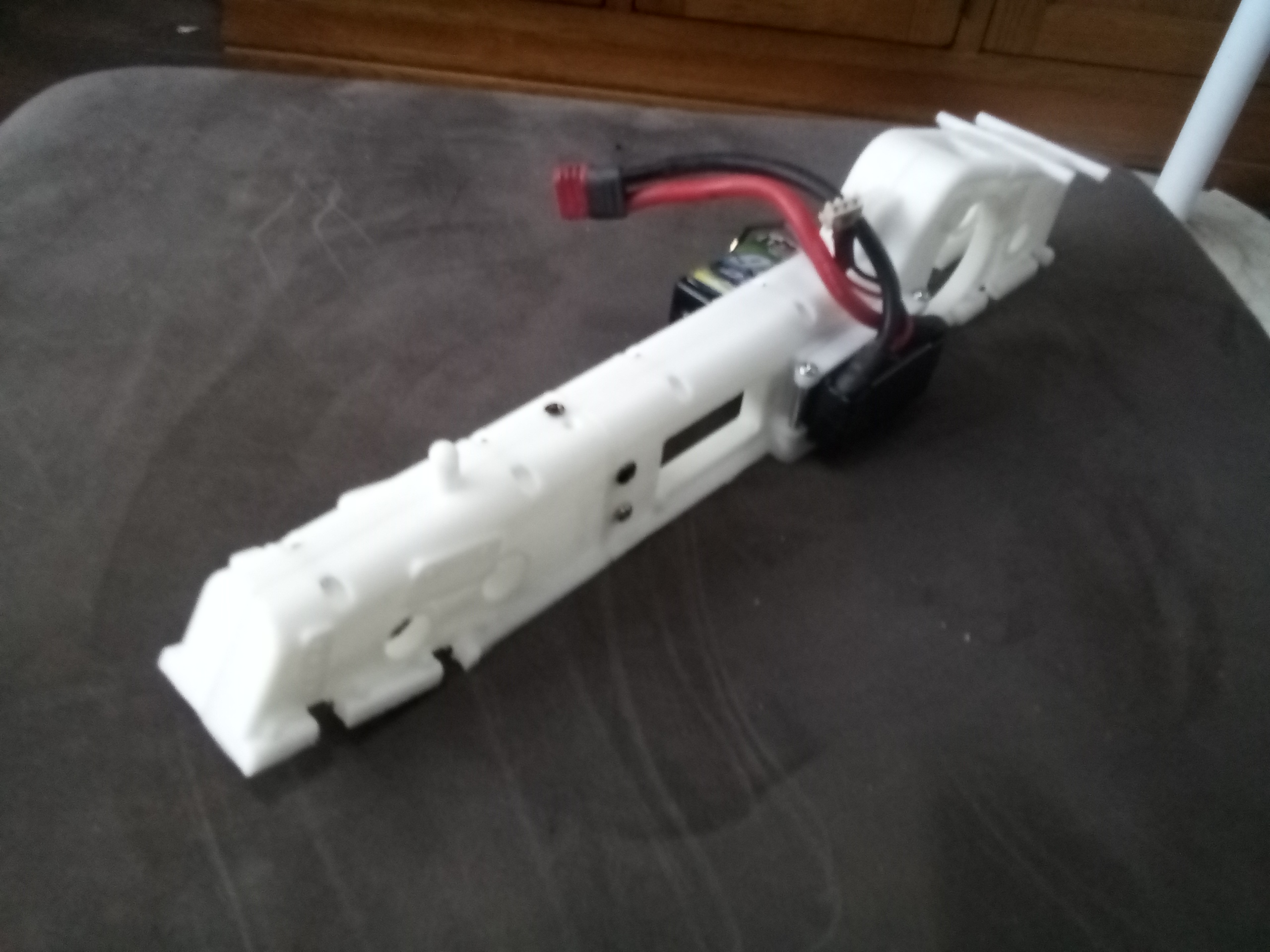

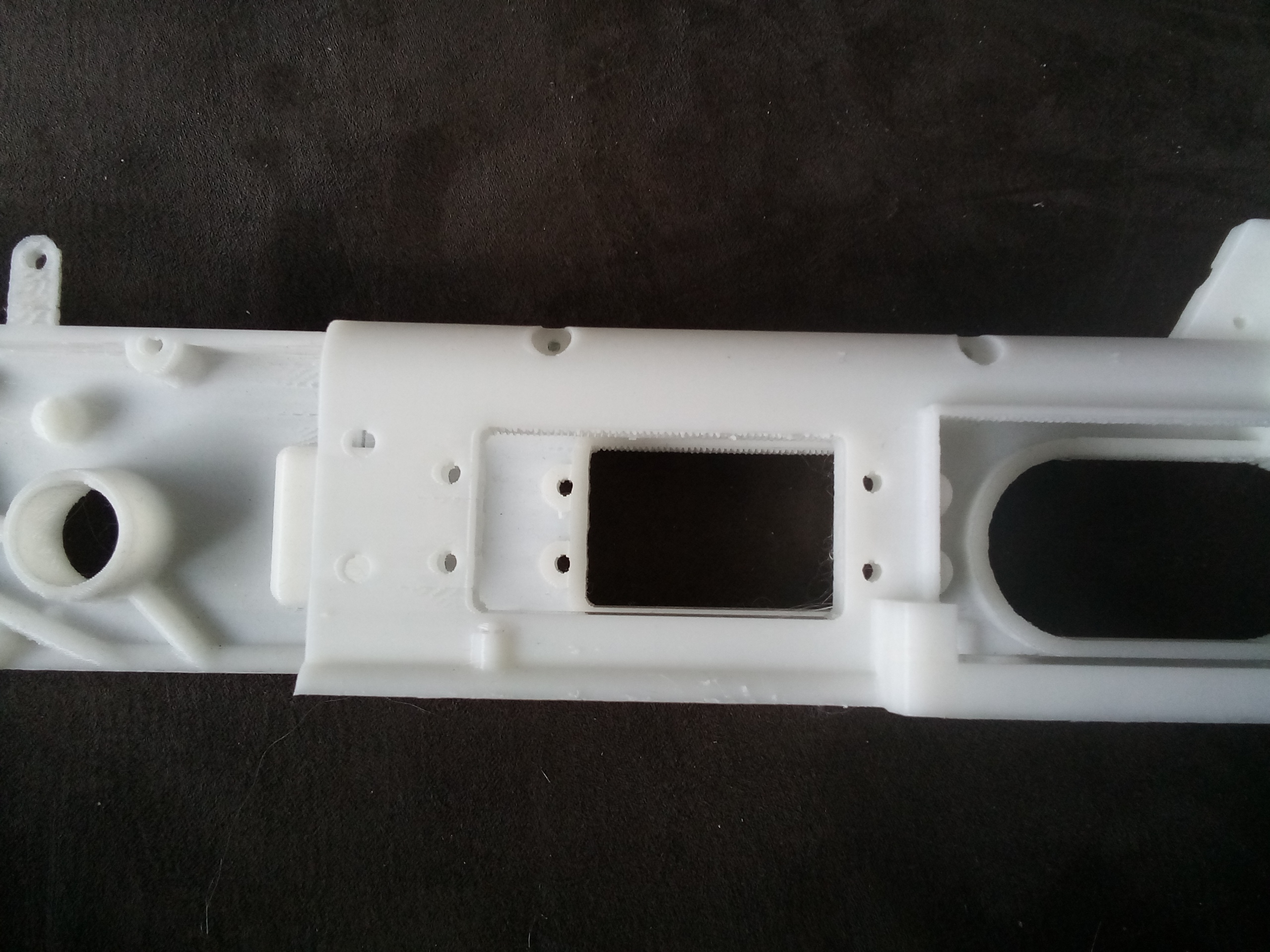

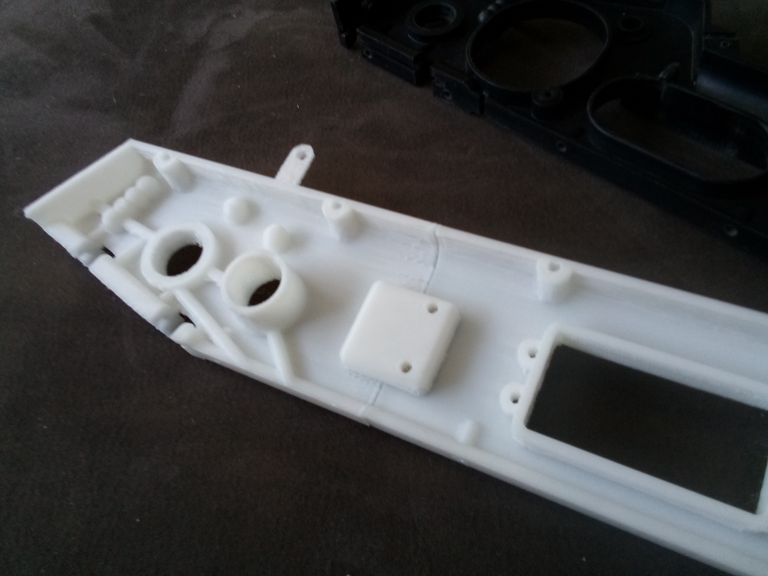

Mini Mustang lipo shorty chassis is half test printed , from the pictures you can see the nylock nut for the belt tensioner and an enlargement of the flange to accept a second screw to help secure the nut , battery fitment showing relocation forward by 12mm of the battery and servo , unfortunately they had to move to clear the motor plate , I'm going to finish this test chassis so I can be sure the belt will clear the battery then I'll publish it on Cults3d .Just looking at the pictures it might not have been clear , the new design is screwed to the original for comparison .

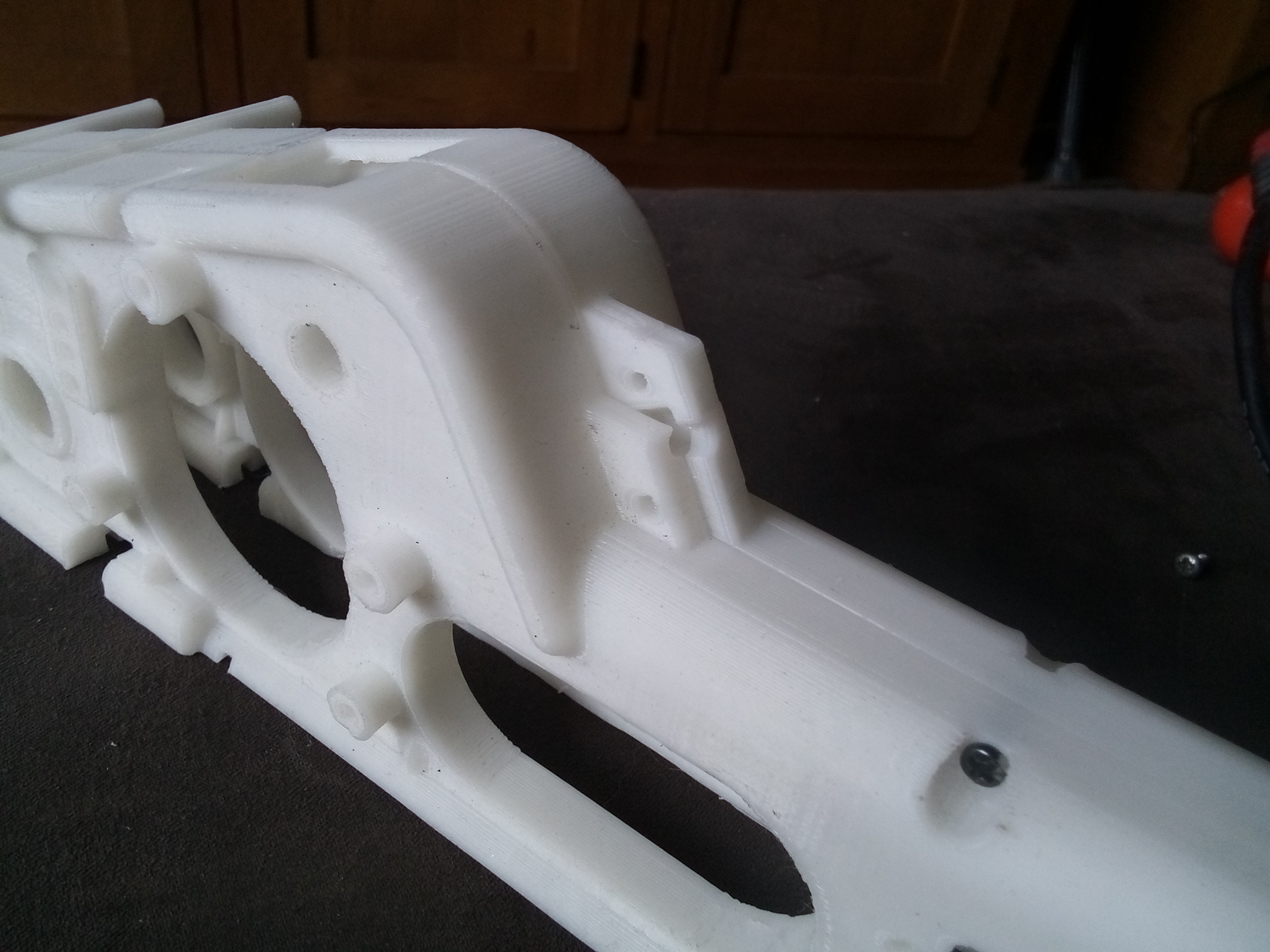

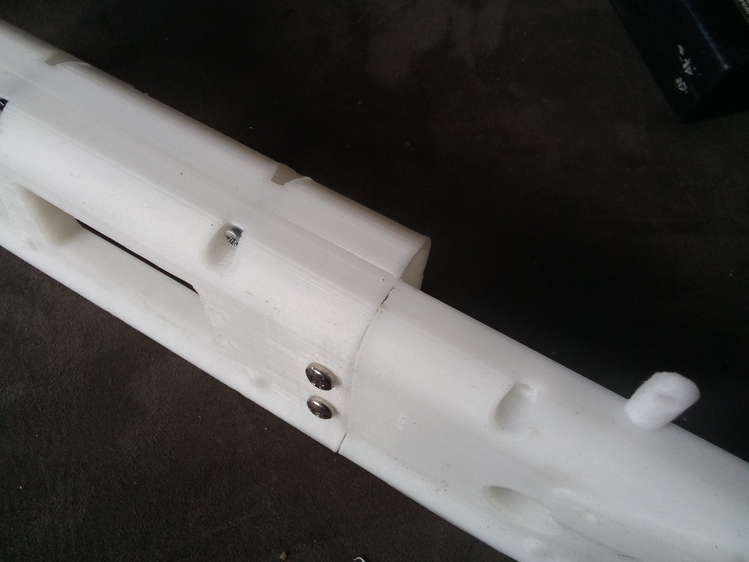

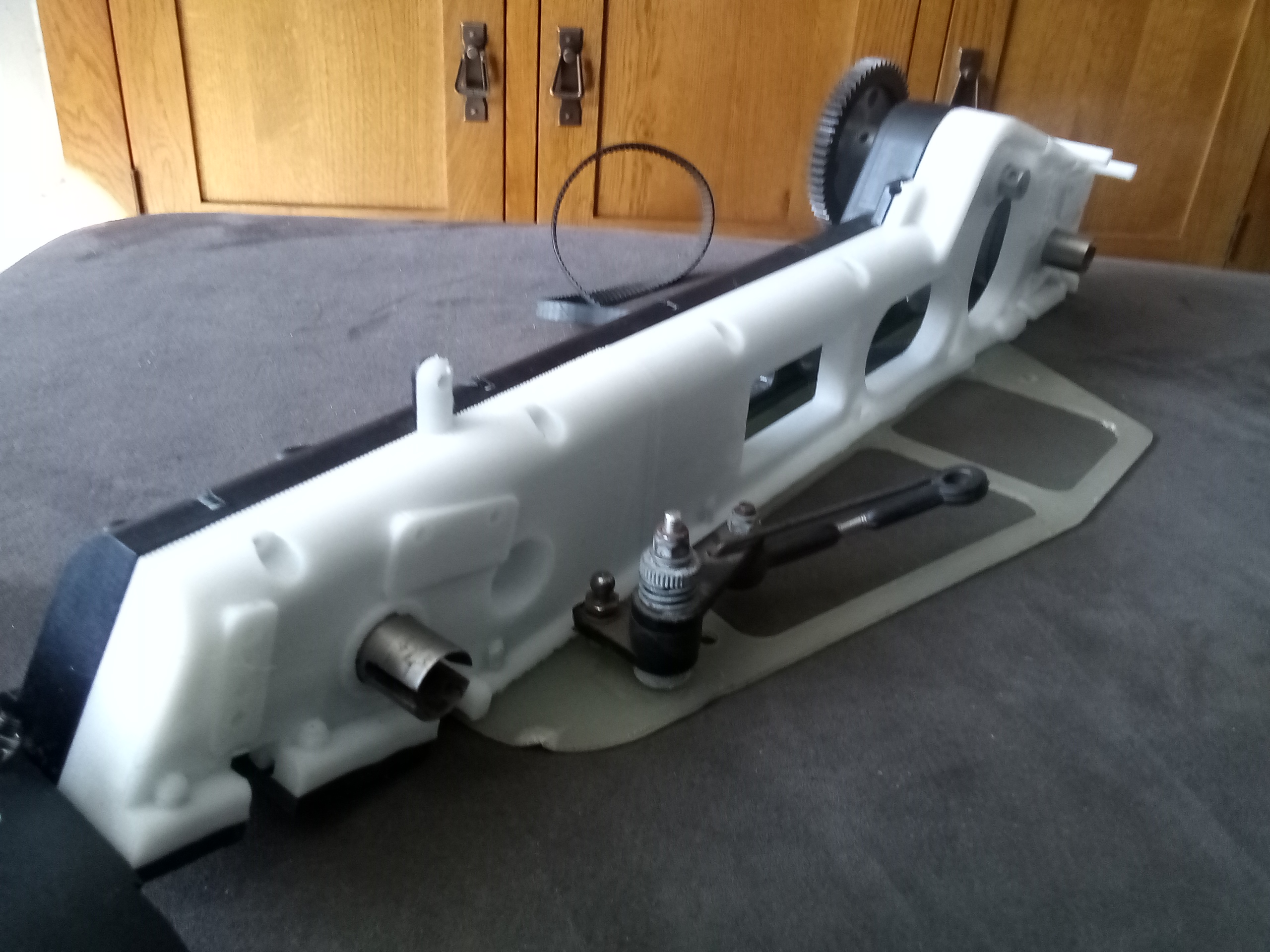

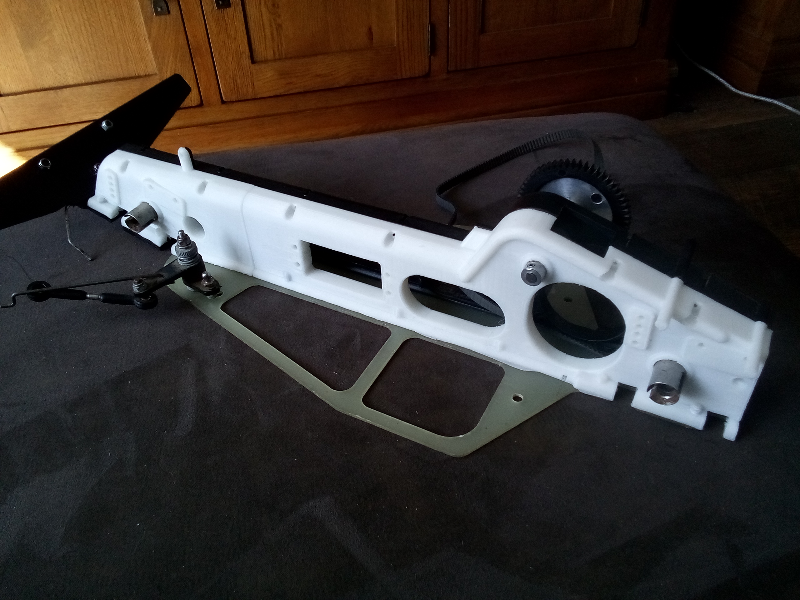

Think I've finalised the Mini Mustang chassis for lipo , got it all test printed and I'll fit the transmission tomorrow just to be sure the belt clears , I added another screw to the joint for the two piece design just to tighten it up .

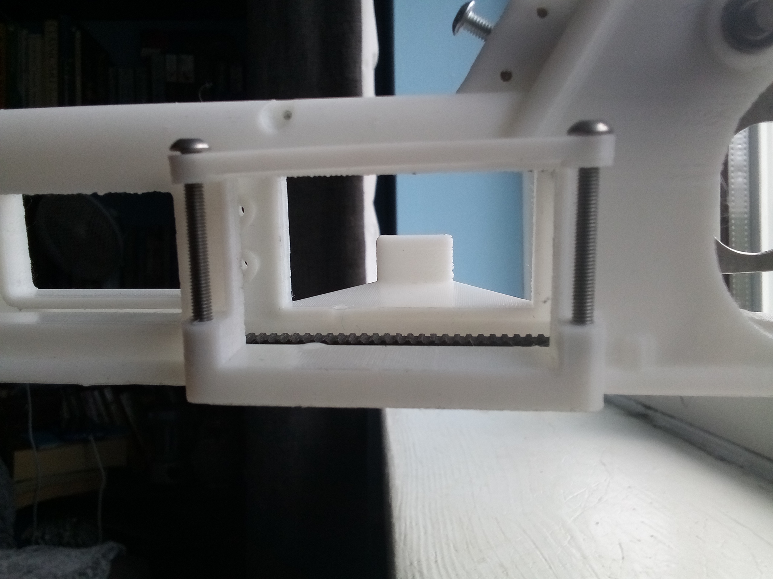

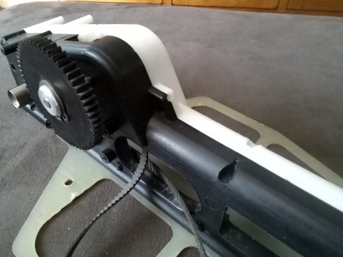

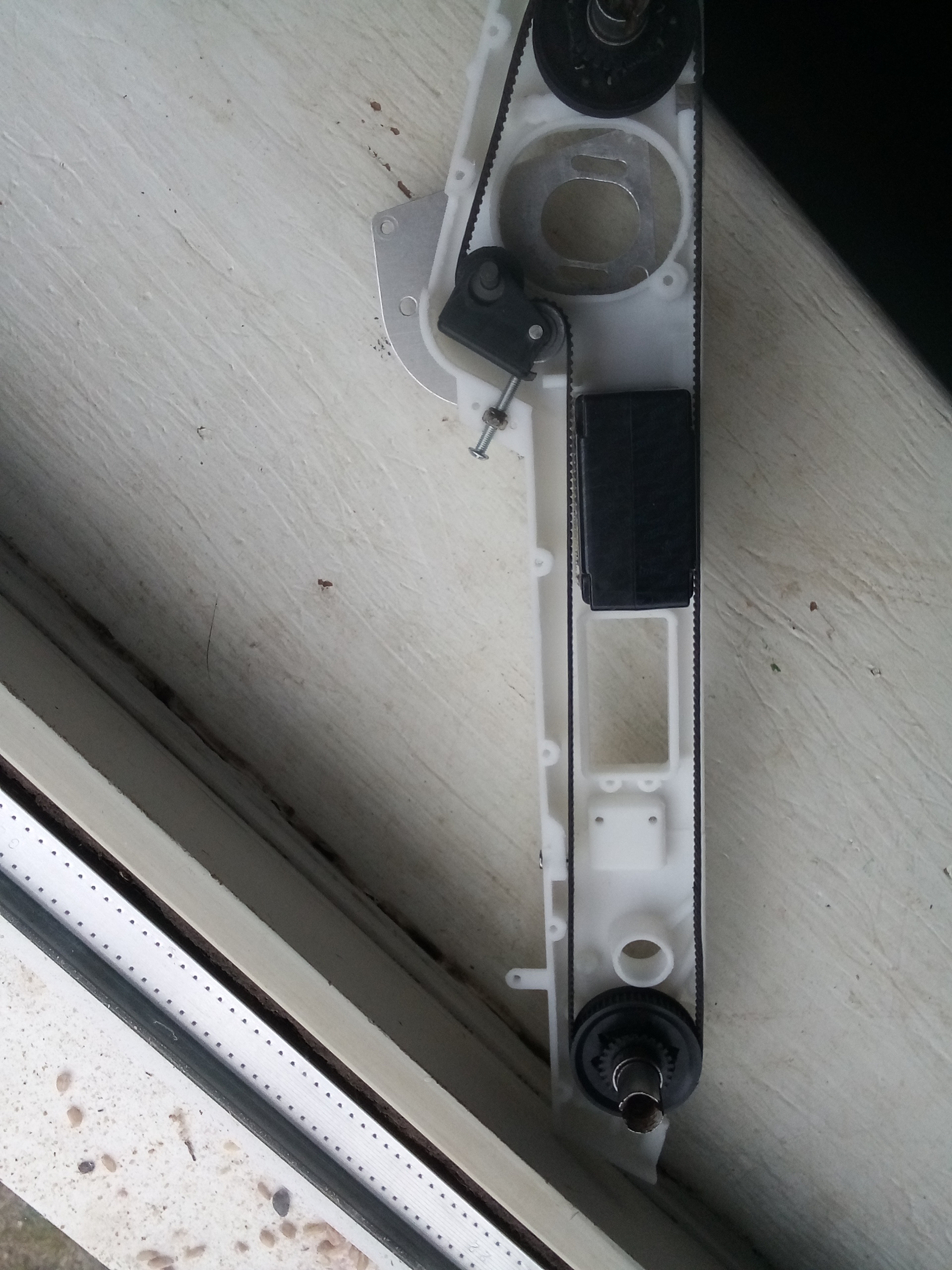

With the transmission in the belt just intrudes into the battery aperture by about 0.5mm at the top rear but clears the bottom it easily clears by about 3mm , the solution is simple ,just lower the aperture by 1mm or 1.5mm , the aperture is taller than the shorty lipo I'm working with anyway so 1mm should be enough.

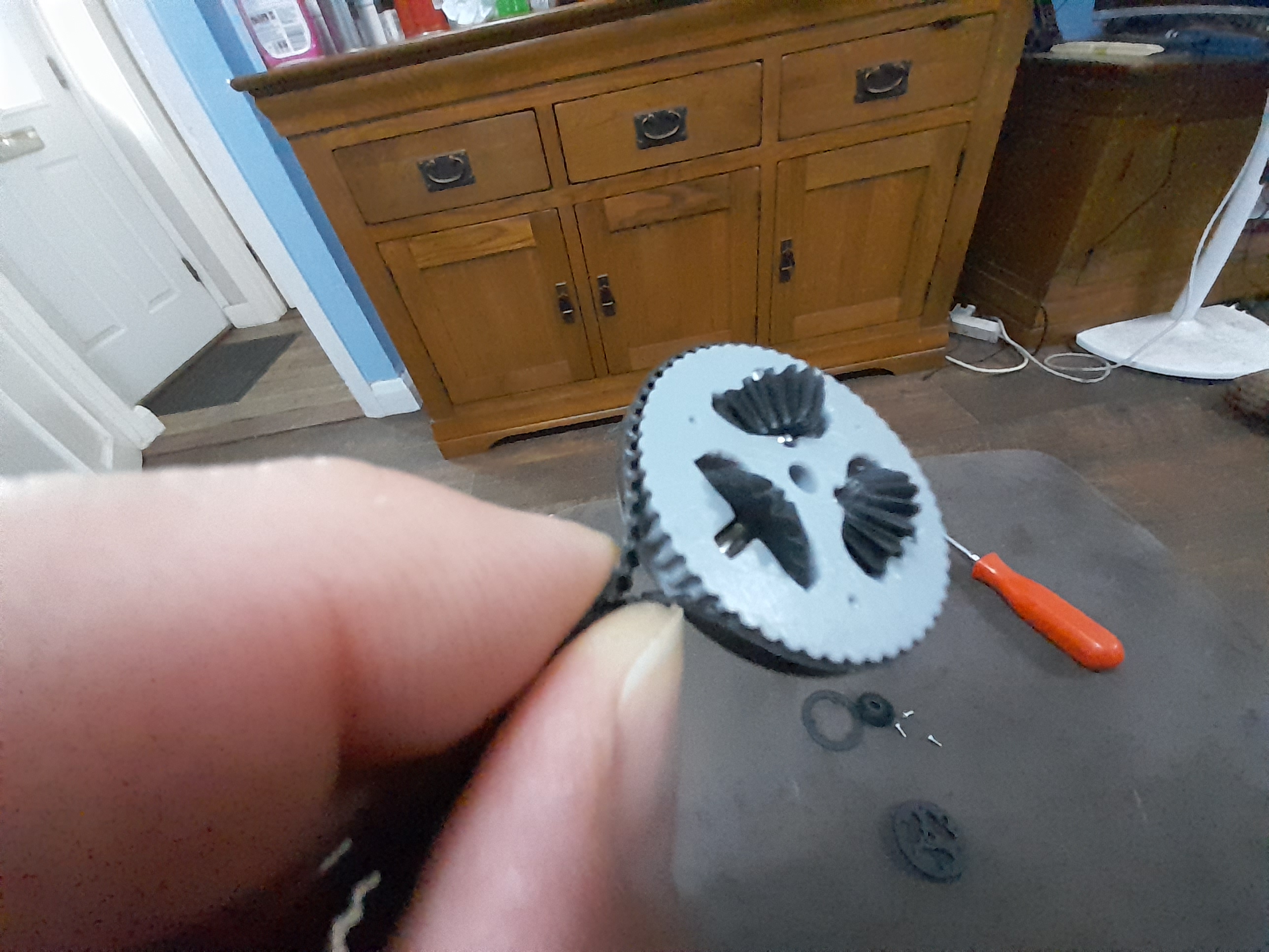

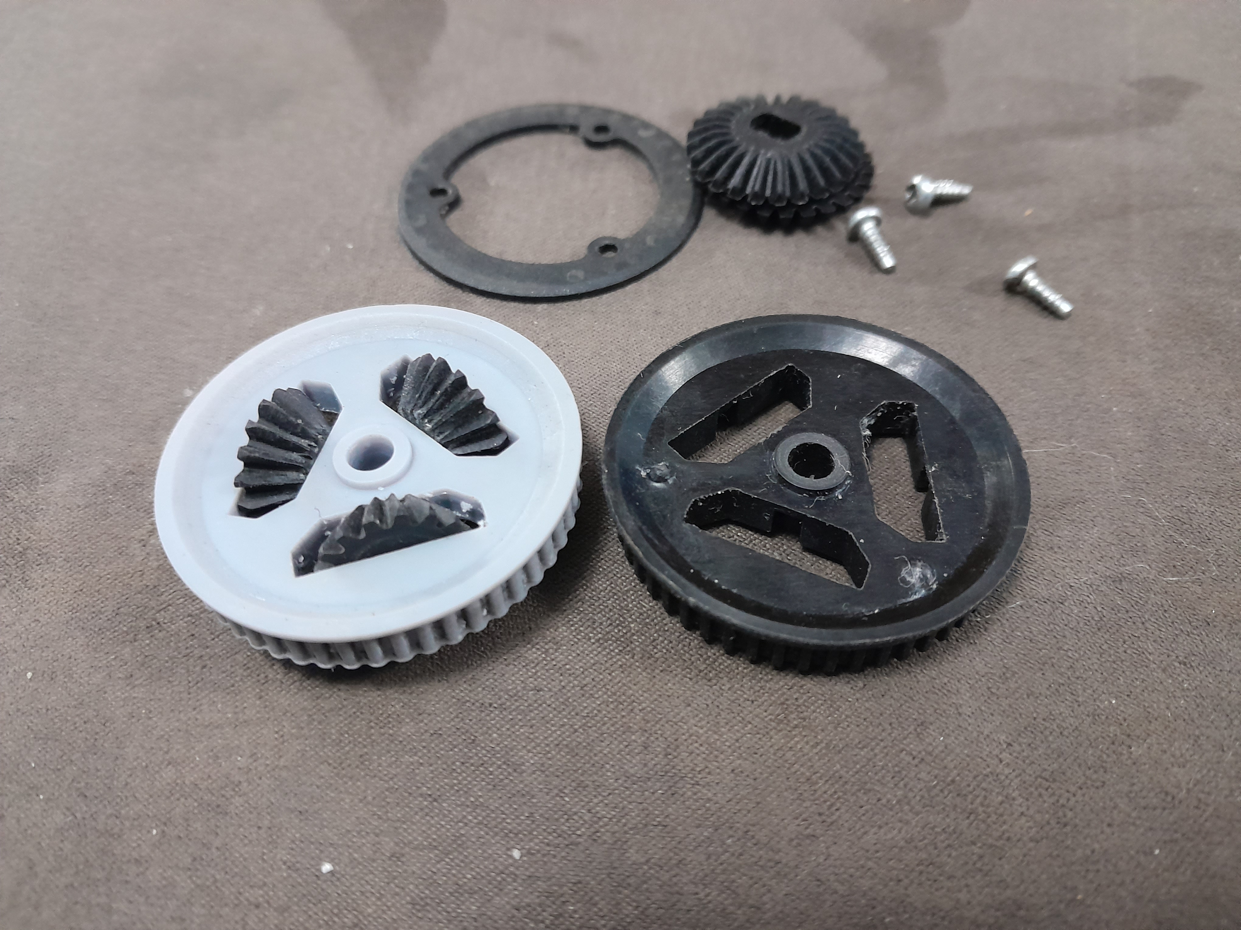

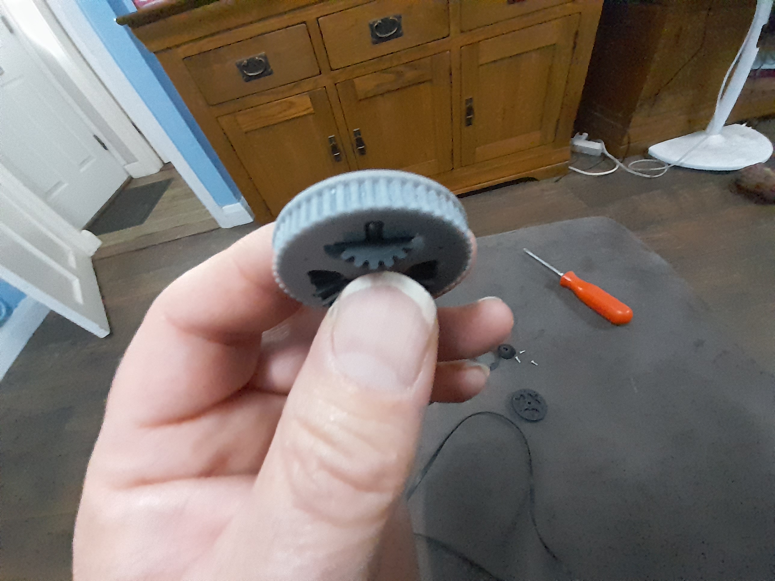

Started modeling the Mini Mustang diff , the belt mesh is good , the teeth look a bit wooly at the edge in the picture's but its just from the print process where it swells as it touches the bed , the only adjustment needed is to move the screw holes slightly .
I'm going to have a go at modeling the bevel gears as well .If a jobs not worth doing then its certainly not worth doing well.
