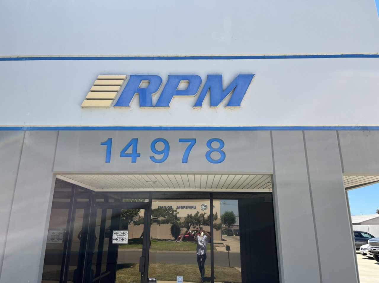

Yes and he was extremely generous with his time. He took about 1 1/2 hours out of his day to show me the factory and the process of parts creation from mold creation though packaging. That process is intense.
I also got to hear a lot of stories about the early days in rc and specifics on the ultra molded buggies and trucks.
The whole crew over there was very kind.
Although I asked nicely there isn’t going to be a re-release of the ultra molded cars. Remaking the mold would just be too much trouble.

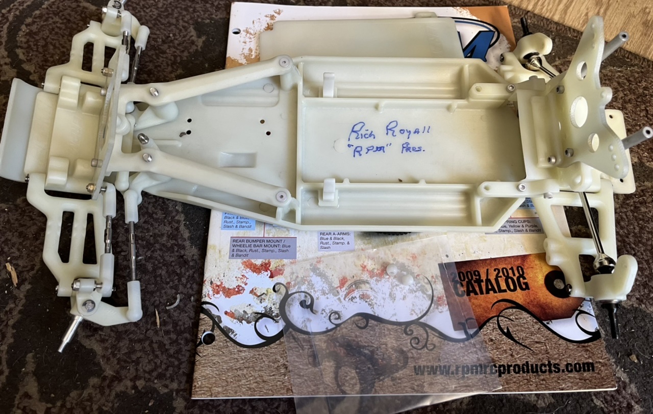

I had my chassis factory modified. I think he is done with signing chassis after this one. He mentioned that he only signed one other.
There wasn’t anything left from that far back. Richard was kind enough to give me a part I did not know I was missing and isn’t on any sheet.

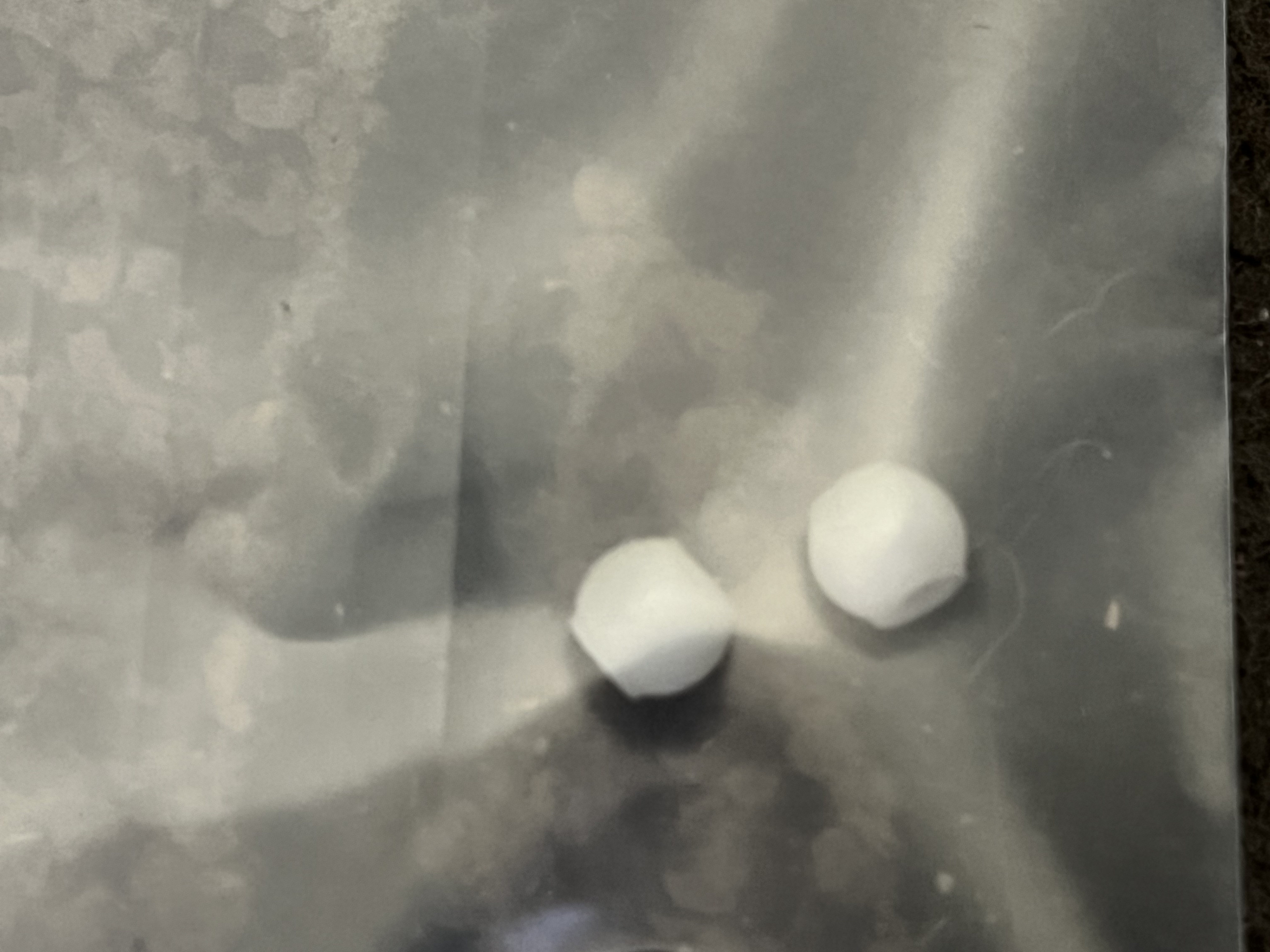

These are the specific Acetal pivots that are used on the front with the shocks. The rear uses the same pivots as the truck.

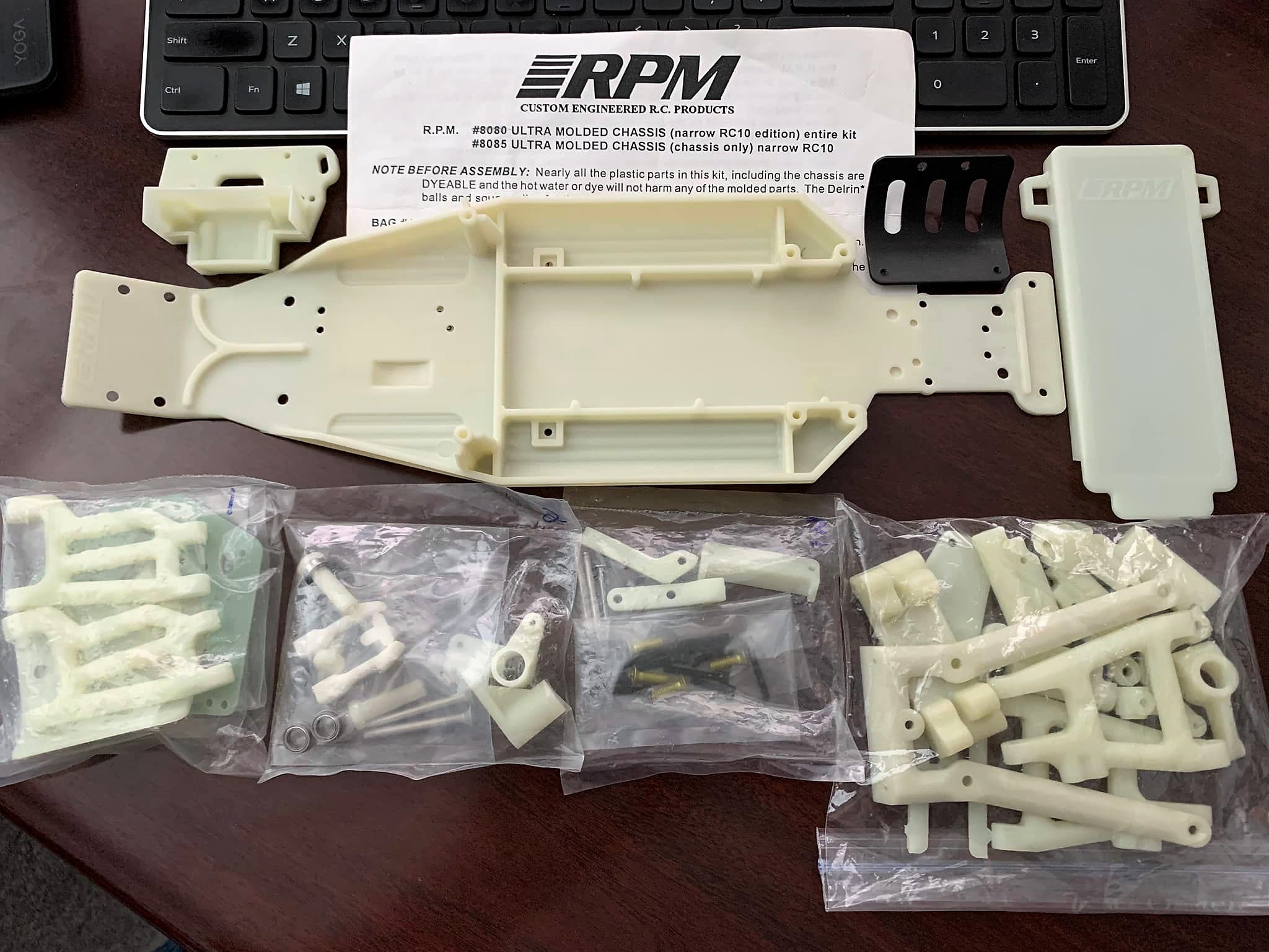

They would have come with that chassis kit, including the shock rod ends and spring cups. Front only.
- Posts: 1901
- Has thanked: 1264 times
- Been thanked: 649 times
Re: Rpm rc10bum
Do you mean there were only rod ends and spring cups for the front? Are the pivots compatible with the AE RODS ENDS.
Do you happen to have a list of everything that it would have come with? This kit seemed pretty complete but it looks like there are a number of pieces missing.

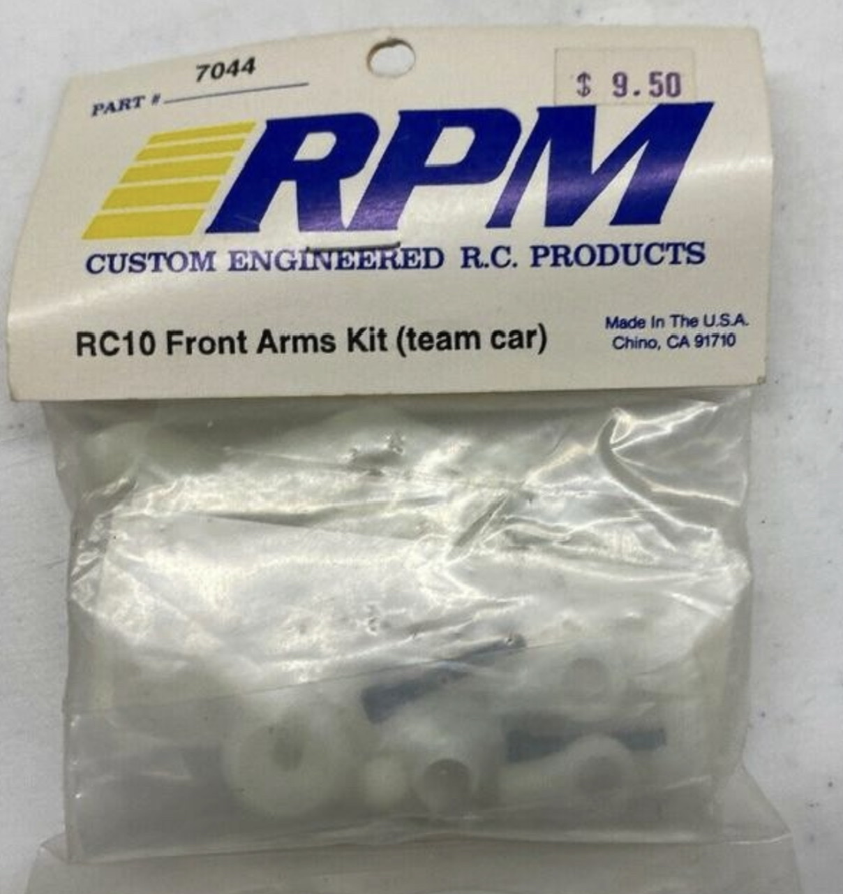

Re: Rpm rc10bum

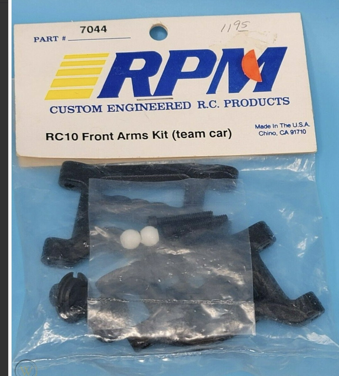

Also came with the “team arms”
Instructions are here, however no pics or parts list
https://www.rc10talk.com/viewtopic.php?t=28575

To add to your list, as scr8p pointed out, it's also missing the translucent white front shock cups, shock shaft rod ends, and the preload spacers.JosephS wrote: ↑Sat Jul 02, 2022 10:48 pmGreat to know. I want to see about getting a full parts list together before I start buying but the offer is nice.
It looks like it’s missing
- transmission brace
- motor mount brace
- 1.5 degree rear arm mount
- delrin shock pivots
- original instructions
- header card

Thanks! I have a feeling that the 3 bags in the kit were the chassis, Worlds front and Worlds rear kit. It's nice to see all the parts laid out so clearly and see that it came with pins. Apparently even though this was a short run vehicle the picture show the early version front shock tower that was made by associated. The manufacture later shifted somewhere else and those towers don't have the nose tube holes cut in them.
