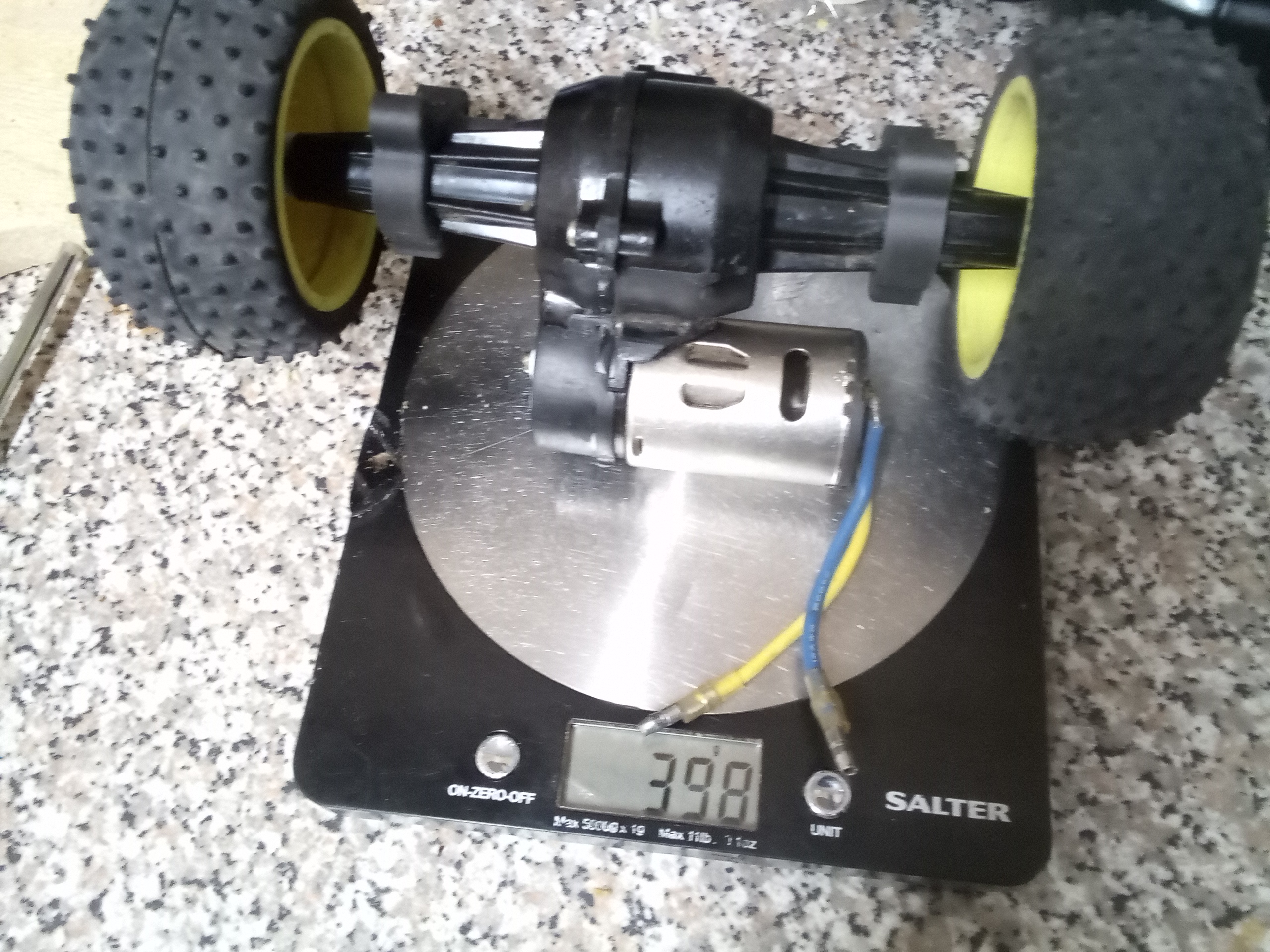

Just out of curiosity I weighed the whole caboodle , 450g so shedding 40g from the wheels is not negligable but I can't see me shedding near to another 40g , maybe another 20g ? That would be over 10% loss , might help .

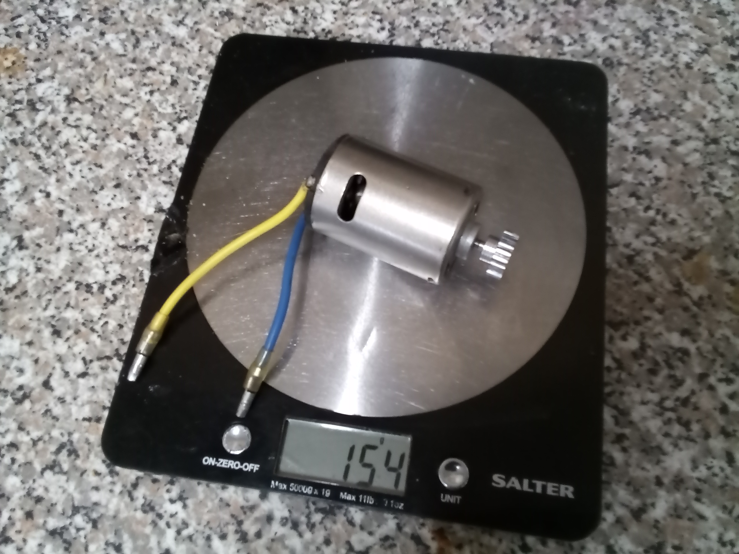

Motor is 154g by itself .

Made adapters for 12mm hex wheels , fitted the FC axle for the spur gear , made a light weight pinion gear cover and replaced the oil fill cap with a small piece of Lexan .
That's 52g reduction or a tad over 10% , it's pitch dark now but I'll give it another test drive in the morning .If a jobs not worth doing then its certainly not worth doing well.

Just found some BL 2440 motors on eBay that are a direct swap for the 380 motor and they weigh in at between 50 and 68g , less than half the weight of the 540 at 154g potentially losing 100g and that's a worthwhile number .
