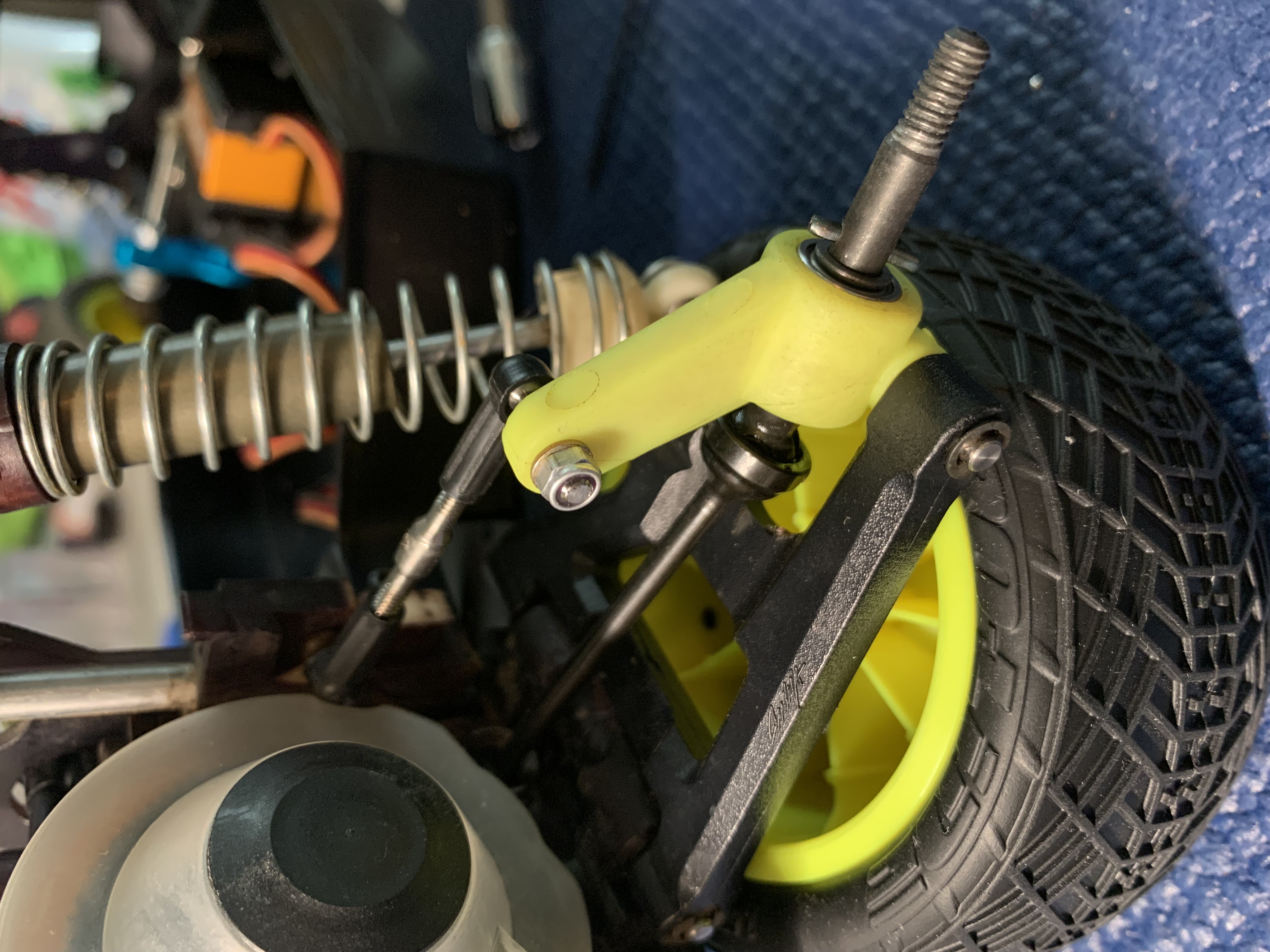

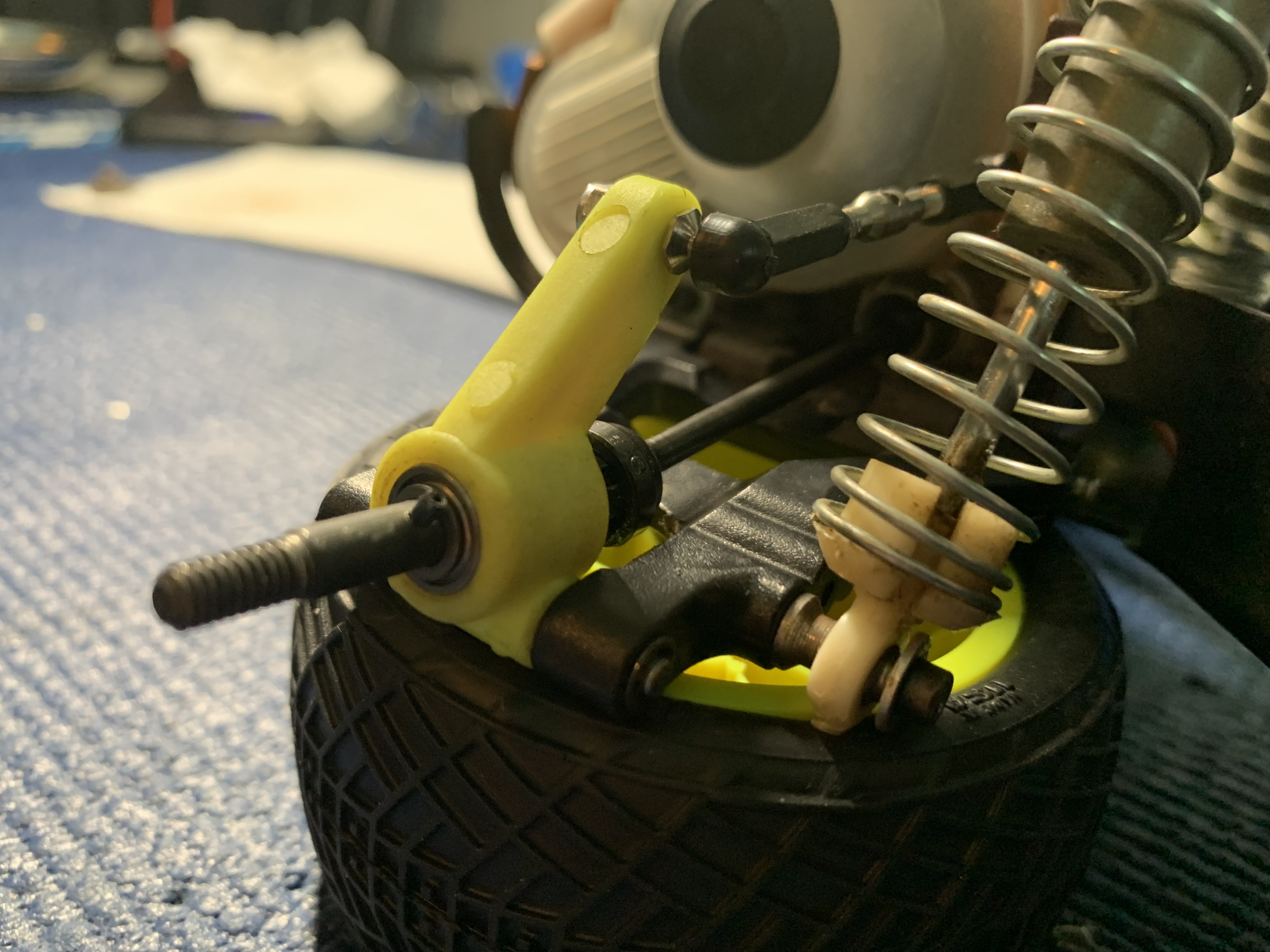

Good afternoon. I recently bid on some parts for my RC10 ($50 shipped!!!). They came, and I was able to install the below Hubs and CVs. I have no idea what they would have been from. They fit really well, just a little play that I put some shims in for. Does anyone know what version of RC10 they might have come from? (Maybe the one suggested on this thread?)
Evolving RC10 from 1985, Original Owner!!
- Posts: 1876
- Has thanked: 1245 times
- Been thanked: 640 times
Re: Rear Hubs
There were quite a number of rc10's that could have been from. Associated issued a kit at one point that used those hubs and axles for converting an older rc10 to 3/16" axles. I have one of those sets.rfulcher wrote: ↑Fri Aug 05, 2022 2:33 pm Good afternoon. I recently bid on some parts for my RC10 ($50 shipped!!!). They came, and I was able to install the below Hubs and CVs. I have no idea what they would have been from. They fit really well, just a little play that I put some shims in for. Does anyone know what version of RC10 they might have come from? (Maybe the one suggested on this thread?)
It was also used in the rc10DS, GT and some models of the rc10t. The hubs were used on the re-release version of the rc10. The 3/16 dogbone stub axles were used on the rc10t2&3 sport and some models of the rc10 (b/t) 4(.0)

The carriers were used on the Worlds car, 10T, GT, and T2.
