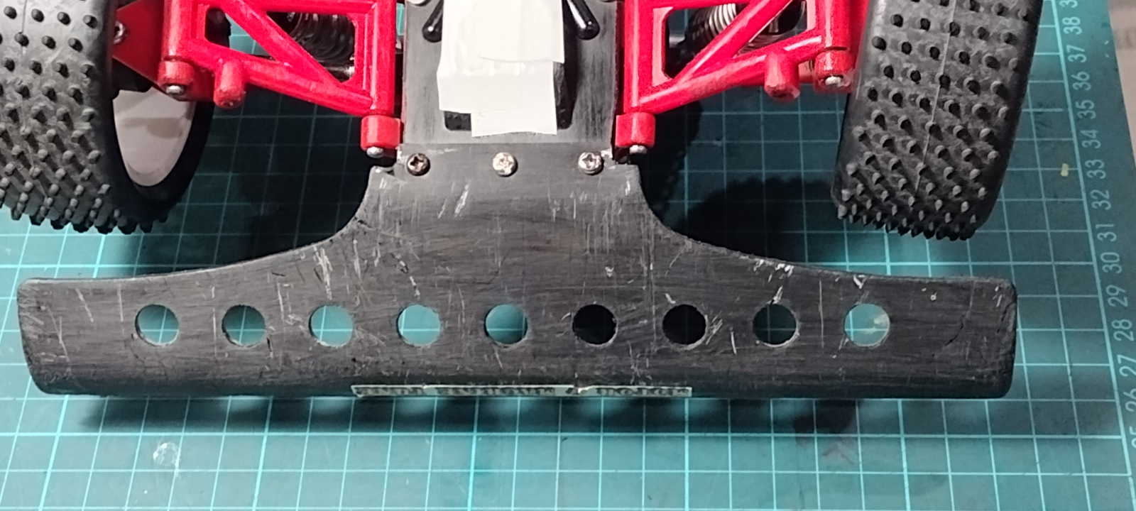

Ten minutes during the post lunch coffee was put to profit to design the Zerda bumper based on 3 sketchs and 3 extrusions...
I'm not even sure I spent 10 minutes doing this...
If anyone has a NIP/NIB Zerda bumper, I would love to se some pics of it's underside and from the sides : I'm debatting about the ends being used by runs or being done a certain way by design...

Not new but two used ones very similar smooth finish. At least 2 layers of paint removed. There's a nice pic Google images of one with "HIROBO" engraved on it
[attachment=0]Screenshot_20221104-180804.png[/attachment]

It's very easy to make those bumpers , it's just 3mm Kydex , you can get it on eBay , it softens in an oven at 150°C or if you just want a bend then a hot air gun works very well .
