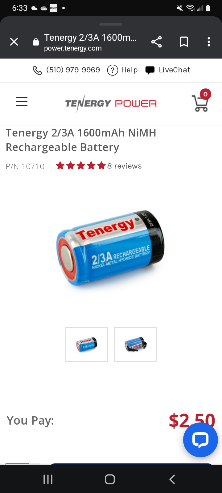

Are you referring to a 2/3A cell?V12 wrote: ↑Fri Nov 25, 2022 5:32 am The battery for the receiver and servos was 5 cells usually. Regarding the size I don´t know the name of the cells, but they are larger diameter and much shorter than AA cells. Sanyo made those cells I think maybe 450 mAh capacity. Could be also up to 600 mAh maybe depending on type and production year.

Additionally, those are available with or without battery tabs preinstalled.
This Ruddog pack is available in the configuration you describe.Create an account or sign in to join the discussion
