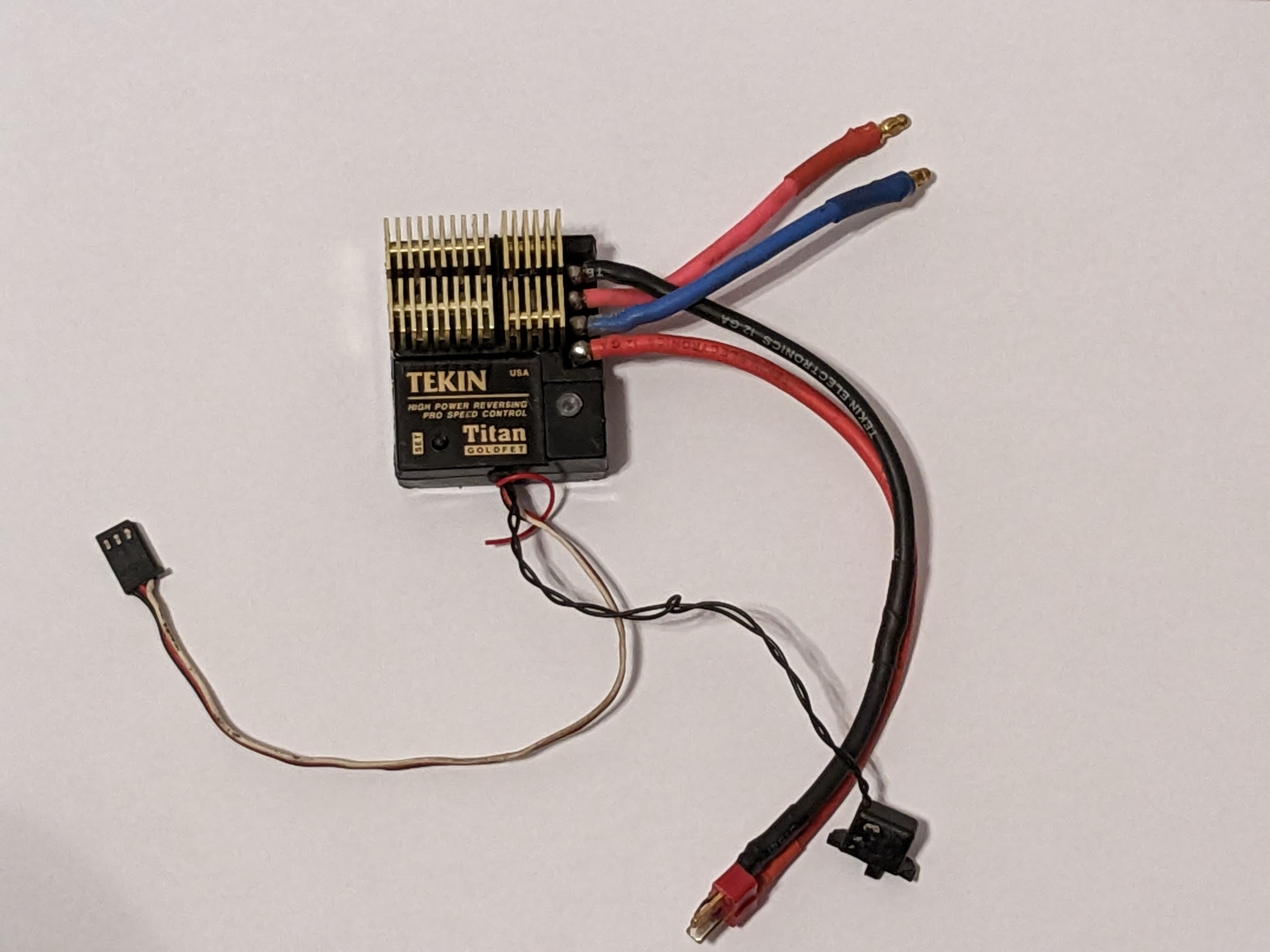

I have been hunting for a nice Tekin Titan ESC and took a chance on an untested unit. It passes power to the steering servo and the light indicates that the throttle calibration works, but it won't turn a motor. Does anyone know of someone that does ESC repairs? Any personal experience with their work? I hate to leave it as just being a paper weight. I'm a Novak guy but still respect a brute like this.

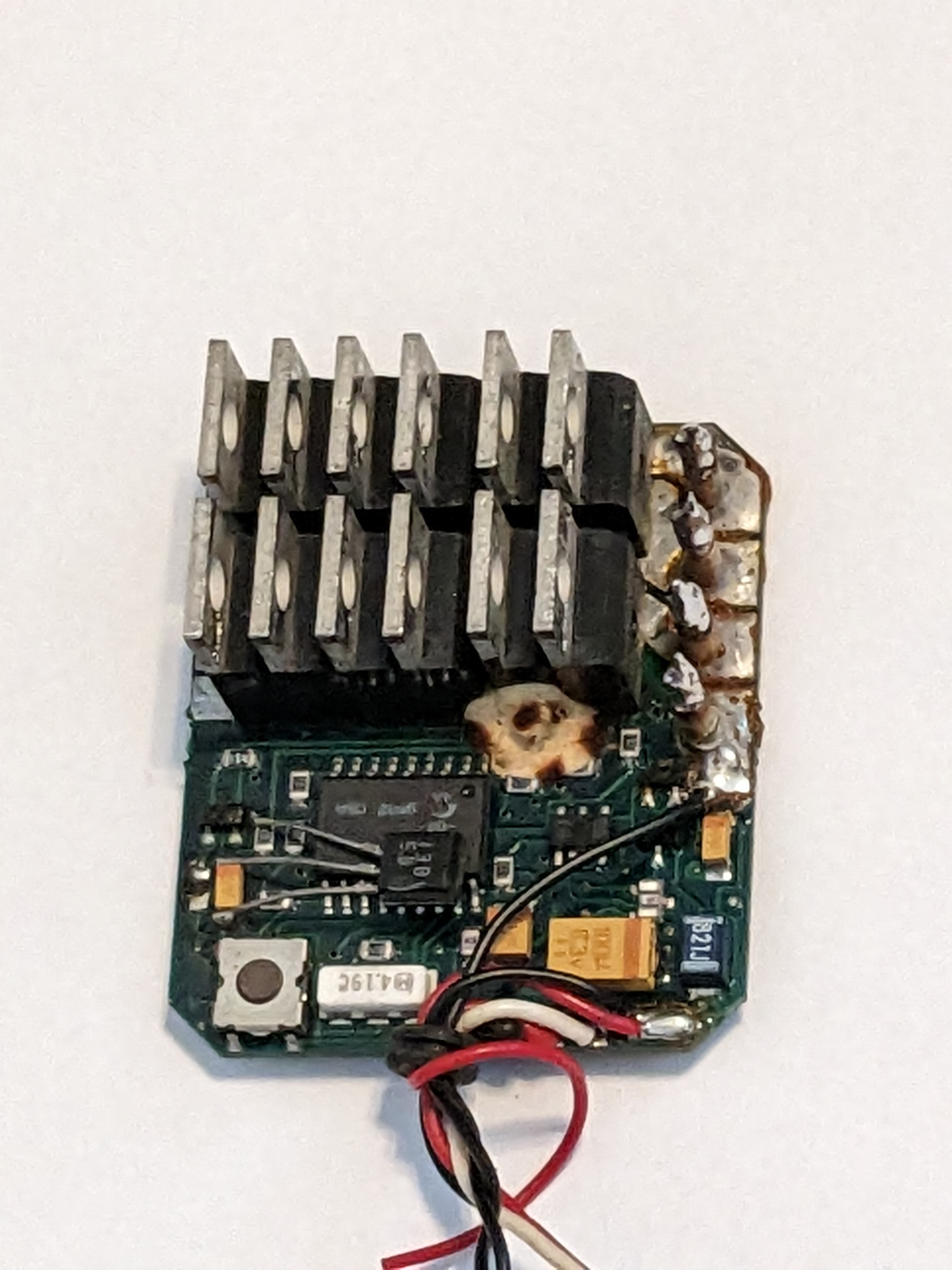

Sounds like the internal fuse is blown. The later Tekins used a external solder bridge as the fuse. At least the BEC circuit is ok.Frankentruck wrote: ↑Tue Jan 24, 2023 8:57 am I have been hunting for a nice Tekin Titan ESC and took a chance on an untested unit. It passes power to the steering servo and the light indicates that the throttle calibration works, but it won't turn a motor. Does anyone know of someone that does ESC repairs? Any personal experience with their work? I hate to leave it as just being a paper weight. I'm a Novak guy but still respect a brute like this.

I removed the leads so the top of the case could come off. It looks like this ESC was trying to toast marshmallows and make s'mores.
