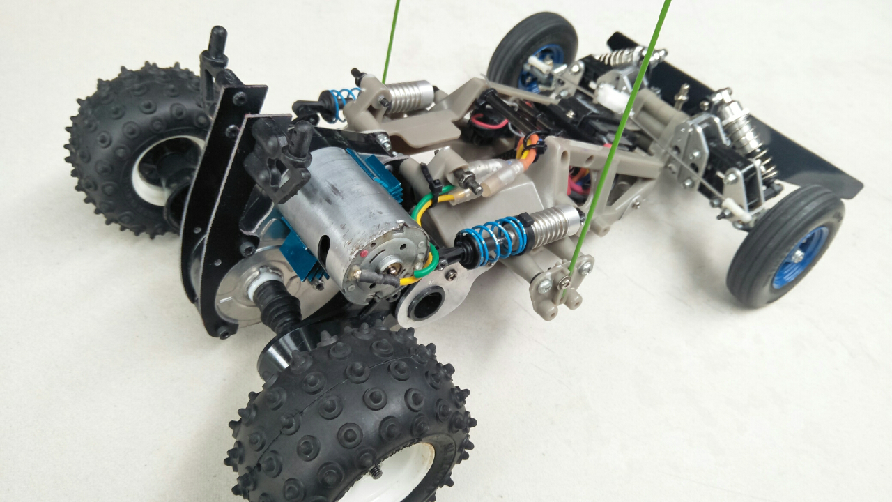

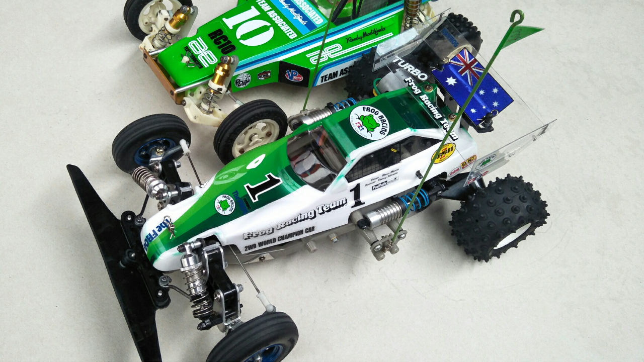

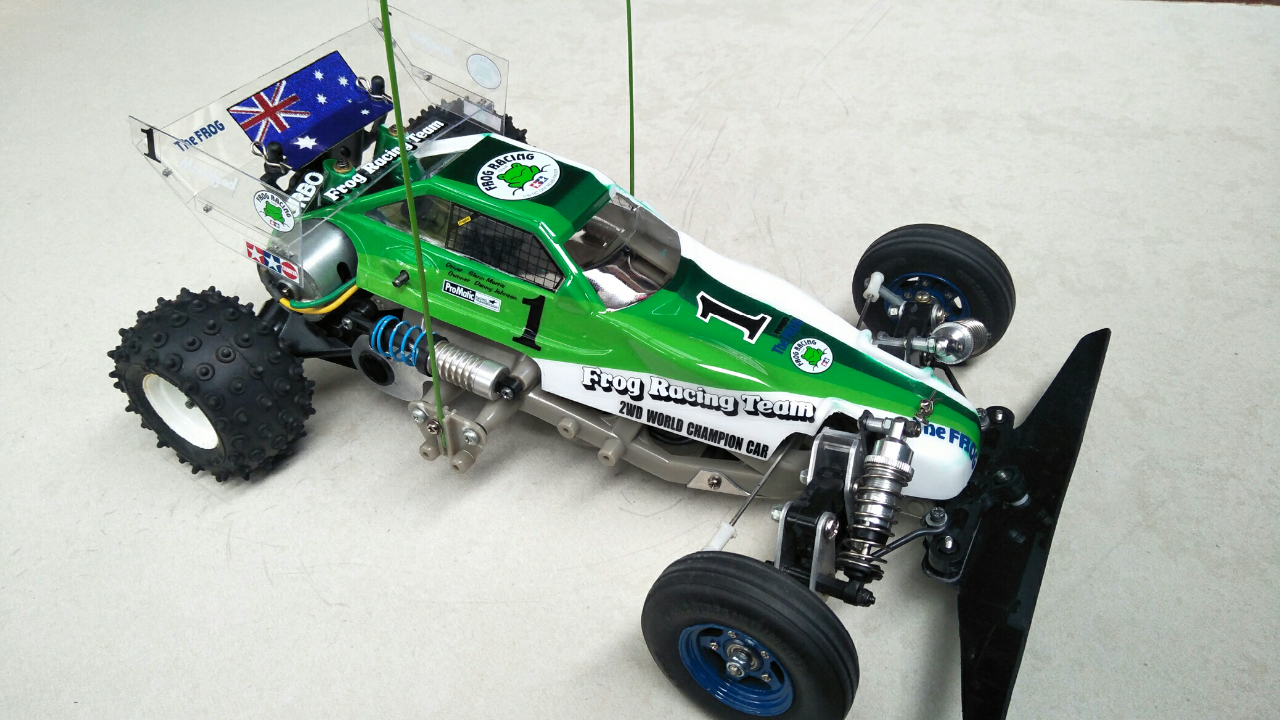

Classic RC10 rival, "Turbo" Frog complete. Mods inspired by re-re Turbo Scorpion. Livery inspired by Jammin Jay RC10 and Frog boxart (behind Frog) 🐸.

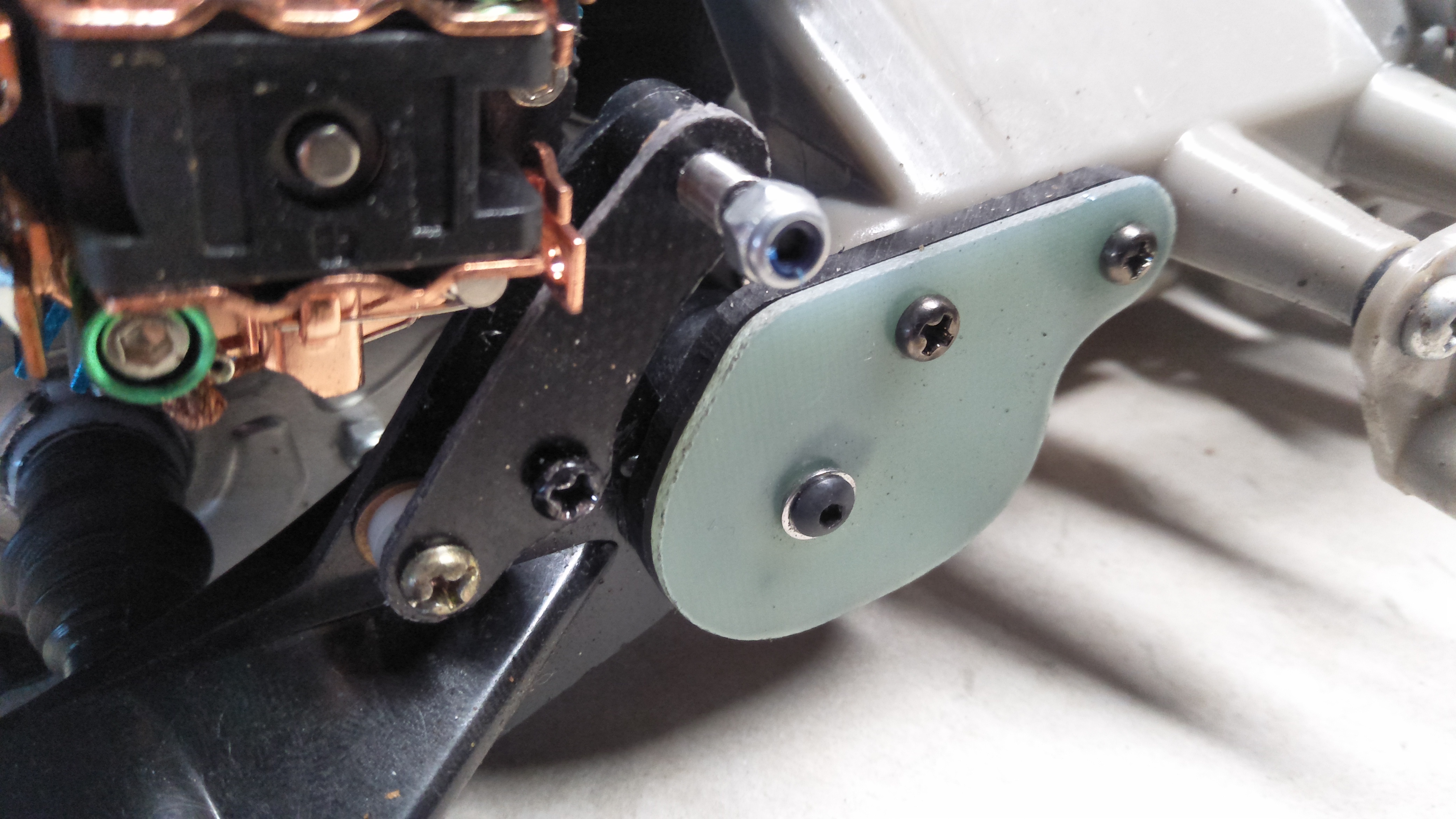

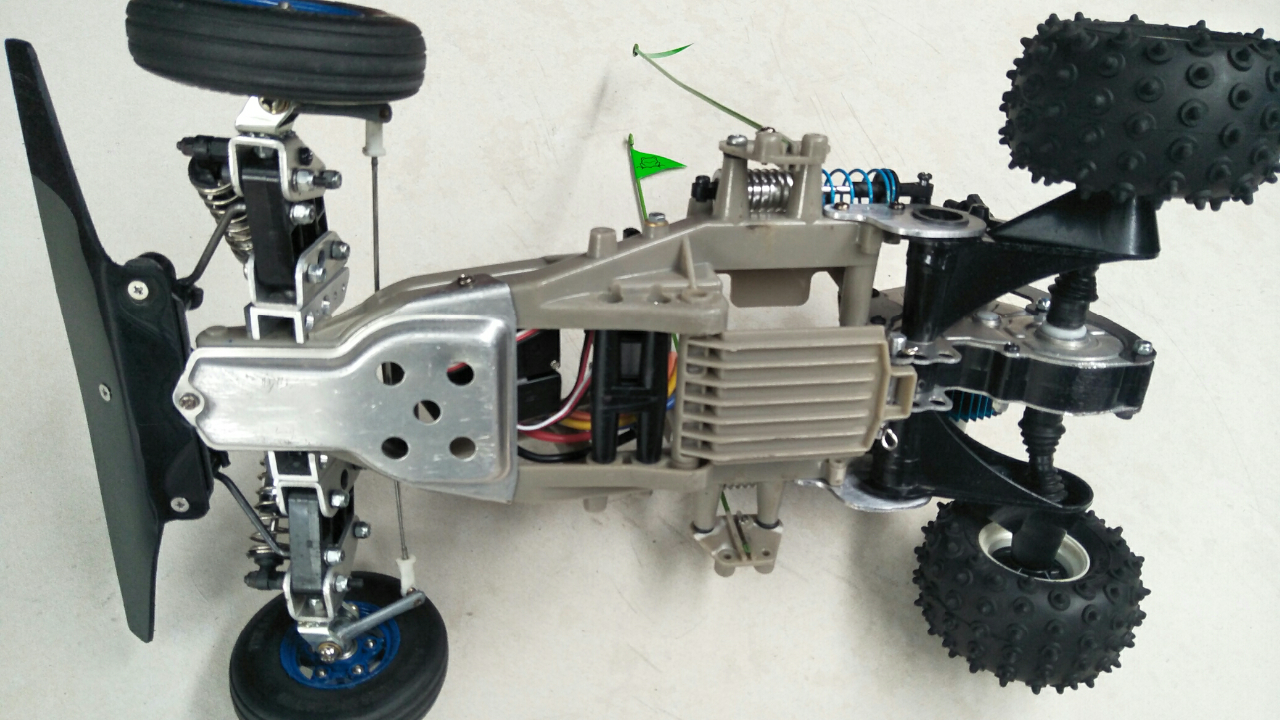

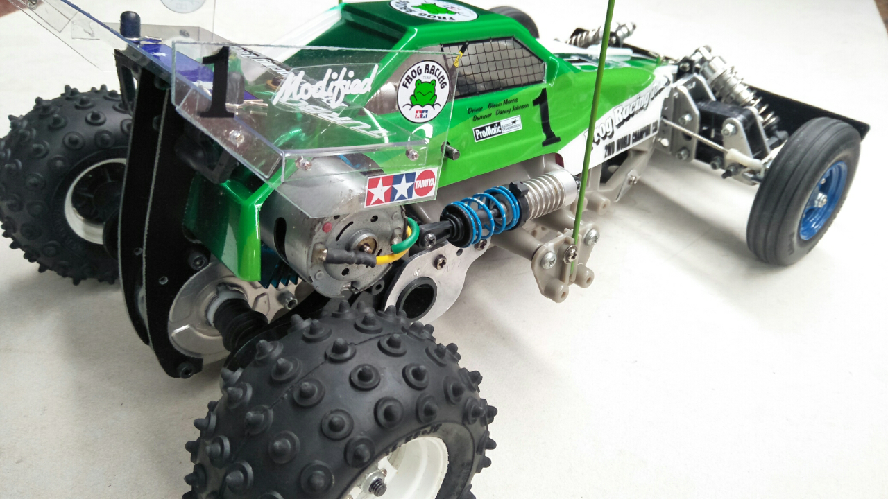

Custom made parts...
*Gearbox mount +10mm wheelbase.
*Rear arm hanger +10mm wheelbase.
*Rear wing mount/rear bumper/body protector.
*Front arm extenders. +20mm front width.
+Front shock towers.
*Front bumper.
*Large bumper reinforcing fiber plate.
*Stealth switch mount.
*Battery harness clip/rod.
*Rear wing.
Custom mods...
*extended rear shock length +10mm.
*Extended steering rods +10mm each side.
*Front shocks.
*Bumper mount front angle.
*Radius arm relocation.
*Front axle screwed into arm.

How does it run?

Sprocket wrote: Sun Oct 30, 2022 1:17 am How does it run?
I've had it out with a 27t brushed stock motor and it handled it nicely. Swapping for a brushless 21.5t, then it'll really put it to the test.

I like the gearbox extension mounts. Might have to steal that idea for my modified frog!

graemevw wrote: Tue Jan 17, 2023 1:18 pm I like the gearbox extension mounts. Might have to steal that idea for my modified frog!
Awesome! Let me know how it goes. 8)

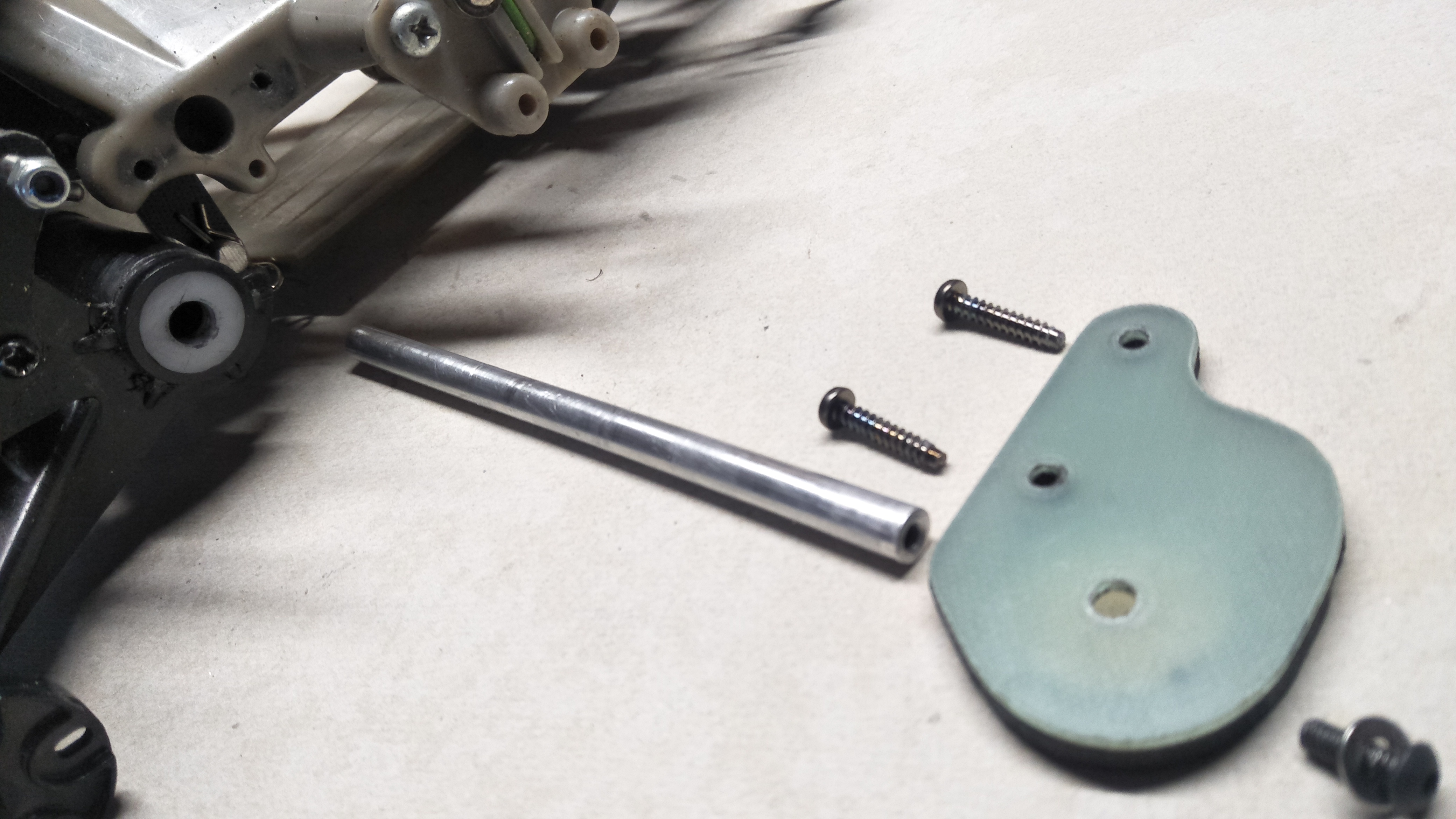

GRRacing wrote: Sun Jan 22, 2023 5:51 am
Will do. Finished my modified grasshopper so time to revisit the frog.
I modified the rear end to put the rear arms on bearings, and the diff has the screw mod. Main weak area is the front end. I put avante shocks on it, but it's still terrible, so I'll prob a my swap it all out for something else. I had been wondering how to give it a bit more wheelbase, and your idea is a nice simple solution. The best solutions normally are!

graemevw wrote: Sun Jan 22, 2023 7:06 am
I`ve used a shaft + bushing arrangement. No play at all now...
