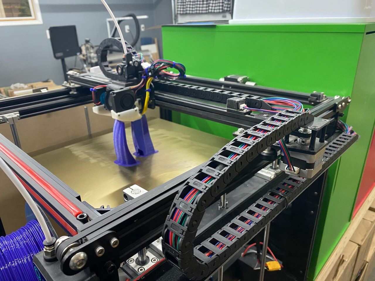

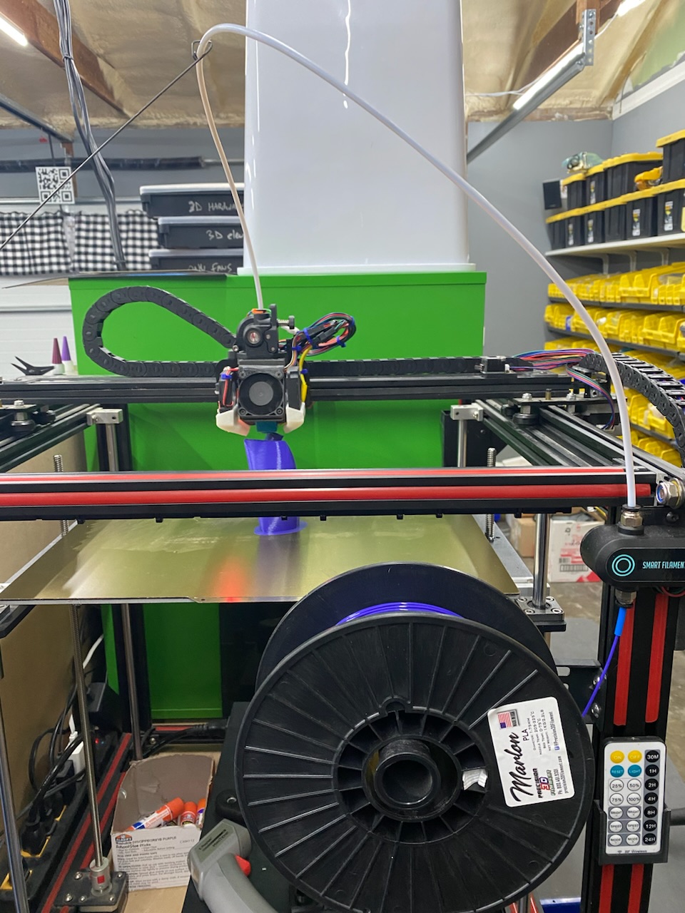

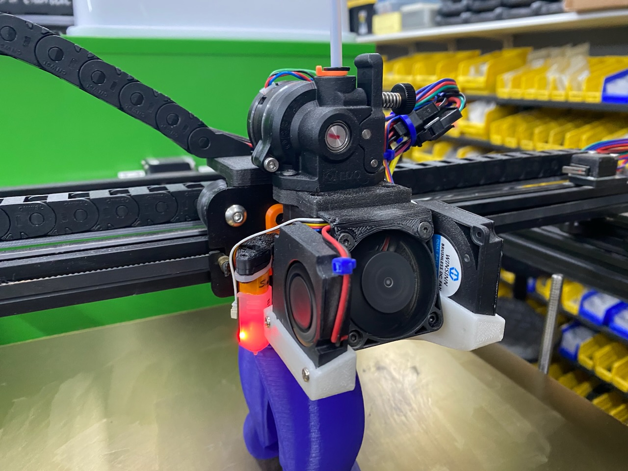

My ender 5 plus never printed very well out of the box. I fought so many things, from the loud grinding linear bearings to the constantly clogging hot end. After replacing the linear bearings with some quality units from xyltech and the hot end with a stock replacement I was able to get decent prints. My first mod was to get rid of the touchscreen and stock board and add a BLTouch. This allowed for easier tuning during first layer and unlocked the ability for me to write my own firmware around my usage. For example, trimming the Z axis. I run a tram on that every single print. Only takes a couple minutes and it aligns both Z motors automatically. I was still limited in the hot end so I went to a e3d v6 hot end and ruby nozzle. You can buy a cheap ruby nozzle and they work fine, but do not cheap out on the v6. I have a stack of clones that are absolute rubbish. You will fight them thinking there is no way such a simple part can cause grief. They do. I was still using the Bowden tube at that time but I did upgrade to a bondtech bmg extruder. This was a decent setup and lasted me a long while. After upgrading a couple of my other machines to the orbiter v2.0 I added one to my ender 5 plus and now it has gone from my least favorite machine only used for large prints to my go-to for just about anything. I tried using the hero me gen7 setup but didn’t like the way he built the clamp for the v6, so I made my own version. I then added the mks pwc module which lets the machine power off when finished. I put these on all my machines now, I really like them. I just recently added the smart filament runout which is really cool. It detects snags which occur more for me than runouts and will park the nozzle until you tend to it. When the nozzle clogs it will also park the head and wait.
I have all the cad files for the gen7 with all the different direct drive mounts and hot end mounts. Just lmk and I’ll get them to you. I would be happy to provide my marlin documentation as well, I keep a list of the lines that I change and what it does. Might help as a reference even if you are using different items on your build.
So here is a list of my current configuration on my ender 5 plus
SKR v1.3 board
Mks mini12864 lcd
Mks pwc auto power off module
Tmc2209 drivers
Orbiter 2.0 extruder
E3d v6 hot end
Amazon $30 ruby nozzle
BTT smart filament sensor
Hero me gen7 hot end mount and ducts
Led light strip on the front frame
Custom drag chain mounts

You really have changed a lot of things, it looks like... It's a long process of thinking I'm just starting now. I'll report about my progress here. I'm not even there yet : I'll order and start the new printer first, so I have something to work with while getting the Ender 5 plus in parts...
By the way, I'm surprised you added the BL Touch, as as far as I remember it was included on the Ender 5 plus from the start (and sometimes not really working well due to the loose cable harness connectors out of the box)... I forgot one single modification I did, which is to insert a PLA printed part behind the run out sensor so it works (cheap microswicth with a bendable part). I celarly envision a lot of work until I get there...

You know… I think you are right about the bl touch. I was thinking I had added it but that would have probably been on my regular ender 5.
If I had it to do over I wouldn’t have bought the 5+. Until I made all these changes it really wasn’t a great printer and now I have so much invested- its just not worth it. But I did it over time and that made it easy.

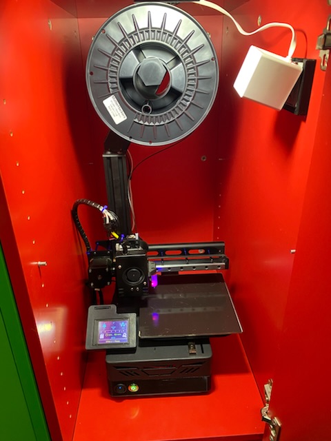

I will also add this- if you want an incredibly cheap machine that makes stunningly good prints out of the box- the Kingroon KP3S (and the original KP3, as well as the newest KP3S Pro) are great and very affordable. They are only 180x180x180 so quite compact and portable. If you wait, you can find them for around $140, and they come with a titan style extruder, v5 style hot end (not the best, but quite ok) and a linear rail X and Y axis. I modified mine with a ruby nozzle, genuine v6, genuine titan, and designed my own gantry to add linear rails on the Z axis. None of those were required. I use these enclosed and print nylon and ASA with great results.

I take note of this, not for me, but for my son... He asked me about a small 3D printer to learn and to do some stuff, this may be the perfect spot in terms of price for this purpose...GoMachV wrote: ↑Sun Feb 26, 2023 12:37 pm I will also add this- if you want an incredibly cheap machine that makes stunningly good prints out of the box- the Kingroon KP3S (and the original KP3, as well as the newest KP3S Pro) are great and very affordable. They are only 180x180x180 so quite compact and portable. If you wait, you can find them for around $140, and they come with a titan style extruder, v5 style hot end (not the best, but quite ok) and a linear rail X and Y axis. I modified mine with a ruby nozzle, genuine v6, genuine titan, and designed my own gantry to add linear rails on the Z axis. None of those were required. I use these enclosed and print nylon and ASA with great results.
