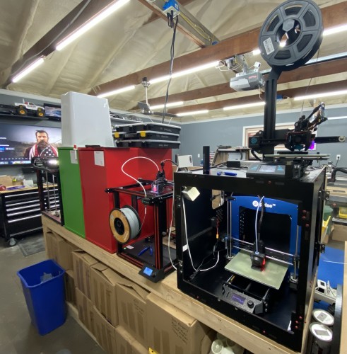

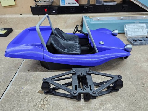

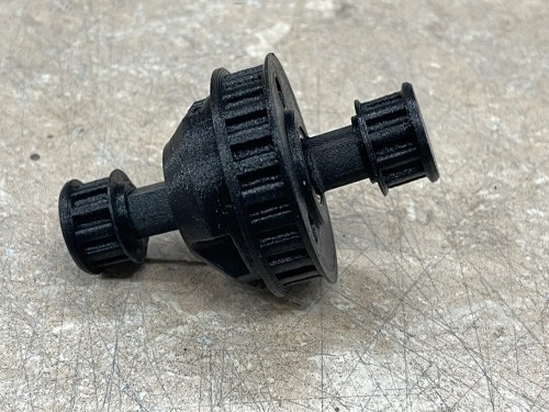

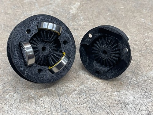

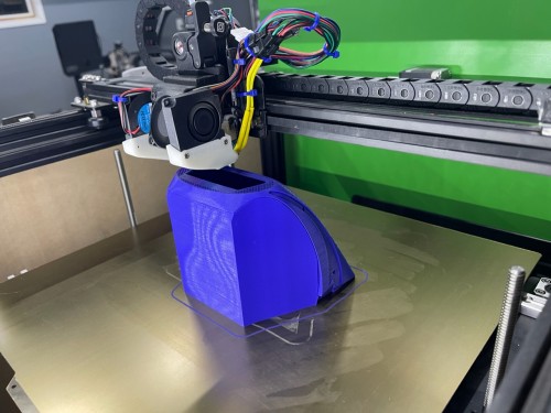

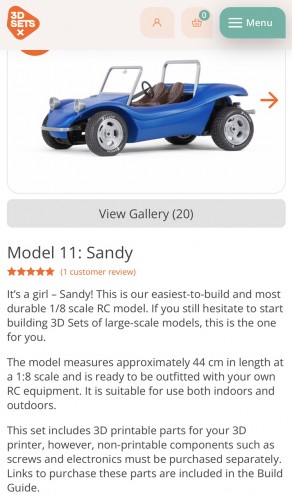

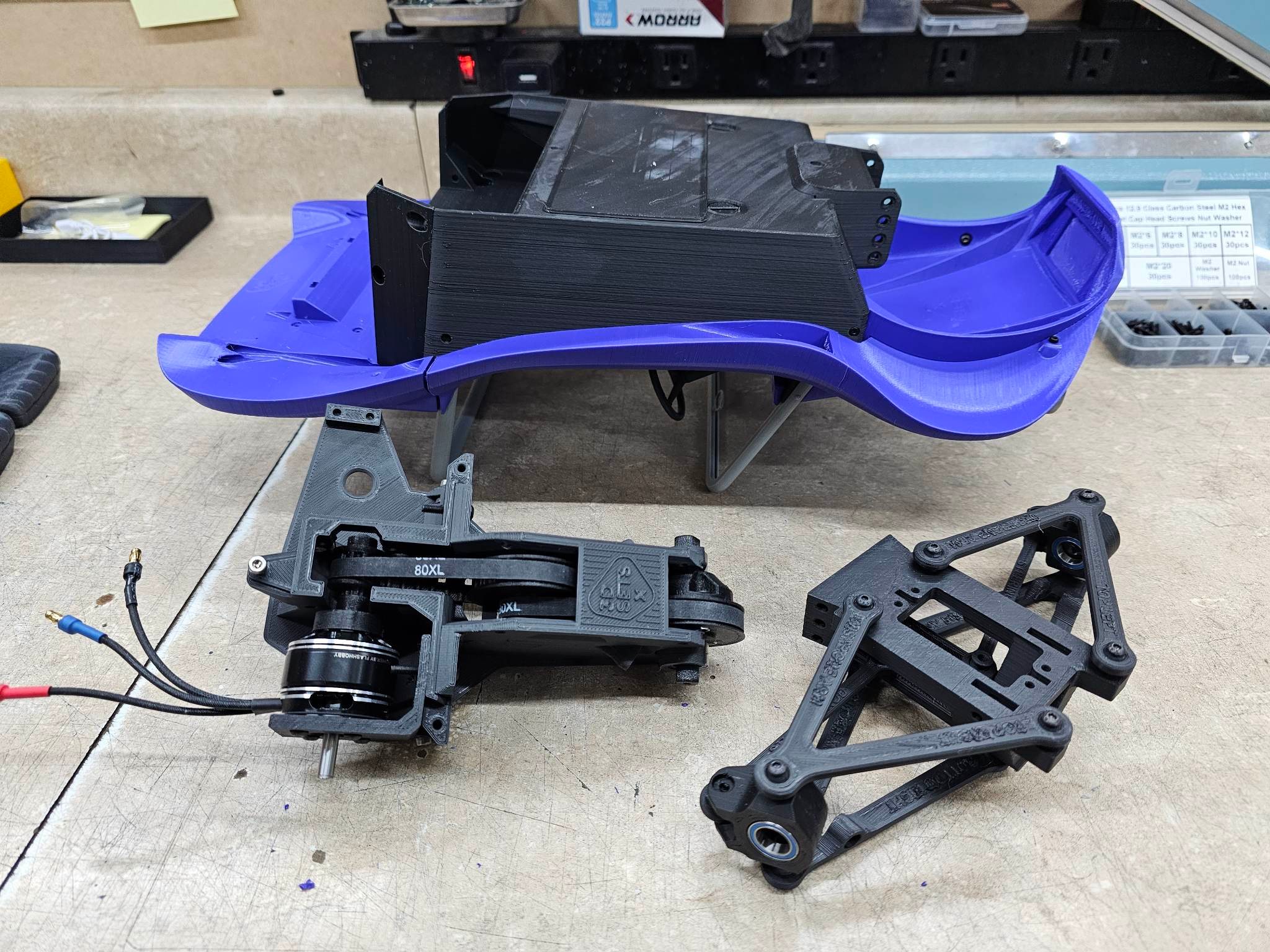

If I don’t constantly have 18 things going on to keep my kind busy I end up on eBay buying stuff :mrgreen: I decided to do some printing to keep me occupied between real jobs coming in. 3dSets released a new printable buggy just recently and wow- I was impressed. I bought the files, cost me $30, and started printing. I’m really amazed at the way they constructed the car, it’s a different perspective than what we are used to seeing. It’s beefy too which is great as it’s made to be printed entirely out of PLA. I decided to build the diff version. I am only a few parts in but really a neat all around setup and I can’t wait to see how it evolves. I already have some transmission ideas cause the belts are really rigid and feel inefficient as they are.
Here’s a link to the Sandy, but poke around- their new A Team van is crazy!
https://3dsets.com/product/model-11-sandy/
4 of the 6 buzzing away, the 2 enclosed are not needed for these prints

Looks very interesting , the choice of 1/8 is good for printing ,as you say it allows the trans to be chunky , are you going to be sanding and spraying the body or leave it natural ?

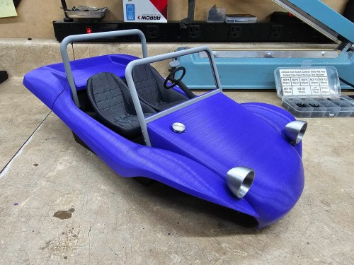

I have always been bad with paint so unless a friend steps up and offers I’ll probably leave it as printed

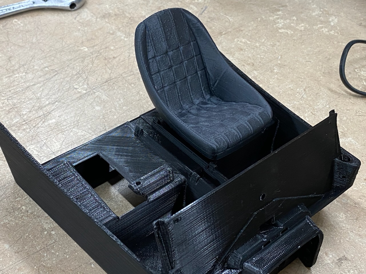

I was trying to figure out how to make the seats look less like the black interior but without changing the color too far (considered tan, flat black, or even white..) and remembered I had a spool of carbon pla. It didn’t work well at all for strength but the texture and color ended up perfect for seats
Also, I will likely end up reprinting that interior with a finer layer height and much slower. That was a draft print since I knew I was about out of that filament and wouldn’t be buying another of the same brand

The seats look just right , if your not too far into printing the body id highly recommend the new dual colour silk filaments , they change colour as you look from different angles , I'm doing parts for my Sand Rover build in a dual colour filament and it really looks good , if you did the body you would need to orientate all the parts the same on the bed so the effect was consistent but it would look sick , check out some YouTube clips on dual colour filament before going any further .

This one is going to be purple but I already have a second one in mind with several mods. That would be an interesting filament to work with, as these body panels print at all different angles.

I have spent the last couple weeks trying to get my printers all tuned as close as I can. Setting accurate steps are the most time consuming for me, using a dial indicator to get the movements exact. My next difficulty was that even though the steps are tuned correctly, the print was still larger than expected. Turns out the flow was too high, most of my printers ended up around 95%, but was was down to 87% to get it correct. At this point both my inner and outer surfaces were pretty close, but then I had some empty spots causing me to need to increase the flow slightly. All my printers allow pid tuning of bed and nozzle, and every time I change a temp I run the calibration. It makes a big difference in the fluctuation of the temps. I use pressure advance and found my k factor likes to be around .3. Since all my machines use the same hot end and orbiter I have used that number across the board. My retractions like to be around 2mm at 45mm/s. It’s been a lot of work getting them tuned but for the most part I can print a part on one now and know it will interface with a part printed on another of my printers.

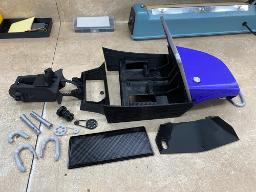

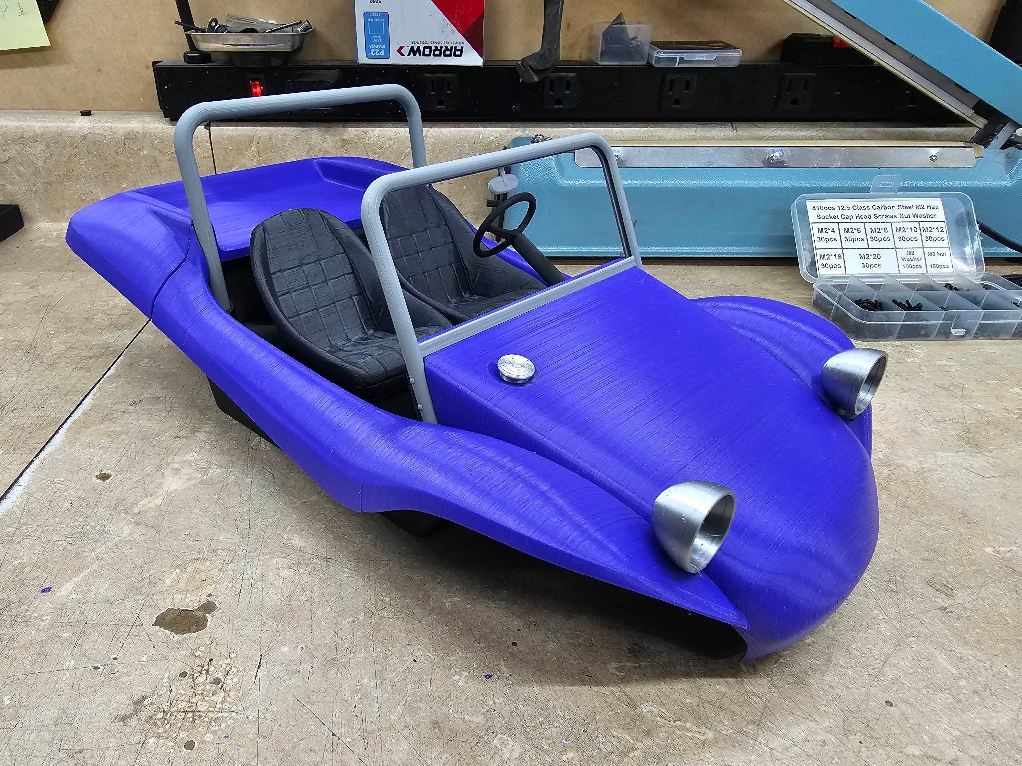

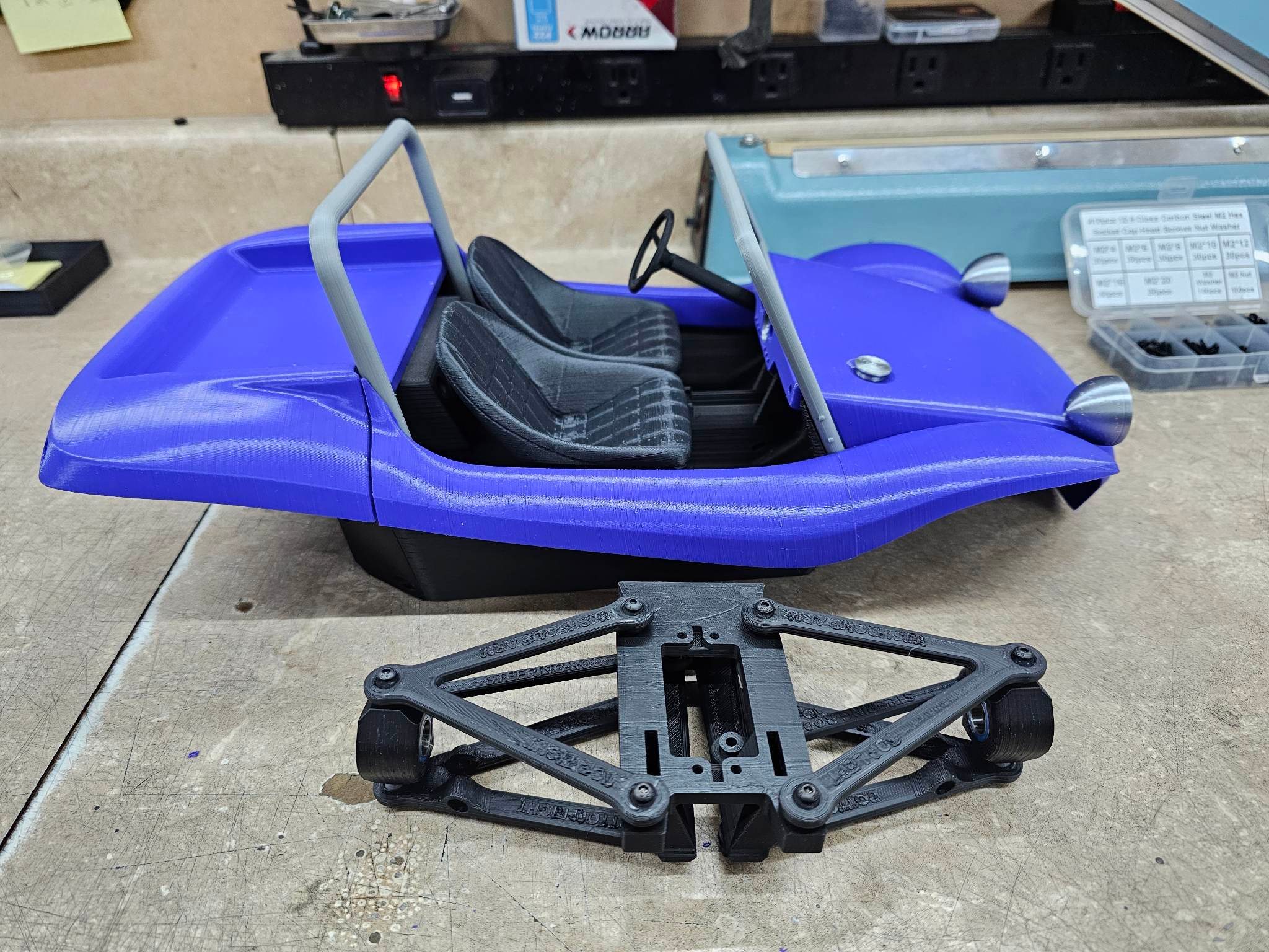

Made a little progress, just printing when I have time. So far the build has been great- the fitment of the parts is awesome. Still need to clean them up a bit and remove some glue

Really liking this , specially as I'm building a Sand Rover right now ,love the body style .
