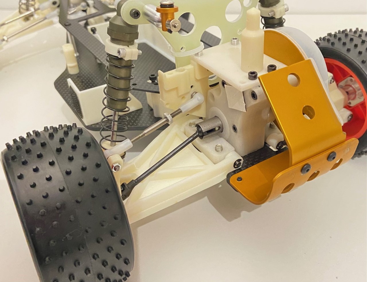

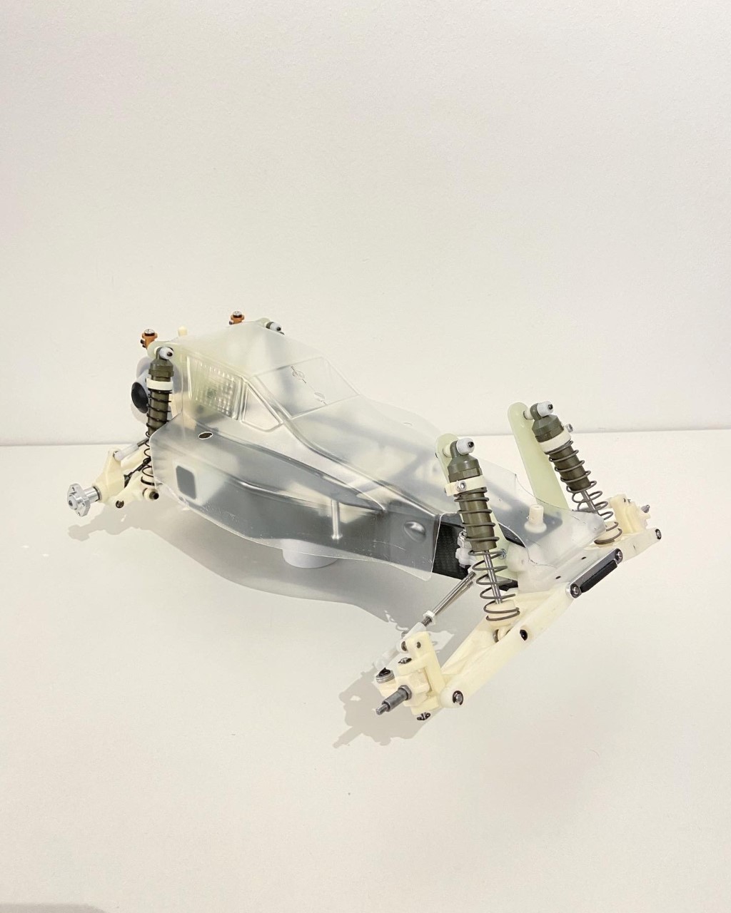

Small updates on the build.
Aluminum M3x6 Phillips screws for the inner pivot balls on the front end (if anyone needs a screw or two I got like 48 pcs over).
I also mounted a used straighten out motor guard at the other end.

Thank you bluewormx,
No no I'm wainting to see how the GP3D motor plate and guard will turn out. I think they are being anodized as we speek.
The biggest visual different to original are the sharper bends on the motor plate towards the rear.

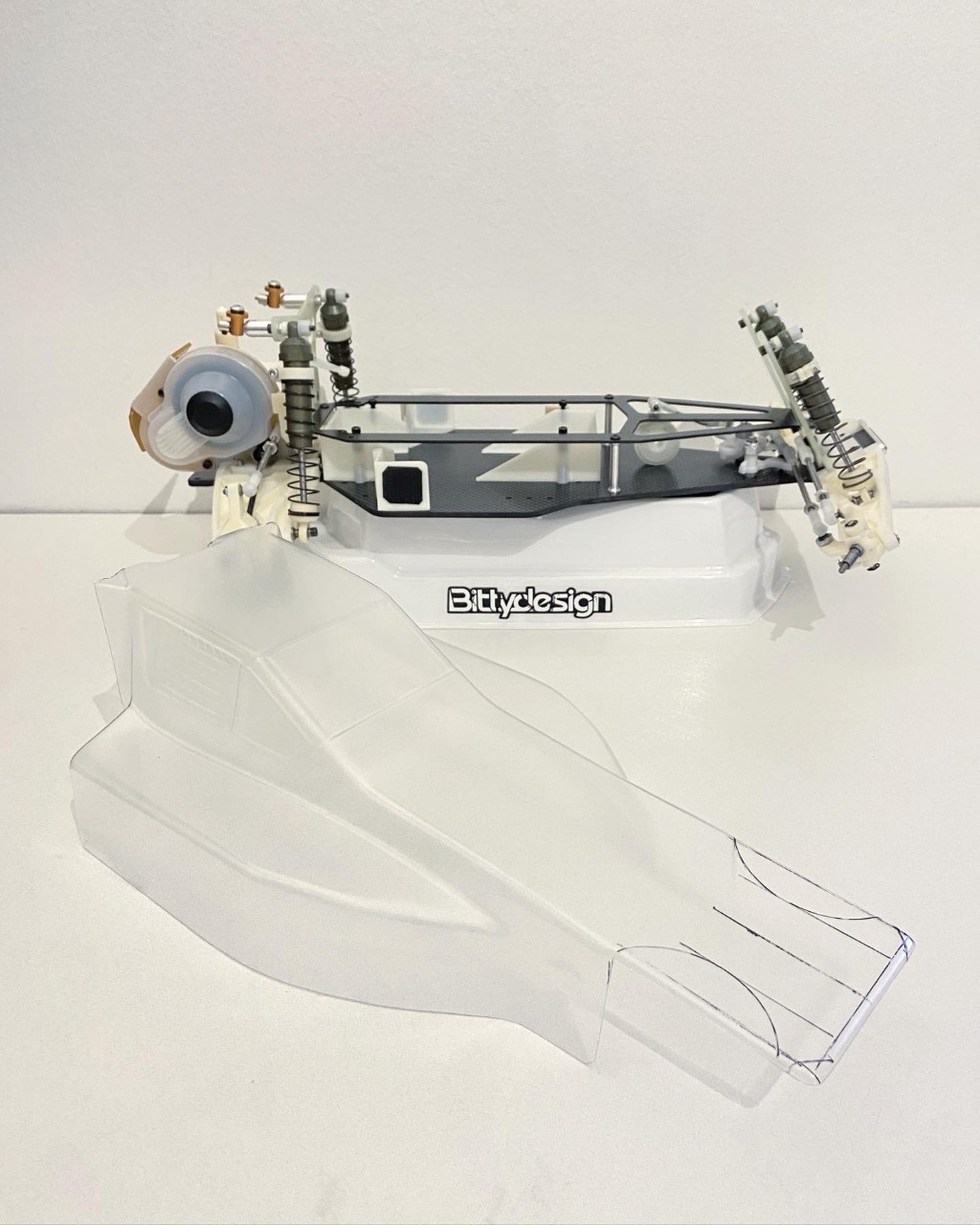

Can you show how the back of the body is cut out for the rear mount thanks
sandkil
Posts: 1082
Location: Stockholm Sweden
Has thanked: 795 times
Been thanked: 624 times
Re: Associated's '89 Stealth car (RC10GX)
Post by sandkil »
hugger19 wrote: Sun Feb 26, 2023 12:16 pm Can you show how the back of the body is cut out for the rear mount thanks
Hi Hugger19
Masami cut his body just aft of the rear shock tower as he didn't use the rear budy post. He used velcro on the sides.
The pictures of Masami Hirosakas car in the Associated book don't do justice as the car has been altered after Masami raced it.
Bluewormx had som good points in the https://www.rc10talk.com/viewtopic.php?f=35&t=5500&start=225 thread

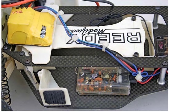

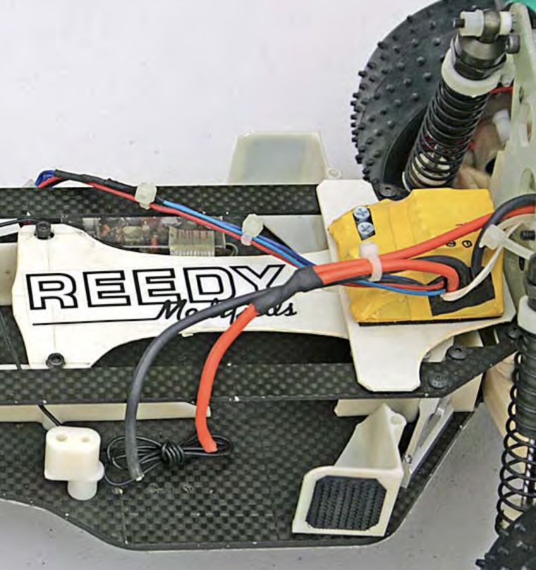

bluewormx wrote: Sun Jan 22, 2023 7:42 am Hi, I had seen this photo and have been looking for it. The slipper looks somewhat like the MIP SL-100. Baring in mind that not much is really known about the prototype stealth gearbox.
Some magazine reviews have said the following:
1:2 ratio
bellview washers instead of diff spring
I think until verified all race reports and reviews need to be judging as "probably right" but may have errors.
The only other info on the prototype stealth transmission, where some photos posted here By mark Pavidis or maybe Ruffy.
The 89 stealth car was probably rebuilt by associated. Most photos from the race show various differences from those captured by Steve Hustings photo book.:
Motor mount cut diagonally
Yokomo rc10 gear cover with bung removed.
transmission brace cut removing 6 gear holes.
No rear body mount (why would he want one!)
yokomo shock clips
Green label Reedy motor (not the earlier yellow label as seen in book)
Probably more stuff that is too hard to see in the long range photos of the time.

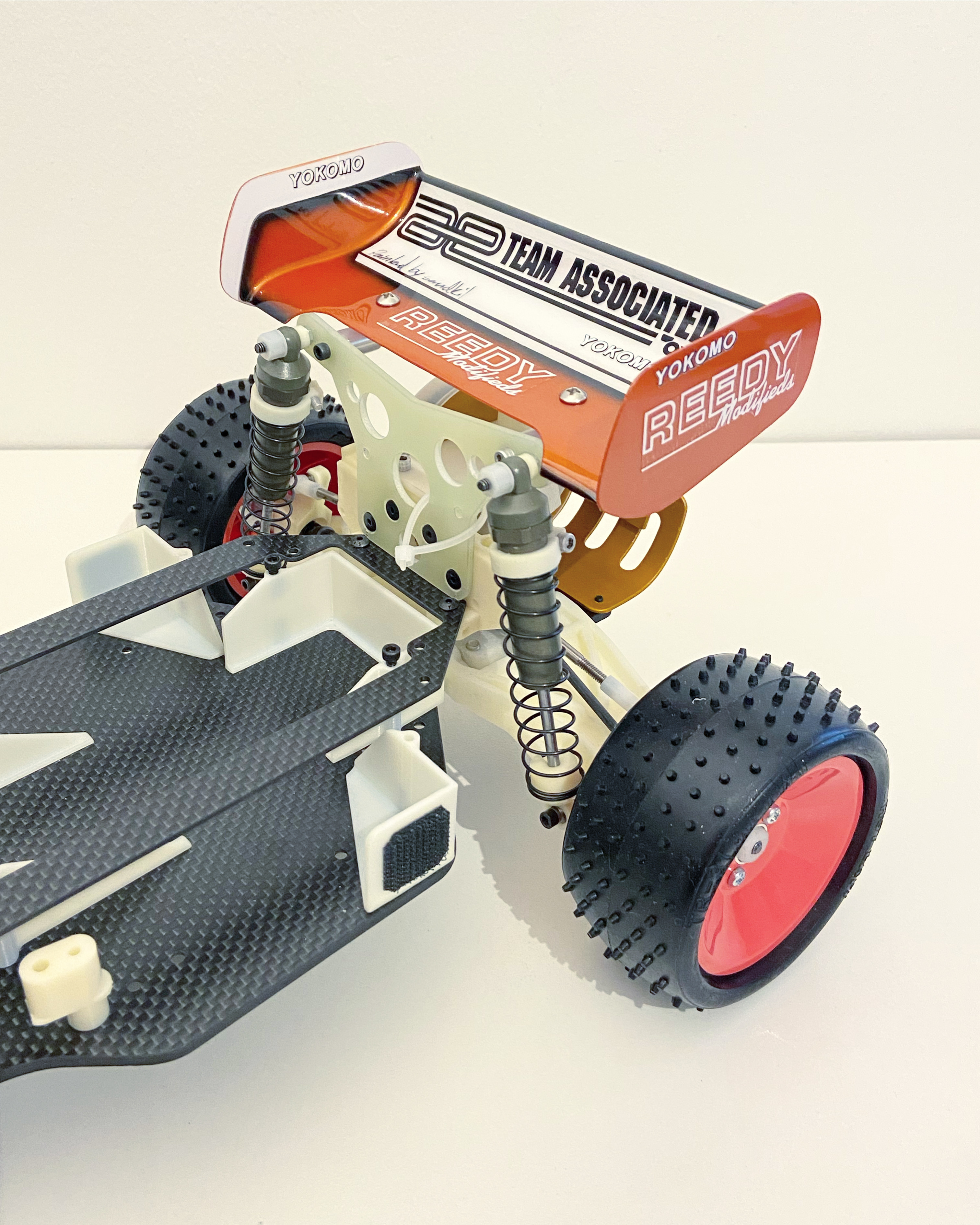

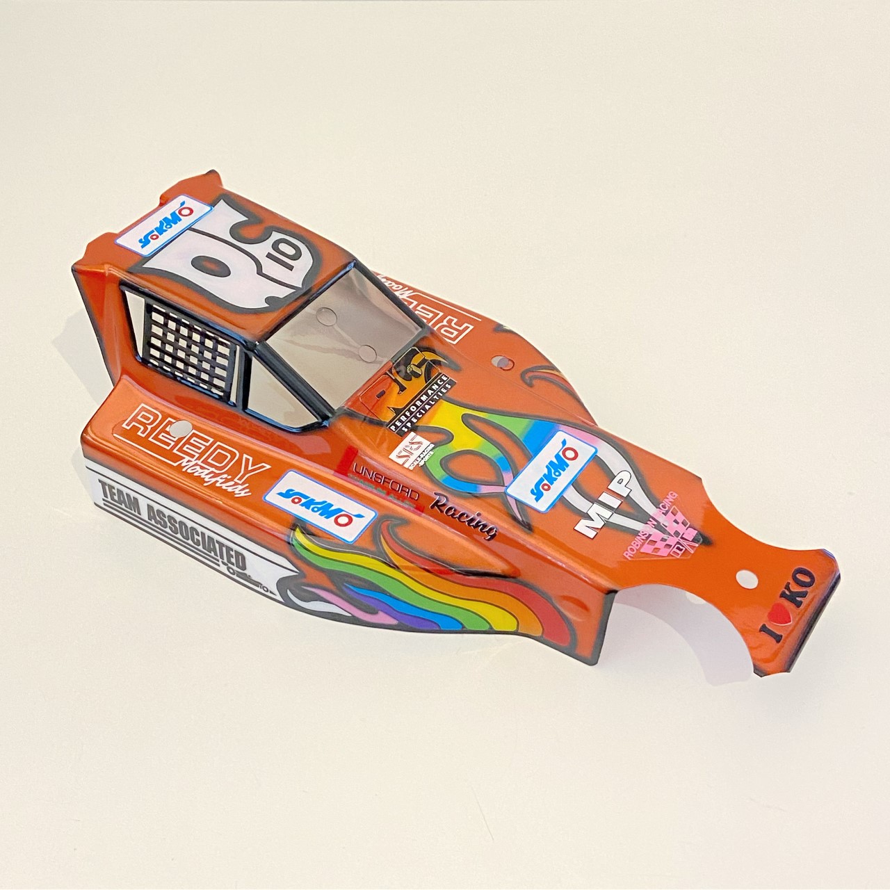

Okay.. this shows what color scheme I’m going for..
NOTE! Do not mix Faskolor and Tamiya’s PS rattle can paint. Faskolor do not like it at all!
I got my work cut out trying to fix the body.

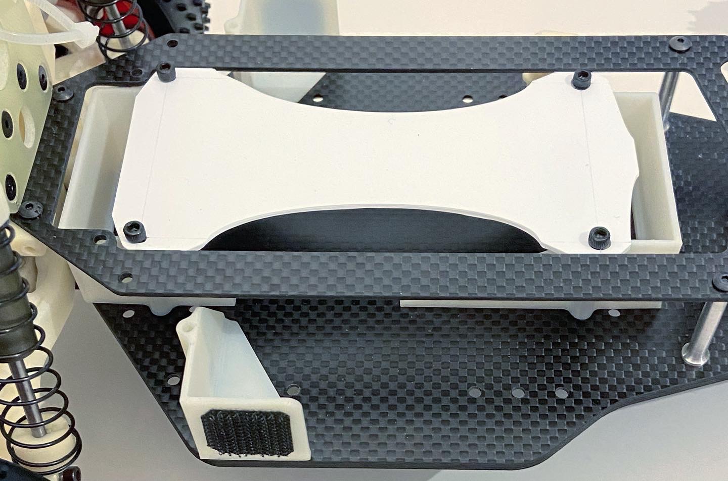

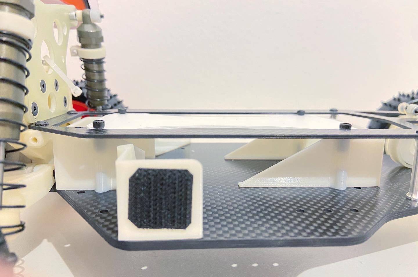

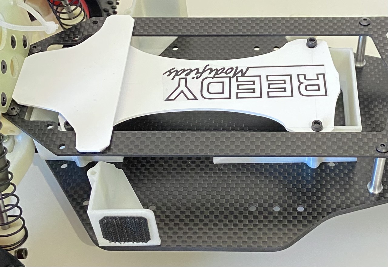

Here’s something I noticed when cutting the styrene battery hold down. As Masami removed the bottom of the battery cups he probably had to grind down the height of the cups so that the battery cells would have a snug fit….. well that is my theory. Compare pics and look at height of the 4-40 socket heads in comparison to upper deck.
TRX-1-3
Posts: 2081
Has thanked: 2100 times
Been thanked: 1006 times
Post by TRX-1-3 »
Have you test fitted some batteries to see if they are loose with your current configuration? You could run a strip of dense foam tape on the underside of the hold down if you didn't want to shave down the cups. But if you are going for a super replica.......
MarkyDents
Posts: 1187
Location: Staten Island, N.Y.
Has thanked: 1809 times
Been thanked: 643 times
Post by MarkyDents »
Looks like the tops of the socket heads are pretty even with the top of the upper chassis. A little more noticeable per how close the rear ones look to the bottom of the esc shelf.
Hey Cru ! Go balls out 8)
sandkil
Posts: 1082
Post by sandkil »
TRX-1-3 wrote: Mon Mar 06, 2023 5:26 pm Have you test fitted some batteries to see if they are loose with your current configuration? You could run a strip of dense foam tape on the underside of the hold down if you didn't want to shave down the cups. But if you are going for a super replica.......
MarkyDents wrote: Mon Mar 06, 2023 8:20 pm
I got the measurements of the Sanyo 1700 mAh SCR cells and the are about 22,3 mm in diameter.
Cups were sanded down about 2,5 mm and that got the hex screws almost flush with upper deck.
Also got the body done!
