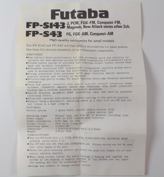

One of my Delta Pocket Rocket 1:18 scale cars came with a Futaba FP-S 143 servo.
I tried to find specs and release date for this servo, but I can´t find anything.
The usual Futaba database for discontinued servos don´t mention this servo.
So anyone have more knowledge?

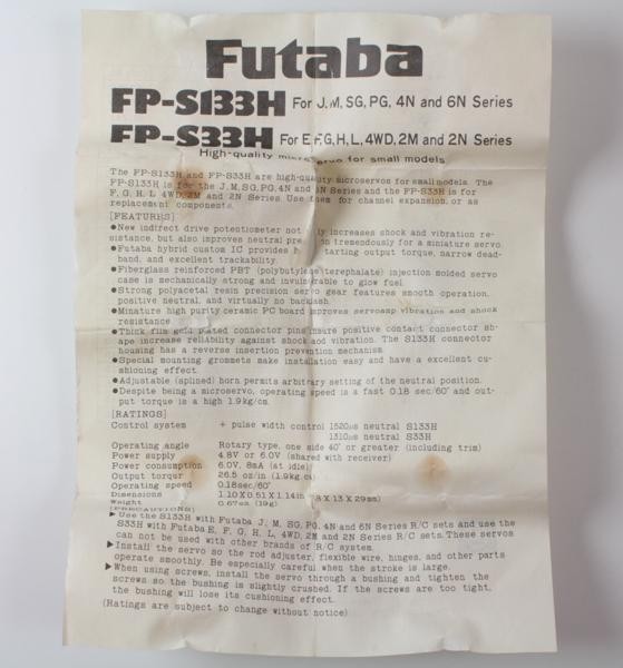

Seems the S143 is smaller than the S133.

My bad. Should've said 133H. The S133, S133H, and S143 are the same dimensions but different torque/speed.
