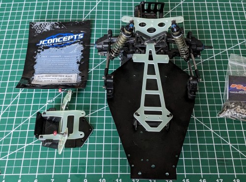

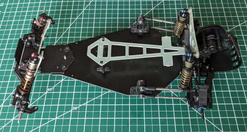

This isn't the nose plate that's going to stay with this build but it's good enough for some mockup work.

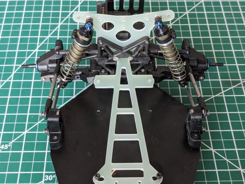

The further this goes, the fewer actual RC10T2 parts that end up getting used. 🤣
A nose brace plate is being added instead of nose tubes which leads to needing a custom front suspension mount. First mock-up trial looks like just a few tweaks will be needed.

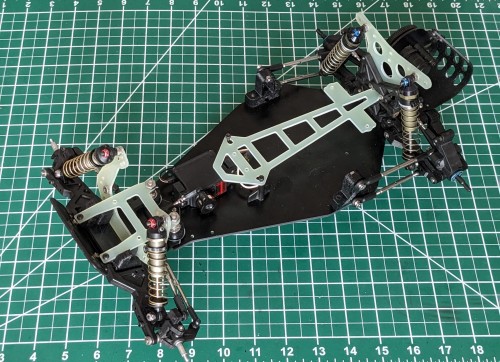

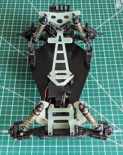

Nose plate arrived and got trimmed a bit to remove the LWB mount holes. Just a few minor battery side brakets left and then picking wheels, tires, and a body. Rear shocks got the limiters removed and repositioned.

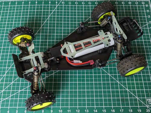

The wheels and tires weren't a hard decision. I have a set of B2 front and rear wheels, and also a set of Race Prep 925 rear / 926 front tires looking for a home. This seems like the right spot.
This is probably a good time to stick in a motor too. My Reedy with the MCI restoration label will work well here.

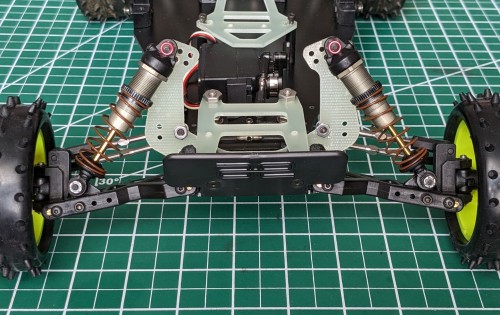

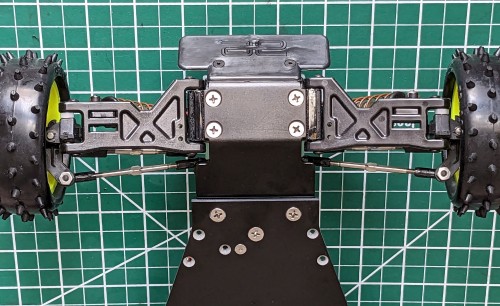

I wasn't satisfied with the front inner and outer hinge pins being too long for the front suspension arms so I went with captive hinge pins, which are what the arms are intended to have. That cleaned up the front nicely. I also stole the NOS front bumper from my 10T.

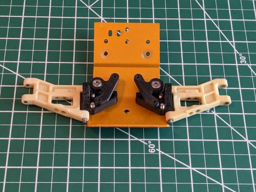

Messing around a little more. The steering area is going to be tricky.
