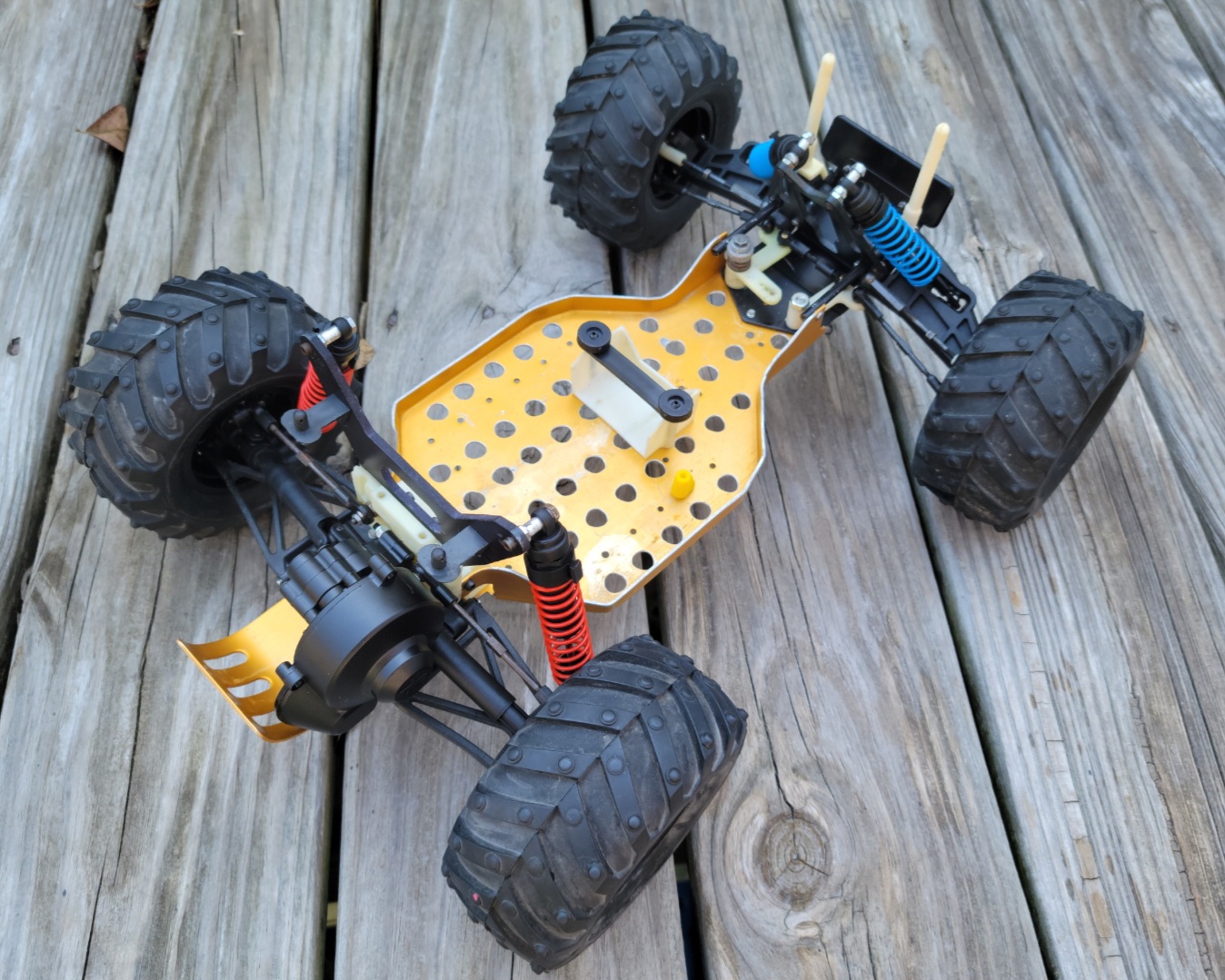

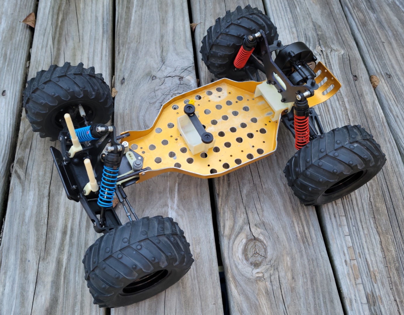

juicedcoupe wrote: Tue Aug 01, 2023 8:28 pm Managed to fit one of those $20 Injora transmissions on a RC10 (going to be a truck). I had to clearance the gear cover a little, to allow more upward movement of the half-shafts.
The half-shafts came off a ECX Torment and the carriers are from a Traxxas Stampede. Both fit without any modification themselves but the control arms require clearanceing.
Got this garbage heap sitting on it's own, with more mixing of parts.
It has modified Traxxas Stampede front arms, 30° B4 caster blocks, modified B4 carriers with Traxxas axles. Shocks are mostly Traxxas, with Losi and ECX parts.
R6cowboy
Posts: 1493
Location: Mendota, IL
Has thanked: 893 times
Been thanked: 910 times
Post by R6cowboy »
One hellavu mut you got going there, but I think it's neat.
-Jerry-
Posts: 3567
Has thanked: 273 times
Been thanked: 2108 times
R6cowboy wrote: Sun Aug 06, 2023 9:30 am One hellavu mut you got going there, but I think it's neat.
The best part is the cost. The transmission and nose plate are the only things I bought for it (specifically for it, anyway). Everything else was laying around.
I've got plenty of electronics to choose from and my original 10T body is in a box somewhere.

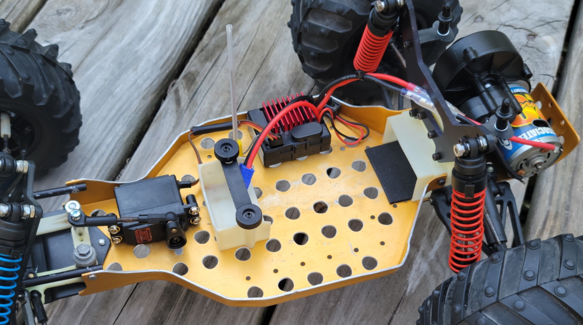

Posts: 3567
Got it functional for now. I picked up a Losi/Horizon esc/receiver and transmitter for cheap a while back (bought on a whim and never used it). Then I dug out an old JR servo and Team Associated Power 20 motor.
Found the original body from my Team Truck, then installed it raised a bit.
