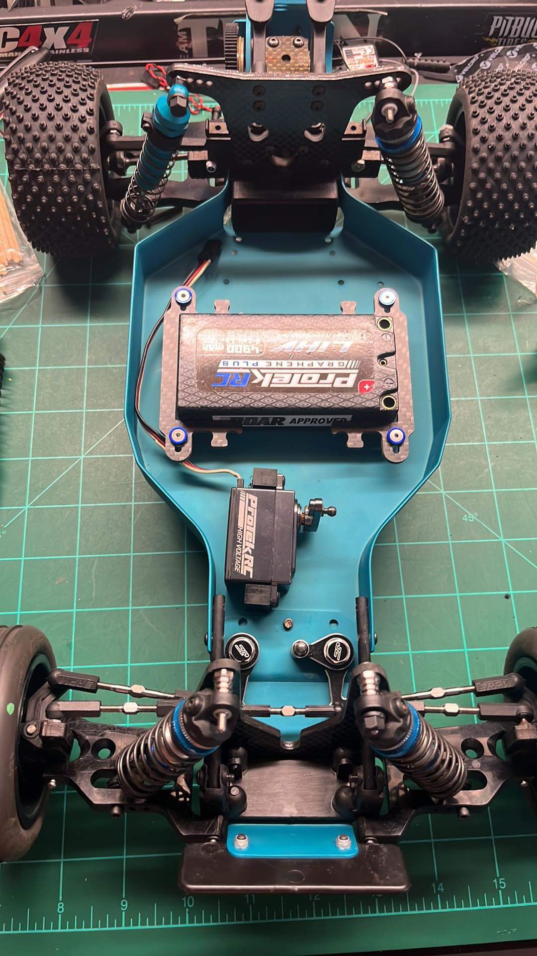

Ok, so I've had some time away, busy busy. Im toying with the idea of putting 12mm associated big bores on this buggy. The problem Im running into is the rc10t front end. the buggy fronts are too short for this tower/front end. Has anyone tackled putting 12mm big bores on this type of front end mod?

Re: RC10 C stamp resto custom
Factory Works makes towers for different length shocks. You probably need the 0.89 Quadra front tower.
Posts: 12335
Been thanked: 3917 times
I agree, Niki's .89 tower should be perfect for that combo. We have them listed here....

GoMachV wrote: Sun Aug 13, 2023 5:40 pm I agree, Niki's .89 tower should be perfect for that combo. We have them listed here....
https://factoryworks.com/shop/ols/products/nix80032
what material is this tower?
Posts: 12335
We use g10, same as original towers

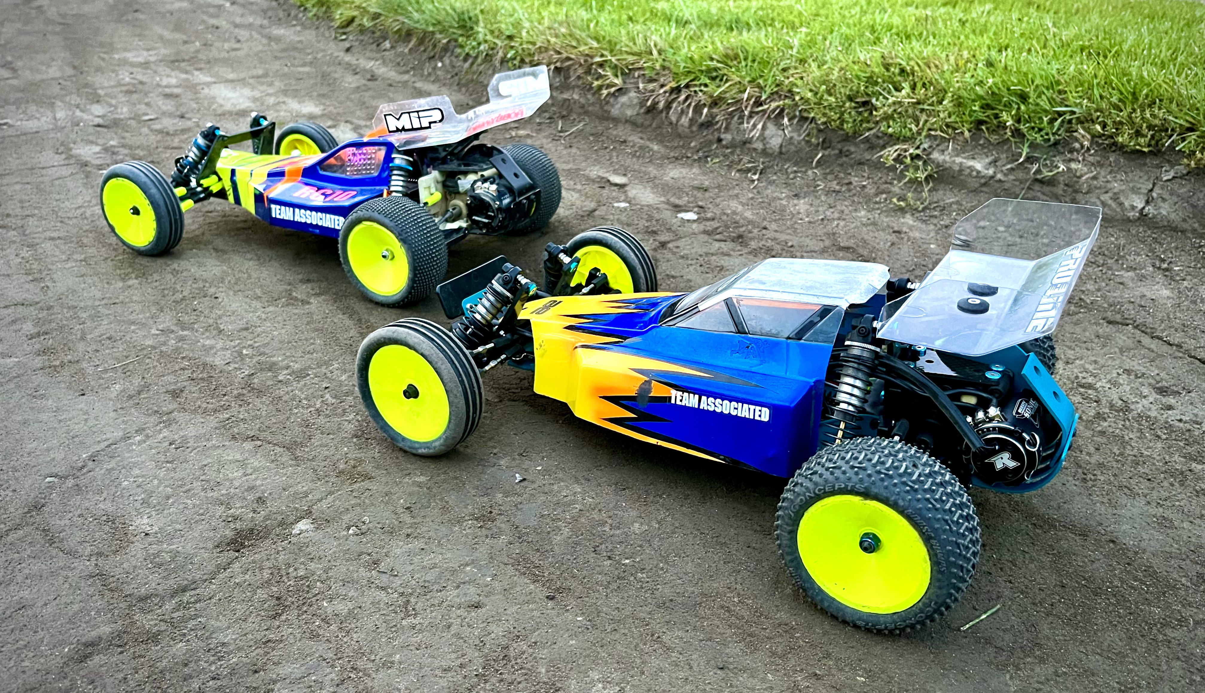

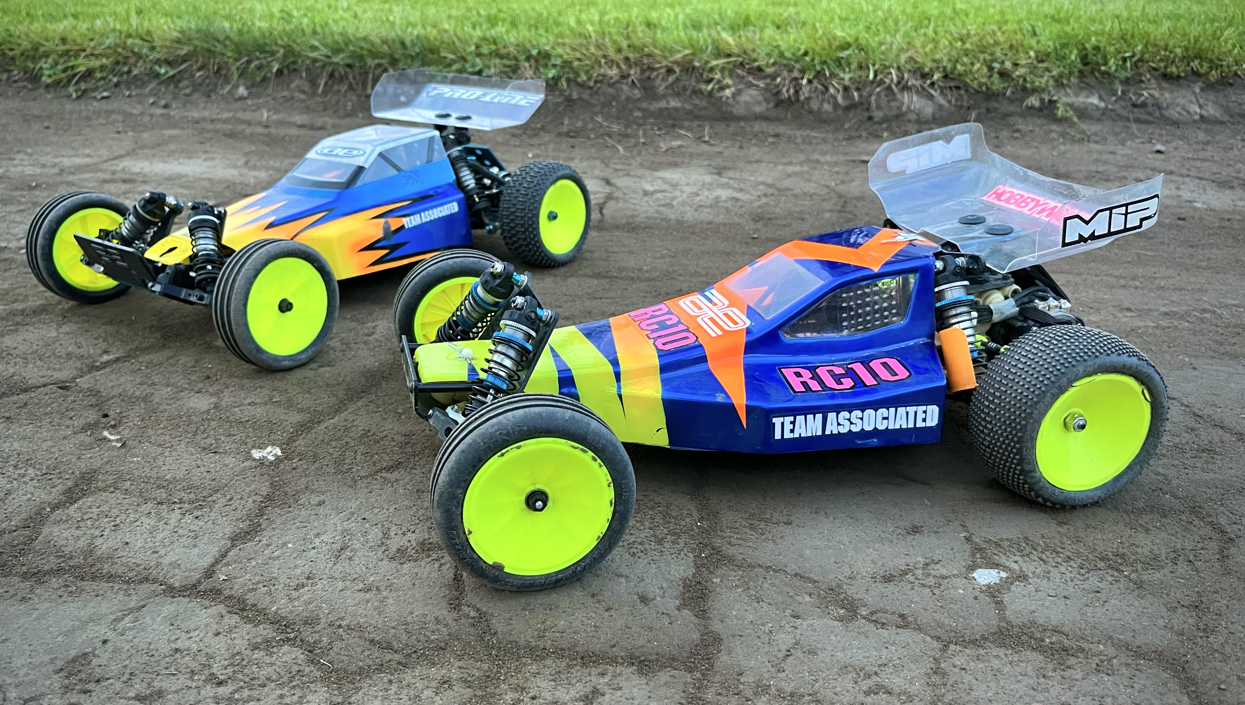

well there has been a long gap for update pics, but I have been running this for a couple weeks now and really enjoying this, it does well against the modern cars and I couldnt be happier running it. I have a spec 17.5 system in it.
Post by RC4X4 »
its been a blast building, thanks to everyone for you help and imput.
