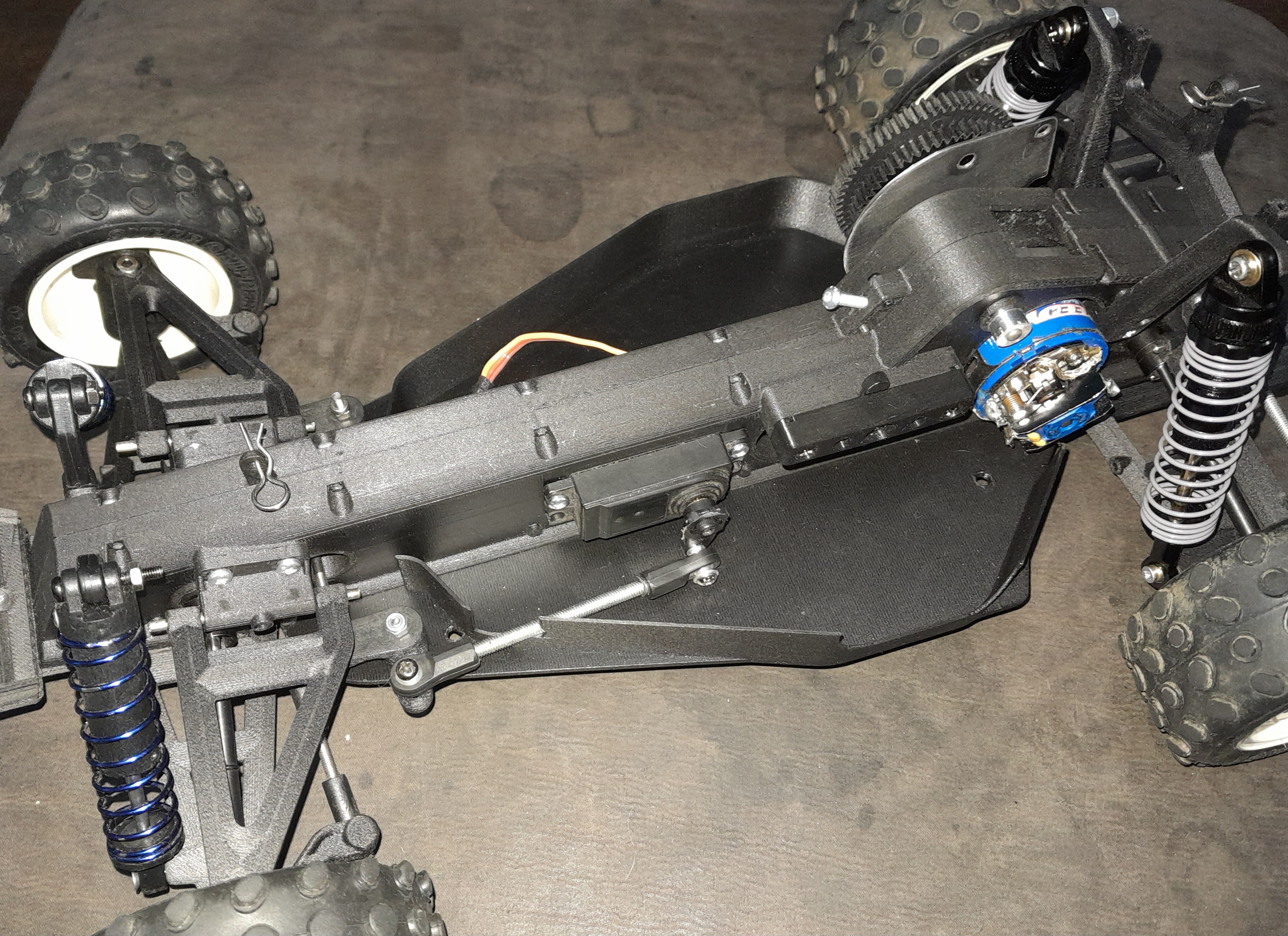

Re: Dadio's 3D Printing Stuff

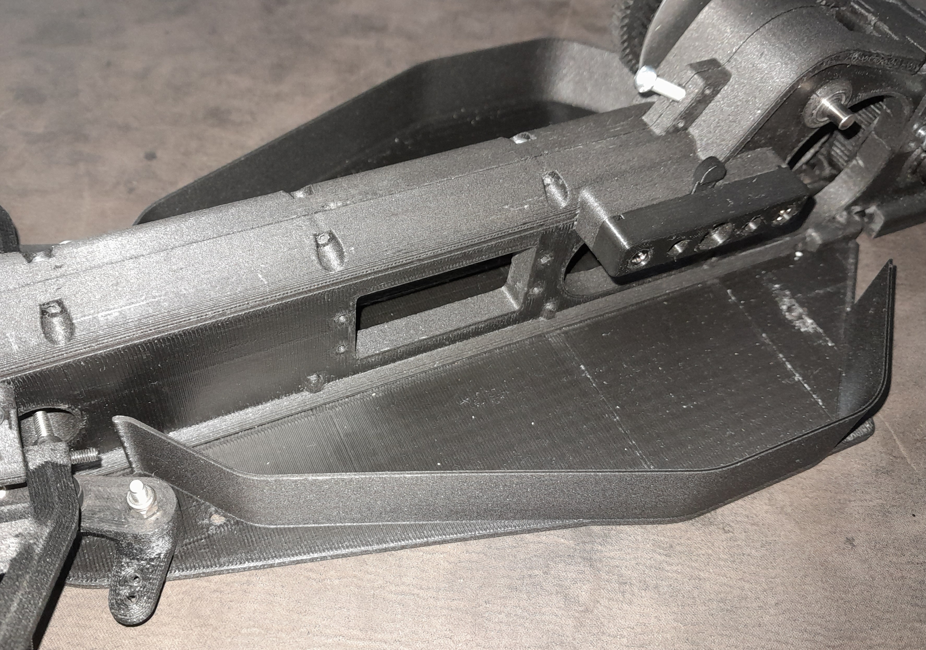

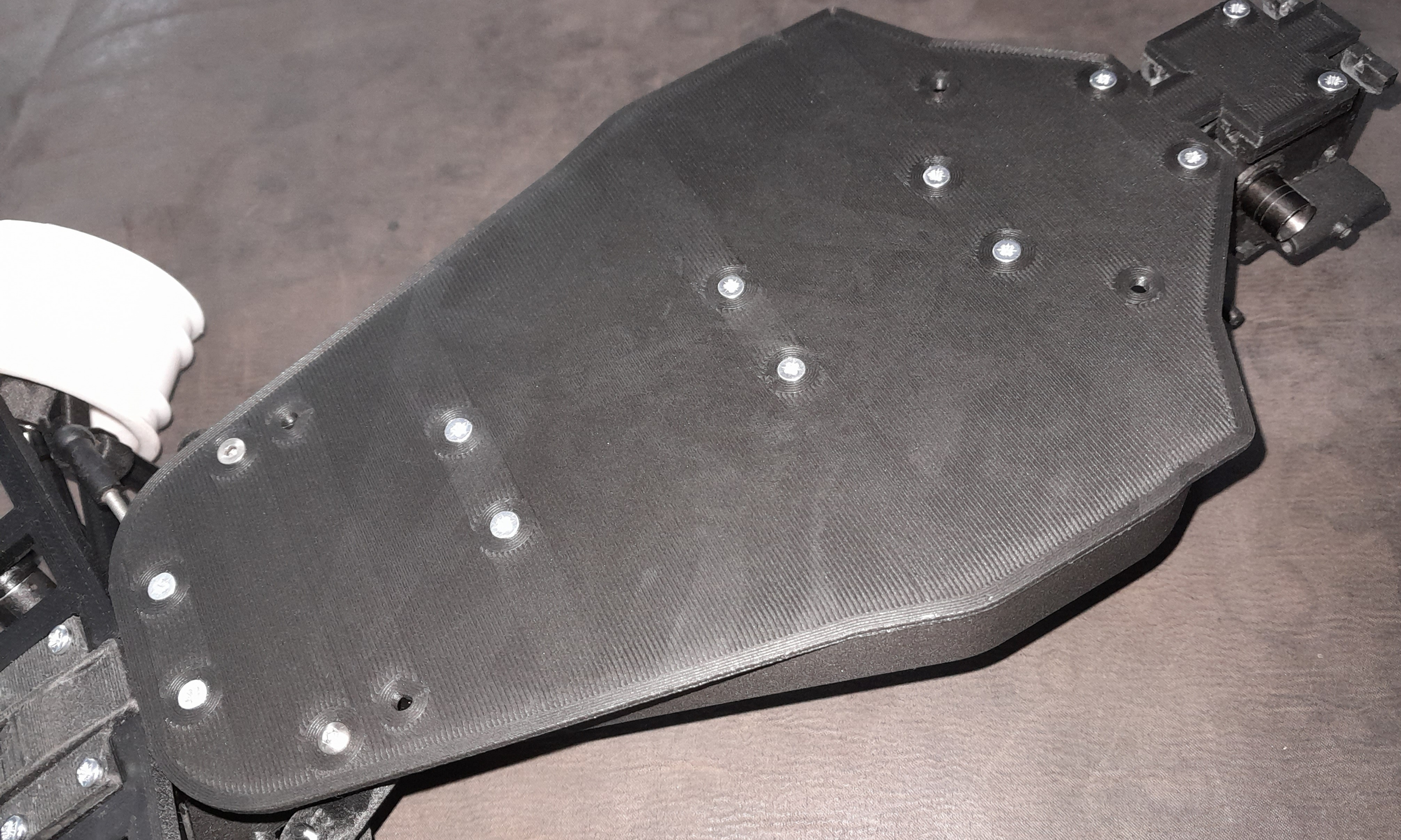

Drew up the steering components and chassis plate for the Mini Mustang , I combined the chassis plate with the under tray that's usually a lexan part, printed in PA6 CF Nylon for the steering and the plate in PETG CF.
The chassis plate once fitted makes the whole thing very rigid. After printing I added cutouts in the under guard sides for battery and steering rod as I'd missed them on this version , easy enough to cut out as you would in the lexan version.If a jobs not worth doing then its certainly not worth doing well.

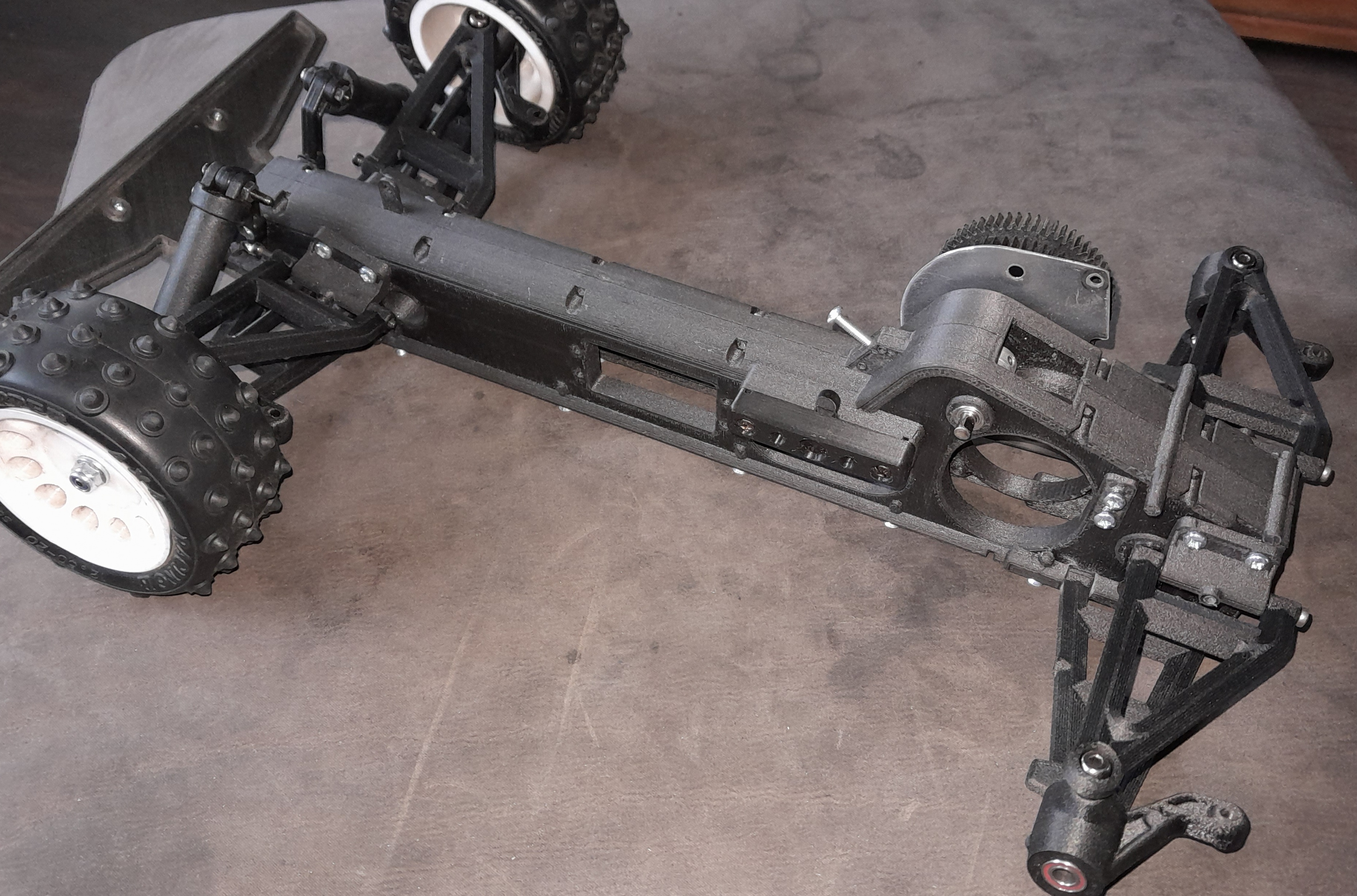

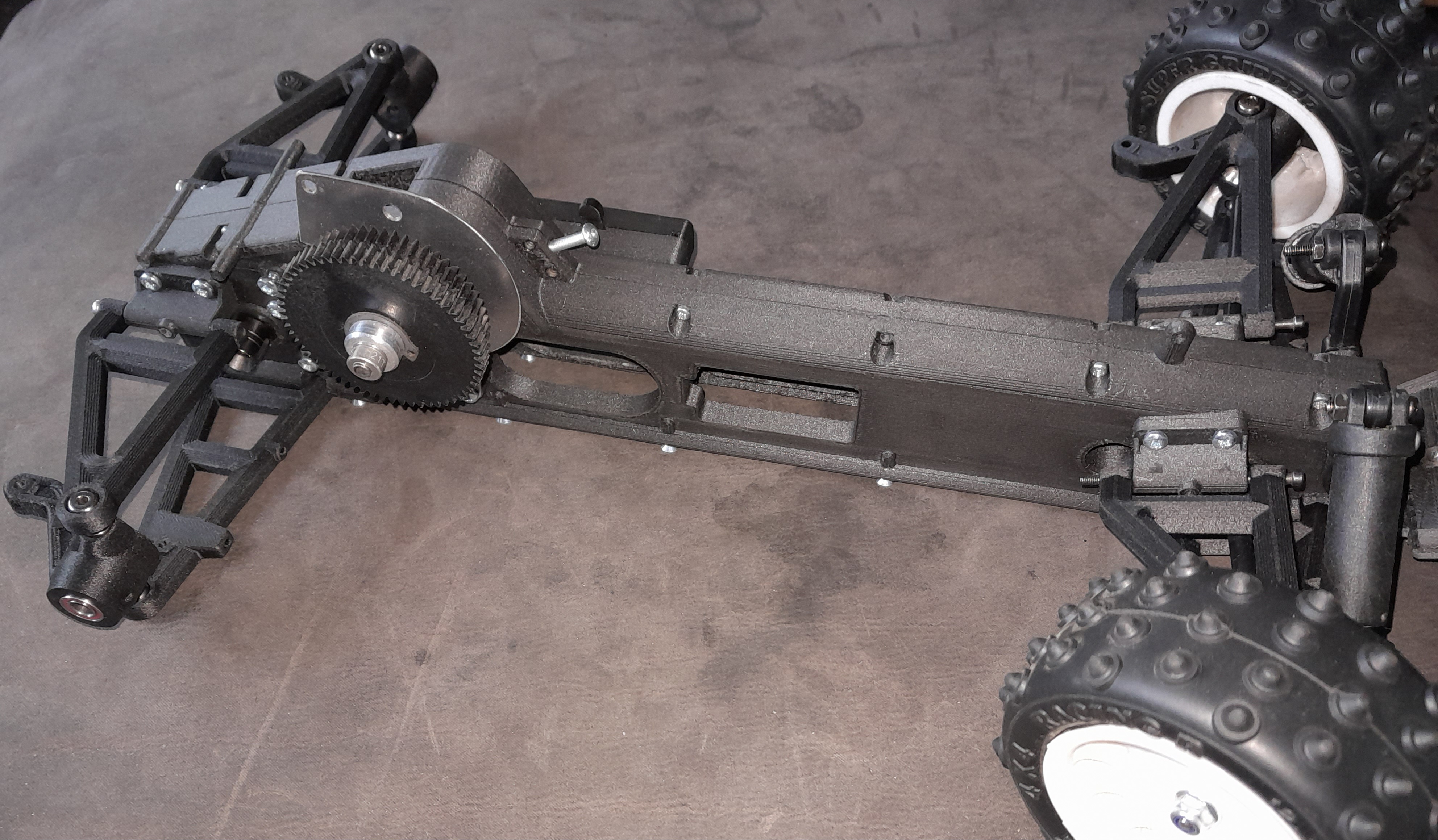

This Mini Mustang is just about done , modified to use Hotshot diff bevel gears , dogbones and axles .
Servo and motor are fitted just need to fit an RX and ESC and it's test drive time, I'm not sure if the suspension arms will hold up in home printed PA6 CF Nylon, where the inner arms meet the suspension pins they are quite skinny , the original material is very tough and flexible , nearest material I could print them in would be Polypropylene and I've never used it , by all accounts Polypropylene only really likes to stick to Polypropylene ....

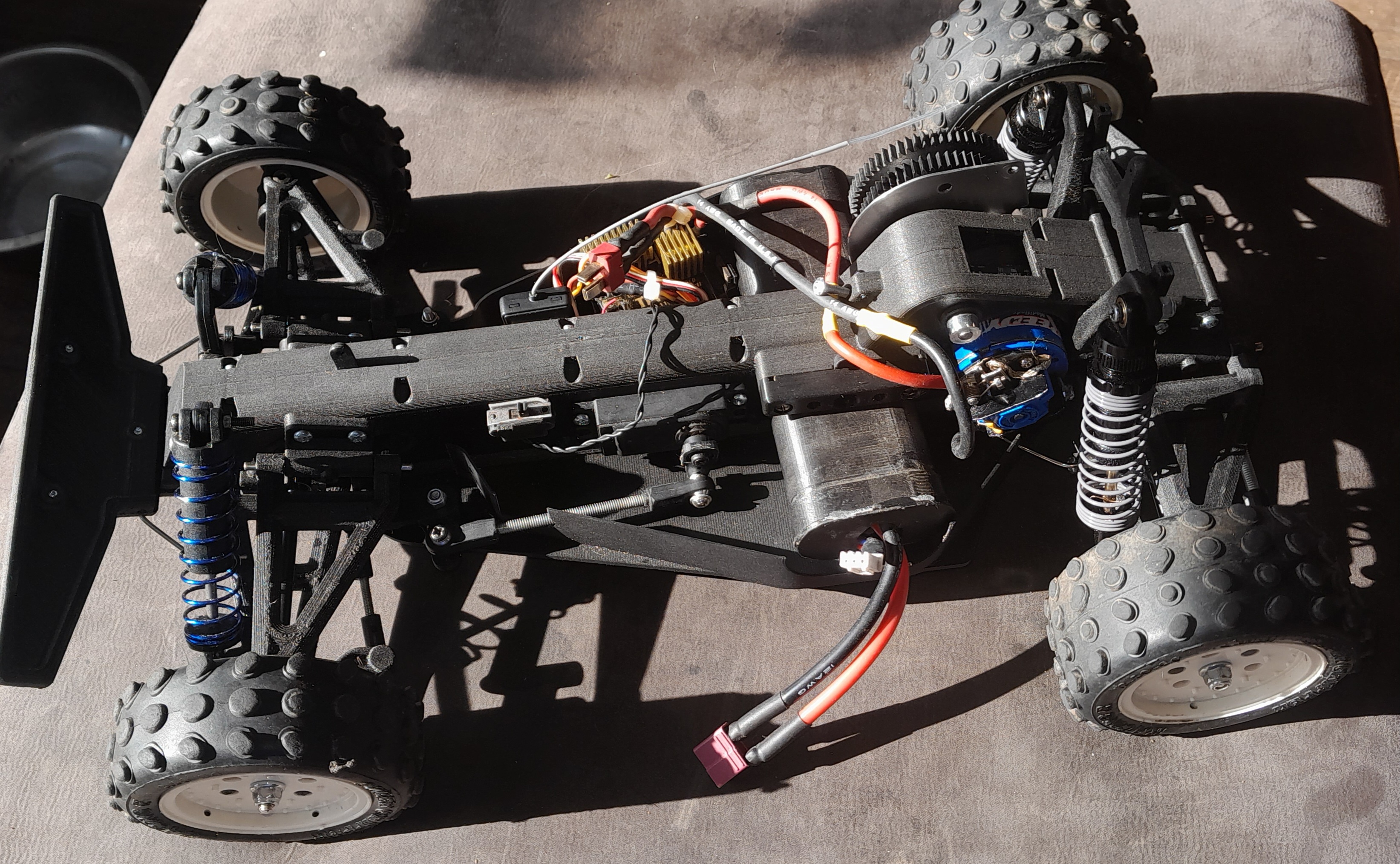

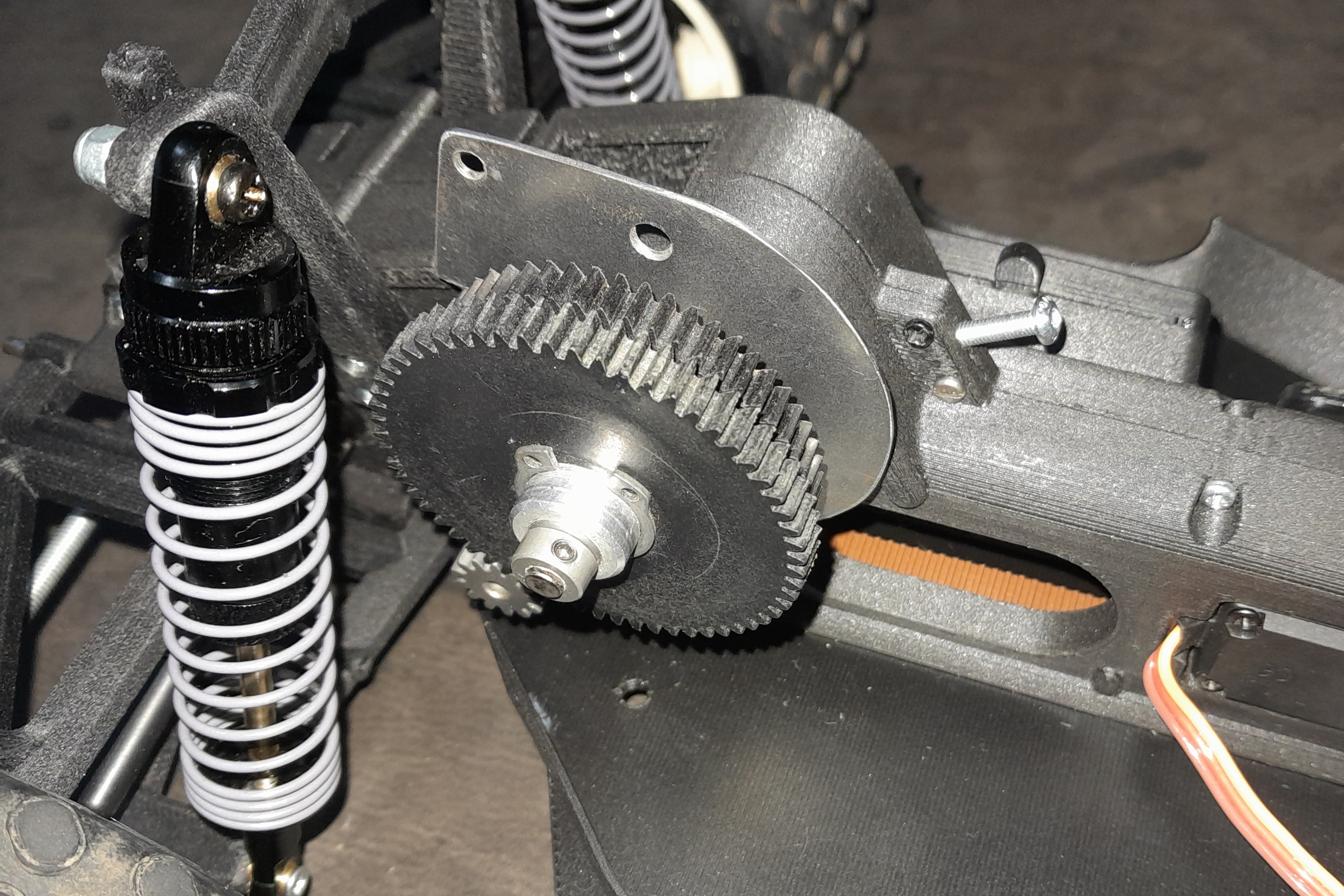

Took the printed Mini Mustang for a drive today , disappointingly the Hotshot diffs don't like being under tension from the belt , with enough belt tension not to slip it virtually locks the diffs
I'm thinking of ways to solve this , its down to the different out drive designs , the genuine diffs have a sleeved screw holding the outdrivres together but the Hotshot only has a loose pin to keep it centred , I'm sure I can solve it for myself but it's a bust for making an easy conversion part for other people .

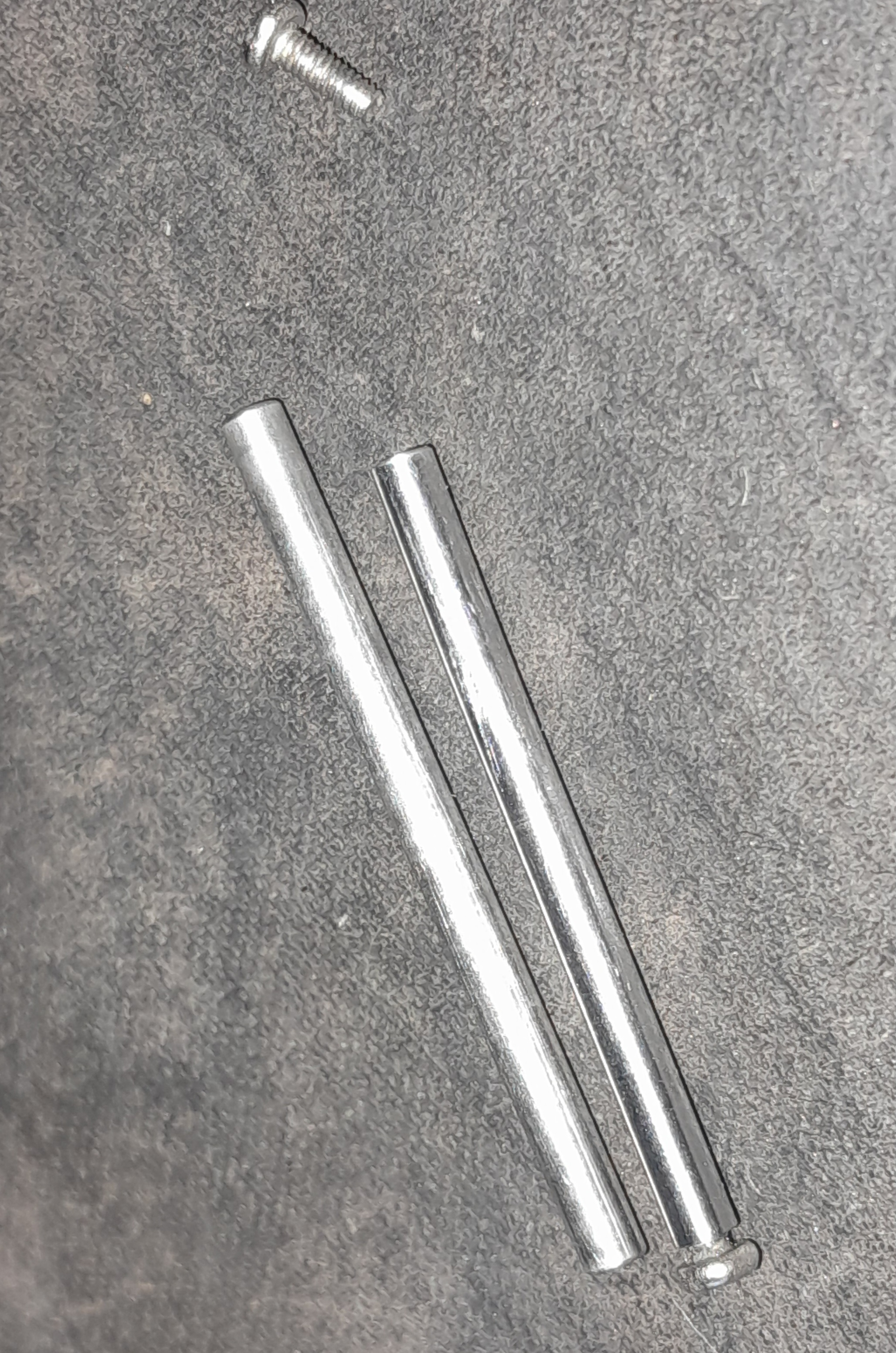

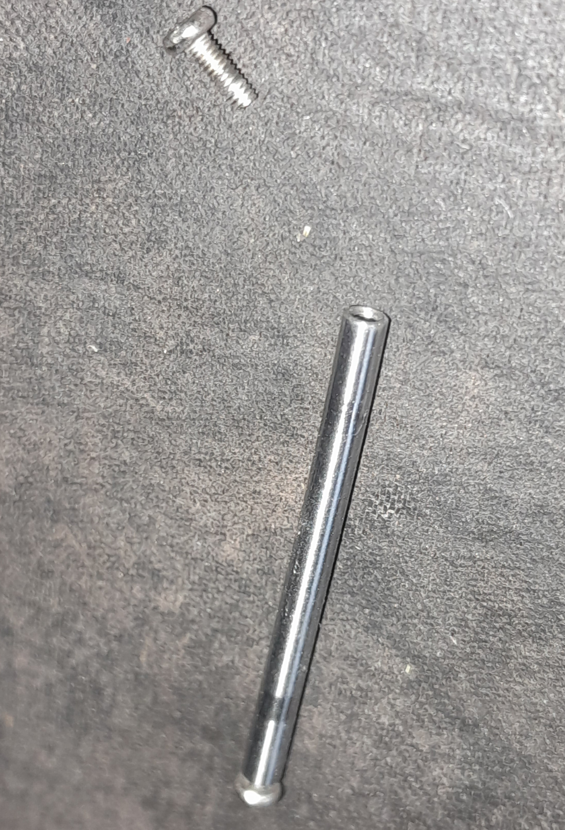

Think I've found the diff solution, I remembered a part used in my micro helicopters called the feathering shaft , basically a 2mm hardened steel rod that's internally threaded at both ends for some tiny screws , this part is just 3mm shorter than the Hotshot diff spindle so all I had to do was drill 1.5mm into each outdrive with a 2.5mm drill , a little fettling and in it goes , this stops the axial thrust from the bevel gears from binding up.
Well it's all back together but now it's pitch dark and tomorrow looks like I'll have little or no time for play so may be a little while before I test it , the diffs are still free even under belt tension though so it's promising.
Was able to find a few min to test the mini Mustang this morning and ...... the two speed dropped a screw out of the clutch
, found time to fix it and try again this evening and it runs well , diffs are still free under belt tension , still wish I could have made the Hotshot hybrid diff an option for all but it's just a bit more involved than I'd hoped for .

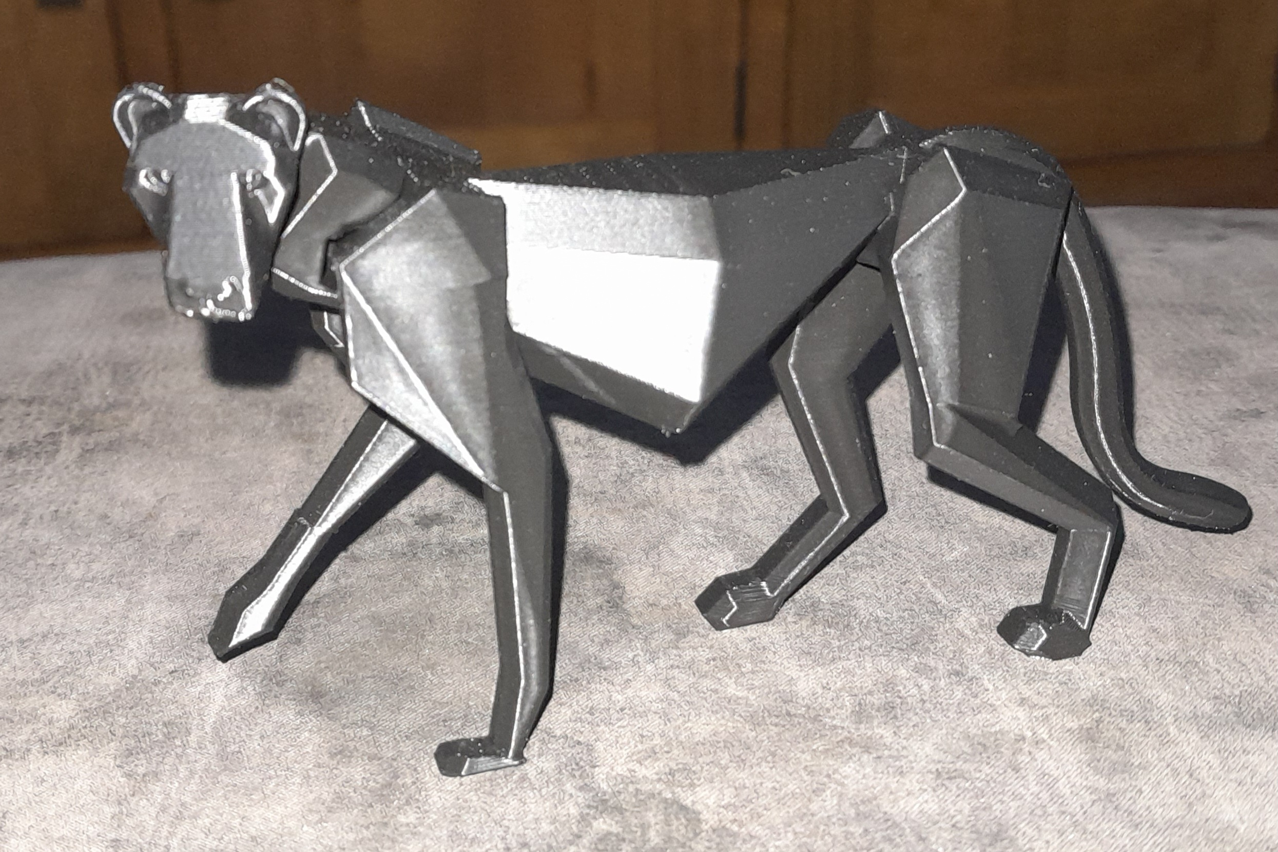

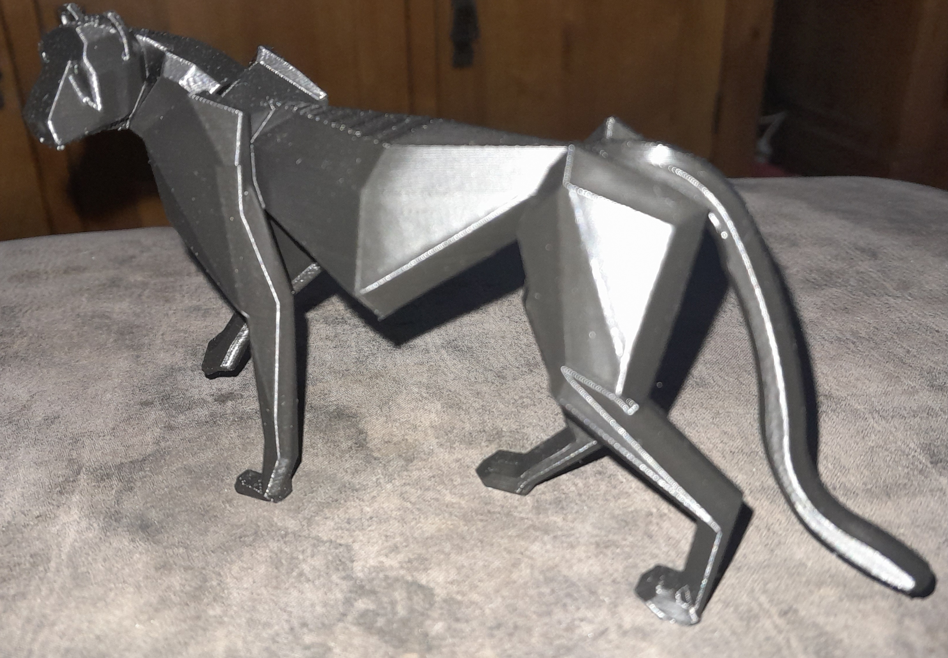

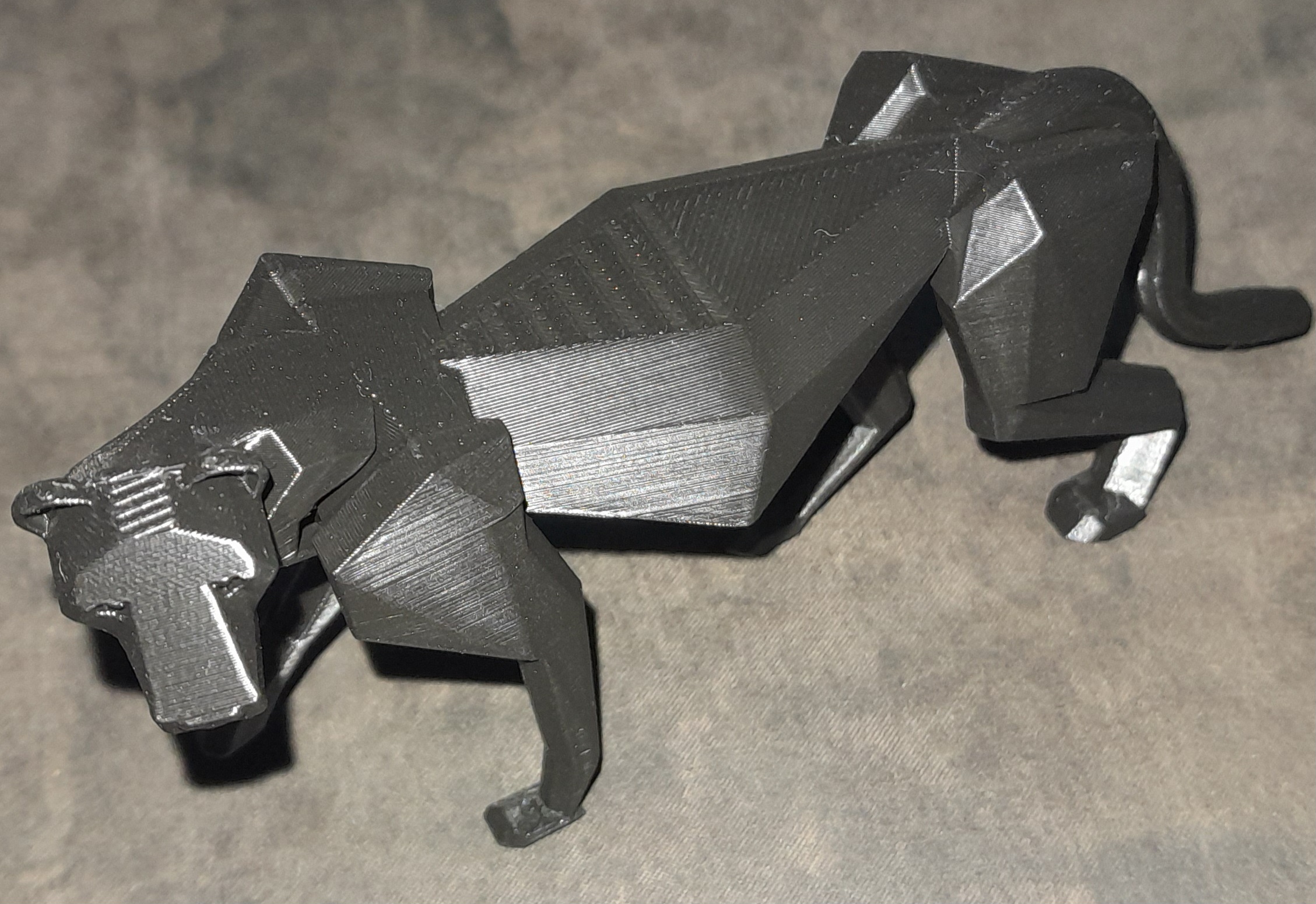

Way off topic but something I'm pleased with , this is drawn in fusion 360 from two pictures of cheetahs and home printed
