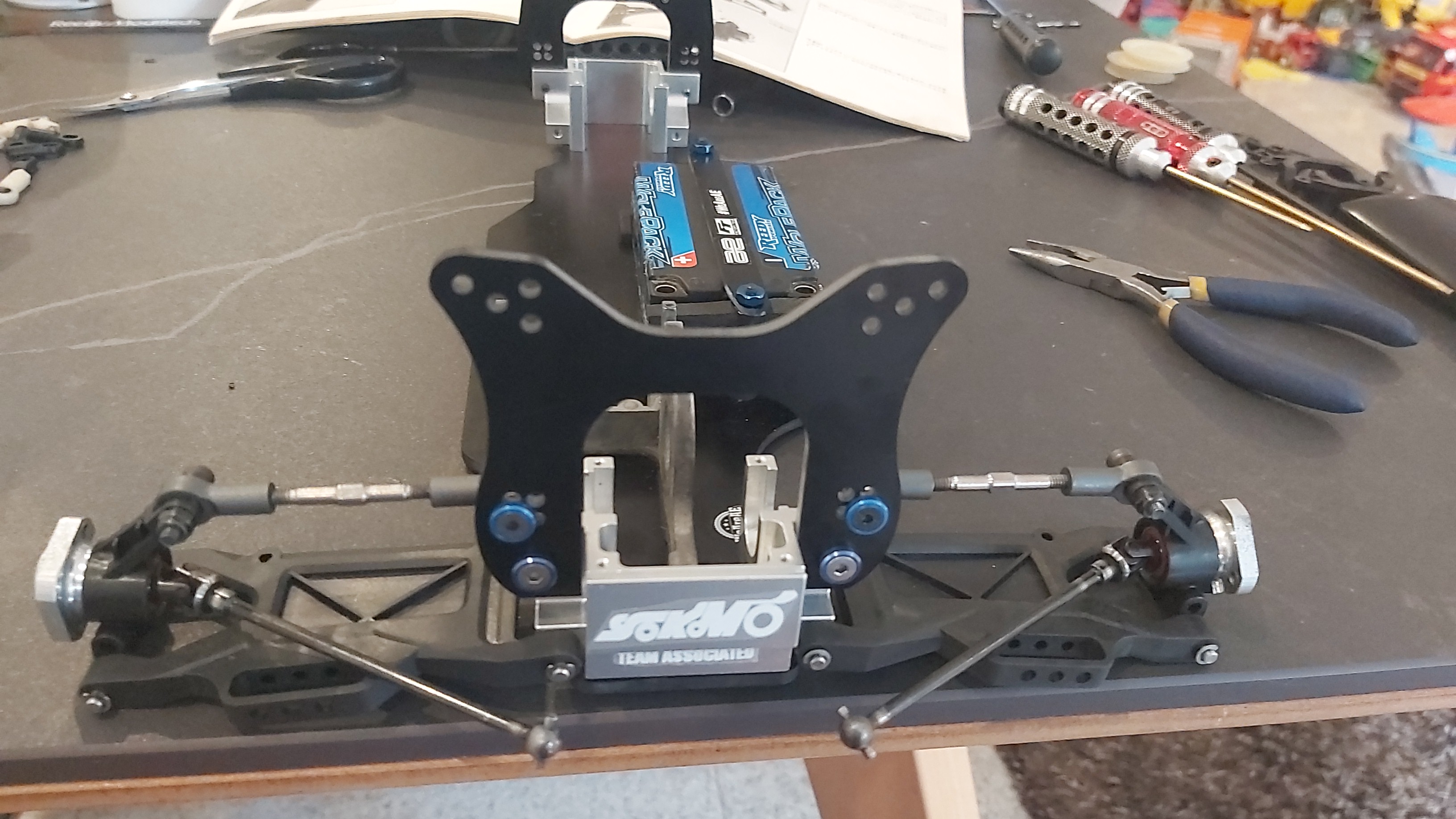

Hi @ all,
Started my works 91 Project recently, built comes Nicely together. Donor car Was original with Lots of spares.
Will use the original shocks.
Chassis Set is a special one from a good friend of mine.

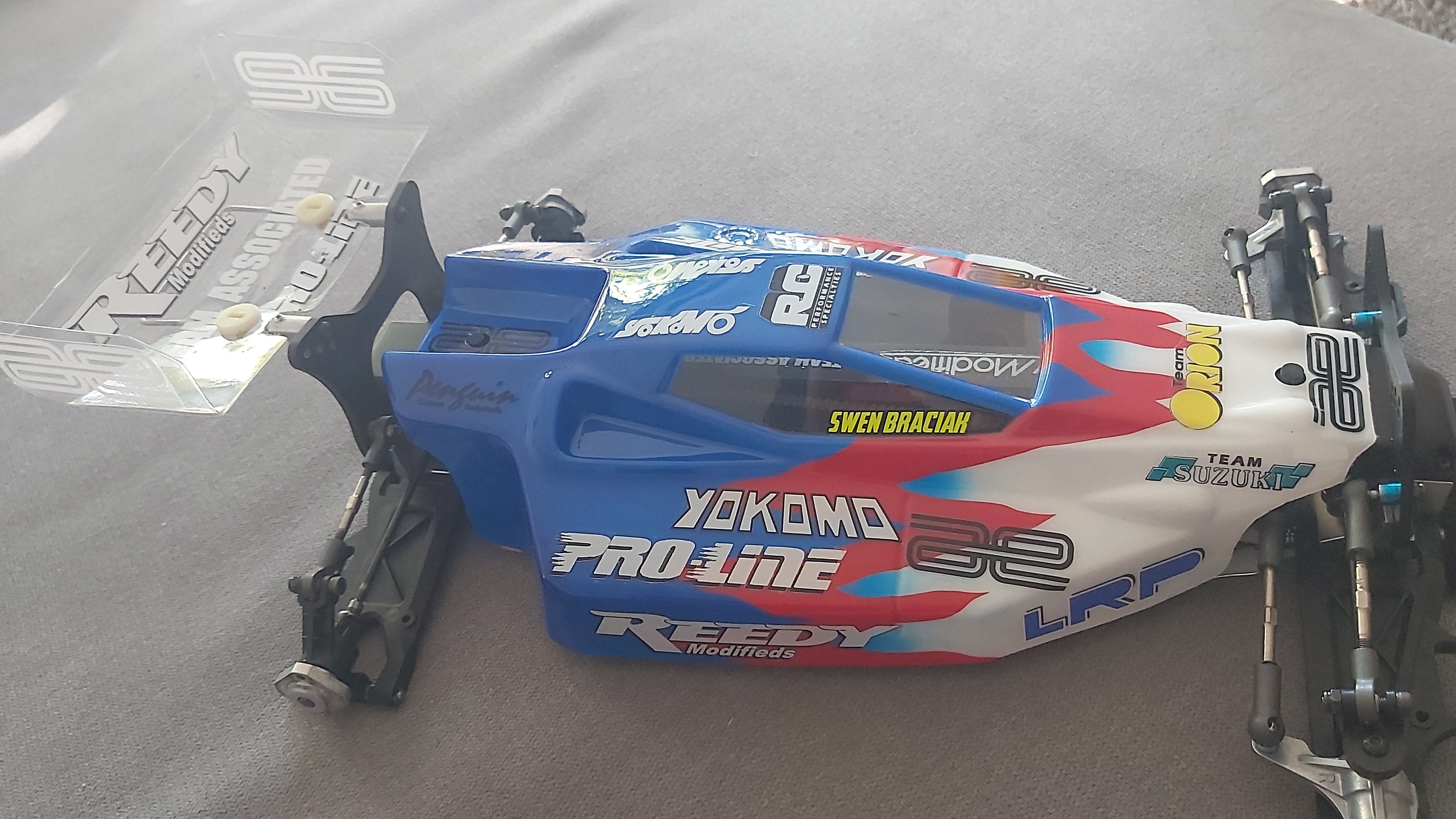

Will be watching this with keen interest. Love the Lipo specific chassis, if I ever build a runner I am definitely going to do a 91’! The Pavidis themed paint job on the body is also awesome, love it!

Re: New Works 91 Project
Hi !
Yes, will be a runner for carpet racing in europe.
Will go for the original shocks with different springs and longer associated B6 shock eyelets.
Car is ready now, except the shocks and ESC installation.
Looks stunning !!!

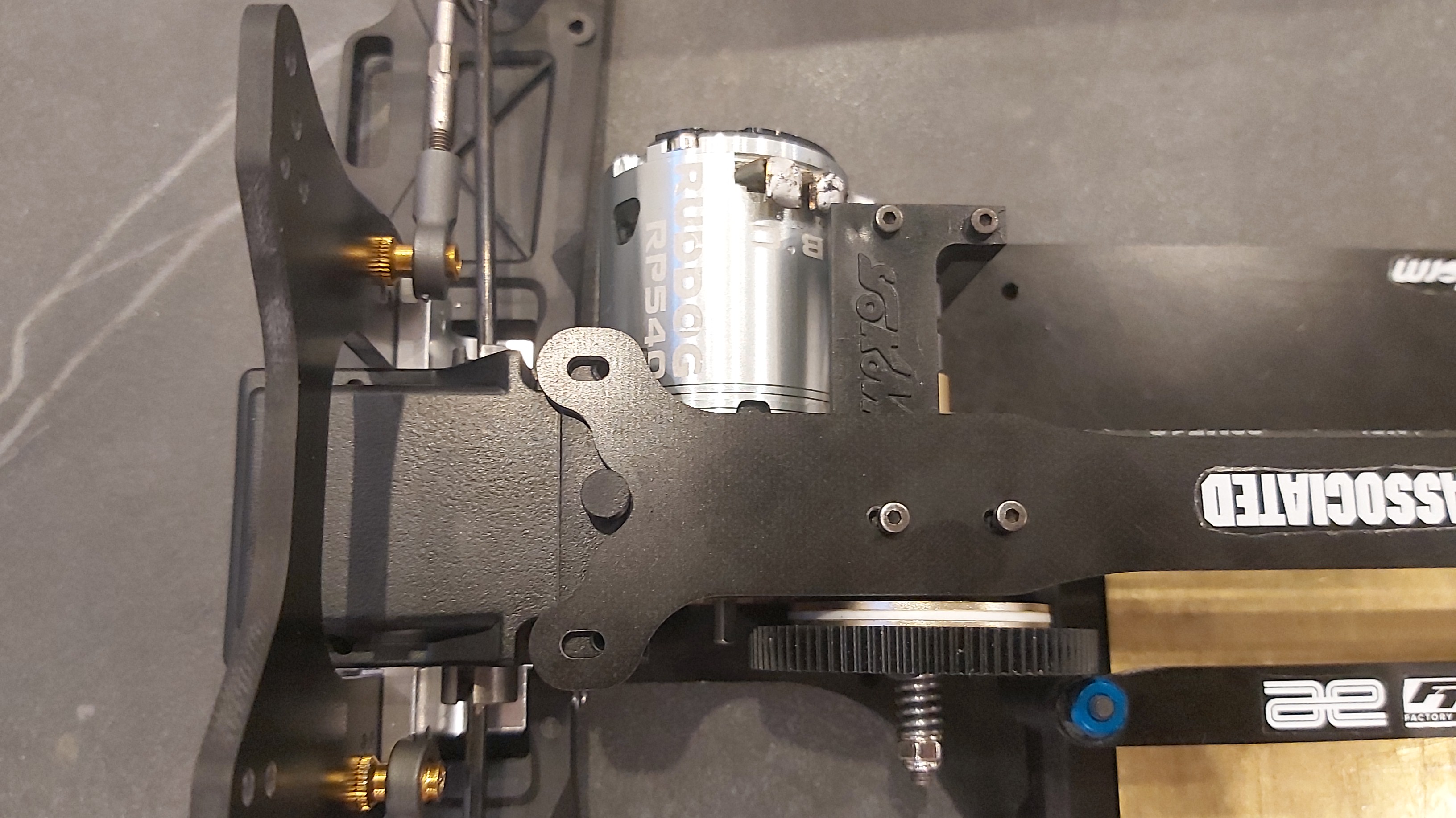

Some general built information:
- used Associated ballcups or RPM (on the steering)
- uses FAN RC front arms and original (NIP) rear arms
- FAN RC bulkheads and middle shaft with slipper unit (no one way anymore)
- steering knuckles are from Kyosho and much stronger then the origina lones
- chassis set with LWB is from y friend of mine, perhaps some of you guys have spotted it already in the vintage scene
- 3D printed lipo holder
- higher shock towers with optional holes for better setup on carpet and less travel
- Diffs standard, cleaned and renewed
- will go for a 10.5 motor setup
