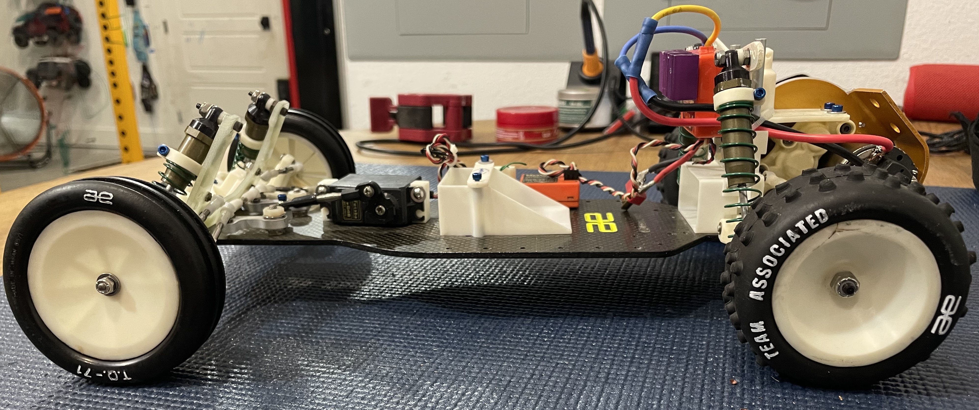

So almost a year after this post, i believe i have a completed RC10 Graphite. I was going for a "team car" build and think its been mostly successful. Please let me know if i need to fix anything to make it right! Would love to hear some feedback, if any.

What a really great looking graphite you built yourself 8)
Nice job !
Got to be the first time I’ve seen that rear tire stretched onto tq wheels. Looks pretty good.
The only thing I’m seeing from memory that’s probably a little earlier then what you’ve built is your front shock tower.
You’ve assembled a team car so that should have a six hole front tower. The four hole one on your car would have been on a regular graphite though.

Thank you! It was fun putting it together and its one of my favorite buggies in the collection. I love the box art livery. I'm trying to get a hold of a Novak servo to complete a full Novak suite of electronics, but they are so expensive! Thanks for pointing out the front tower. Funny thing is is that i do have a 6 hole in the parts bin and i will promptly swapping out the 4 hole! Haha, I'm not a huge fan of the rear tires, but its what i had. Do you recall what rear tires came in the kit? Were they the same as the TQ10?

Mtherr1988 wrote: Fri Sep 22, 2023 11:48 pm Thank you! It was fun putting it together and its one of my favorite buggies in the collection. I love the box art livery. I'm trying to get a hold of a Novak servo to complete a full Novak suite of electronics, but they are so expensive! Thanks for pointing out the front tower. Funny thing is is that i do have a 6 hole in the parts bin and i will promptly swapping out the 4 hole! Haha, I'm not a huge fan of the rear tires, but its what i had. Do you recall what rear tires came in the kit? Were they the same as the TQ10?
Any TQ tire would be period correct. Really late kits shipped with a 6823 step pin.
I just double checked the 25 yrs thread and according to it, an early graphite team car could have come with a four hole front tower…..

6872 and 6822 are the tires you'd be looking for.

scr8p wrote: Sat Sep 23, 2023 1:19 pm 6872 and 6822 are the tires you'd be looking for.
Yes, for an early kit that seems correct.

How accurate are you wanting?
Because the blue screws, turnbuckles, and aluminum bellcranks are also incorrect. Not really out of place, just not kit spec.
The green springs look like the newer type as well.

jcwrks wrote: Sat Sep 23, 2023 1:54 pm
Should be for all cars up to the all black kits.

juicedcoupe wrote: Sat Sep 23, 2023 2:05 pm How accurate are you wanting?
I'm just wanting major pieces to be correct. The 4 - 6 hole front shock tower for example. Not looking for 100% kit spec on this one. I do have all the parts you pointed out to put back to kit, though. I was unaware there were different versions of the green springs? How can you tell? Thanks for all the comments and replies so far!
