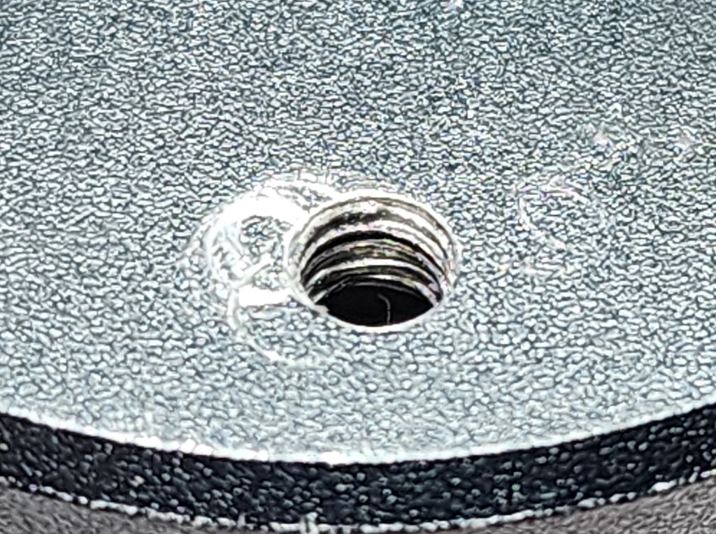

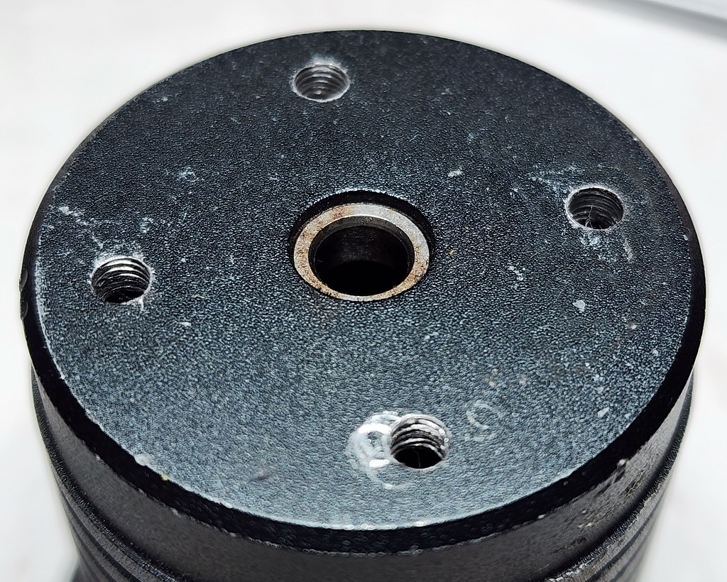

So finally got some time to try and repair my son's Team Orion brushless motor with the stripped mounting holes. I took some pictures this time! So it turns out that two of the four provided mounting holes are stripped, and they are next to each other, so can't just turn the motor 90 degrees and use the other two. Either way would have one completely stripped out hole. In the overall pic, you can clearly see the hole on the right is pretty cleanly stripped. You can take the proper size M3 screw and just insert it easily into the hole and remove it. There is literally no metal there to grab anything! This was the way I got the motor when I bought the car. The hole on the bottom is the latest one to strip out. And a detail shot of the threads completely buggered.
So I used the motor mount for the car as a template and marked two new holes slightly offset, drilled new holes using a #39 drill bit and an M3x0.5 tap, and it came out quite nice! Luckily, there was about maybe 10mm or so of clearance between the stator windings and the end plate for clearance of the drill bit and tap. Time will tell if there is any strength to those threads. I used new hardware, lock washers and blue threadlock when I installed it to the mounting plate. In my haste to get it back together, I forgot to take a picture of the completed new holes. If I take the car apart again I will try to remember to snap a pic of the new mounting holes.

If it ends up not holding the greatest, just drill out the original holes and tap for M4 screws, and use aluminum washers. But sounds like you did a thorough job.

A small update on my son's Team Orion brushless motor thread repair. We ran the cars the other day and it was the first time that both of us were able to run the cars all the way to battery dead state. Running the same cars (TC-3's), same batteries (3300mAh NiMh) but different brushless motors, I got about 30 minutes and my son got about 35 minutes. We had a few smacks on the cars but no full speed into concrete disasters. The thread repair is holding 100% so far.
