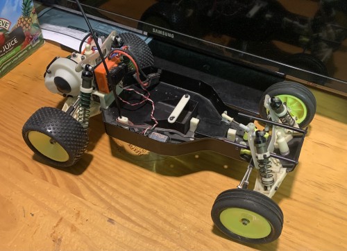

So are you going to stay with that Futaba receiver and servo? It all works, has the same wire order in the plugs, etc.
- juicedcoupe
- Posts: 3552
- Location: Pascagoula, MS
- Has thanked: 270 times
- Been thanked: 2099 times
Re: RC10 Gold Pan - C stamp?
The blue receiver and servo with blue plug use the newer "Z" plug. The Z plug has the common wiring format, which follows that of Futaba, Hitec, JR, etc. As I said before, other (non Z) plugs will require a little trimming.
The black Airtronics receiver and black plug servo use the older Airtronics wiring format, which has a different wiring pinout.
I tend to avoid older Airtronics servos and receivers, just to avoid accidentally damaging stuff. Mixing them incorrectly will definitely fry a servo and possibly damage the receiver and/or esc.

I really want to go back to the Airtronics Rx that matches the radio and servo's that I bought with the kit in '96. Hoping to get the pin out right this time.Frankentruck wrote: ↑Sun Dec 10, 2023 6:31 am So are you going yo stay with that Futaba receiver and servo? It all works, has the same wire order in the plugs, etc.
To me, that's crazy that they used the same model numbers for the Rx, and Servo, even though they have a different pin layout. Any change in design should've been denoted with a model number change, weird stuff.juicedcoupe wrote: ↑Sun Dec 10, 2023 2:52 pm The blue receiver and servo with blue plug use the newer "Z" plug. The Z plug has the common wiring format, which follows that of Futaba, Hitec, JR, etc. As I said before, other (non Z) plugs will require a little trimming.
Thanks guys!

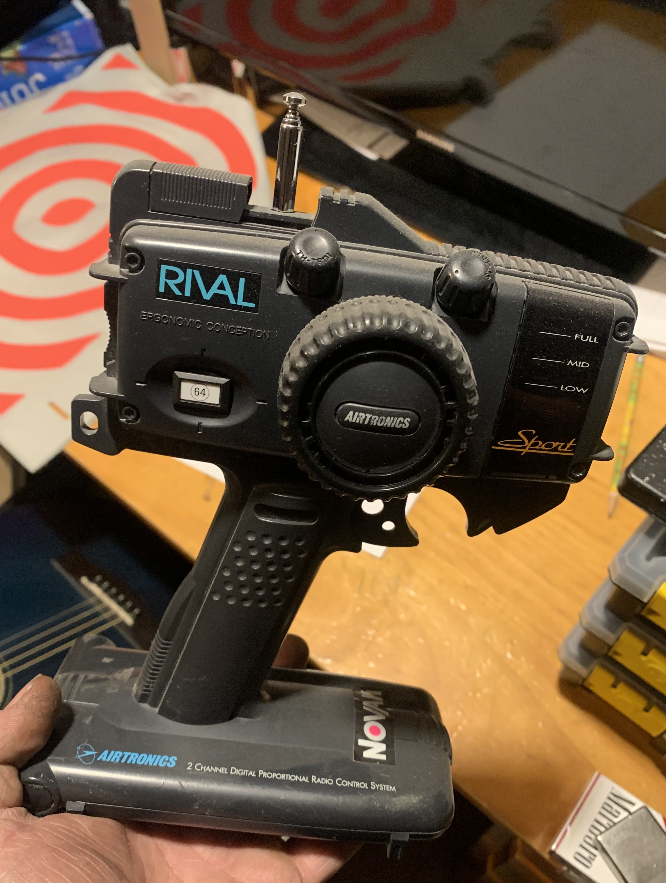

- MarkyDents
- Posts: 1187
- Has thanked: 1809 times
- Been thanked: 643 times
Got the same transmitter running a team car.

Looks great! I like how the ESC is on the bulkhead too.MarkyDents wrote: ↑Sun Dec 10, 2023 4:26 pm Got the same transmitter running a team car.

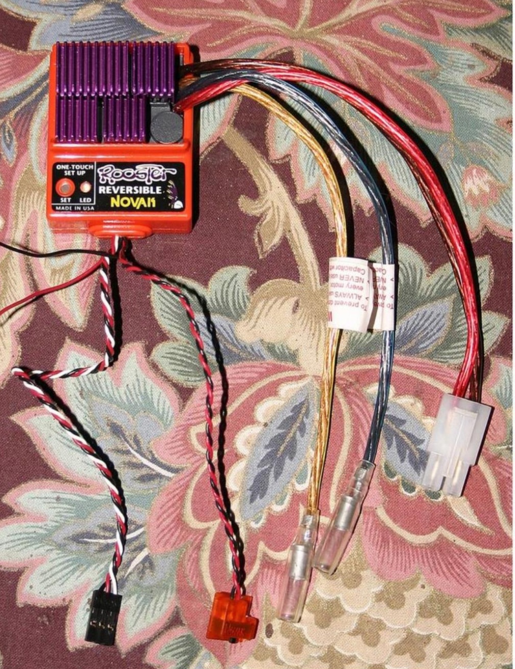

Getting ready to connect the ESC to the stock DS Spec motor.
Rooster motor wires are yellow and blue.
Stock MSC had the red/black wires.
Preparing for connecting the blue and yellow to match.
When I saw this:
Amazon had (120) 0.1uF NP caps, for $7 prime free shipping, can't imagine what DigiKey and Mouser would've cost for the shipping alone, when I really only need (3) of these.
When I saw this:

According to the Rooster manual, I'm supposed to use (3) 0.1uF caps.
I have (2) of the caps setup from + to -, but I can't see a third ground tab like in the manual.
Does anyone know where the third cap would go on a stock motor?
EDIT: Supposed to solder the third to the can of the motor, missed the * in the manual. Doing it now.

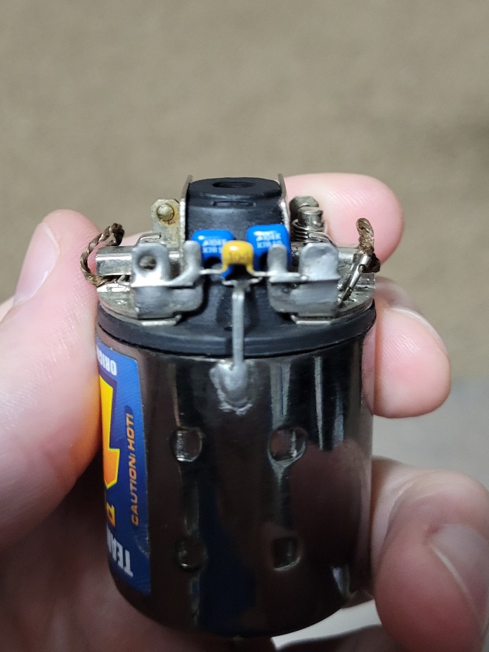

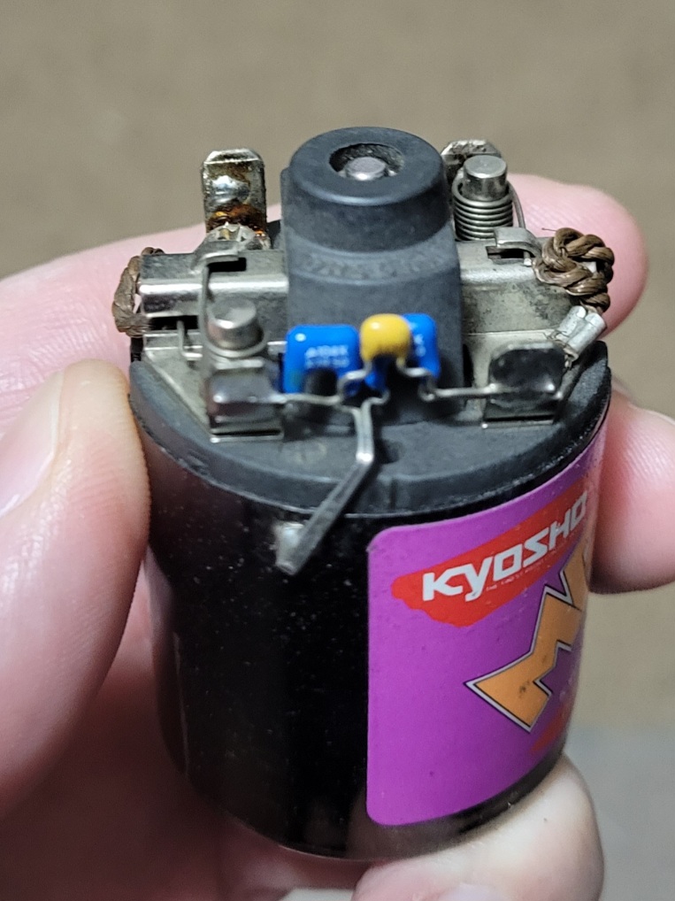

Only one cap goes across the positive and negetive tabs.
The other two will go from the positive and negetive tabs to ground.
Motors with crimped endbells don't have ground tabs. You must attach directly to the can (it takes some practice).
Here are a couple of mine.

Nice work @juicedcoupe! Those Amazon caps did have some seriously short leads, nearly too short. I think I got it though.
