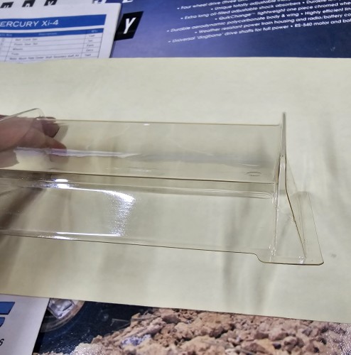

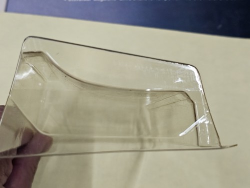

I also first thought the wing end plates were bent from storage as well, as you can see on my original wing here
But it shows the bends in the sides in the manual
I guess I'll have to change the wing, or to make a second one, with the angles. The fact is that car was sold under Mugen, Academy, Ryuz and Graupner. I've not seen much of Academy and Ryuz pictures, but it seems that the Ryuz one had a different body, a metal undertray (and no lateral decks), and potentially a different wing from what I saw. And I'm affirmative I saw some Mercury with no angled sides.

Not sure if this helps. Very hard to photograph and get that line. Mine is the World Engines version (Academy)

Following @terry.sc and @GoMachV indications, I modified the wing...
