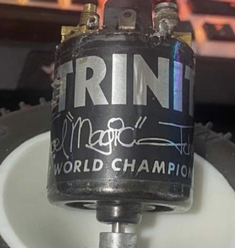

Hello, first post here and was wondering if someone can tell me a little about these motors? I purchased one for $35 that supposedly still runs. Thanks

Well that's a start. Hoping someone will come along that has actually owned one of these. Wondering if I payed too much or got a deal? What is a good recommended vintage ESC to match it up with and what pinion? Can I run lipo with this motor so long as I watch temp and run time etc?

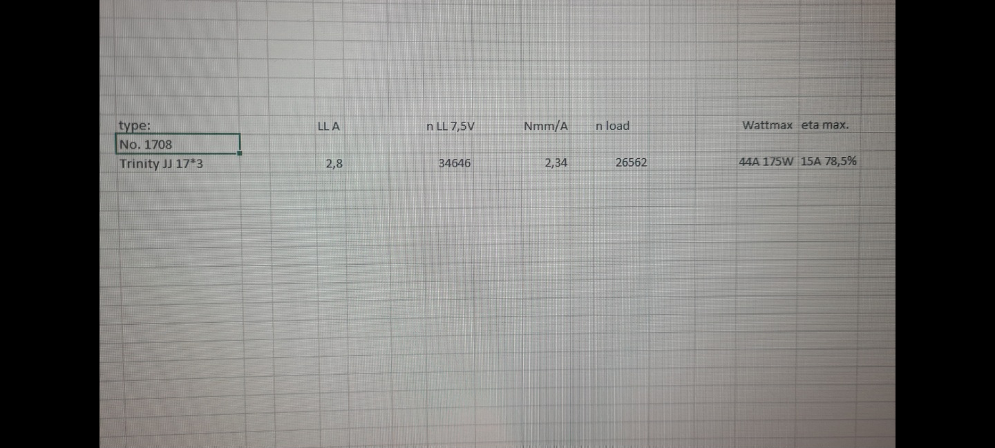

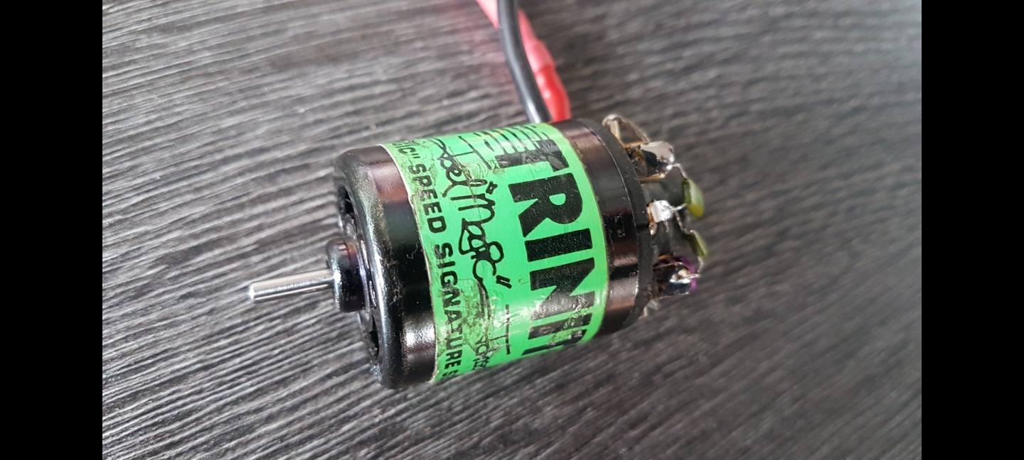

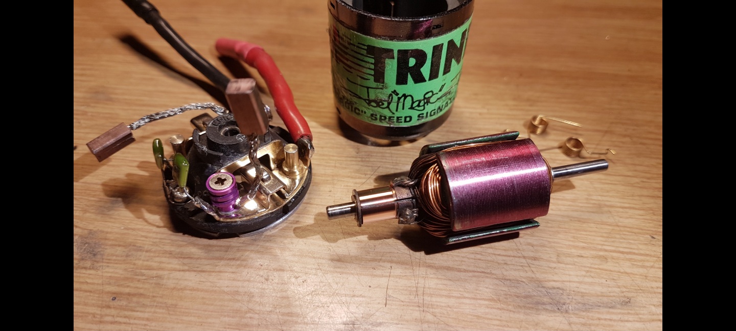

Hi, i ve a similar one, thought it would be the 1708 Trinity, bit with green sticker.. measured data seems to be 17x3 Turns..
Perhaps you can open it and take a pic?

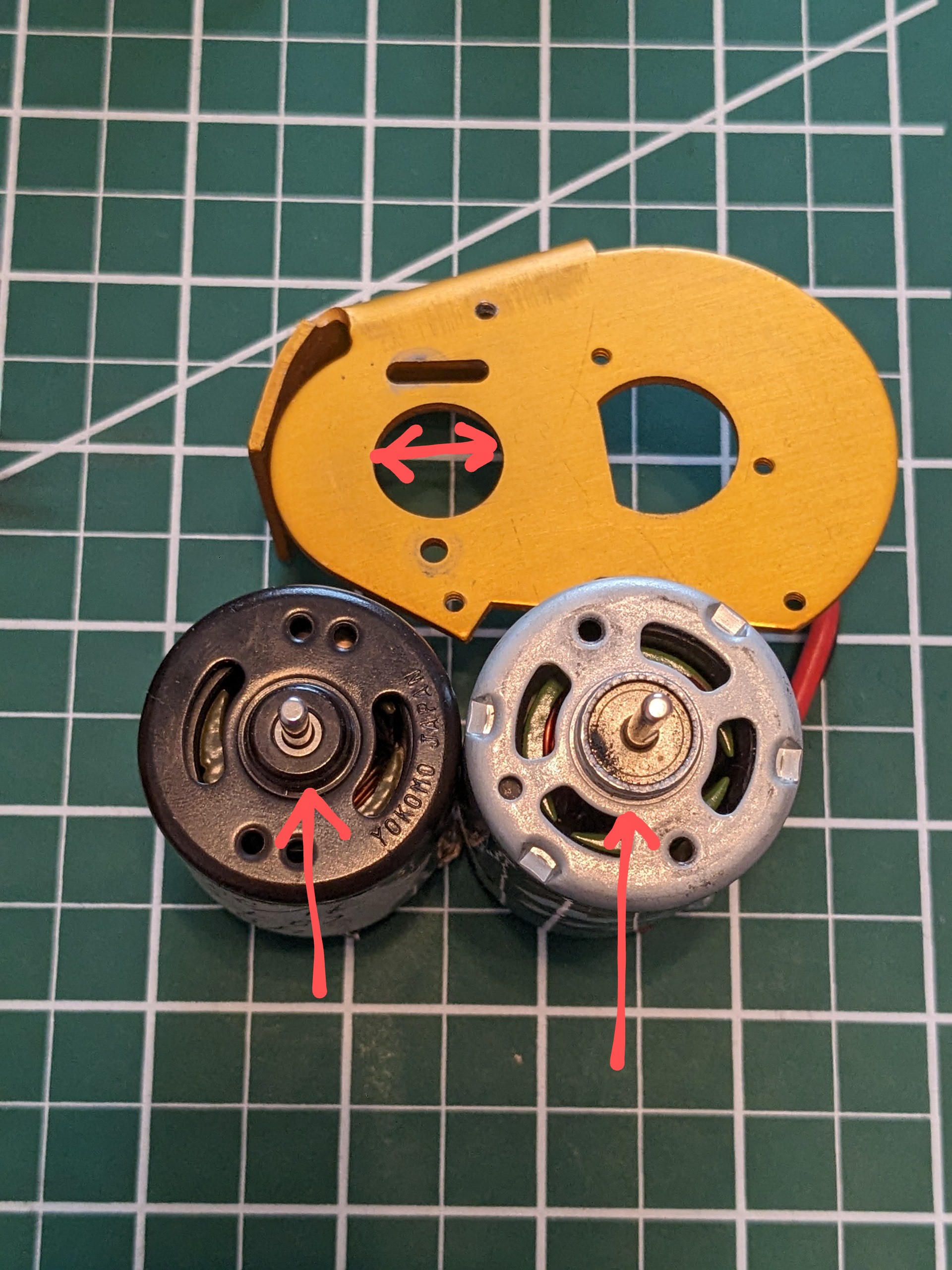

I have a stockpile of vintage motors that I would consider runners more than collectors. Many of them have either lost their label or have a replica replacement label on them. It is fun to run a nice vintage motor sometimes but it isn't fun to burn up a nice vintage motor.
Motors like the Traxxas Titan 12T have a built in cooling fan that spins with the motor keeping it cool enough for long run times. But they have a large shaft bushing that will limit distance the motor can be moved in the motor plate for pinion gear choices.

I have two of these motors. As mentioned they're 17x3. You certainly got a good deal at $35. In my opinion, this is a motor to keep in as good of shape as possible and it would be a shame if it got burnt up. Reedy Radon 2 motors are a dime a dozen and would be a good candidate for a runner motor.
