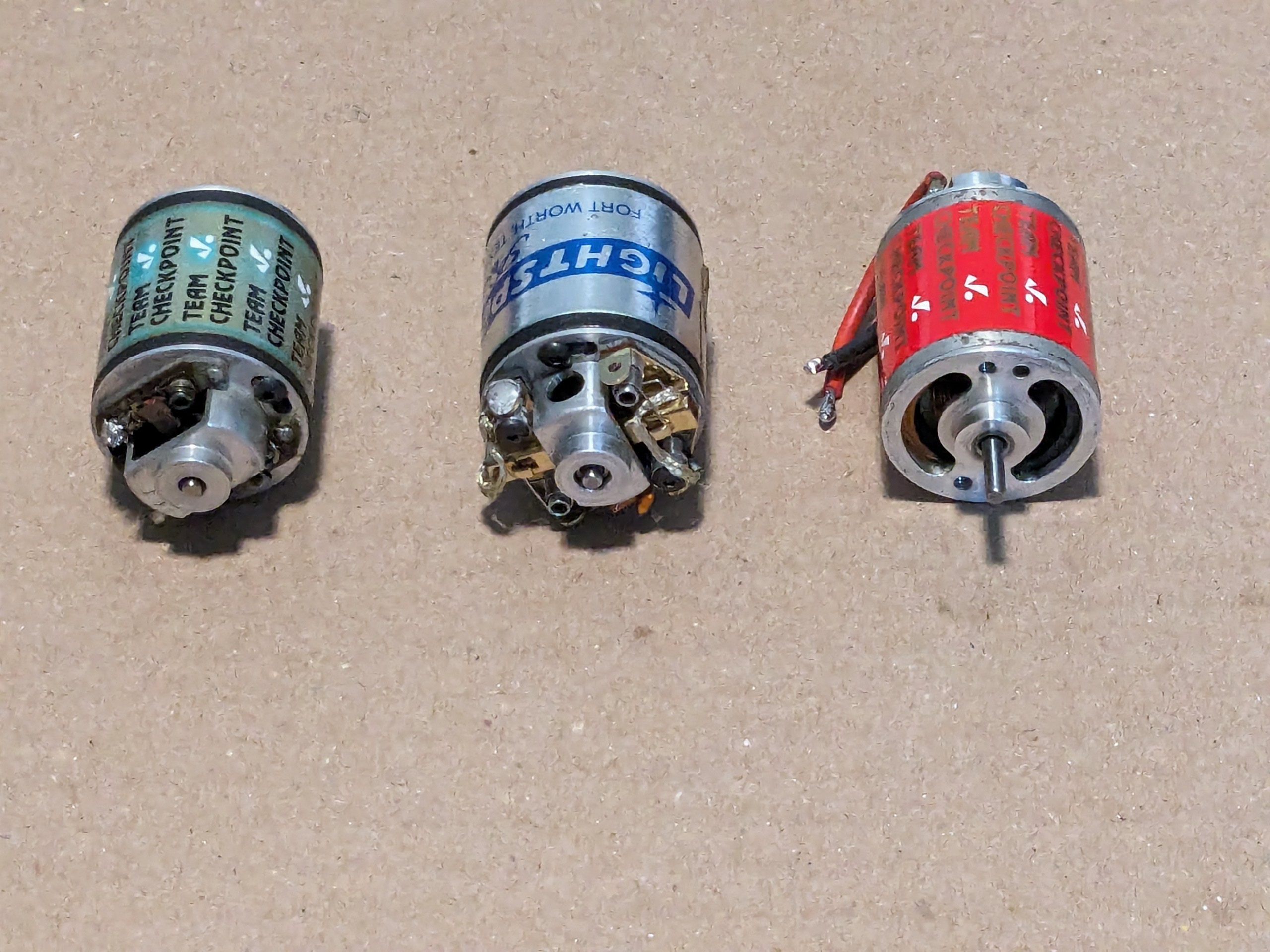

Re: Brushed motor cans & endbells
Checkpoint motors are the most common place to find these cans and endbells but some other brands did use them. I'm not positive if Checkpoint was the maker of the parts. They are one of the cans that had an aluminum mounting face.
. Example of an early Checkpoint motor with early Yokomo can and open endbell.

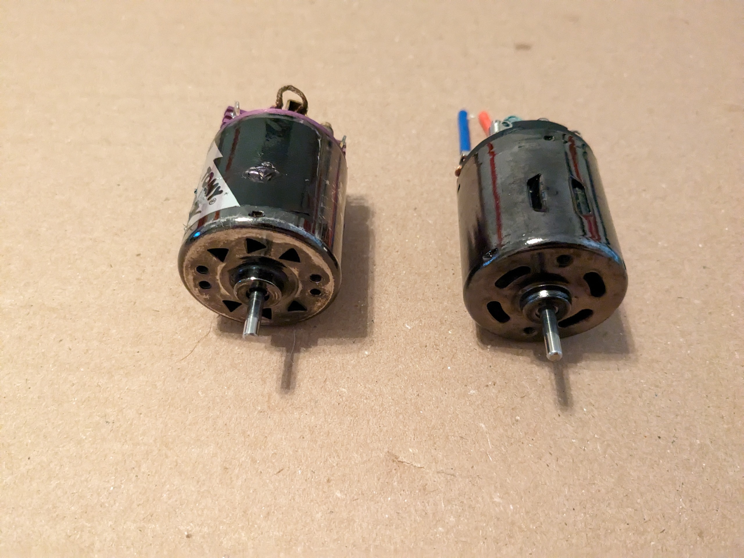

I'm lumping the M's together, just because. Mabuchi and Malung
. Mabuchi also had a steel and aluminum can.

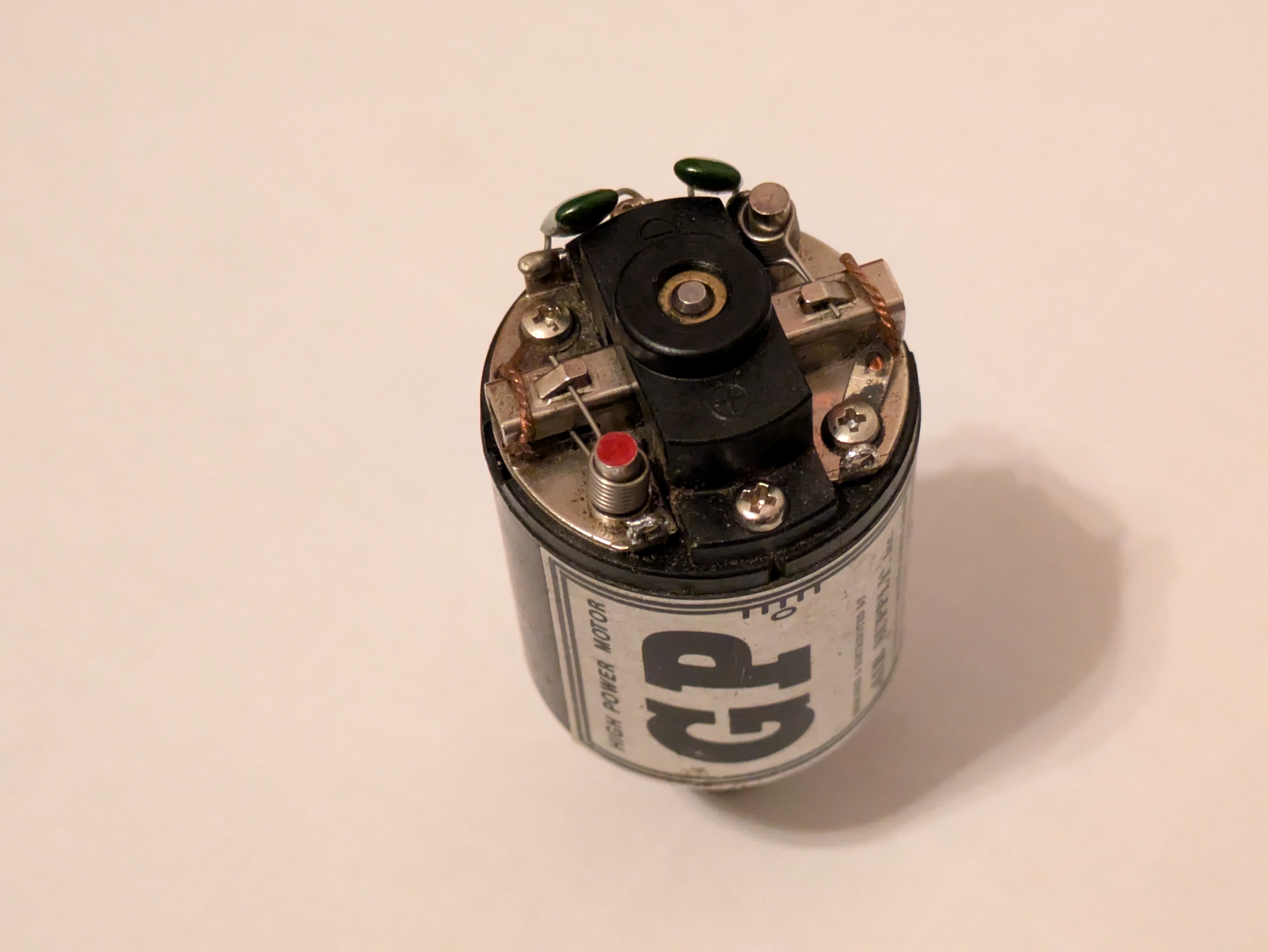

GM Racing (Graupner)

It's worth noting that Lightspeed never used a Checkpoint aluminum endbell, so the former owner swapped it out at one point. Checkpoint sold bulk platinum cans (and possibly alum endbells) to Fantom though, and they used their own arms and endbells.

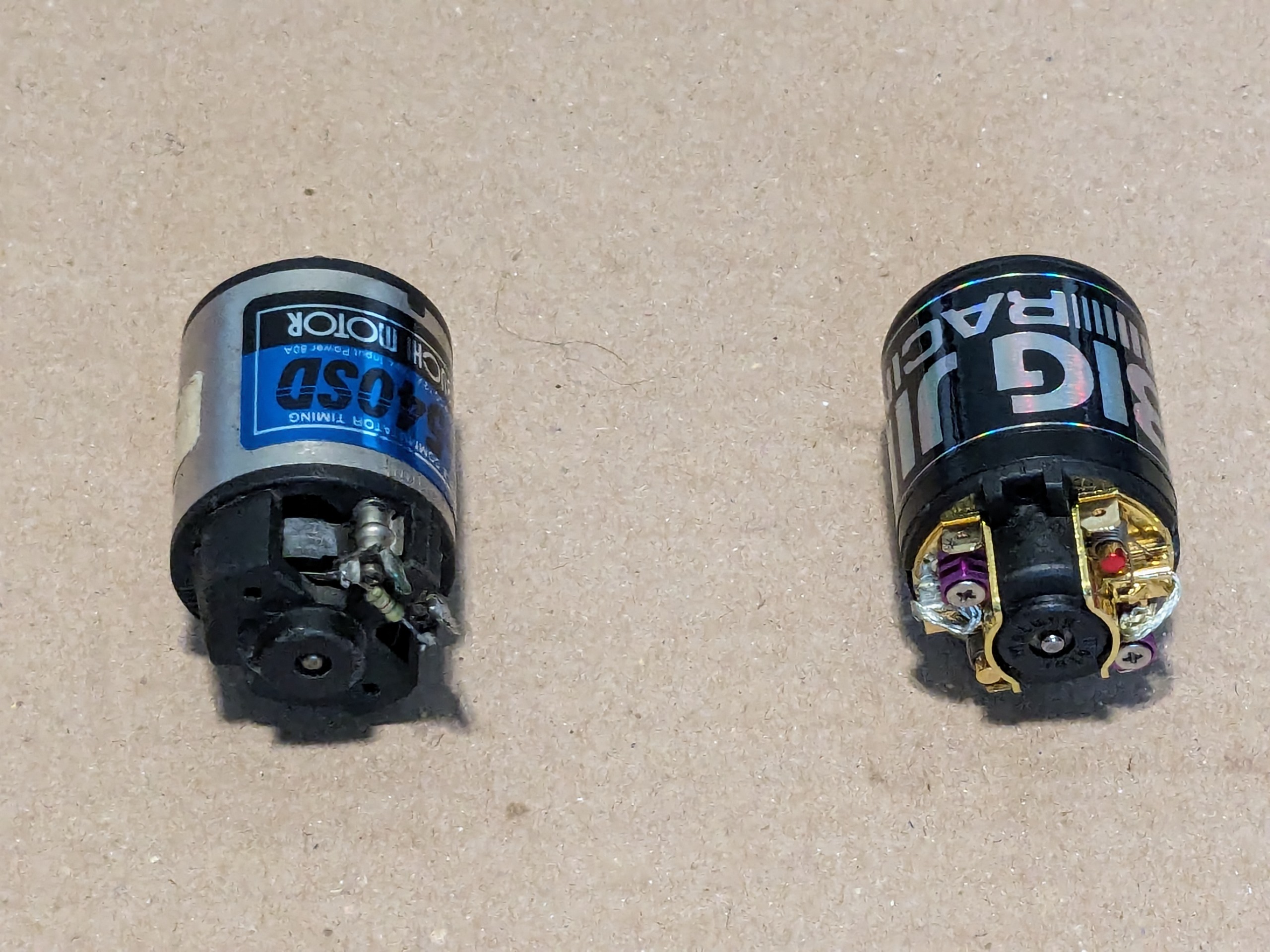

Trinity/EPIC has produced a lot of variety.
There are a couple of common styles that looks to be from Kyosho design.

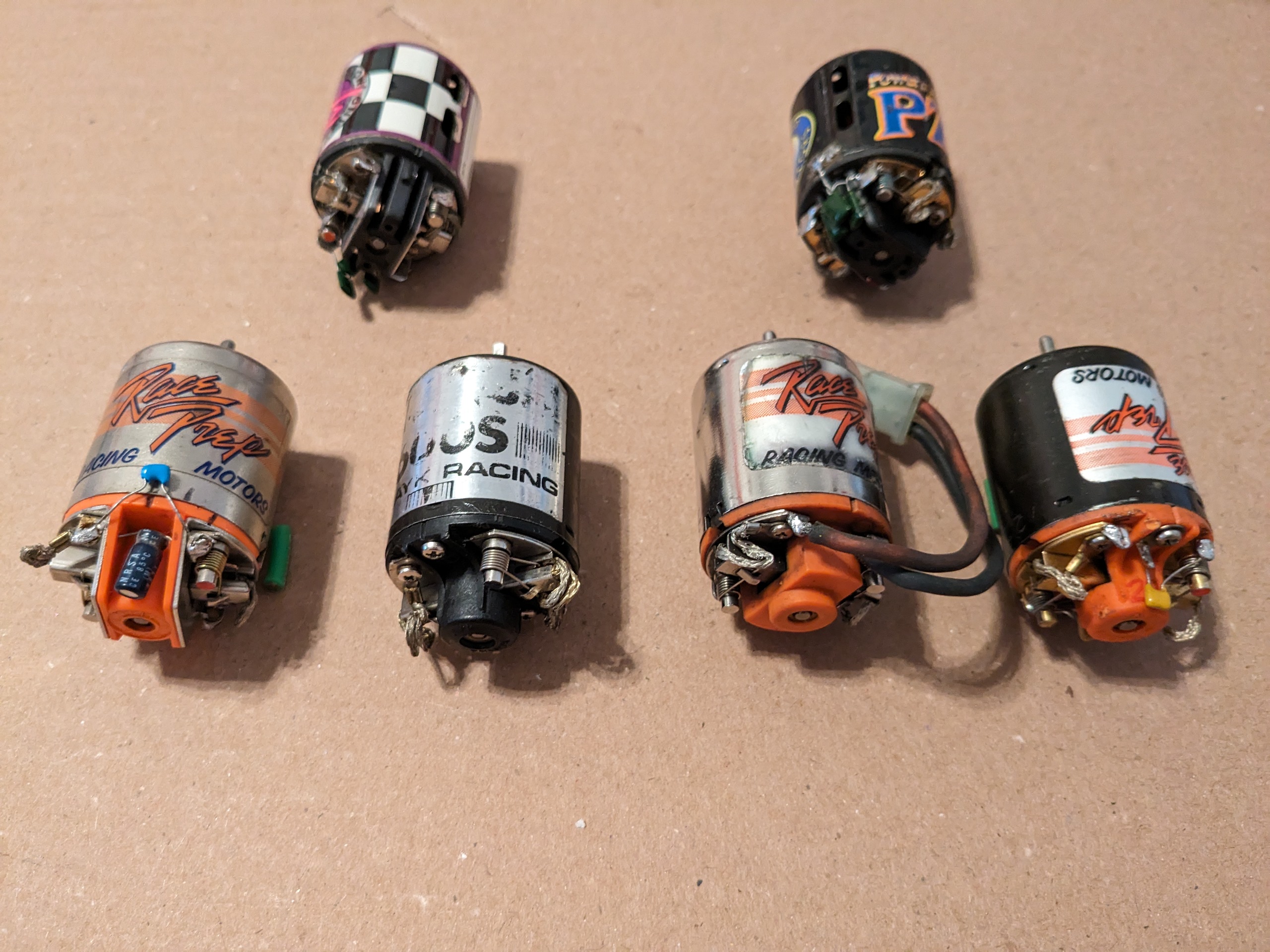

AYK/Race Prep
. . This one has had a Race Prep Accessories label put on the can and there is doubt that it is actually a Race Prep motor: . .
However this AYK GZ480 motor has some endbell construction similarities, although nothing is the same as the doubtful motor.

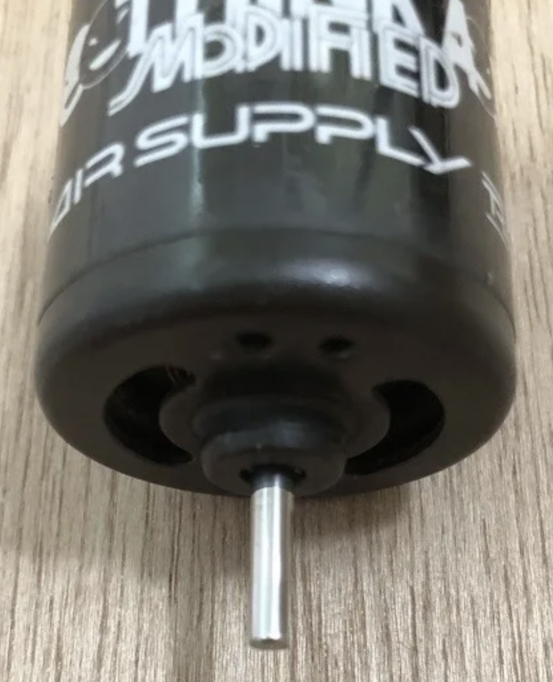

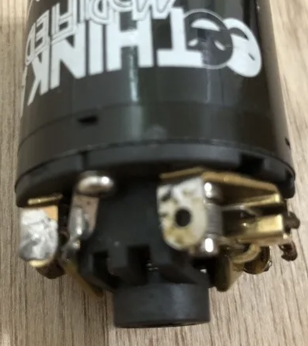

Air Supply endbells.
The Air Supply motors I've come across look to have Yokomo style cans.

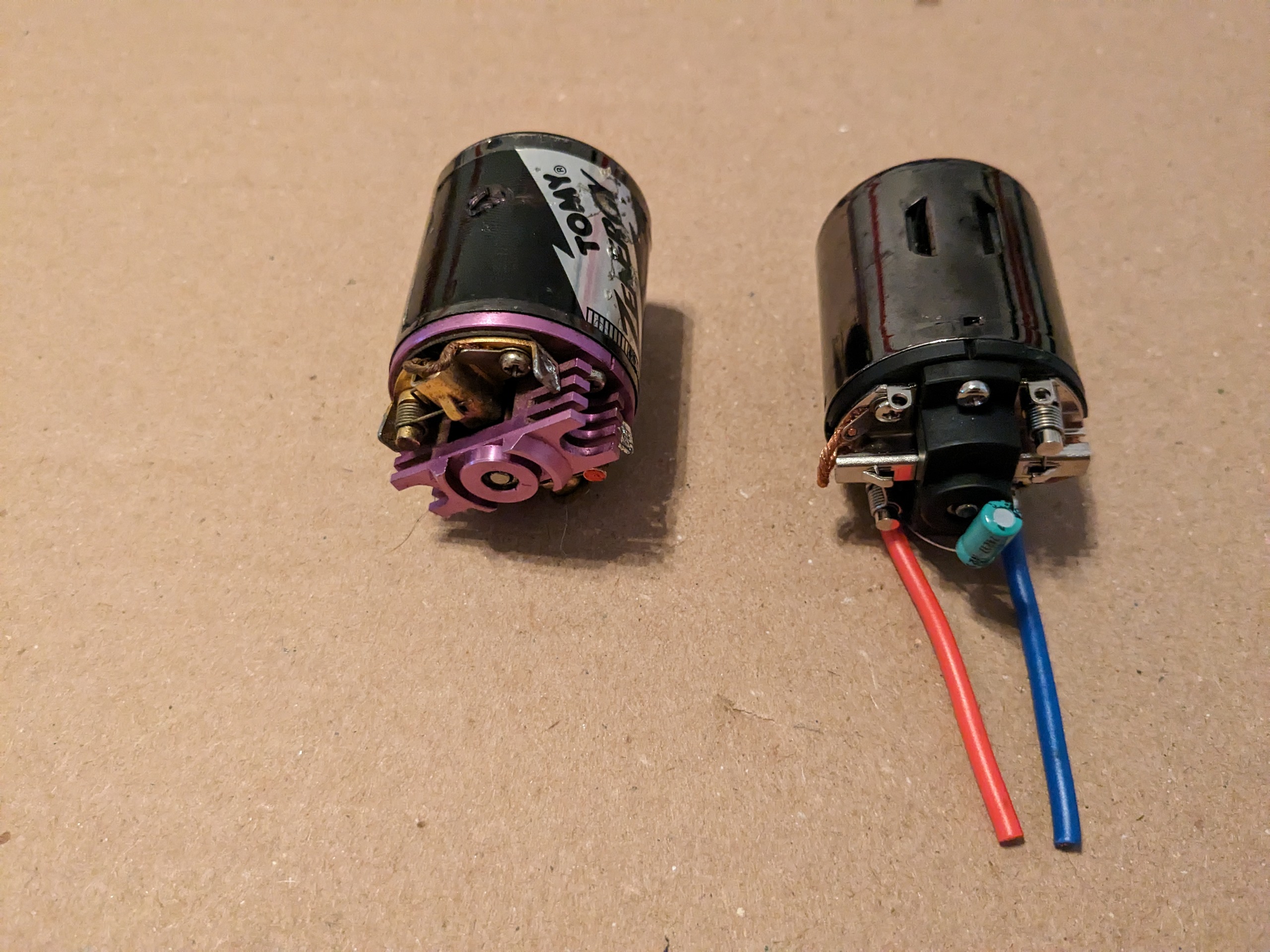

I'm also going to lump together Diamond and Tomy for no particular reason.
